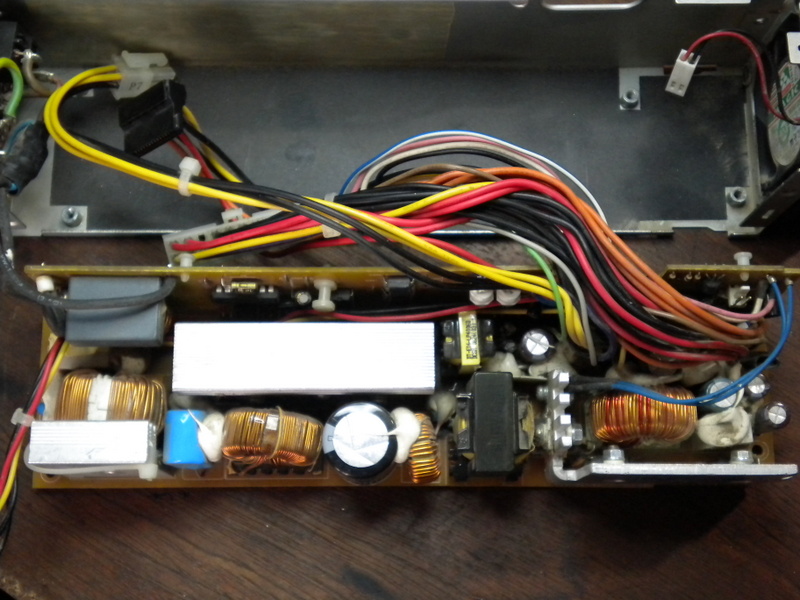

    Got fuj. siemens esprimo c5910 with power issue : no reaction to switch.
    To make pc start, need to power up PSU alone without load (by grounding pson) before connecting it to mobo
    All PSU voltages are checked ok without load (stby voltage=+5v), but when connected to mobo, stby voltage becomes low : 1.8V.
    Steps taken : swapped PSU with a good working one, pc starts normally.
    Concluded that PSU is culprit, and particularly stby rail.
    Opened PSU case, all caps are looking fine.
    Any idea as what are the main stby rail check points and where to dig further to help fixing this issue ?
    Thank you

    Post the make and model of the psu and good pics of the psu guts, top and bottom of the board. then someone may be able to help ts it.

      Any hi res pictures from top and bottom to go with this? I think that this is a "special" PSU as it is rectangular tube shaped and does not use a standard ATX PSU case.

        PSU model : NEWTON POWER LTD MODEL : NPS-210BB A REV : 08 -210W
        Unfortunately, no specific schematic found on the net.

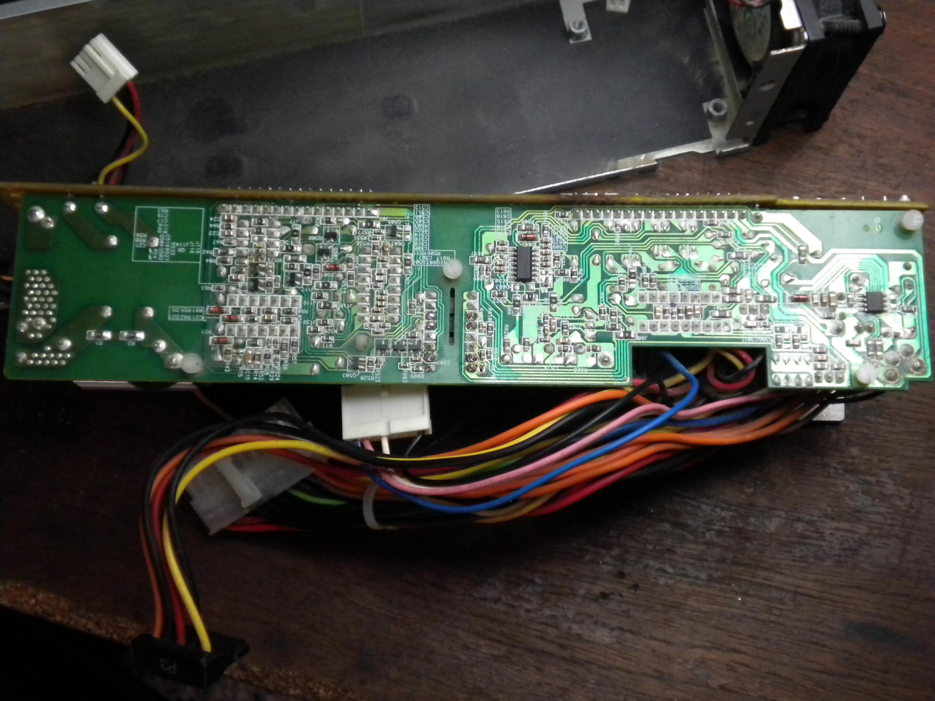

        Here attached some photos.

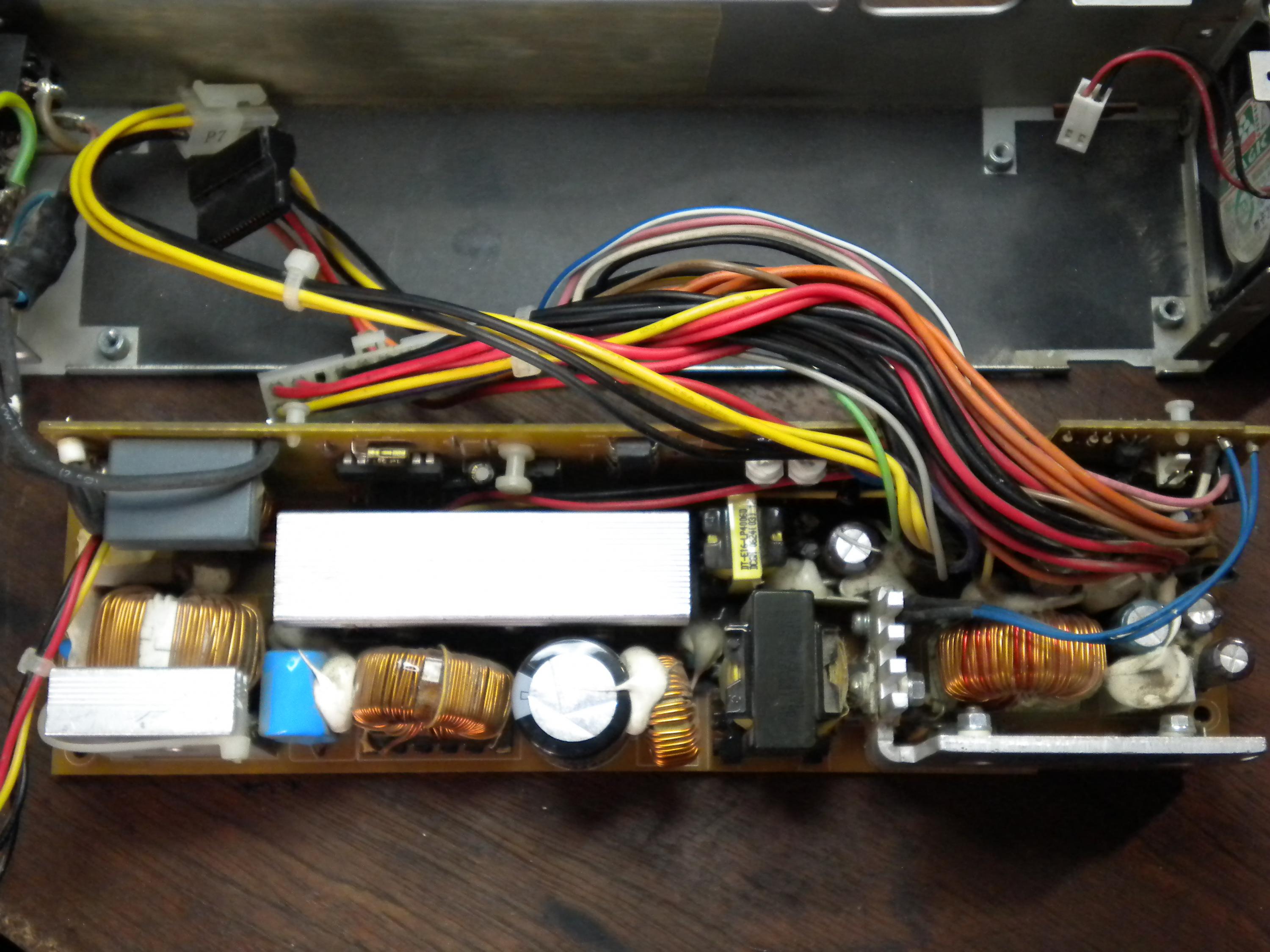

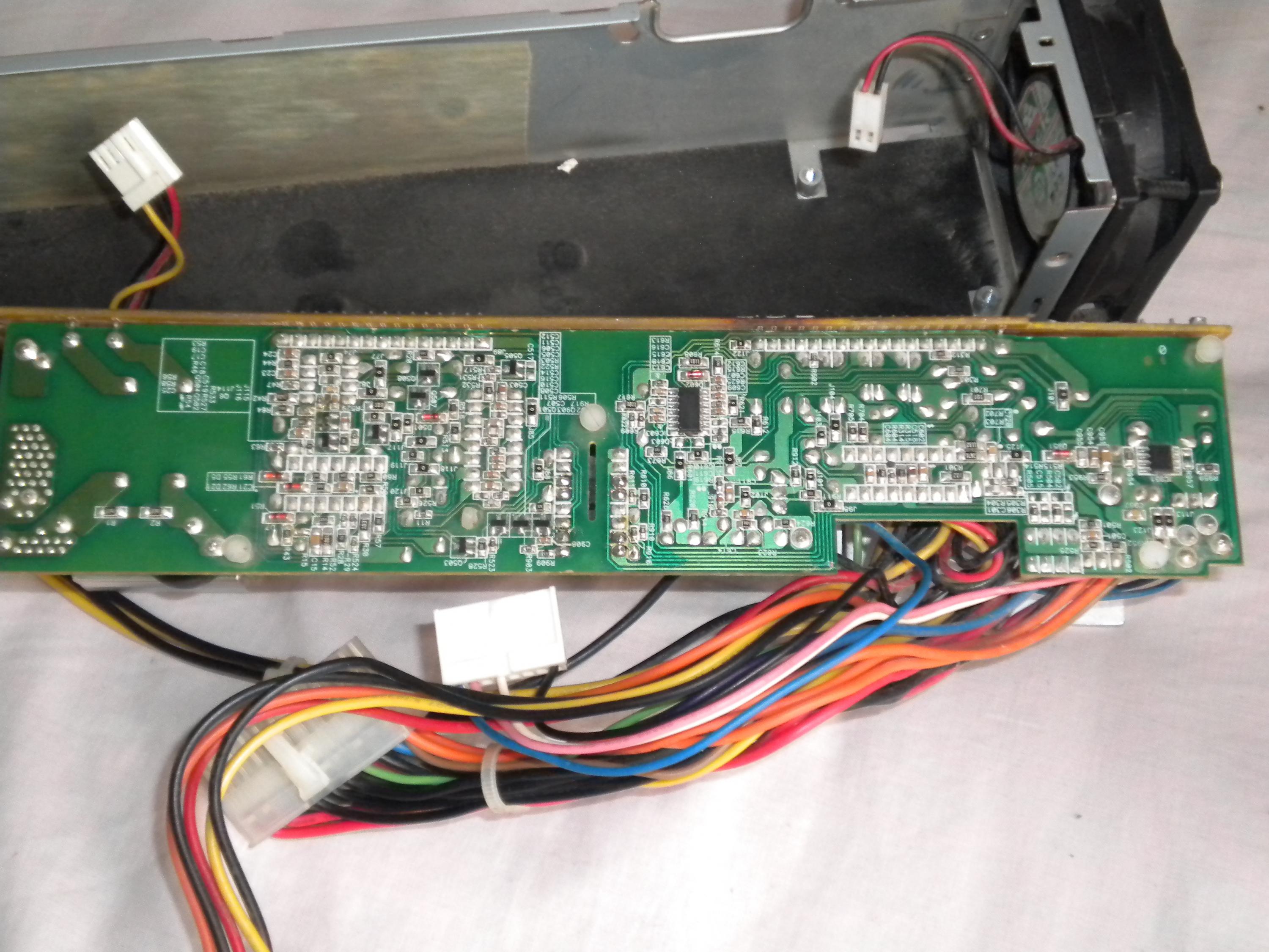

          Here newly attached reduced size photos, if previous photos are slow to load.

            probably bad caps on the standby causing voltdrop when there is actually a load.
            specially in that, it's packed like a train during rush-hour!

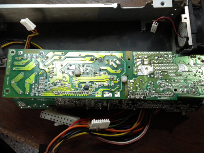

              Sorry Board1 and 2 uploaded were same.
              Here attached real Board2 of PSU.
                Caps are looking quite fine. If no other fix found, will change all caps on stby rail.
                  Re: ATX stby voltage too low +1.8v
                  x2 what stj said.
                    They can look "fine" but still be bad. Without an ESR meter, you can't really know for sure.
                    So in cases like yours, it is best to change them. I've seen bad caps (that looked physically good) make the 5 VSB act weird in more than one occasion.
