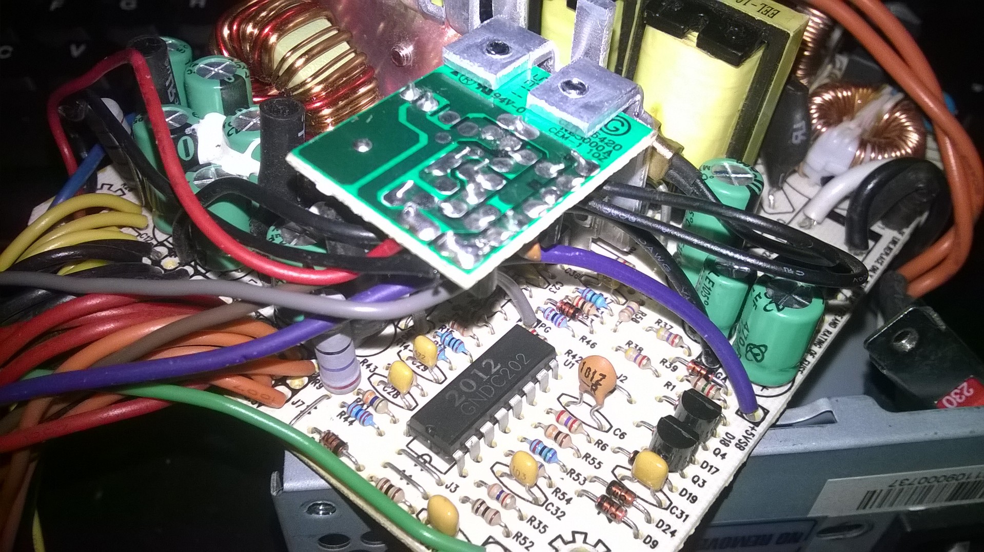

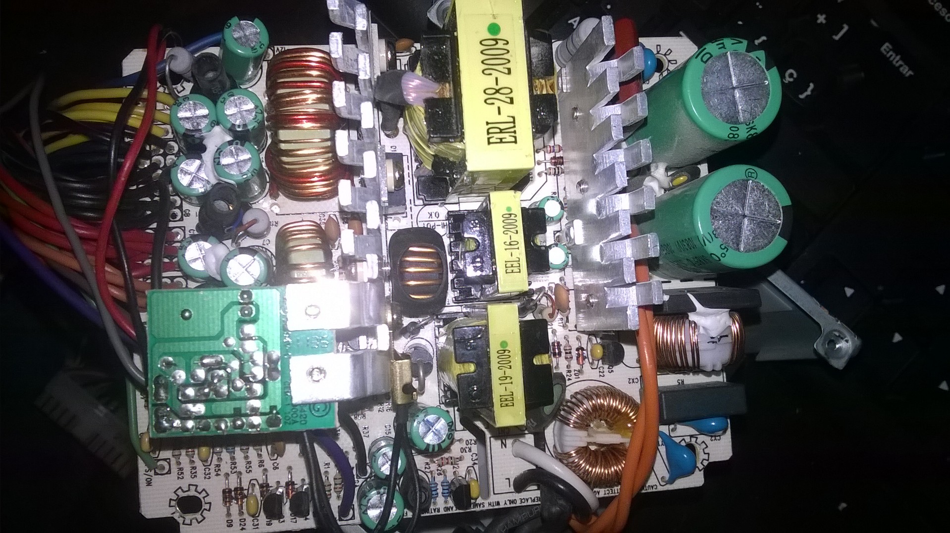

    Hi. Greetings from Argentina.
    I'm having trouble with this PSU that was given to me. Previous owner discarded it without repair attempt.
    I'm very new to PSU repair but have knowledge in electronics.
    The PSU only has +5vsb and does not turn on when PS_ON is grounded.
    I've checked every major capacitor with a capmeter, but I have no means to measure ESR. All caps measured good. Their brand is ANODIA.
    PSU has 3 NPN Power Transistors that are good and 3 diodes at the output that are good.
    All other diodes in the board measured good. All resistors measured good too.
    I'm starting to think that maybe the PWM chip is dead, but as I have no experience with PSUs I'm in doubt.
    PWM chip is "2012 GND202" and googling I've found this PSU is made by Solytech.
    I'm lost!!. Any help would be greately appreciated.

      5vsb working is a good sign. Here is what I would do.
      Fuse is OK or you would not have 5vsb. check the 115V/230V switch on the back of the power supply. If you are using 115VAC and the switch is in the 230V position, that could cause your problem. Measure the DC voltage across each of the two main input capacitors. Should be 160 volts across each one.
      Next, if you have an oscilloscope, look at the output signals on the 2012 pwm chip. If they are present when you short PS_ON, the pwm chip is probably OK. At that point I would suspect the two 945 driver transistors. Attached is a schematic of the 2012 chip. This power supply is made by L&C/Solytech/Allied using the "chip of the year" series of pwm chips. I have seen several Allied power supplies using the Anodia brand capacitors.

        No. No fan twitch. Not a single spike of output. Always flat.
        I have an oscilloscope. Will check with datasheet and report back.
        What are the possibilities for the PWM chip to die?. Is it a common culript?
        Other component I'd left unchecked is the optocoupler.
        Cheers

          These are the measures from 2012 chip:
          Pin 1: VCC : 1.551v (is this good?)
          Pin 2: PS_ON 0.2v (shorted to gnd with a wire)
          Pin 3: V3.3: 0.3v
          Pin 4: V5 : 0.2v
          Pin 5: PP: 0.18v
          Pin 6: PG_IN: 0.1v
          Pin 7: O1: 1.517v DC (checked with the scope)
          Pin 8: O2: 1.516v DC (checked with the scope)
          Pin 9: PG: 0.1v
          Pin 10: FB: 0.6v
          Pin 11: VREF: 0.2v
          Pin 12: GND
          Pin 13: COMP: 0.205v
          Pin 14: NEG: 0.107v
          Pin 15: SS: 0v
          Pin 16: RI: 0.38v
          Question: Pin 1 VCC shoudn't be 1.5v?
          Cheers

              Well. After checking Pin 1 traces, I've discovered it takes supply from 5vsb thru a 10 ohm resistor and a 10pf cap in parallel.
              This cap was shot. After removing and replacing the bad guy, VCC raised to 4.8 volts and now the PSU is alive and kicking!.
              Now I will consider replacing all capacitors, just in case.

                It is 220watt right? What caps are there? Look pretty small, I guess about 1000 uF.

                    Yes it's 220W, but I doubt it will reach that power. Right now it's powering a new AM1 motherboard with an Athlon 5350 (25WTDP), and a single hard disk, and it gets pretty warm. The fan starts quietly but after a few minutes it starts to be noticeable.
                    Caps are: 2 x 330uF x 200V
