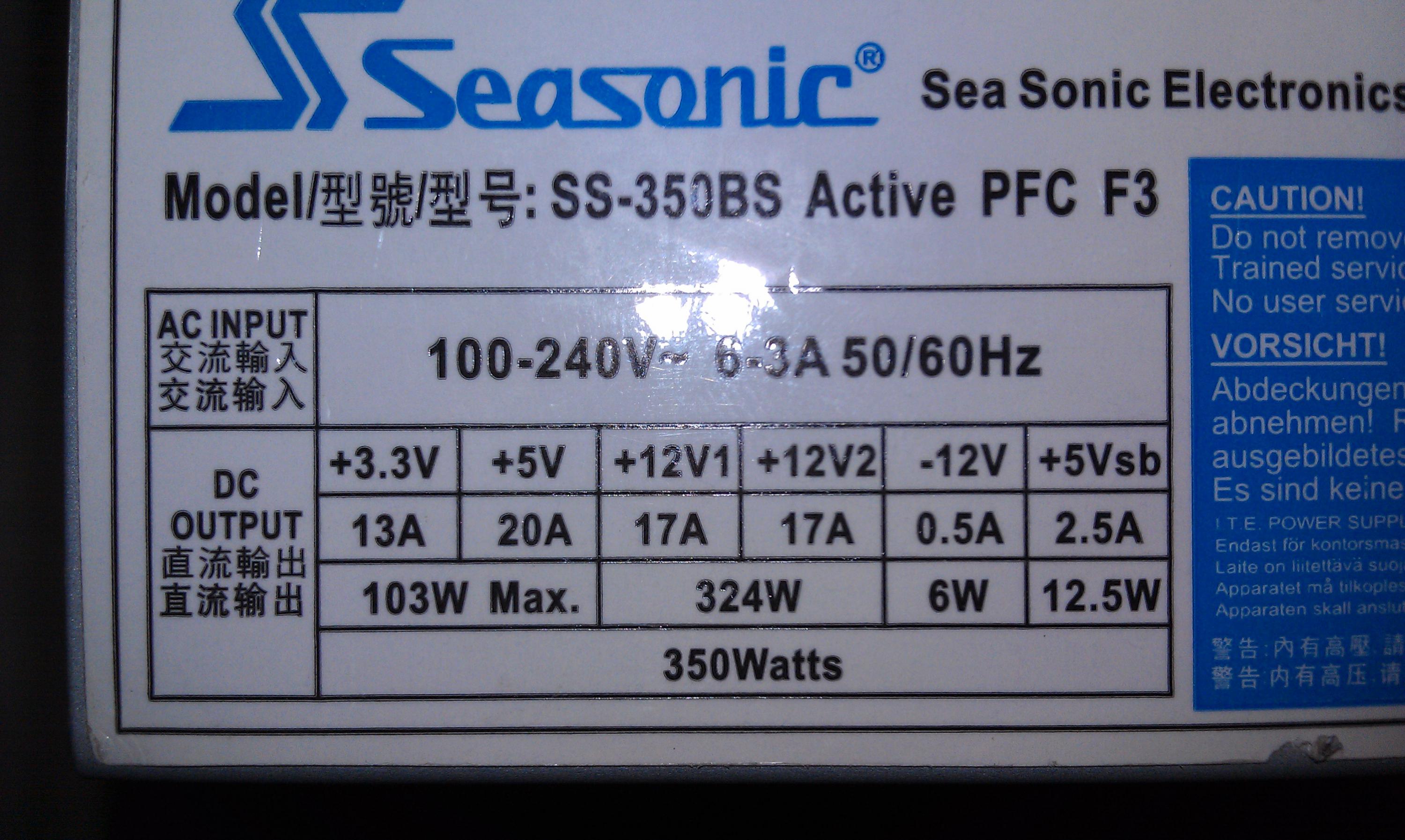

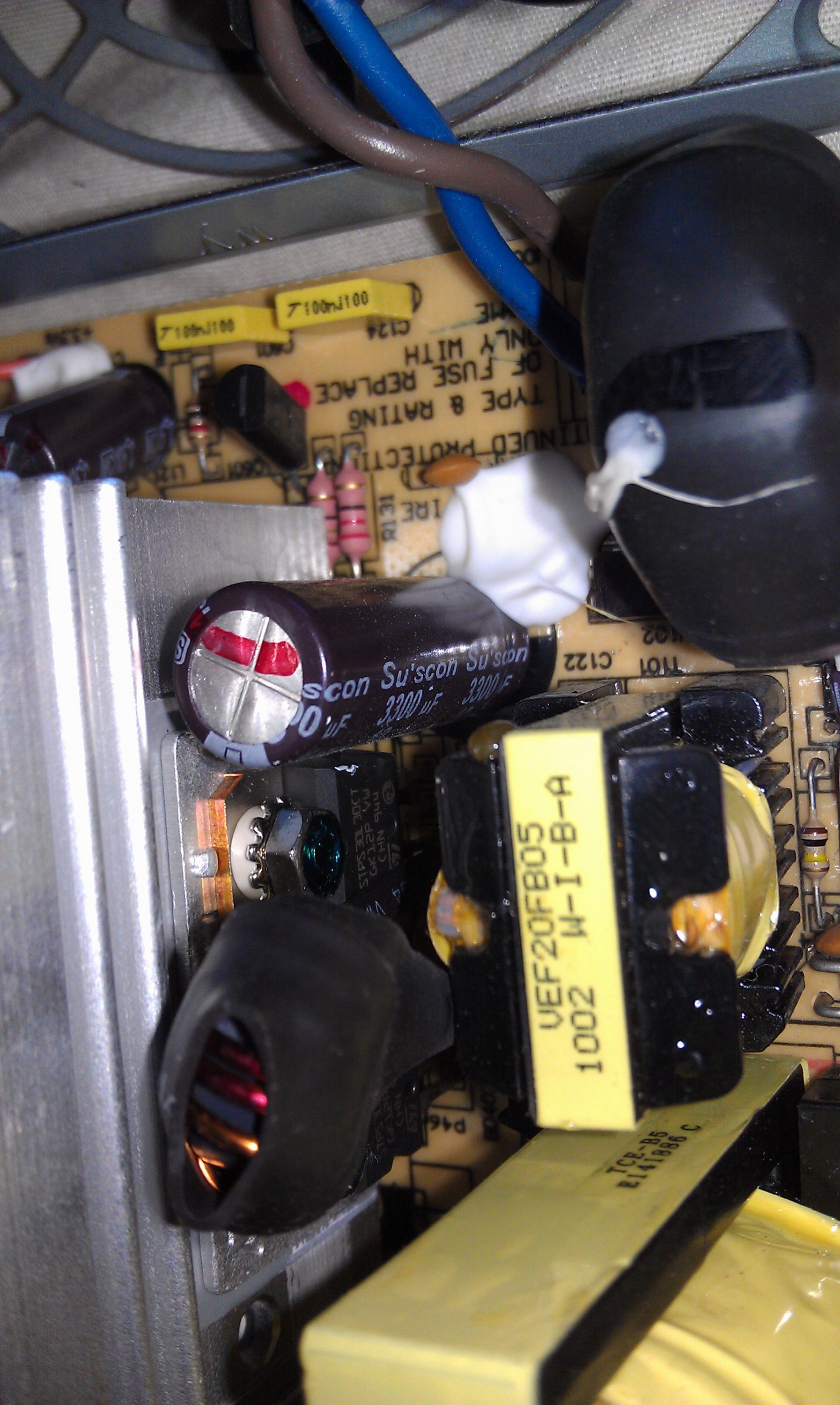

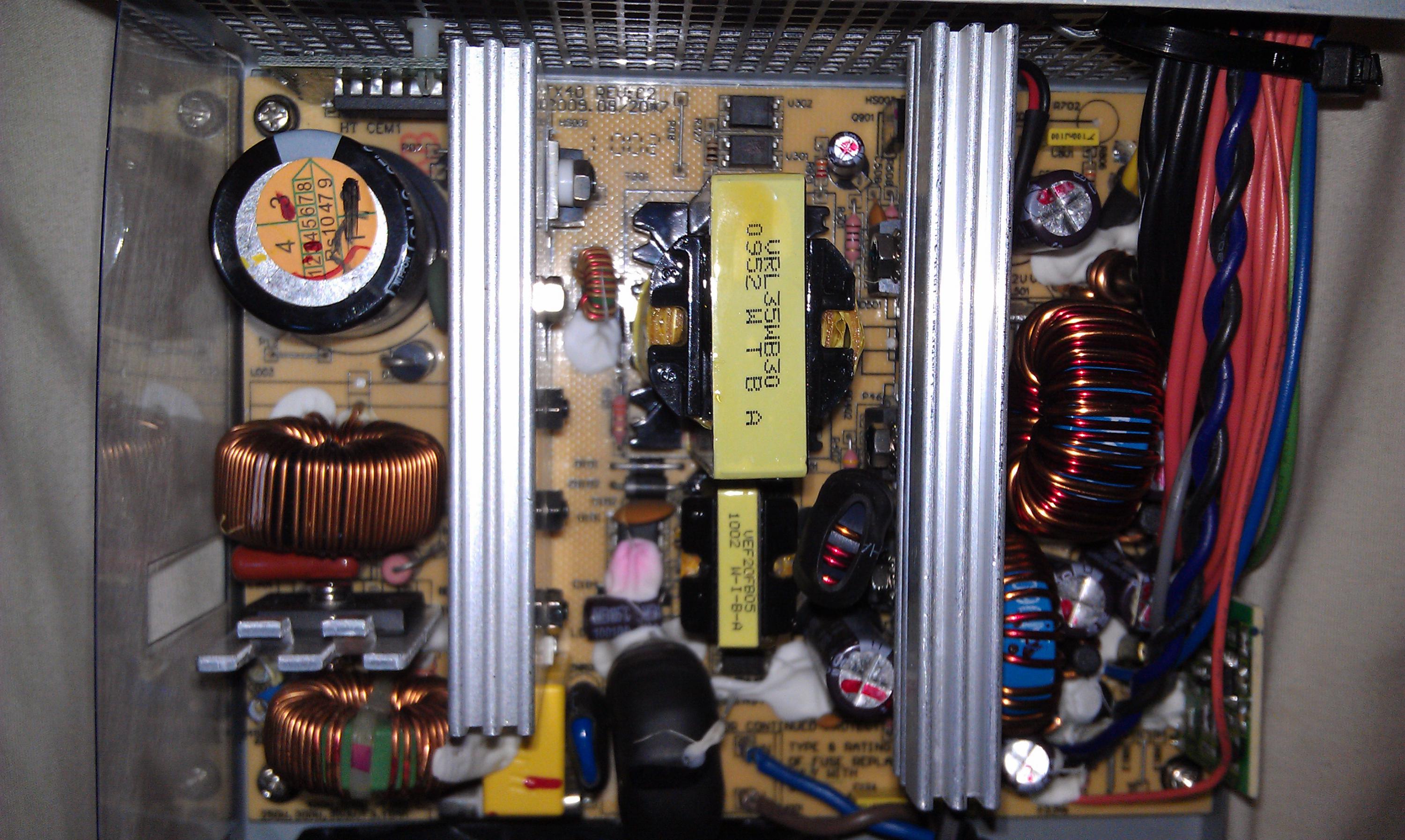

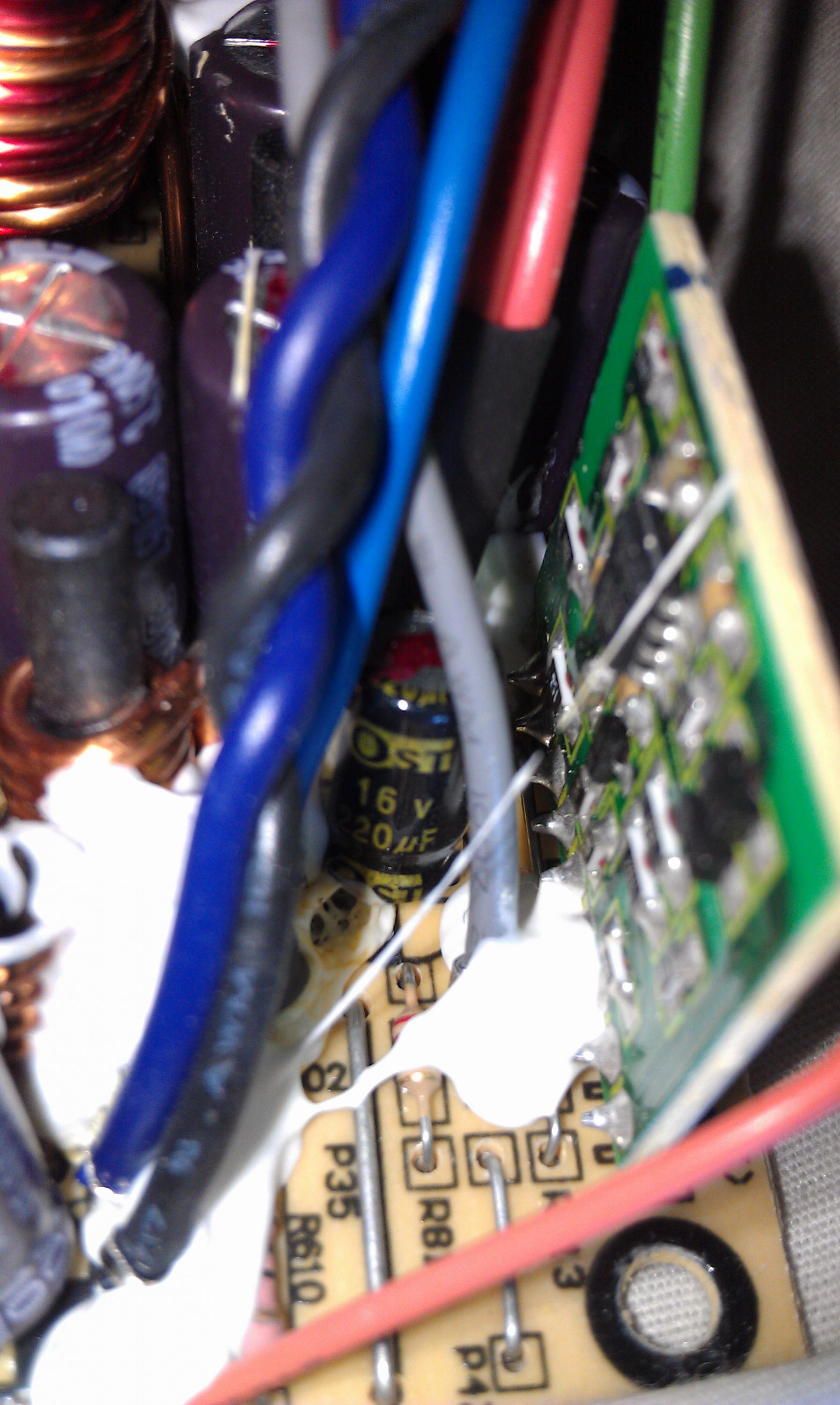

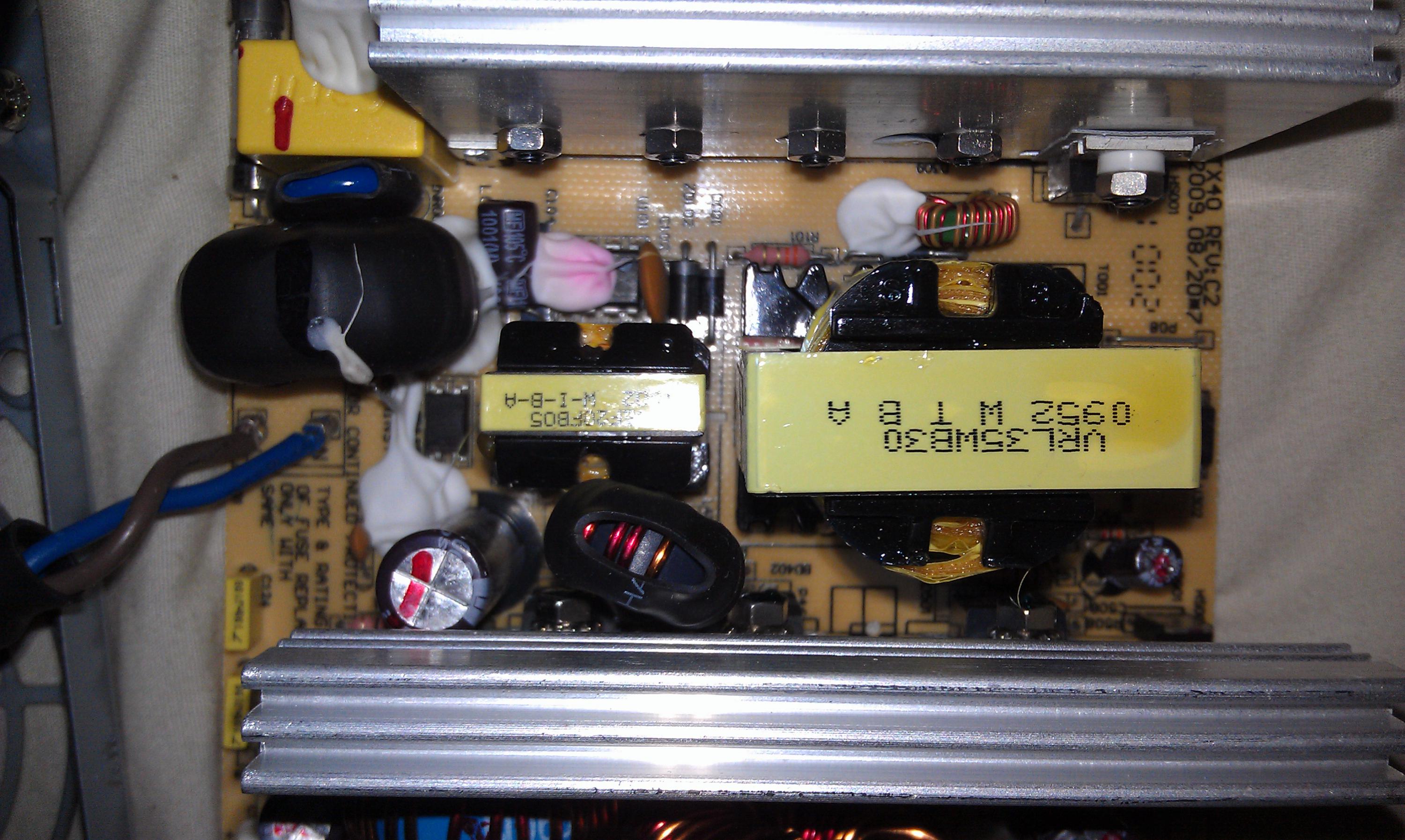

    Just got this 350w power supply off ebay for a Athlon 64 x2 build I was planning, and was wondering what you guys thought. I don't know much about power supply's, but I do know it's full of su'scon crap caps and one lone ost. The heatsinks seem a little wimpy as well. Although I installed it in a Pentium 4 3.06ghz machine and ran prime95 for 3 hours, and it didn't heat up much at all. I thought Seasonic were supposed to make good psu's? Just wasn't expecting to see such bad capacitors in there. Here are some pics i took of it let me know what you think. Thanks in advance

    The su'scon and ost are naturally not excellent capacitors but the power supply is well cooled and there's a lot of space around the essential capacitors for airflow. You can replace them if you want with panasonic or nichicon or united chemi con, I personally would't.
    The heatsinks are adequate and you said it yourself that it didn't heat much so the capacitors won't be under lots of heat stress.

      Thanks mariushm for taking the time to reply. Do you think it will do the rated wattage? The reason I ask is the system it's going into will probably pull around 220w full load. Will those caps last under those conditions, or would I be better off recapping it?

        Yes, it will do the rated wattage. 220w will not be 24/7 so for a few hours a day while you're gaming it should still be fine.
        If you want to be absolutely sure, I'd suggest replacing the capacitors with Panasonic FR or United Chemi Con KZE, these are two series of capacitors that are reliable and with good lifetime rating.

            To be 80 plus certified, the unit must be able to do full power, so no worries there. The heatsinks are smaller due to the units high efficiency. Like mariushm said there is room for airflow and this is a good design. It doesn't help that the caps are pushing 6 years old though. I have seen ost fail in this platform, usually on the 5vsb. So i would definitely periodically check those caps.

                Yeah, you mainly just have to watch the ones on the 5vsb and 12v. I'd let the machine run 24/7 to help keep the 5vsb caps cool. Computers in off or standby mode wear out those caps faster.

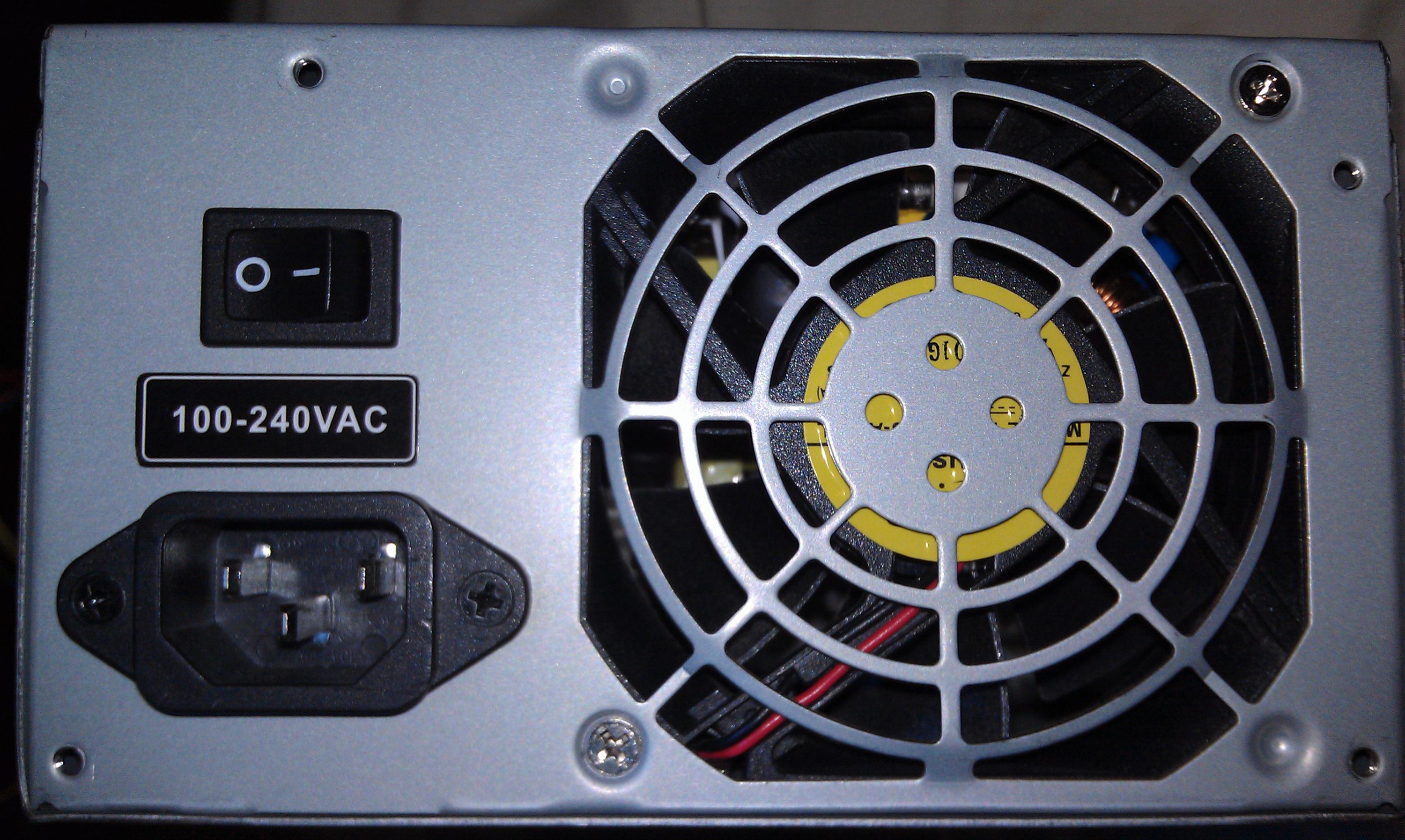

                                    Oh, thanks for that clarification stj. So basically the power supply is in standby waiting for the motherboard to send the power on signal? If the power supply has a switch in back would turning that off keep the psu from being in standby?
                                      • 31169
                                      Re: Seasonic SS-350BS
                                      that would work, but a lot of psu's dont even have a switch anymore!
                                      • electromaster84
                                        • Jul 2015
                                        • 35
                                        This unit does have a switch in back, so I think I'll just switch it off when powered down.
