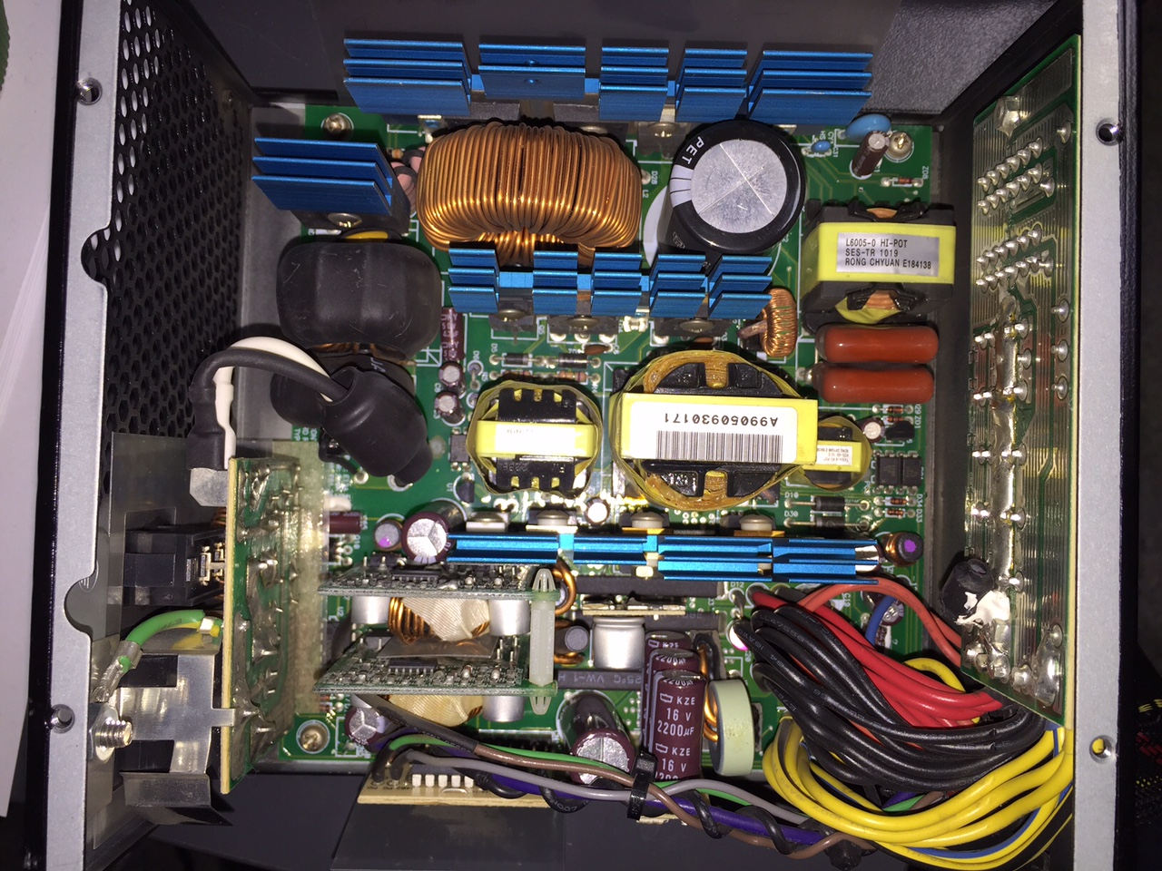

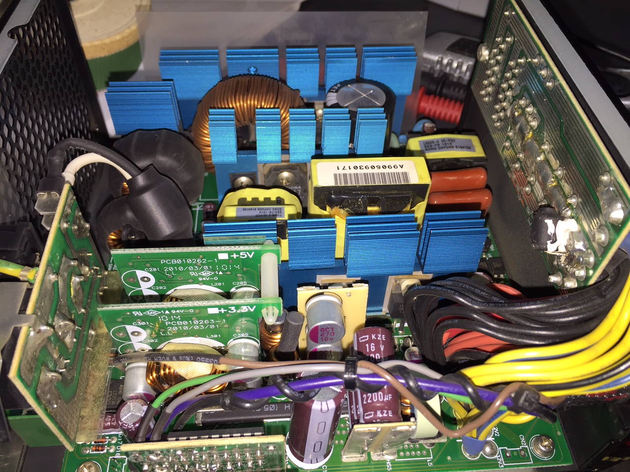

    One of many Enermax units which are not turning on and with which I had no luck so far. This time the fan does not even twist, I got absolutely nothing when grounding PWR_On. Which is OK at 3 V and stand-by has full stable 5 V.
    It is resonant topology with CM6901. Found no shorted silicon, caps are all japanese. Soldering is quite messy but I checked few suspicious SMD components and they all seem OK. I am lost here…

                I don't think you will succeed - because of the same reason we cannot reapir that. Too many protection and feedback circuits, it is too complicated. Also it is resonant unit so both sides heavily depend on each other for it to work, and it has limited window of parameters where it works OK so I think increasing voltage would not be possible much.
