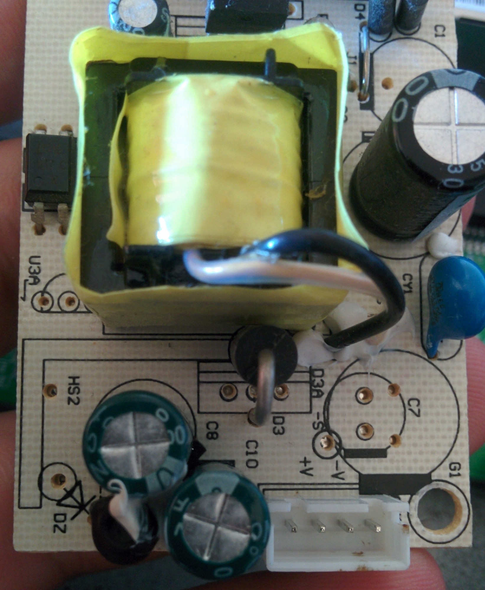

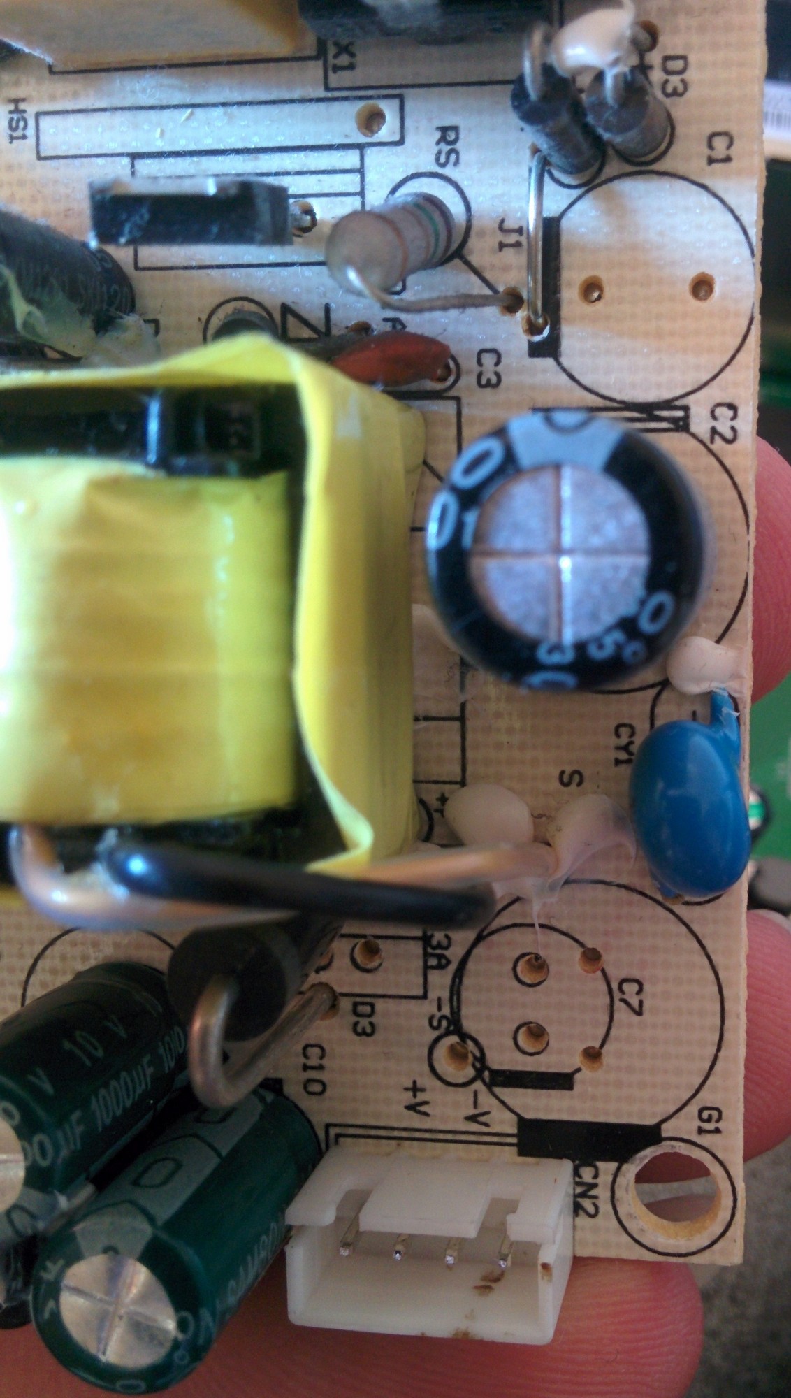

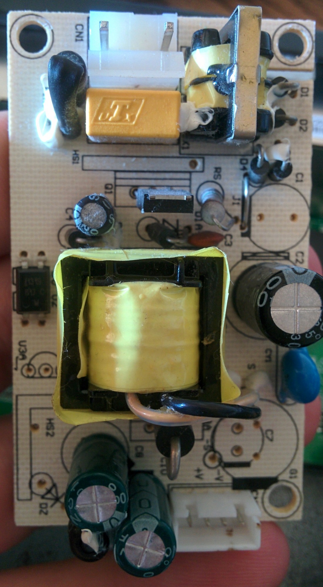

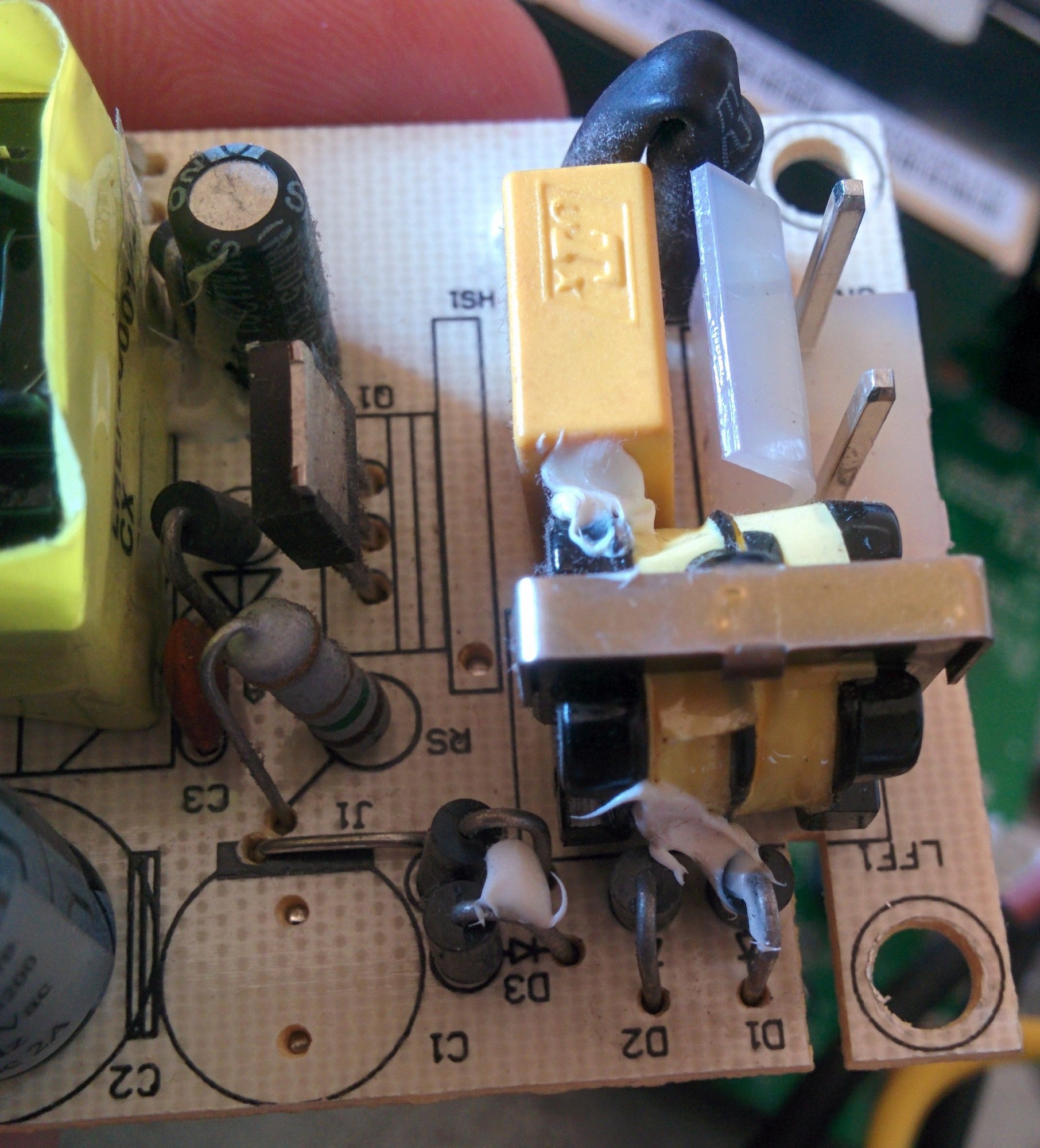

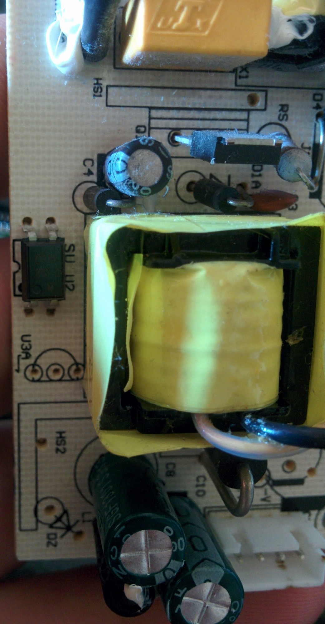

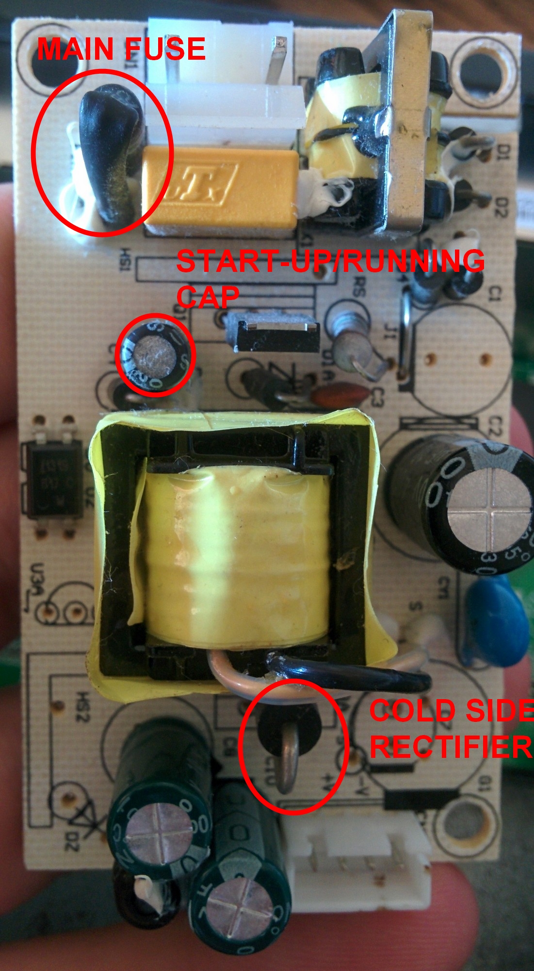

    Hi there
    A friend of mine gave me this device because it wasn't working anymore.
    Its a 16 port switch with an integrated power supply board.
    I checked the output and it shows 0V. Caps look in good shape. So i wanted to ask what could be the most probable component to have failed in here.
    Here you have some pictures of the power supply board.
    Output are the 4 pins at the bottom they are shorted in couples GG ++
    Re: Zyxel gs 1100-16 power supply is dead

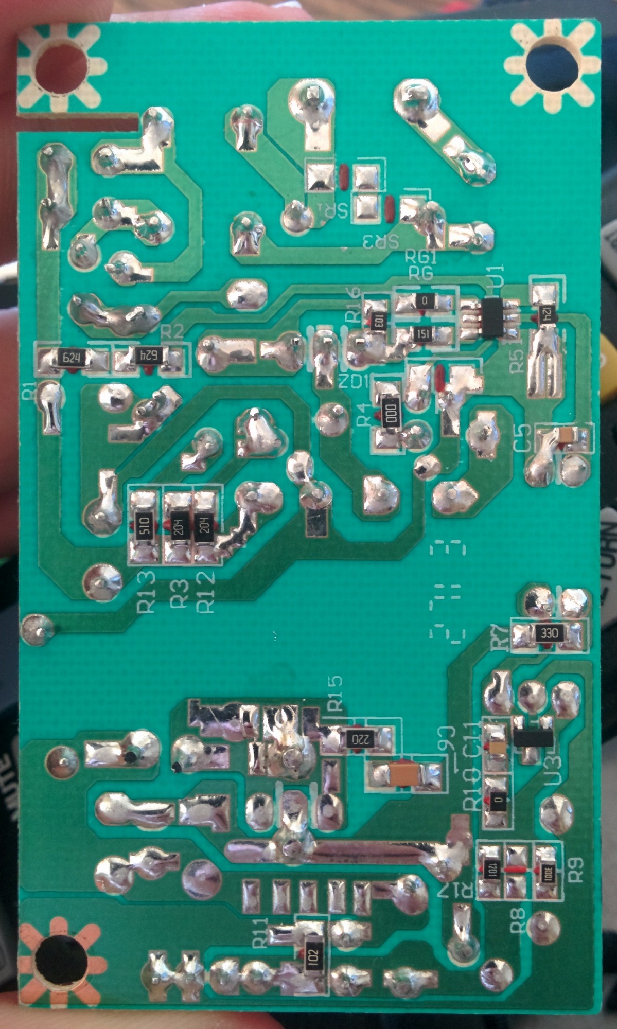

    Check the main fuse, the startup/running cap capacitance and ESR (if in doubt, just replace it), the cold side rectifier.
    BTW, there is 6-pin SMD SMPS IC which will be difficult to indentify.

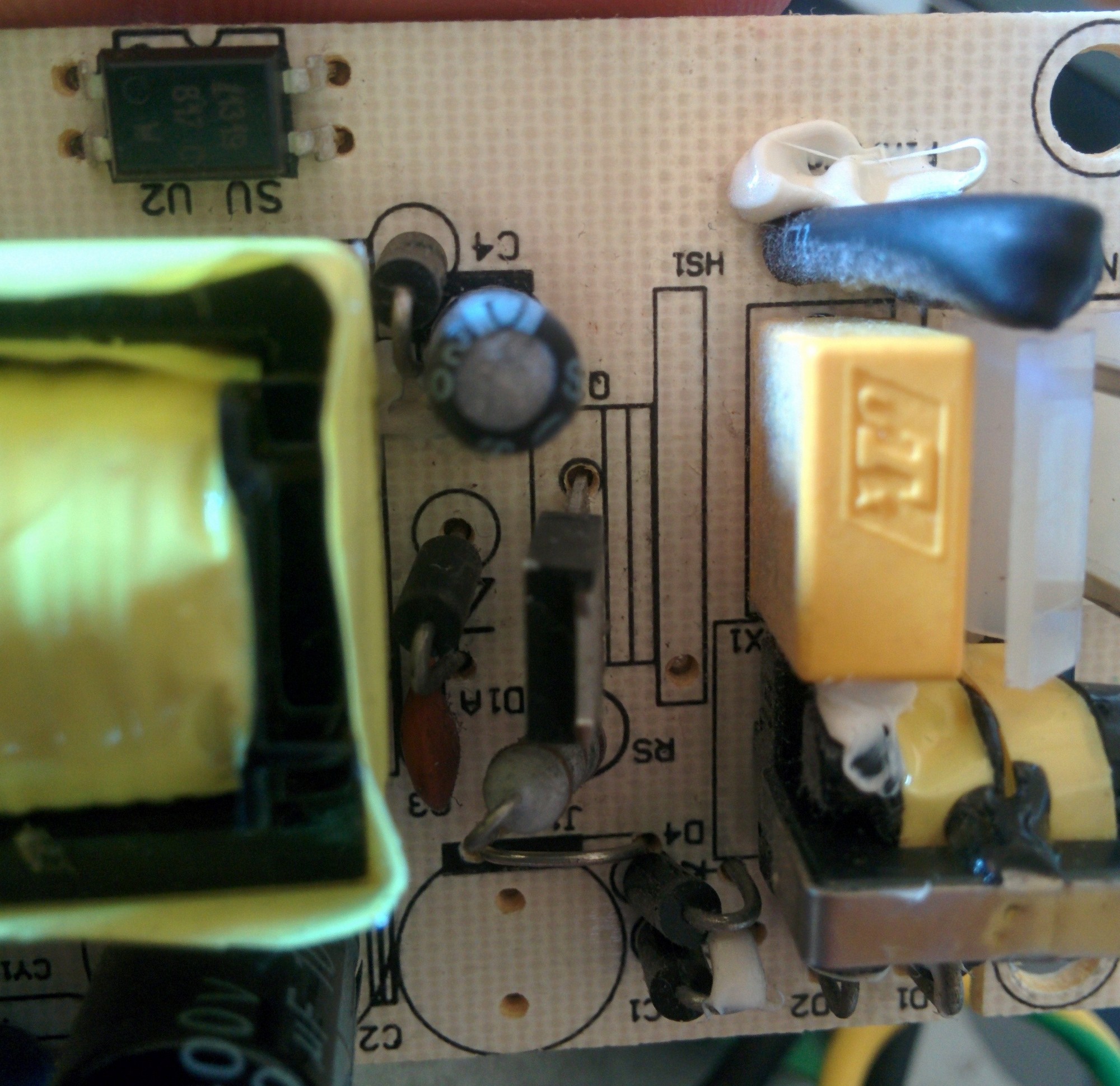

        what's the specs of c4?
        • Pentium4
          CapXon Be Gone
          • Sep 2011
          • 3741
          Is voltage getting through to the input cap? Check the switcher too while you're at it
          • badele
            • Mar 2014
            • 14
            • italy

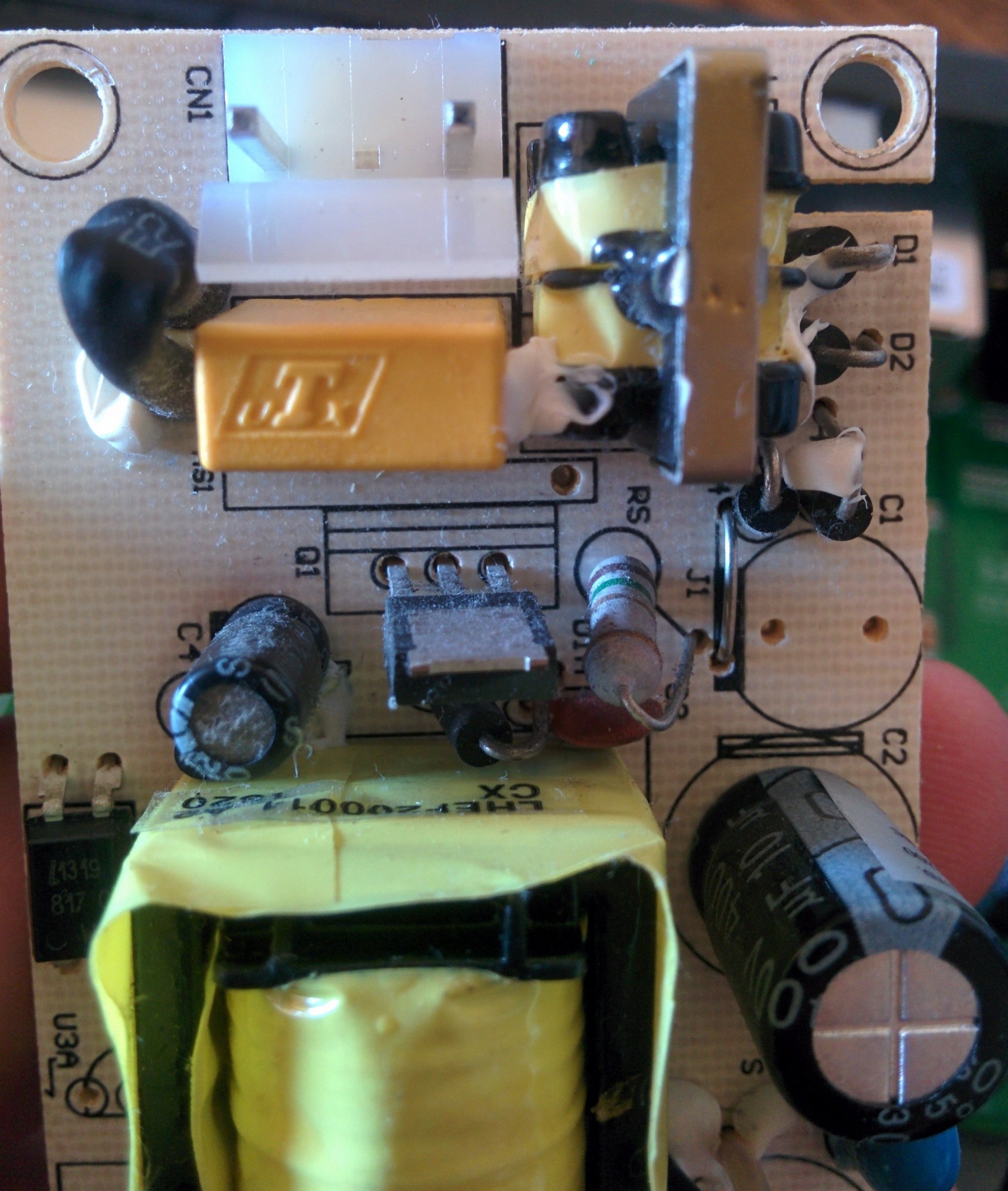

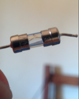

            So it was the most probable component. Fuse 1A 250v was blown. Shorted the pins for a moment an got 3.5V as output. Thanks everyone for the fast replies.
            One last question do i have to replace it with a fast or slow blow one? The package has no information about what kind of fuse this is.
            here is a pic too
              • 31058
              that should have "F" or "T" embossed on it.
              • badele
                • Mar 2014
                • 14
                • italy
                thats the problem , it has neither F neither T
                On one side it says 1A250V
                on the other it a 3D and some circles
                • Pentium4
                  CapXon Be Gone
                  • Sep 2011
                  • 3741
                  I'd guess F
                    • 31058
                    F is safest when in doubt.
                    • badele
                      • Mar 2014
                      • 14
                      • italy
                      ok thanks, just ordered it.

                        You can replace the caps while at it, output seem like Samxon GF? Those are bad series from Xamson, prone to fail. What is the rest?
