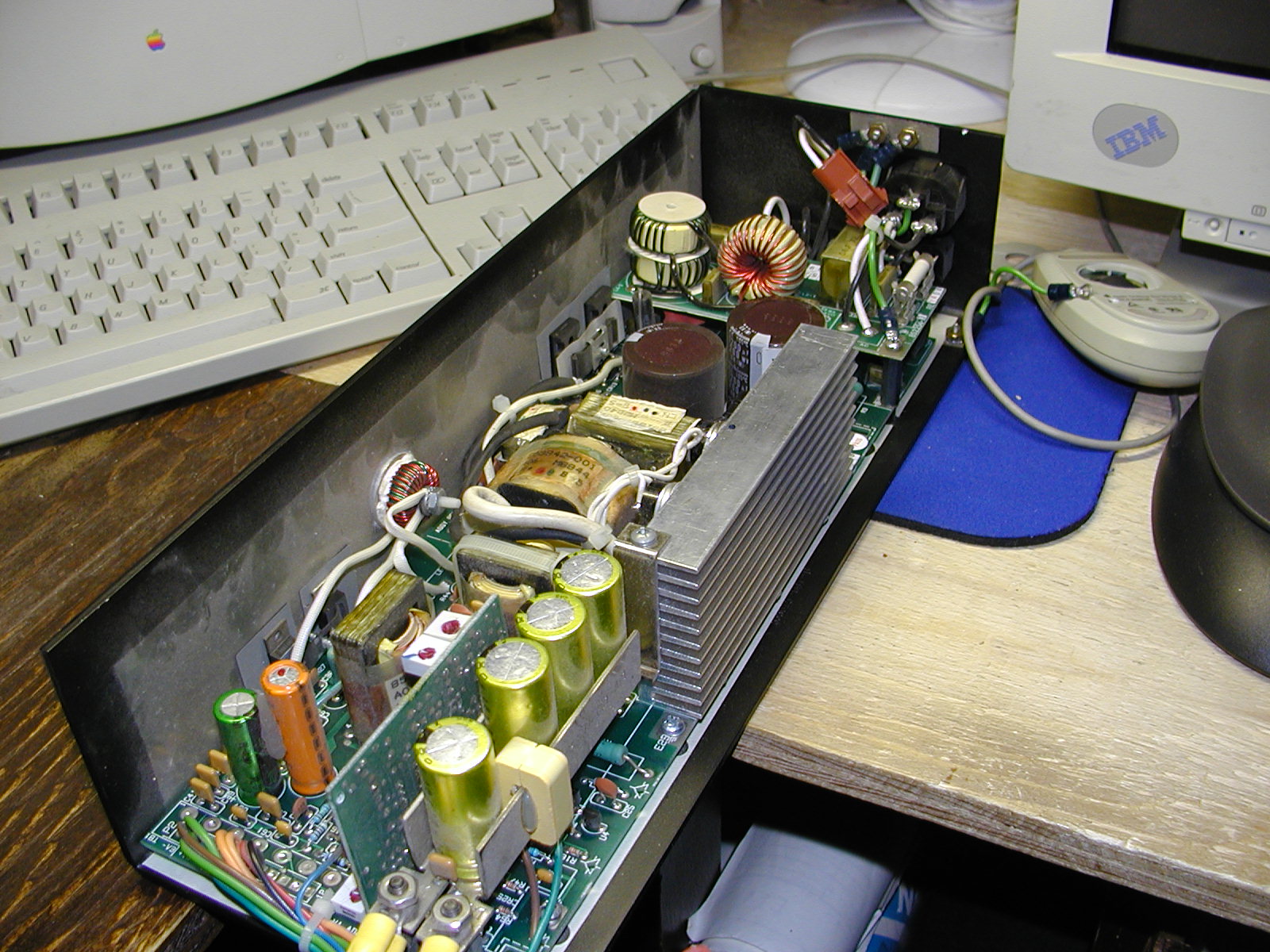

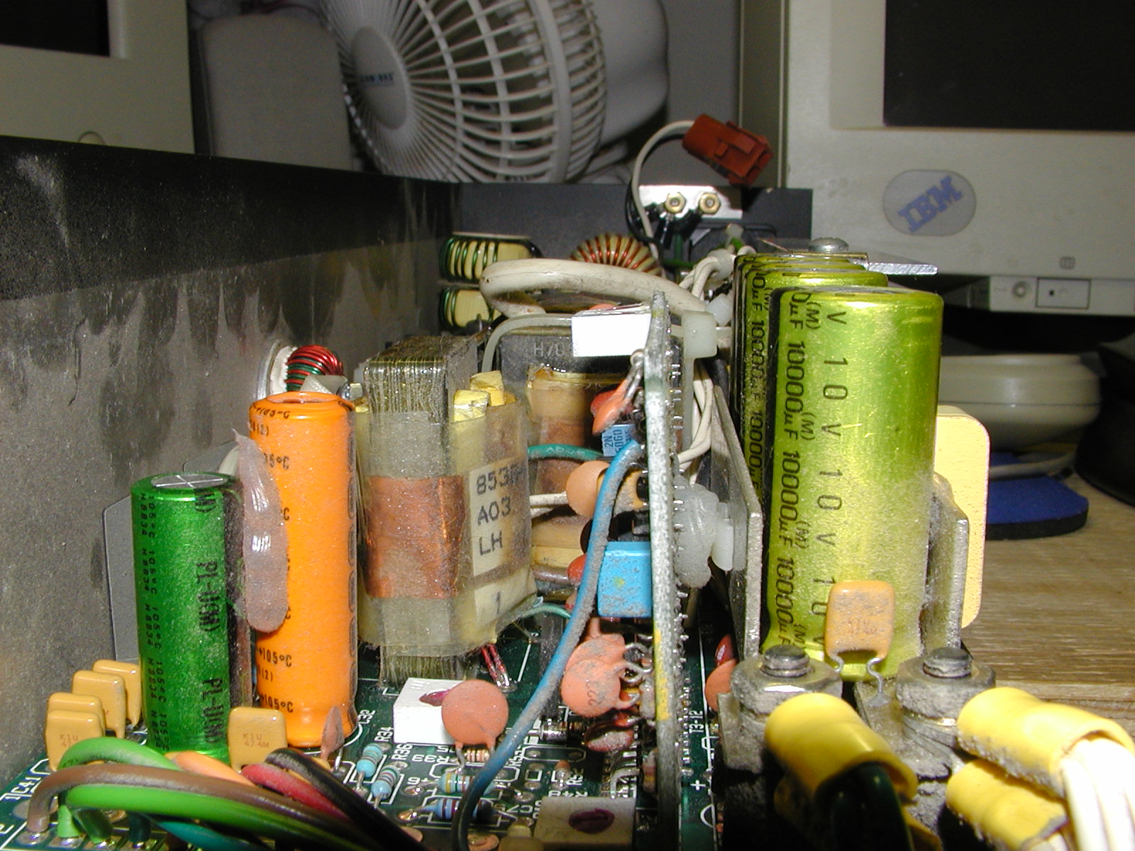

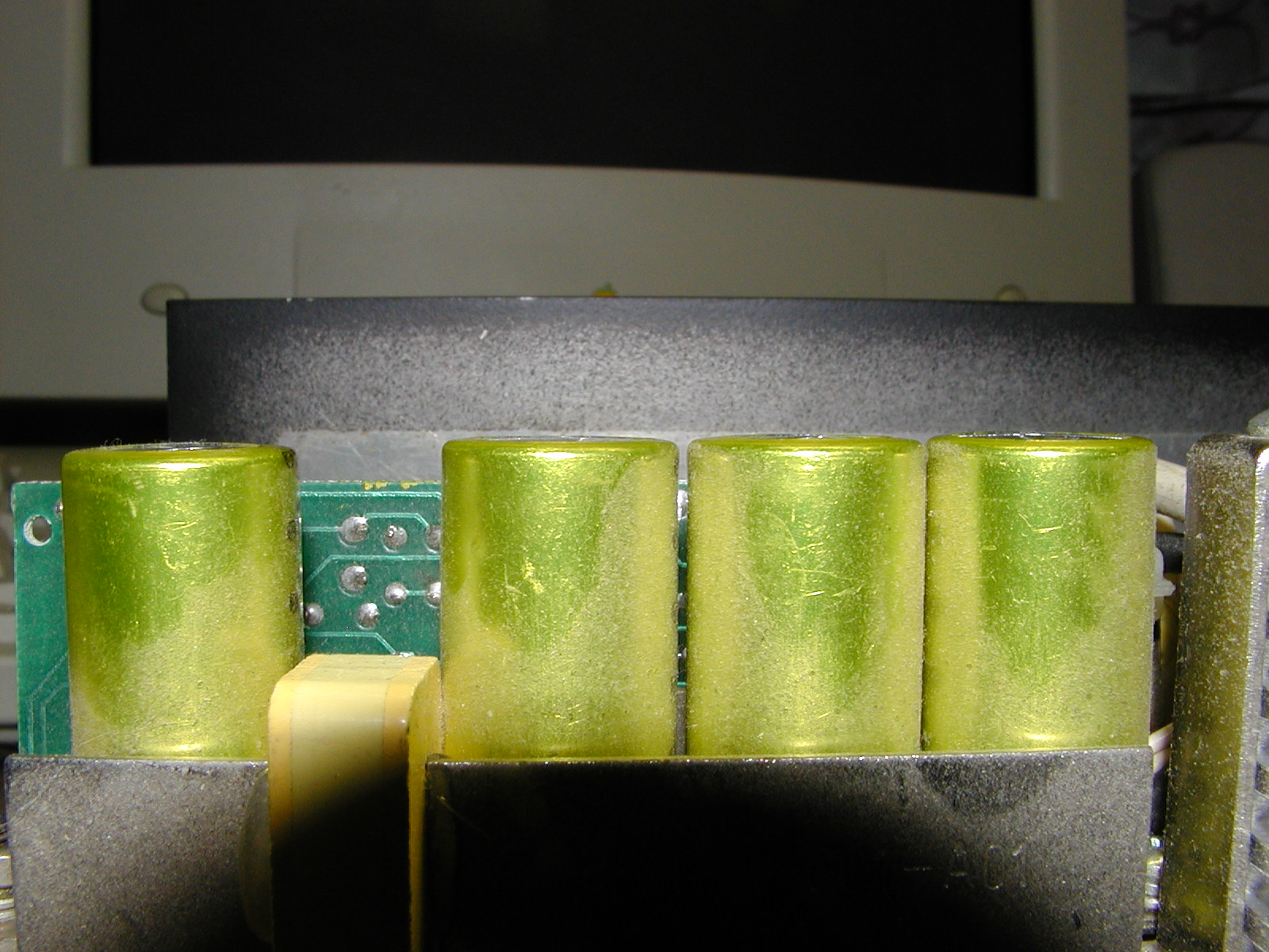

    Inside my personal Iris is this beast of a power supply.
    While output voltages are normal I have reason to believe that the lines are very noisy and it's interfering with the scsi controller.

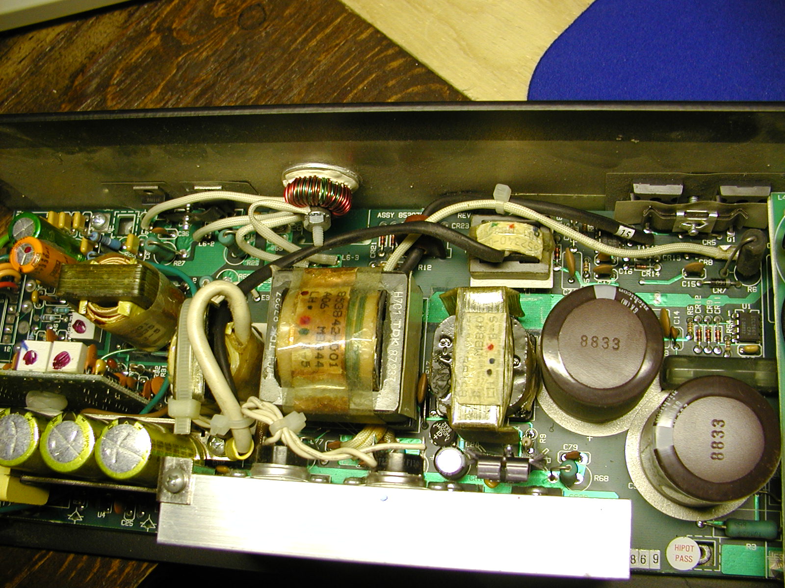

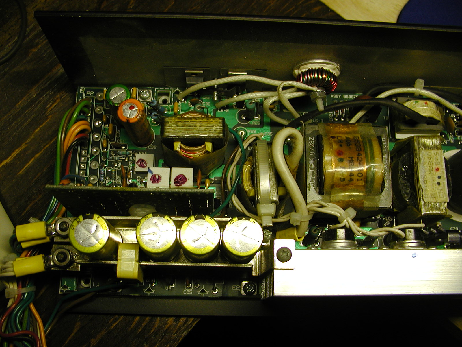

    From my view, only one of the yellow Elna caps look bulged but it's hard to say as I have never worked with this kind of power supply and I can't test the system using a regular ATX PSU since I don't have anything that can output the juice this gives out. The system worked fine...before it was put into storage for six/seven years.

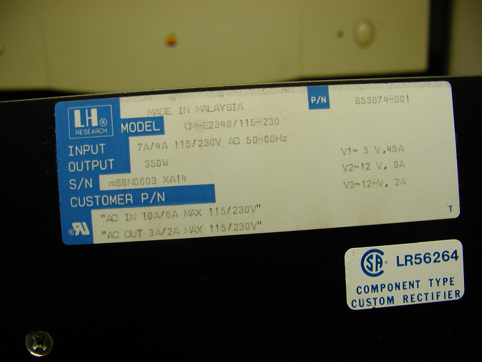

    That P/S may have an interesting history. The large I/P lytics are mid-1988 vintage. OTOH, those low ESR Elnas and that one low ESR UCC (bright orange, probably RX or RXA series) are mid-80s vintage. I wonder if the P/S was built in the mid-80s and repaired/upgraded in the late 80s. Regardless, 19+ years old is pretty old for lytics.

      According to the stamp on the case the system was assembled in 1989.
      Some of the older Professional Iris systems use power supplies from the same manufacturer and quite a few of them are starting to get cranky.

        Replace those elna capactors,they are probabaly leaking,they leak just like the old nichicon capactors of the same time.Yes elna capactors are reliable but these series are known to be leakers.
          Re: LH Research PSU faulty?

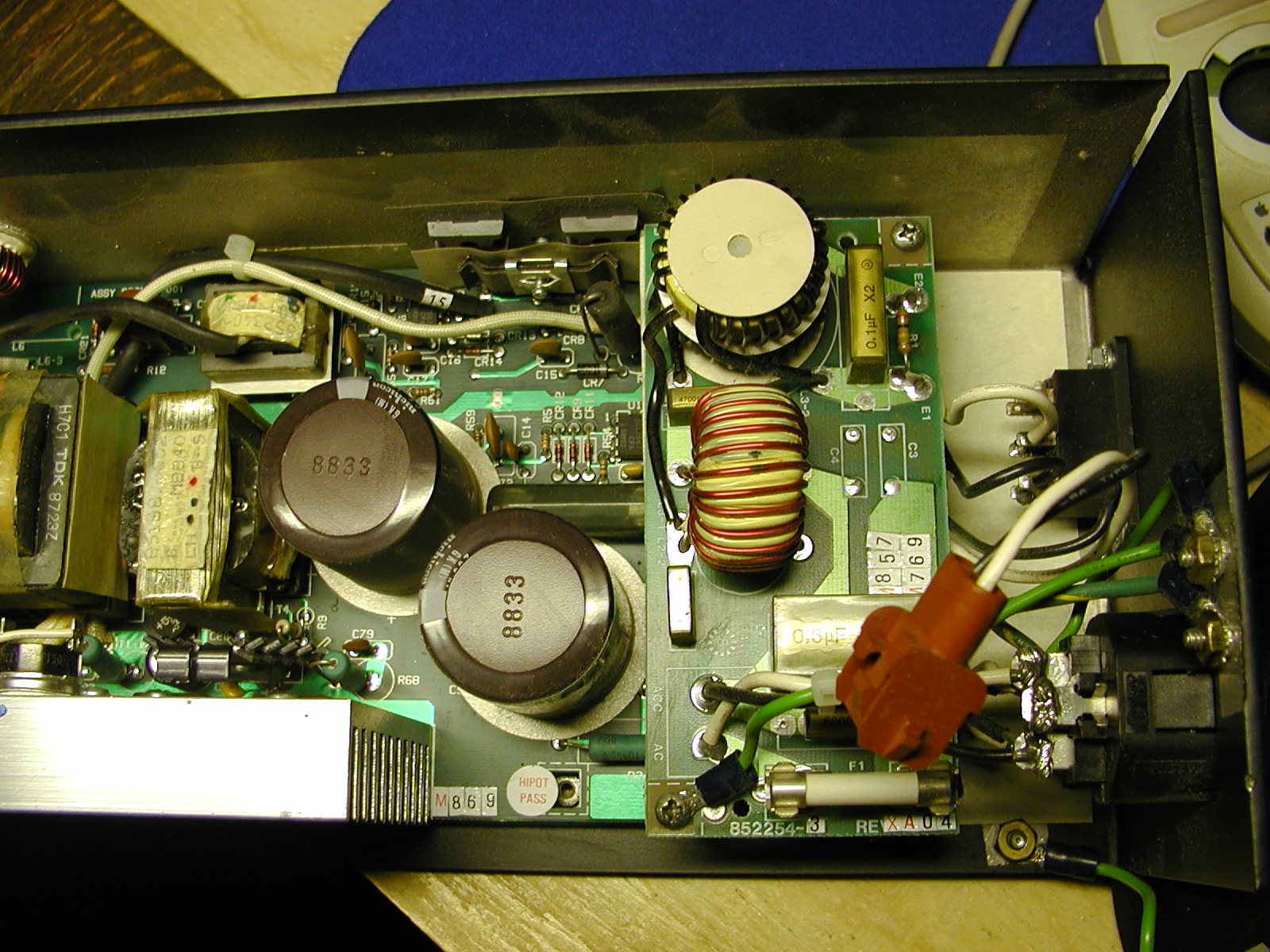

          Oh yes I didn't notice it before but that green nichicon capacitor is also probabaly leaking.It looks like this power supply was made by power one which made good power supplies but these old caps are usually the problem.I have seen these caps leaking in power supplies and certain high end monitors and tv's from 1993 and back.
            I see no traces of leaking but whatever.
            Wow. Tho$e babie$ are $pecial order in the$e part$.
            Can any of the more senior members back up what this newb is telling me?

              I think the message is clear, w/o any ripple or ESR measuring, the only choice is to replace those lytics.
              If you wanna stick to the original style capacitors, then i will be just an expensive repair.
              May be you can fit two 4700uF Samxon GD or GC or any other low esr cap with this capacitance in there.
              This would make it an ugly but reasonably economical repair. From a practical point of view, this would improve ripple beyond the factory value.

                pentium, getting some LXZs or PWs from Digi-Key should work. Modern low Z parts will be better than late 80s vintage low Z parts.

                  those yellow elna's will stink bad when desoldered

                      Tell me about it.............they smell worse than the nichicon caps..lol

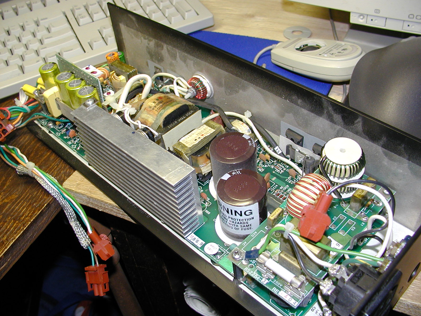

                        Before I do that I think it might be worth a try to adapt a regular ATX power supply to work in the system. It's going to mean I have to tear apart my pc to get a powerful enough PSU but I don't want to get the parts and then find out that it was not the power supply.

                                    Actually I did just try to wire up an ATX power supply and All I got was a fan and no activity from both the monitor or the diagnostics port.
                                    I'm going to have to get a scope. What kind of used scope would you recommend me?
