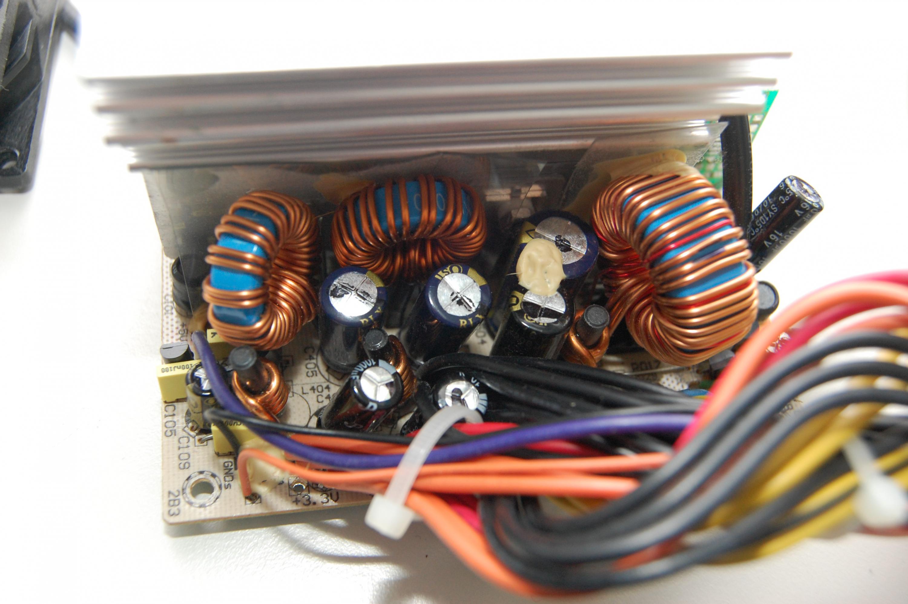

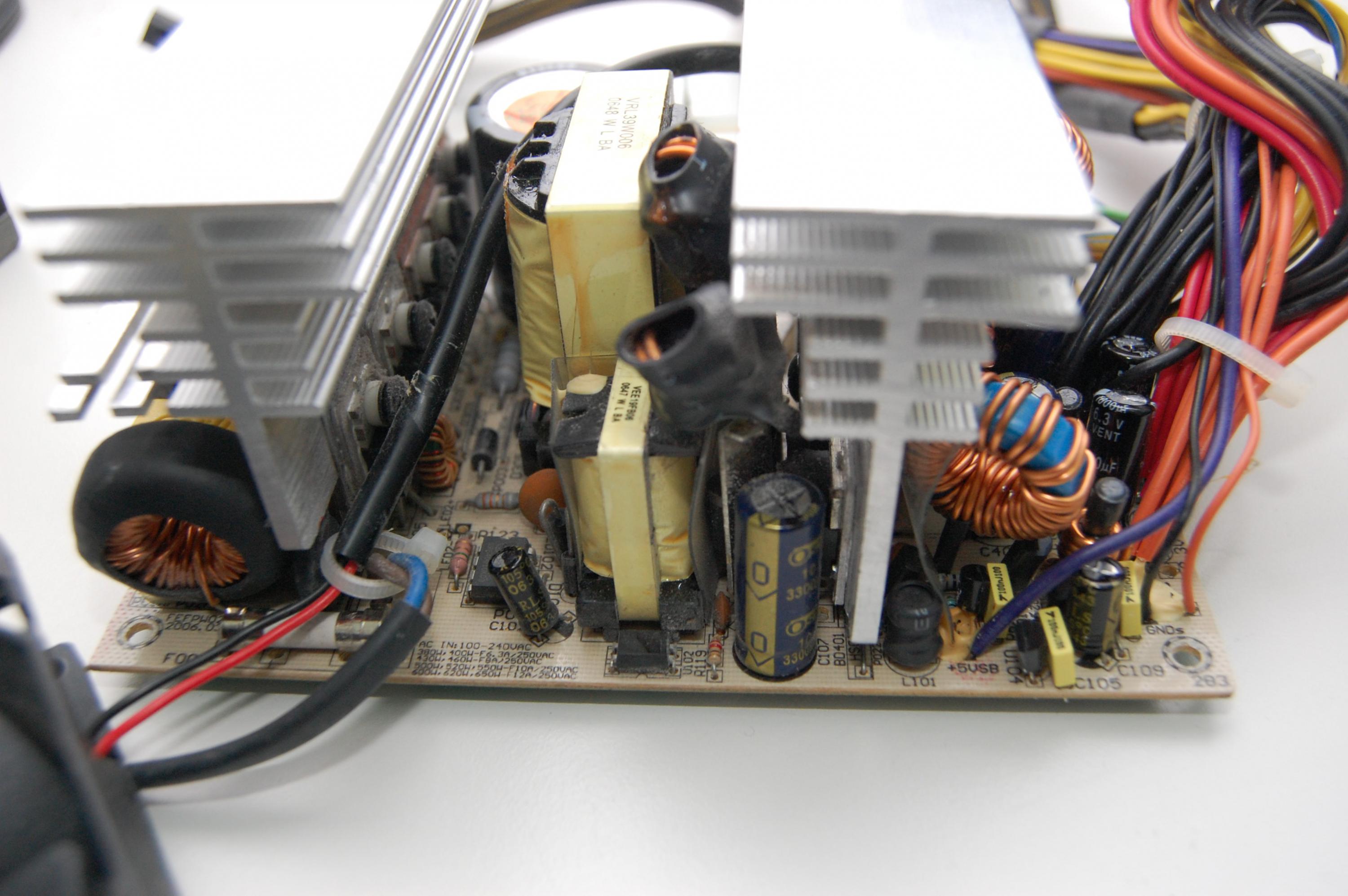

    Re: Antec NEO HE550 Caps replacement

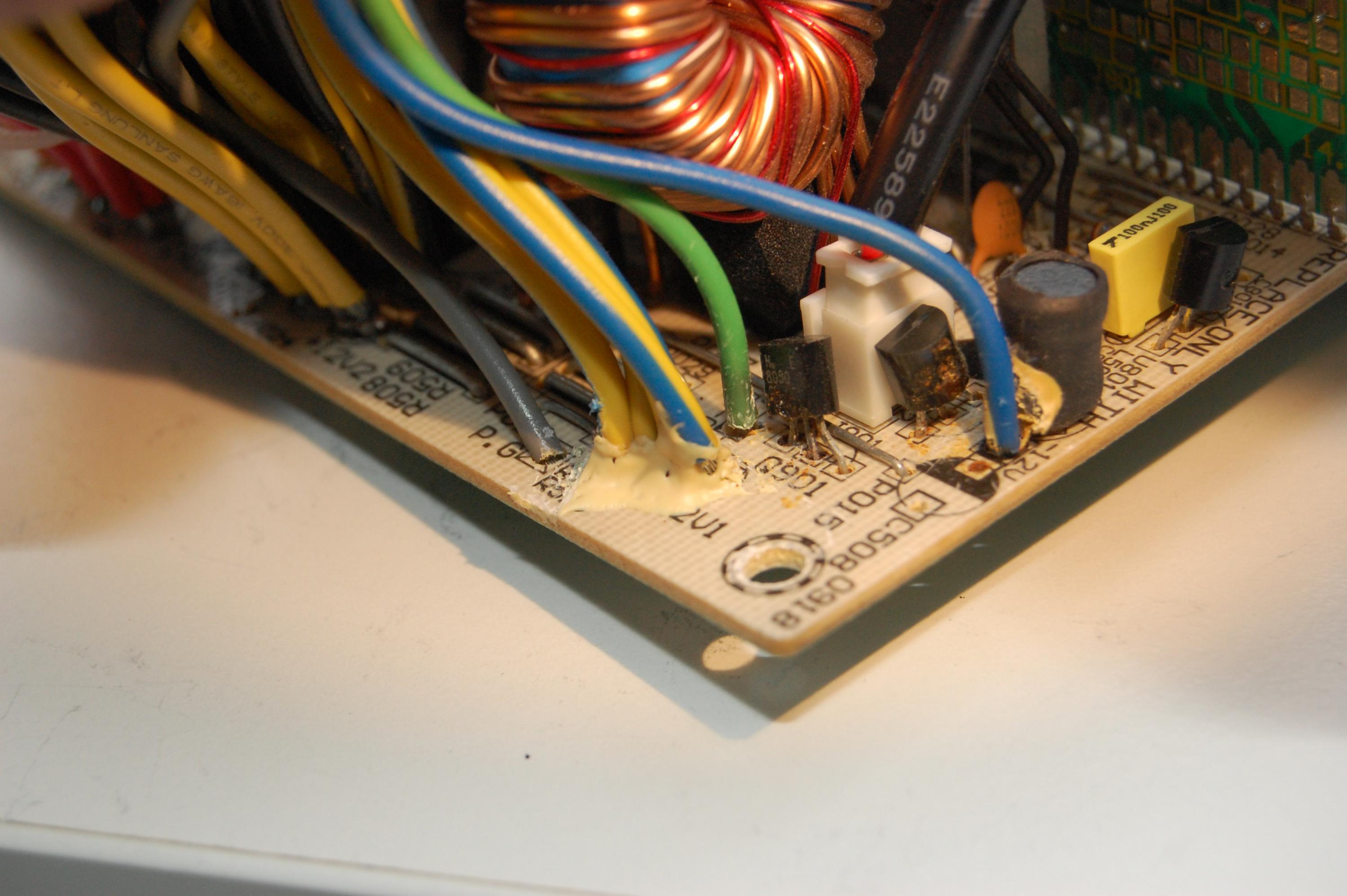

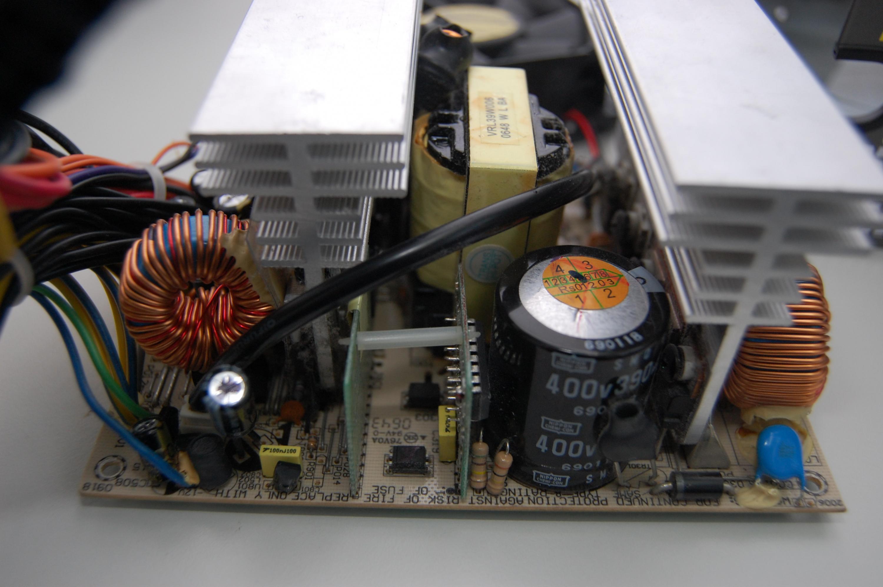

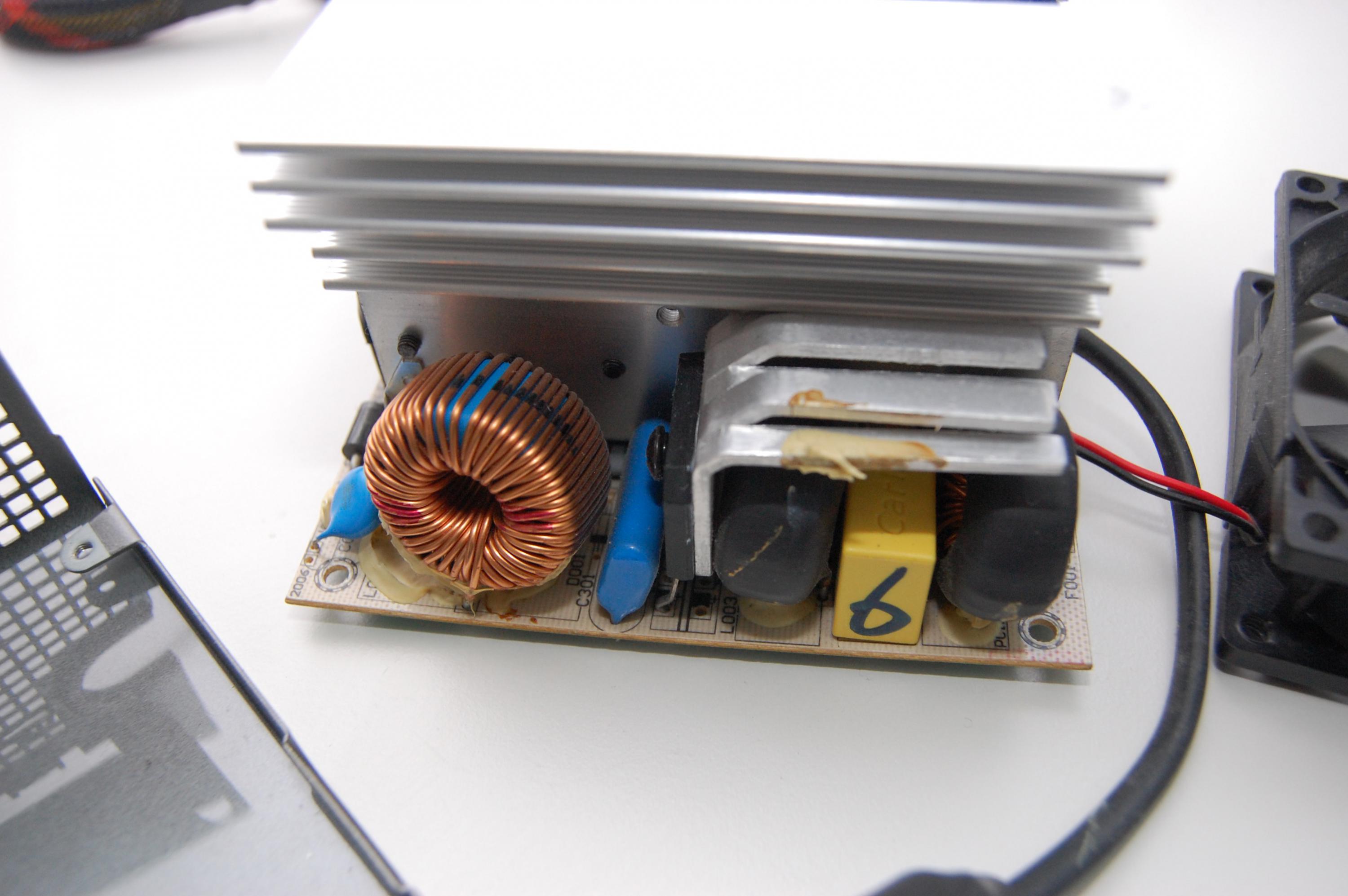

    Here is some pics

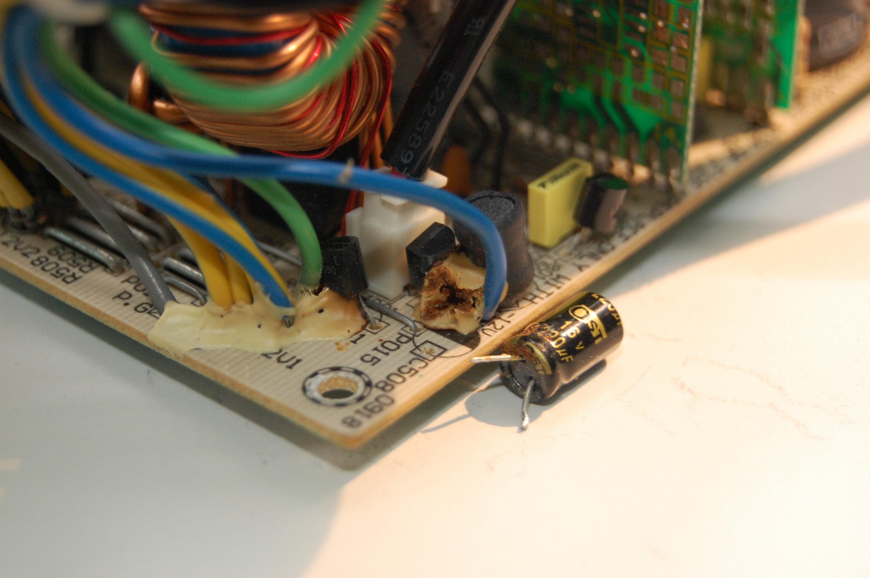

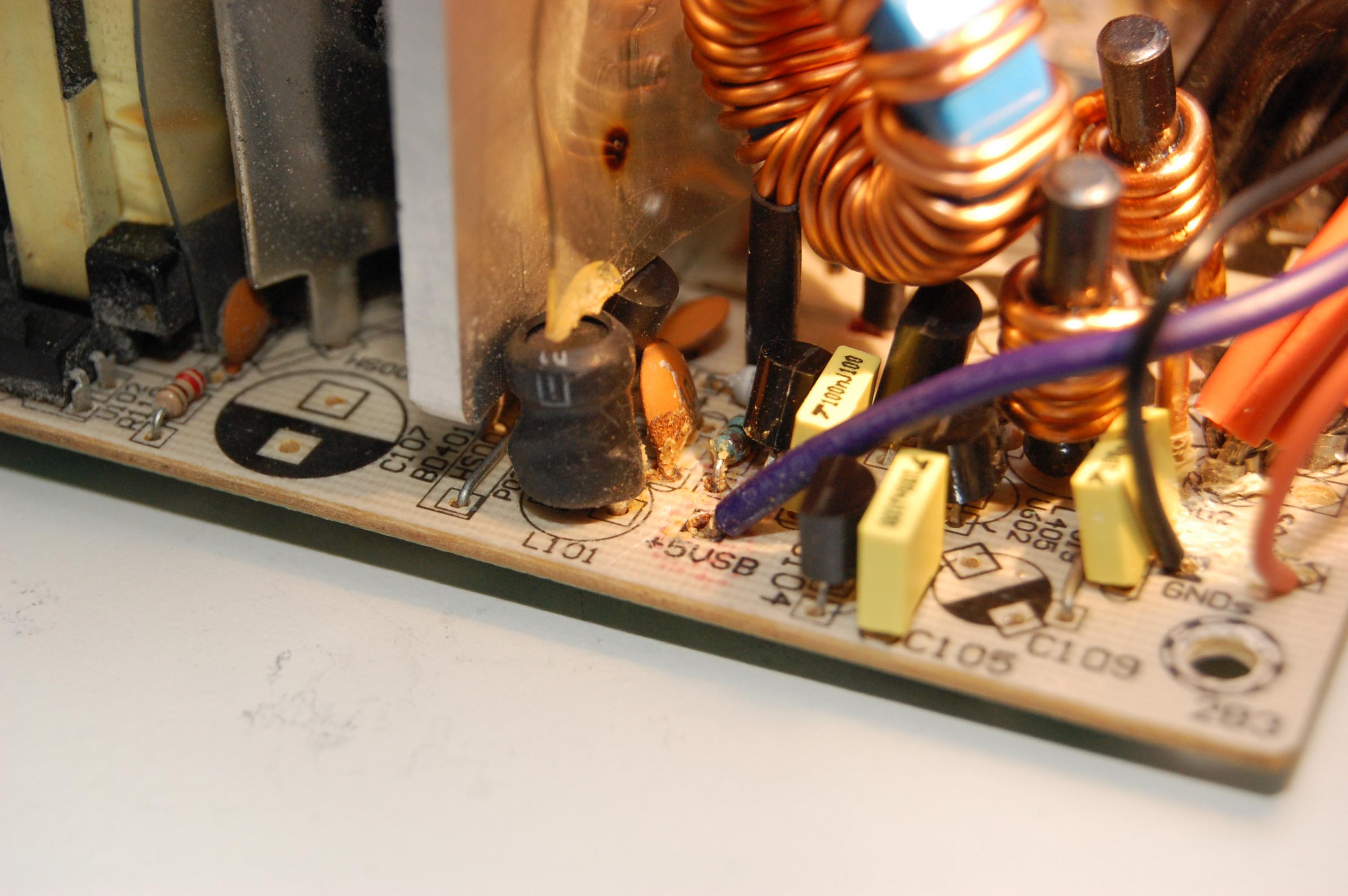

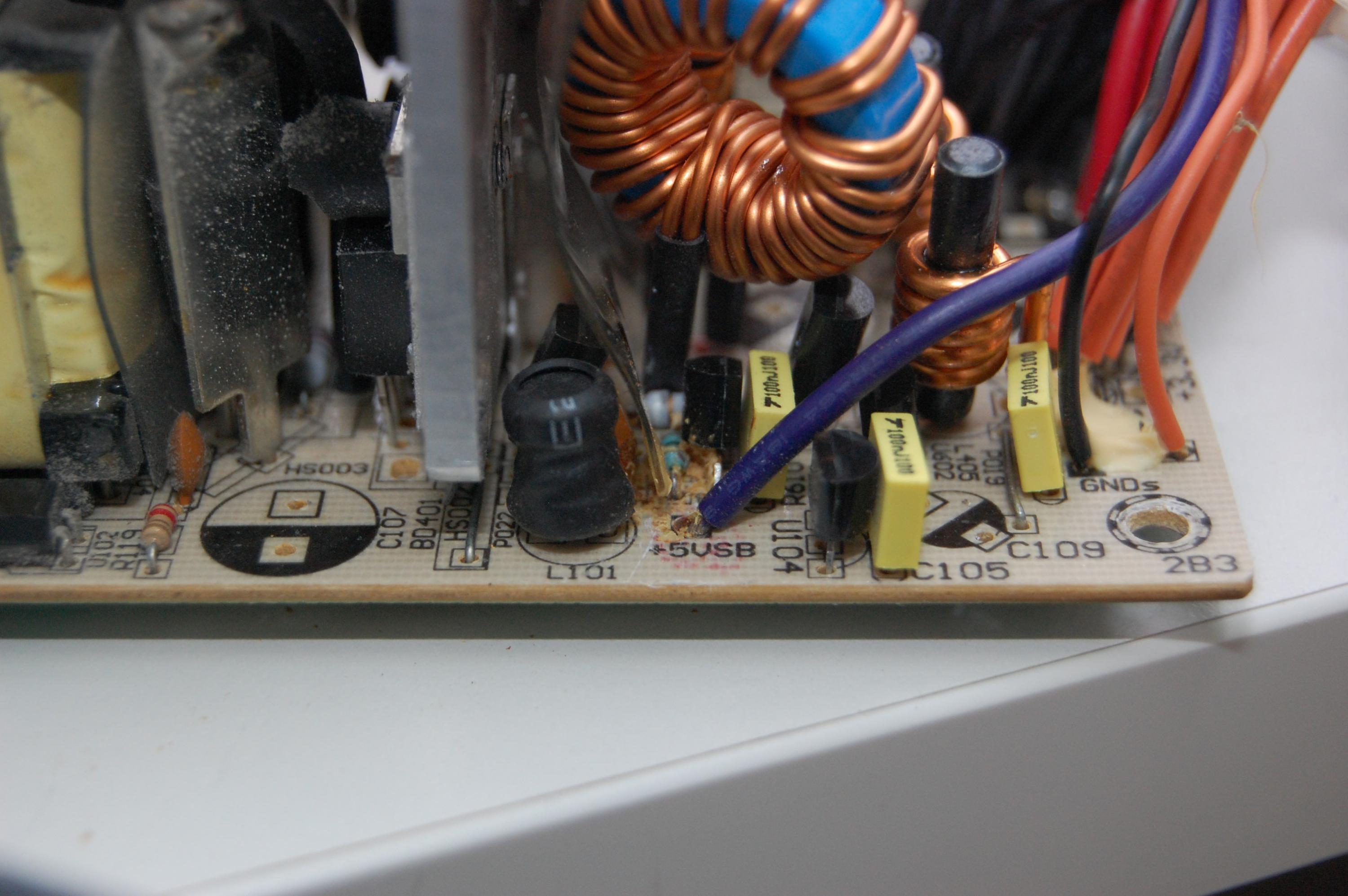

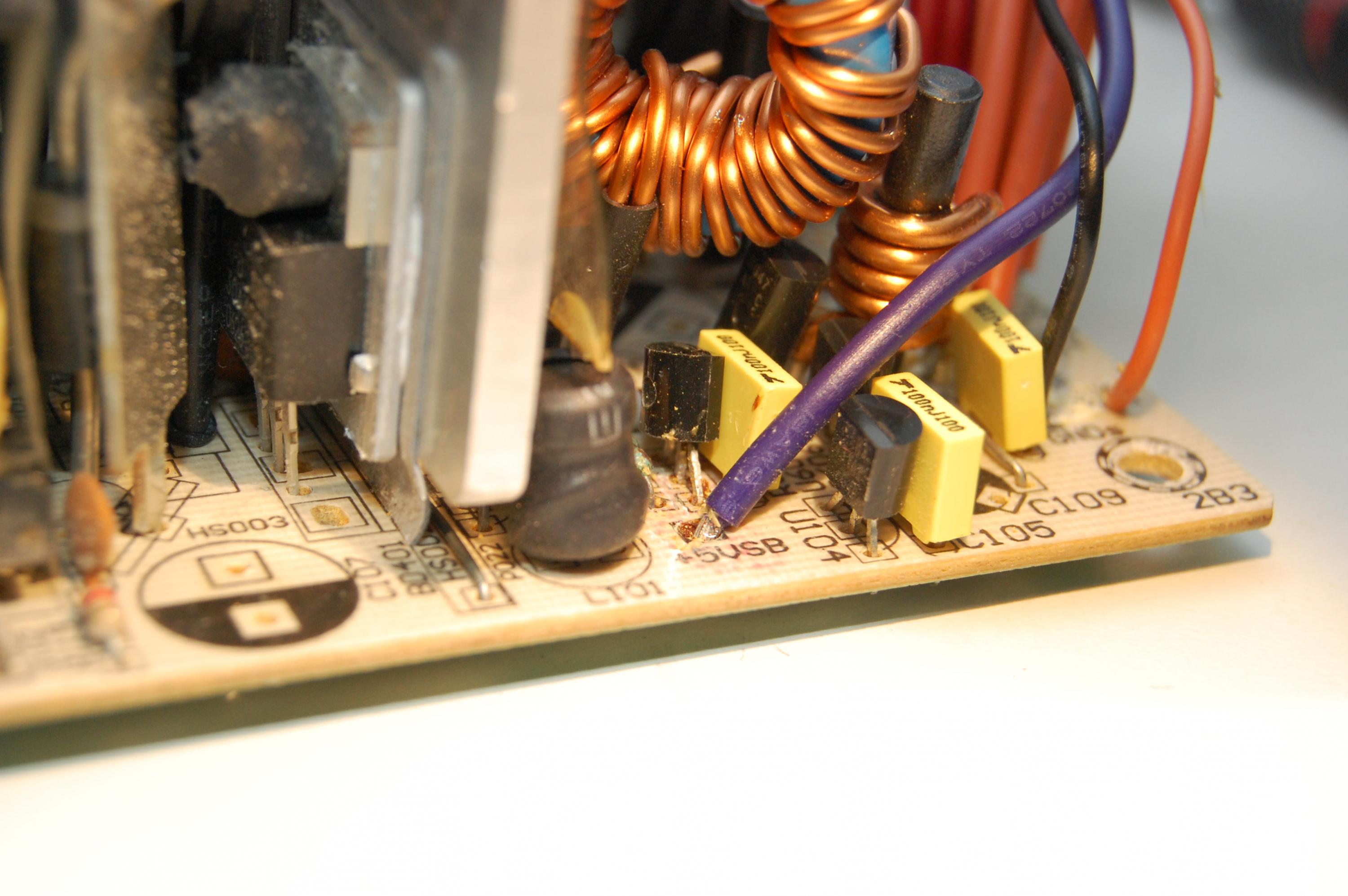

            Also needs some glue cleanup. At least where it might cause short circuits... Here's before and after.
