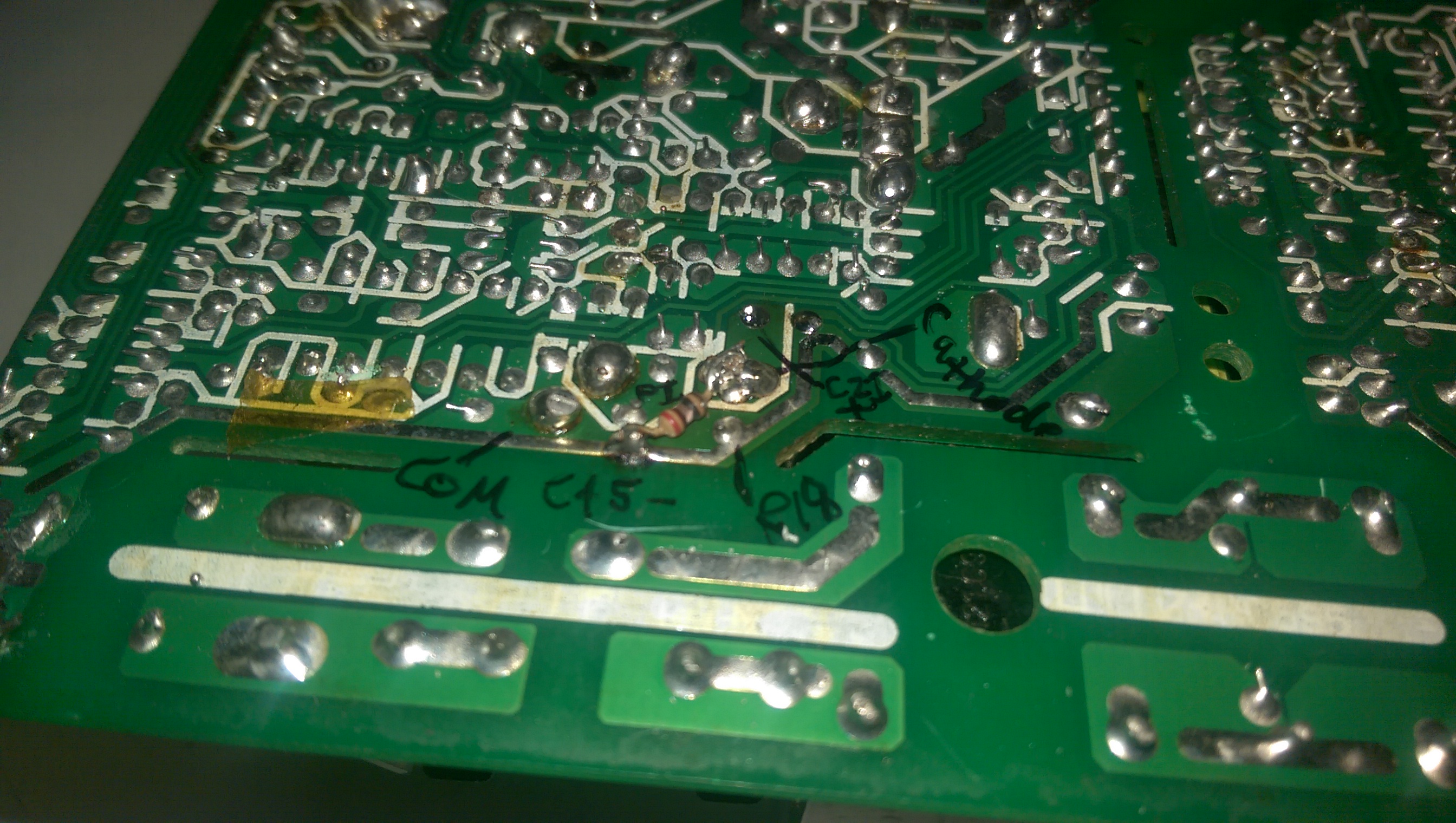

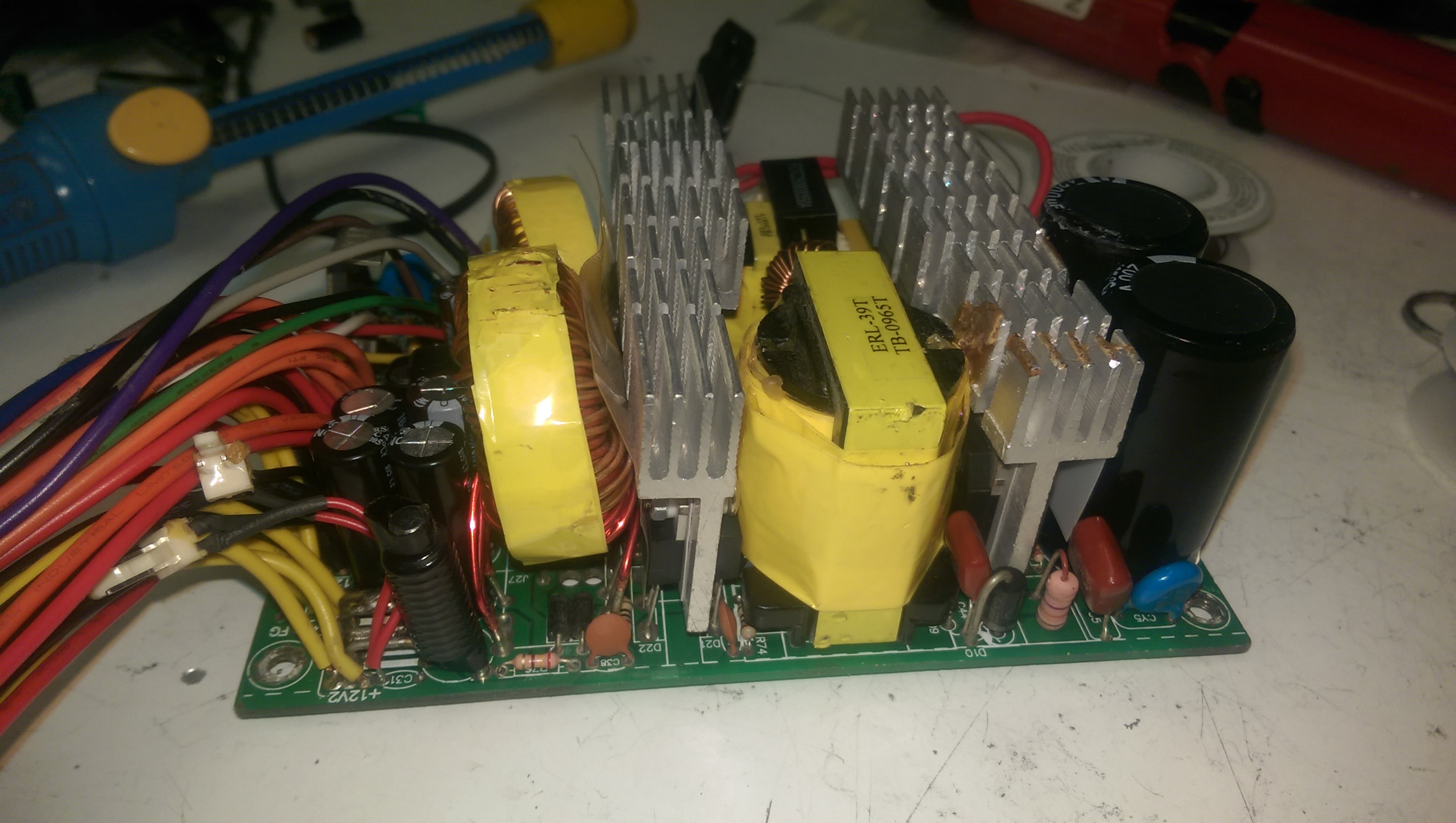

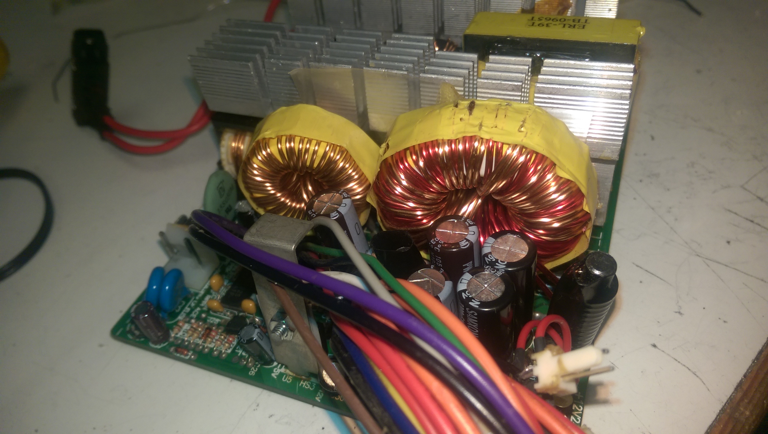

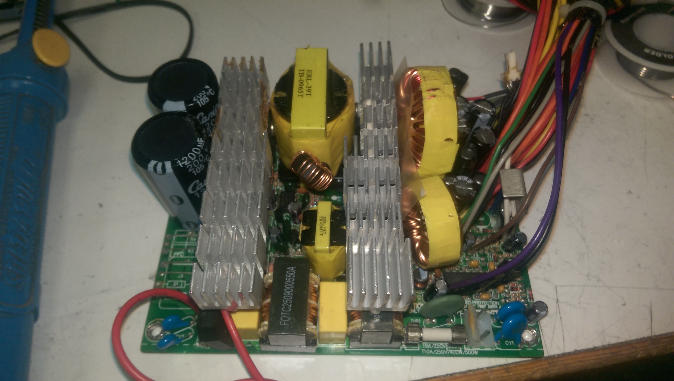

    Double forward, with huge heatsinks and good silicon. Currently trying to get the 5VSB to not run so hot. There's that 21Ω resistor on the bottom side and 33Ω on the top. Without the bottom one, the 5VSB runs at 8.45V I'll upload more pics later

    The primary uses two Fairchild 9N90C FET's on the primary. The label claims 450W, which seems pretty honest. It looks to have two 12V rails with OCP. Controller on the secondary is PS222S https://cdn.badcaps-static.com/pdfs/...ec01b02f46.pdf
    There is a Texas Instruments TL3843P on the primary. Uses an 80mm fan for intake and 120mm for exhaust. All caps were Canicon/CS/JEE/GL. Only one CS cap and two GL caps. The 2200uF 6.3V CS cap failed on the 3.3V after the coil. I think for two reasons: It was physically touching the -12V output rectifier, and it was 8mmx20mm. Seems small, must be GP (No series printed on it) The only other caps that failed was the 100uF 10V JEE on the -5V rail, and both 4700uF 10V Canicon on the 5V filtering. I was blown away that both 3300uF 16V JEE on the 12V filtering were okay. They tested 3367uF 0.02Ω and 3412uF 0.02Ω. Those caps I put in are 30mm tall, so look how big that those toroids are! The heatsinks are huge too.
    I can't get the 5VSB to run correctly without the original 5VSB resistors, which seems odd to me. However, I had to replace the 5VSB output inductor, because a leg fell off the original one when removing, because it got so hot!

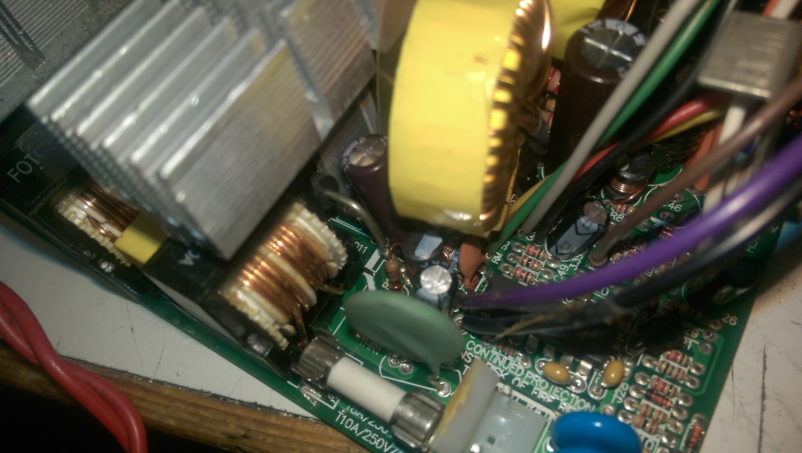

        Re: The best Sun Pro you've ever seen
        the clearance between the fuse, thermister and the nearby low votage stuff is way to low!!
          Seems like Sun Pro is definitely picking up a little - or at least in terms of components sizes. That output inductor is definitely ginormous !
          However, the quality of the craftsmanship (if you can call it that) still looks poor. They really need to start paying their workers a bit more.
          8.45V!?!? That's a motherboard killer right there, or at least a competitor for the 250W Bestec 12E. Either Sun Pro seriously messed up on the design here -OR- something went wrong during manufacturing.
          The 5VSB should be at most 5.25V without those two resistors. Is it a 2-transistor design or something else? Any suspicious caps near the 5VSB circuit?
          I agree. May want to add a plastic sheet to separate them or something.

            I did. I changed the original 1000uF 10V GL with 1000uF 10V nichicon PW, and changed the 330uF 10V JEE with 1000uF 10V nichicon PW.
            True. Although, I did move the thermistor to get a better view of the 5VSB.

            Yeah, mainly the soldering side. I'll take a solder shot, but I've already redone a lot of the joints.
            Yeah, and it ran at 5.74V when the computer was running. The lowest it's got was with a single 47Ω resistor. I'll try it with none and see what it does. Otherwise, I may have to do a everell style mod. Yes, it is 2 transistor.

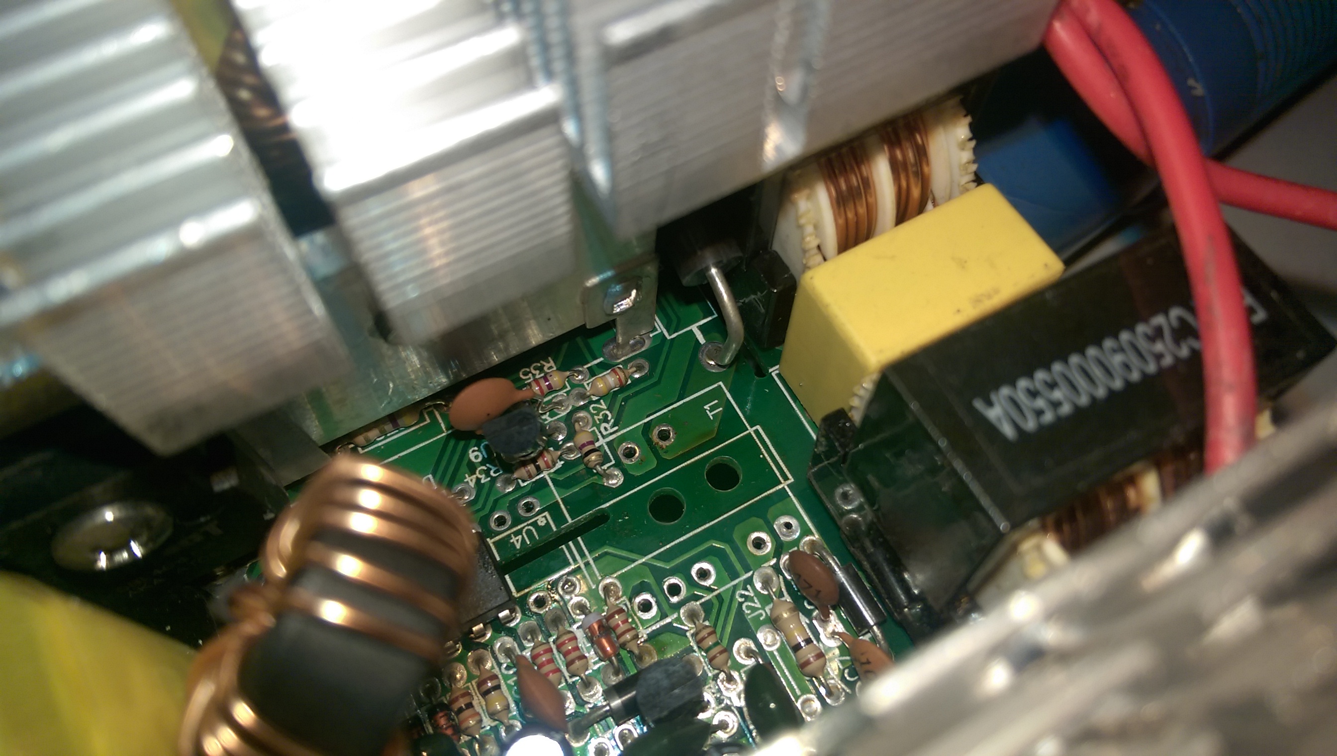

                        I guess try the optocoupler next. Before that, though (since you have the 5VSB transformer out), pull the small 5VSB transistor that drives the bigger 5VSB transistor on the heatsink. Check its B-C and B-E diode properties. If okay, put it back in and then try a new opto.
                          I had already replaced the optoisolator
                          Are you talking about the one to the left of "J22" ? I think it's a 945. I'll check tomorrow. The 431 I replaced is U9
