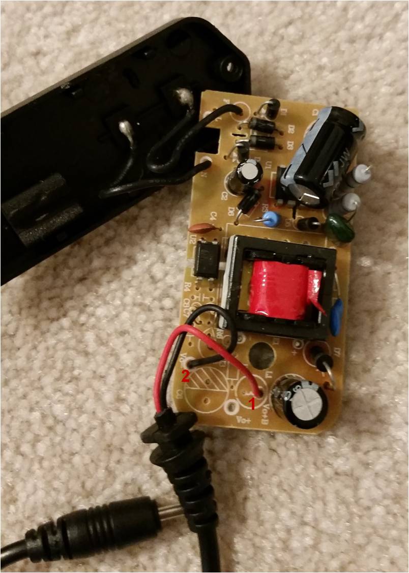

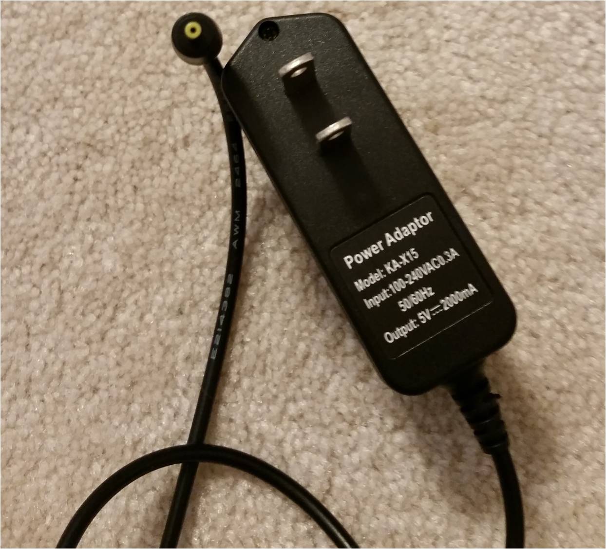

    HI,
    My daughters noria 7inch tablet is not turning on or charging that we can tell. So i pulled the adapter apart (which was easy because they have a screw holding it together) to look at it.
    Observation1: I noticed that while charging the adapter "smelled" like hot wire smell and it was "warm" to the touch.
    Observation2: Look at pic1.......labeling says output in DC is 5V/2000mA
    Observation3: Look at pic2.......i actually plugged this in and measured between nodes 1 and 2 and i measured 5.52V dc.
    So i guess this means the adapter is ok........right? or is there something else i should check on the adapter to make sure its running ok.

              Re: Noria power cord adapter question
              Take the tablet apart and resolder the charging jack. It is always the problem on cheap tablets.

                That 5v @ 2000mA on the label is kind of wishful thinking... i doubt a 7" tablet uses that much current to charge, or that the charger is actually capable of providing that much current.
                Please, just go and buy a "brand name" phone charger or a somewhat higher end 5v @ 1000mA or higher power adapter.
                Then, cut the cable somewhere and connect the cable of this old charger in its place so that you'll have the proper connector. Making sure the polarity of the wires remains the same (you can use a multimeter but the wires should be colored differently so it would be easy without one)
                The circuitry inside the current adapter is horrible and doesn't seem capable of actually producing 2000 mA, more like 300-500 mA. In addition, the wires in the cable with the connector are so thin that they wouldn't handle 2000 mA in the first place.
                  there is nothing much wrong with the charger itself. The only thing that could be wrong is if it couldn't provide any current. In that chase just replace the output cap and you are back in business. I think there is something going on inside that tablet.
                    Nothing much wrong?
                    No pi filter ... see there spot for an inductor and capacitor missing, they just soldered the wires directly on ground and where the inductor was supposed to be. Red wire should go to Vo+ but since inductor is missing they had to solder the wire there.
                    Components missing in the feedback path, by the optocoupler, maybe it's not even working.
                    The transformer is undersized, i sincerely doubt it can do 1000mA.
                    The diode by the transformer should be rated for 2-3A if the charger is supposed to be capable of 2000mA - that diode looks more like 1A max. If it's rated for 2A, have a second look at datasheet, it would be rated 2A at 70c temperature or something like that, if the case is hot and you smell something, you can bet the insides are probably much hotter than that. Luckily diodes are more resilient in general, they don't fail often.
                    The wires are simply undersized for that current, at 2000mA you would have A LOT of voltage drop on the cable. Luckily, at idle this adapter outputs 5.5-5.6v so at 2A the output voltage is probably more like 4.5v if the adapter can even do that. The smell of hot wire is probably the insulation on the cables getting hot because the wire is thin and therefore heats up.
                    This charger looks and probably is SHITTY. Your Asus, Samsung, Apple chargers may very well do 1-2A without any problems, but they're in a totally different league compared to this charger.
                      I've got tablets and smart phones (Asus, Samsung, Apple) in all sizes. All can be charged with 5V 2000mah. Cording to my current meter they will actually come very close to that too. If I'd be charging my Ipad on 500mah, it would take a full day to charge!
                      that things a joke. wrong creepage distance for 230v, poorly designed feedback regulation (and a high drift opto), no fuse or sacrificial resistor, no pi filter, etc.
                          +100!
                          The ripple from that thing is going to kill the tablet. Maybe not now, but it will over time. That tablet will be the next "Adam computer*."
                          Welchs, cut the plug off that junker and solder it onto the end of this:
                          http://www.allelectronics.com/make-a...-supply/1.html
                          Don't even waste the time with these junk supplies.

                          Welchs, while there may be a cap in the output of that thing, I certainly wouldn't trust it. It's likely of dubious quality, and the lack of pi-filtering affects the poor device connected to it. It was bad enough in my above example, it'll be an outright disaster in that little tablet.
                          CapLeaker, of course it get hot and smells like burnt varnish/wire- the transformer is undersized and overheating. That thing could fault primary to secondary. And w/o an EGC, the entire tablet (and everything/everyone) connected to it will be floating at line voltage. Needless to say, the heat also killed the caps. I had this same "dusty burnt varnish" smell from the Deer PS above.
                              Originally posted by Welchs101
                              wow, came back tonight and did not expect this much info........
                              so thanks.
                              should i even make the measurement you guys mentioned or should i just order the new charger
                              thanks again
                              You're welcome.
                              As long as you can't think of any problems with splicing the old plug onto the cord from the new supply, you should be ok. I'd cut the old cord near the plug, leaving a 6-8 inch tail. To get at the wires inside, try a wire stripper for #10-12 AWG and gently sort of score the insulation. You'll be able to remove it w/o damaging the two wires inside. The cable from the supply is a miniature "zip-cord," which should be easy to work with.
                              That's a pretty small plug, so splicing it this way might be easier than cutting the actual connector out of the overmold.
                              Make certain to check the polarity before plugging it into the tablet! You don't want to let the smoke out.
                              Don't forget to slide the heatshrink on before you solder it!
