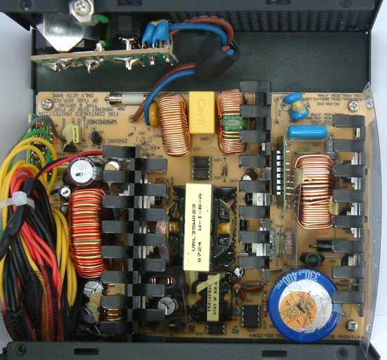

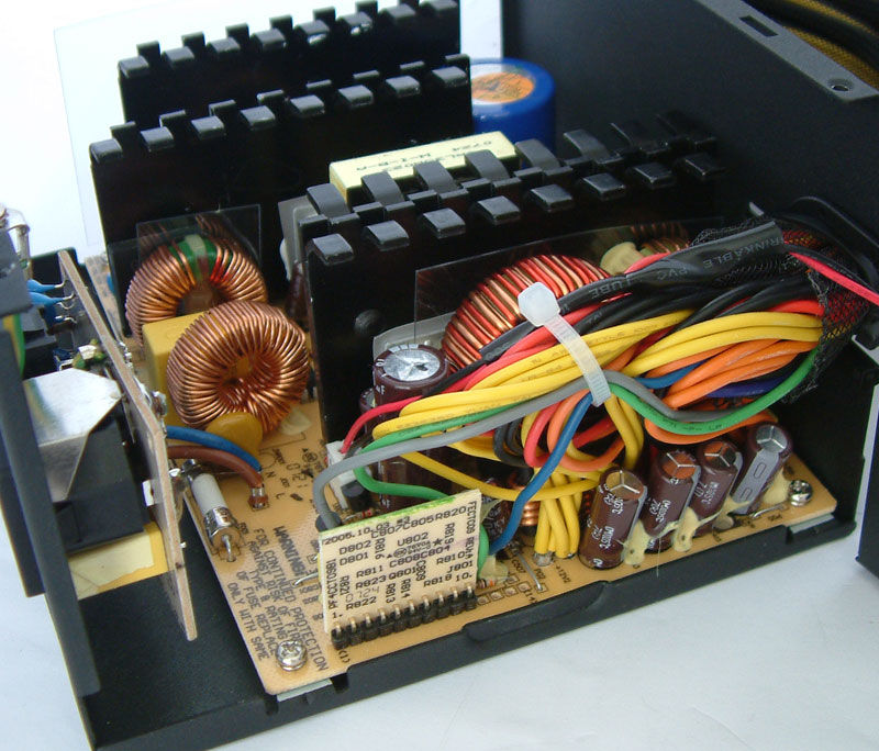

    I'm recapping my Corsair VX450 due to age. From 2008, it's 6-1/2 years old now. The PSU works fine, loafing along at ~150-200W output.
    The caps are all United Chemi-Con, mostly KY and a few bigger KZE's, primary KMQ and one Rubycon YXG.
    The outputs have a single 1,000uF 16V KY on each, which seems small
    KZE ESR 23m 1.82A ripple 4,000hrs lifetime D=10mm
    KY ESR 46m 1.40A ripple 7,000hrs lifetime D=10mm
    The KY's have higher ESR but longer lifetime specs than the KZE.
    I'm not sure what to go with. Any recommendations? I'm tempted to upsize the O/P caps to maybe 1,500-2,200uF (D=12.5mm) if they'll fit.
    The PSU is made by Seasonic, inside looks like the Antec Earthwatts 430W, CX400W from 2008 etc.
    (here's generic inside pics, but w/Hitachi primary cap)

    Don't bother recapping it. The original caps should easily have another 5 or more years life left in them. Japanese caps last practically forever in a well designed power supply.

      I had to do a double take when the title read VX450. I remembered that unit as having all Japanese caps.
      c_hegge is absolutely right.
      The only thing that causes me to grimace when looking at those pics is the cheap Chinese organic glue that Corsair spec'd for that particular unit. Still, I wouldn't muddle. You're going to end up breaking something and regretting that you ever posted in the first place.

        Bear in mind too, that you actually have at least two caps on all of the outputs. The larger ones behind the wires are on the output filtering too.
