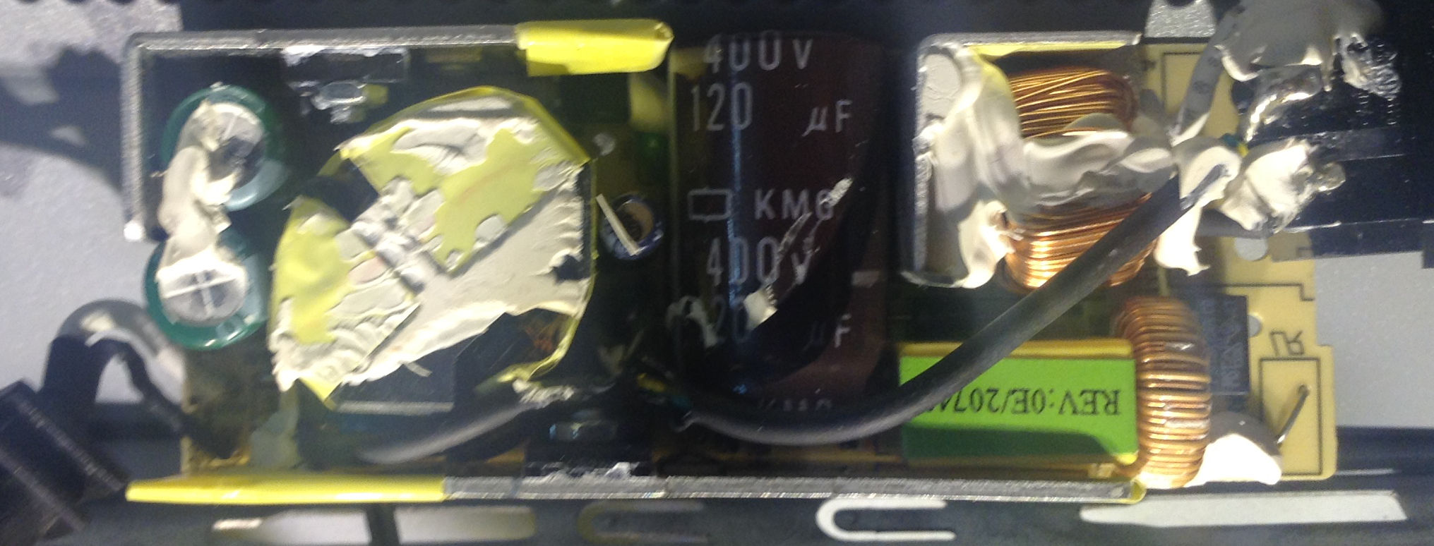

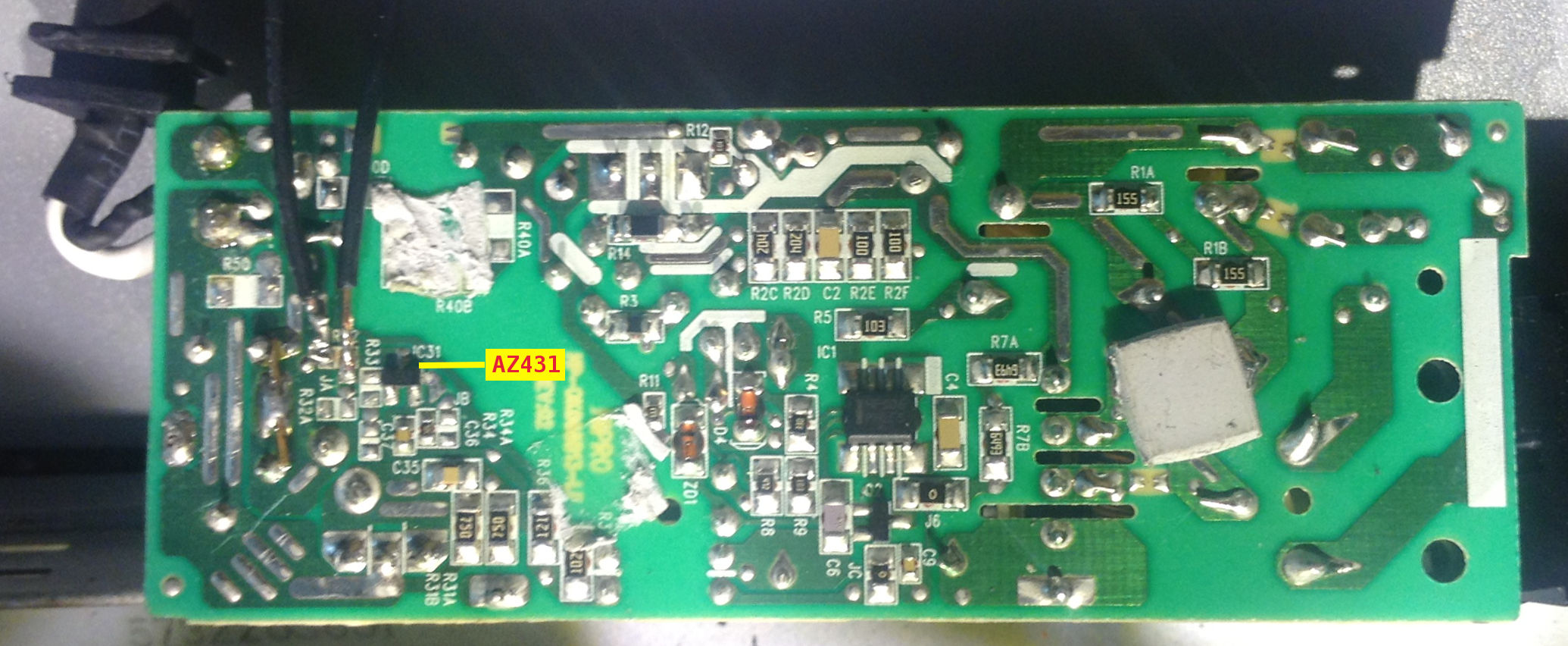

    I have a Chinese 100w LED. DC Forward Voltage(VF):30~34Vdc ; DC Forward Current(IF):2400MA
    I want to try to see if it's possible to modify a 19v adapter to run it. I have been reading about modifying smps to raise their voltage and have actually been successful(miraculously lol) so far at getting it from 19v to 25v.
    The power supply:
    HP 380467-003
    INPUT: 100-240V 50-60Hz 1.6A
    OUTPUT: 18.5V 3.5A 65W
    I know I could buy a proper driver but I want to learn and have some fun Also the drivers are a bit costly. If this could work, it would be sweeeet!!
    What I've done:
    After researching for a long time I finally believe I figured out the feedback circuit and by lowering the resistor value gradually I got the voltage up to 25v but when I try to go farther it shuts down.
    I'm assuming some other over voltage protection but I can't figure it out so far...
    First, do you guys think this is possible? I realize it's only 65watt adapter but I'd be fine driving the LED at that power and fairly sure it will operate. Plus, if it works, I'll just get higher rated adapter for next version!
    Also, the second big question:
    How could I integrate constant current into this?
    Pics attached and many thanks fellas!

        it uses a chip designed most likely for constant voltage, and the transformer secondary is wound for 19v.
        get a datasheet for that chip, but i wouldnt try to get double the voltage from it anyway.

          Thanks stj! You're talking about the pwm chip right?
          It is labeled HP3D6 and I cannot find datasheet on it but I think it's same as NCP1203. (I've compared typical application to this board and pins are same)
          https://cdn.badcaps-static.com/pdfs/...ff378b36a8.pdf
          but i wouldn't try to get double the voltage from it anyway
          I figured I may be trying to push it too high but I'd like to see how far it will go. There are some nice Vero leds that would run at around 26v I think.

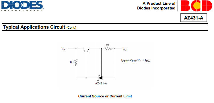

            The power supply uses a controller designed to control voltage, not current.
            By playing with resistors on the voltage reference, you can adjust voltage a bit but up to a certain point due to other factors like the transformer used and the secondary capacitors (which are most likely rated for maximum 25v).
            For leds you need to control the current.
            The led will probably turn on and be somewhat bright even at 19v and the low voltage will most likely prevent the leds from going beserk and use so much current as to blow up.
            But, as you get close to the rated voltage, you need to control the current carefully.
            You need a proper led driver, and there's boost/step up drivers or buck/step down drivers. Since you need 34-36v but your voltage is 19v, you need a step up driver.
            The efficiency of such drivers isn't that great, it's probably around 85% so you have to keep in mind that... your led will consume 35v x 2.4a = 84w so your power supply will need to be able to provide about 84w x 100/85 = ~ 97w - your 65w laptop adaptor is not powerful enough to power up that led.
            If you change that to a 24v psu or a computer psu (where you have 30-60A at 12v), then you don't have problems anymore.
            See here led driver chips, choose step up and make sure the chip can boost that much current and then check datasheets to see circuit examples and figure out what extra components you'd need :
            http://www.newark.com/led-drivers
            There's ready made led drivers here... pick ones that can do the voltage you want and the current, though i guess those will be kind of expensive. Not even sure they sell such high wattage drivers: http://www.newark.com/dc-dc-converters-led-driver
            Also.. a warning... a 100w led will need serious cooling, picture a large heatsink (or a cpu cooler with heatpipes) and fan blowing air on the heatsink to keep the temperature down.
