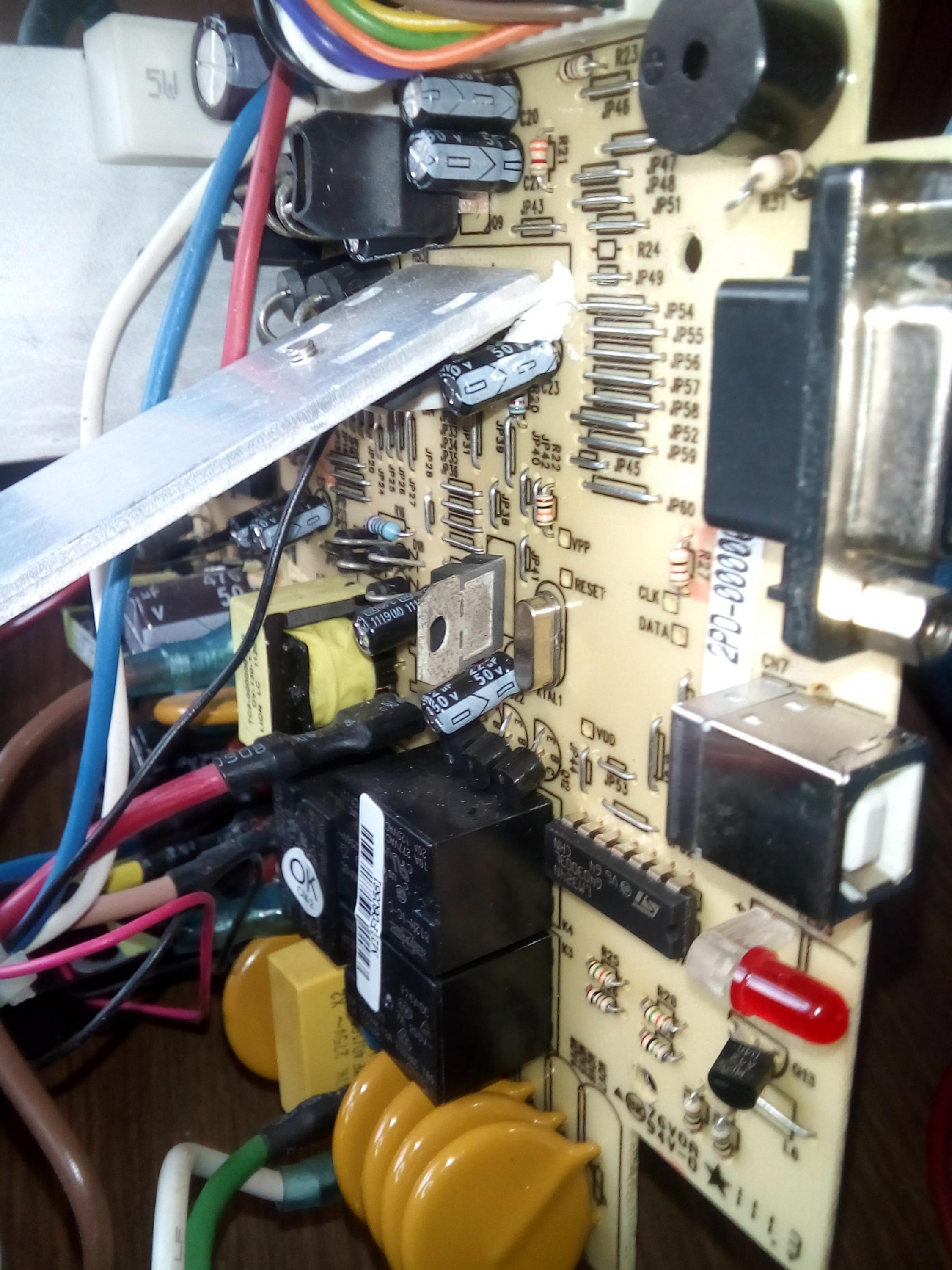

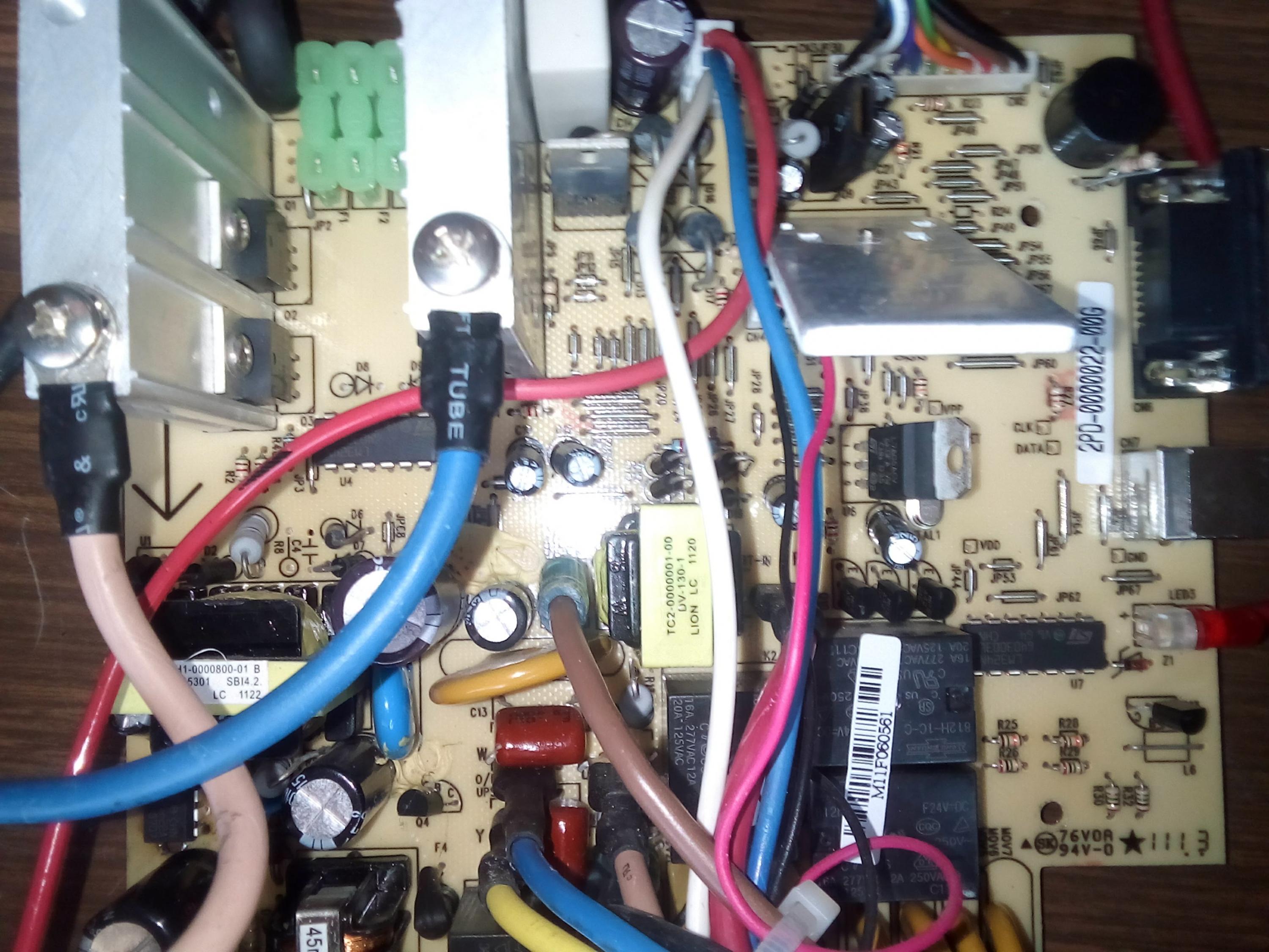

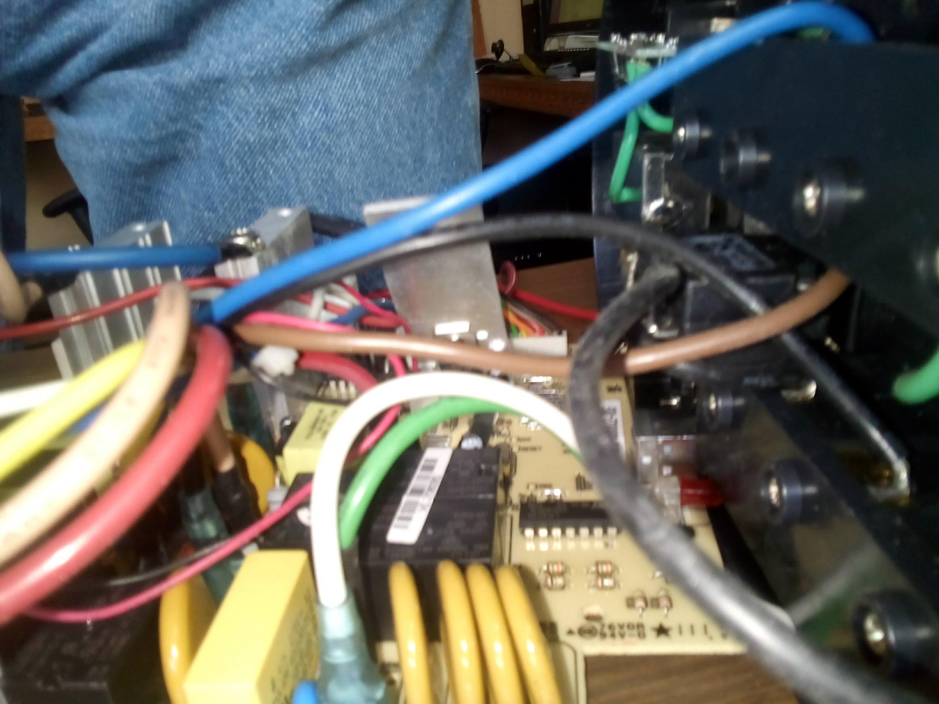

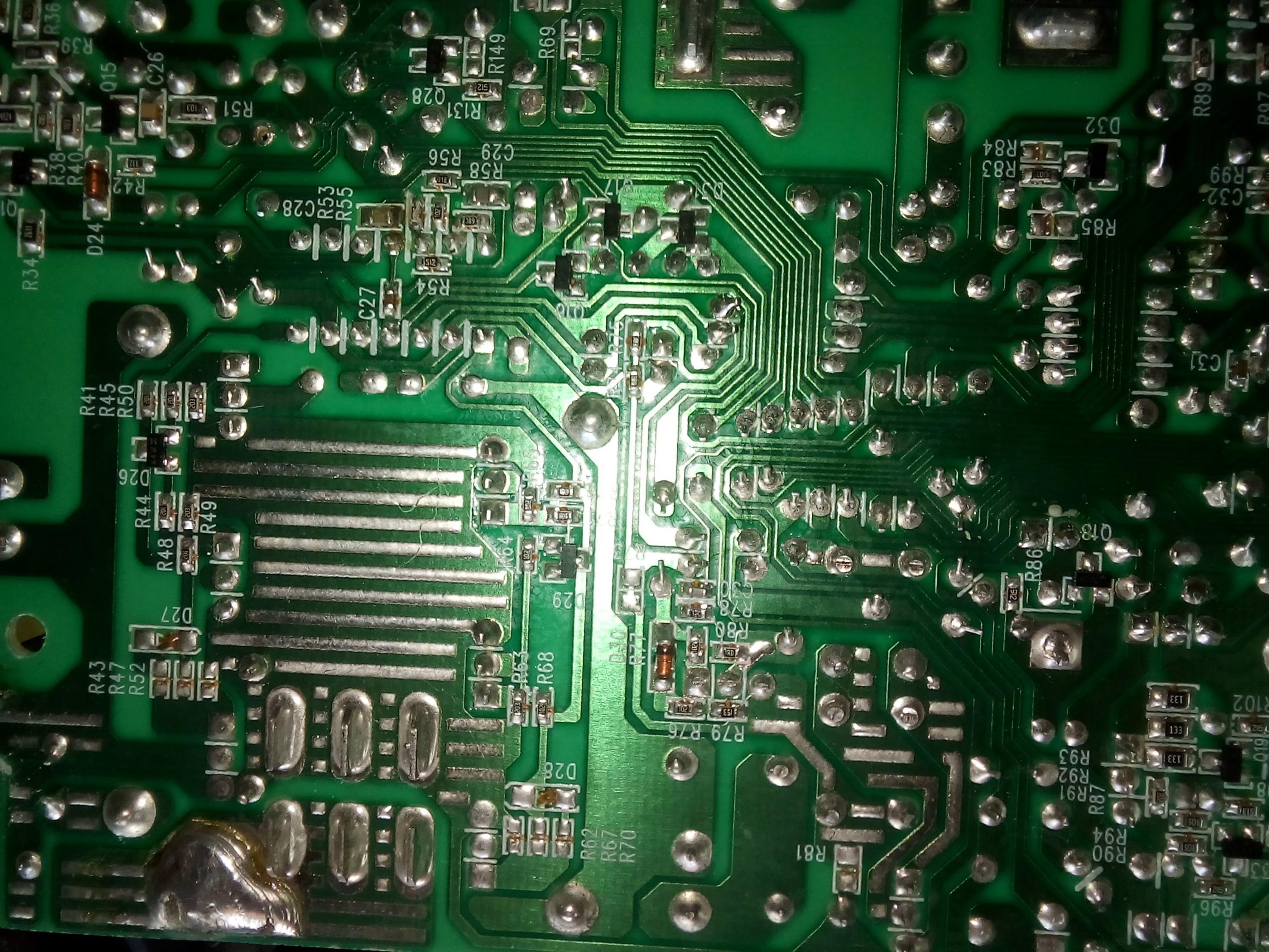

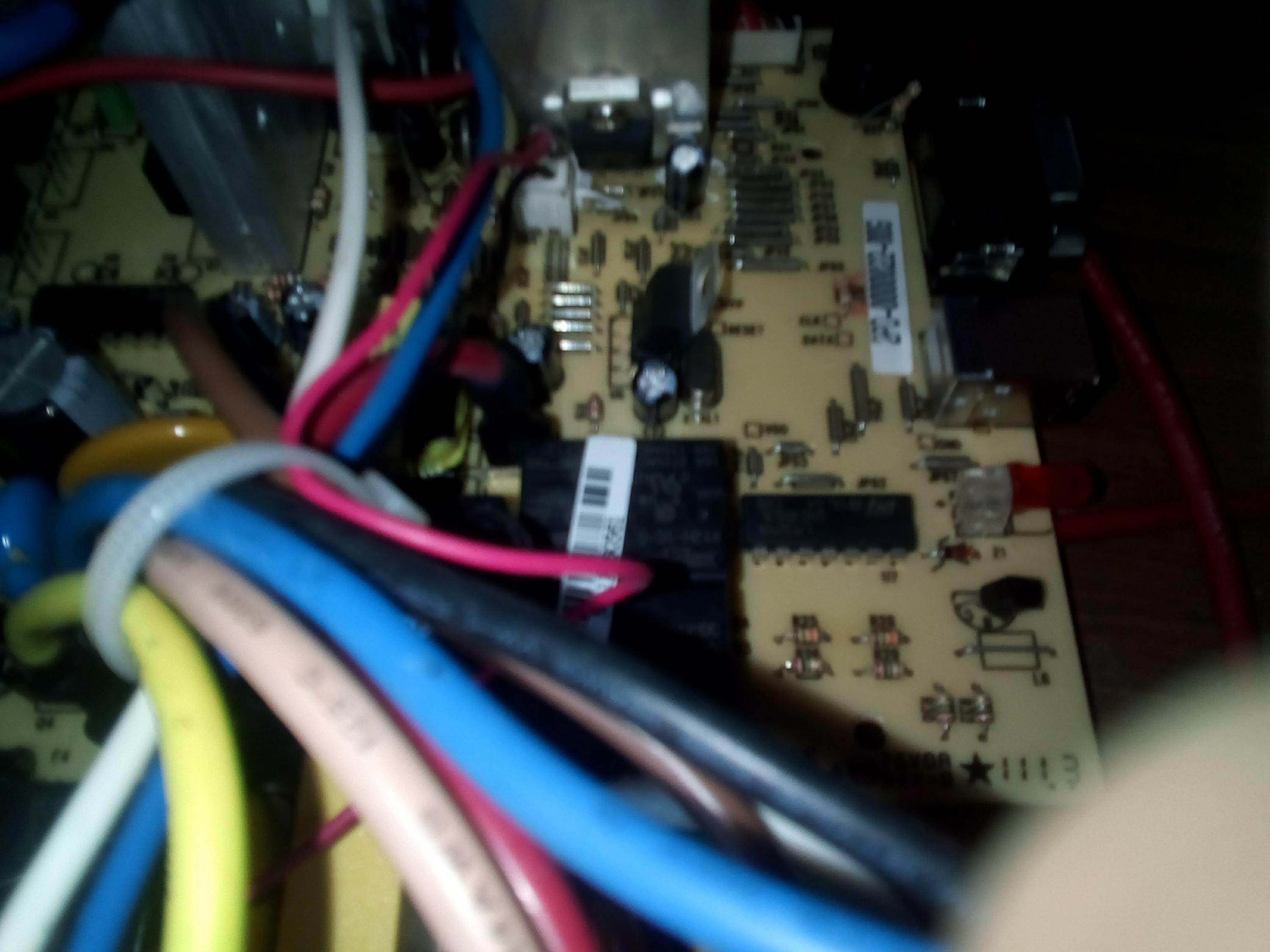

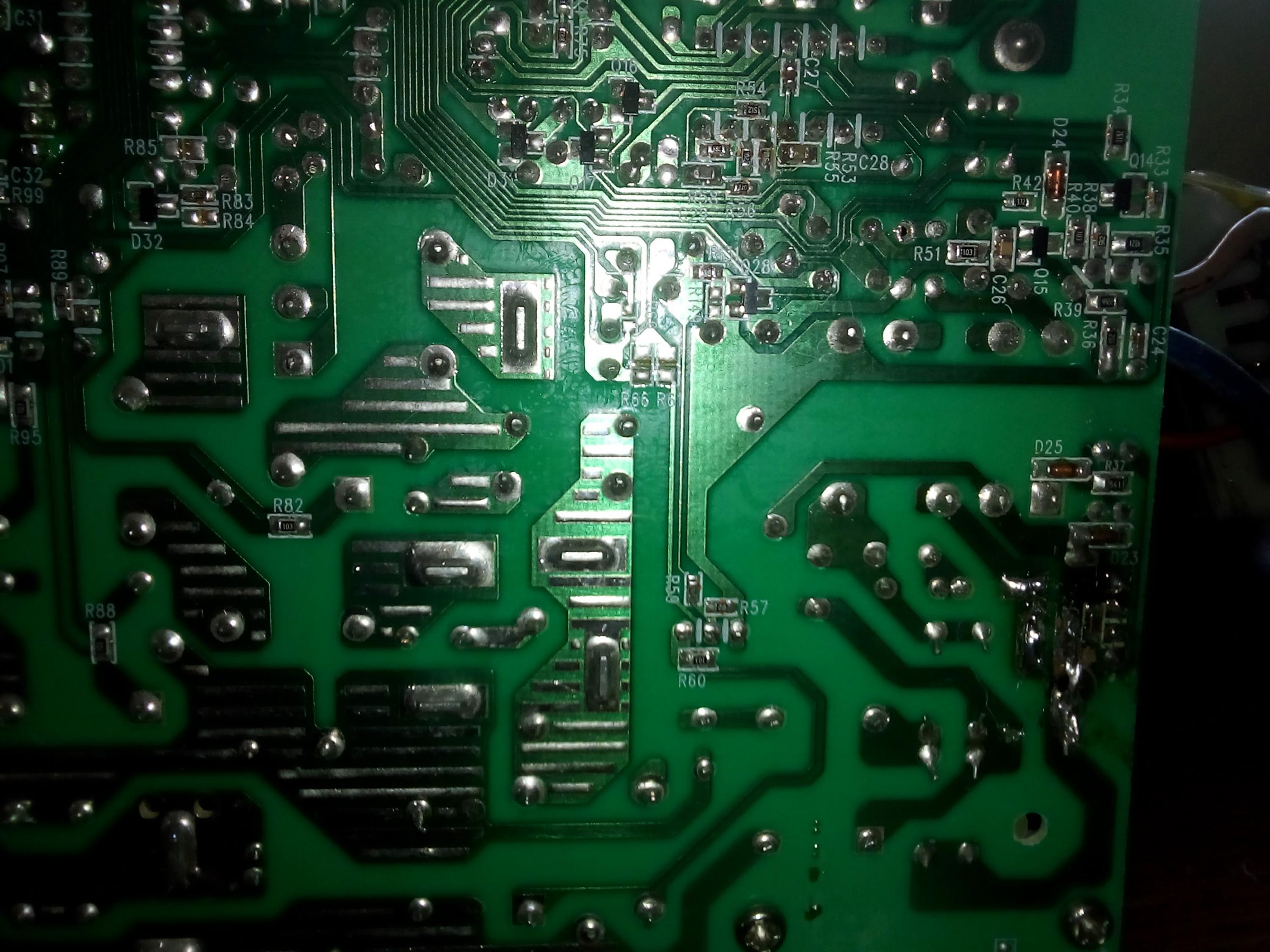

                    #69
                    Re: Cyberpower PR1500 won't charge battery
                    Here are some photos. Under the angled sink is a 15 volt regulator. There is a
                    SM6002N to the left of the switcher sinks, for control I suppose.

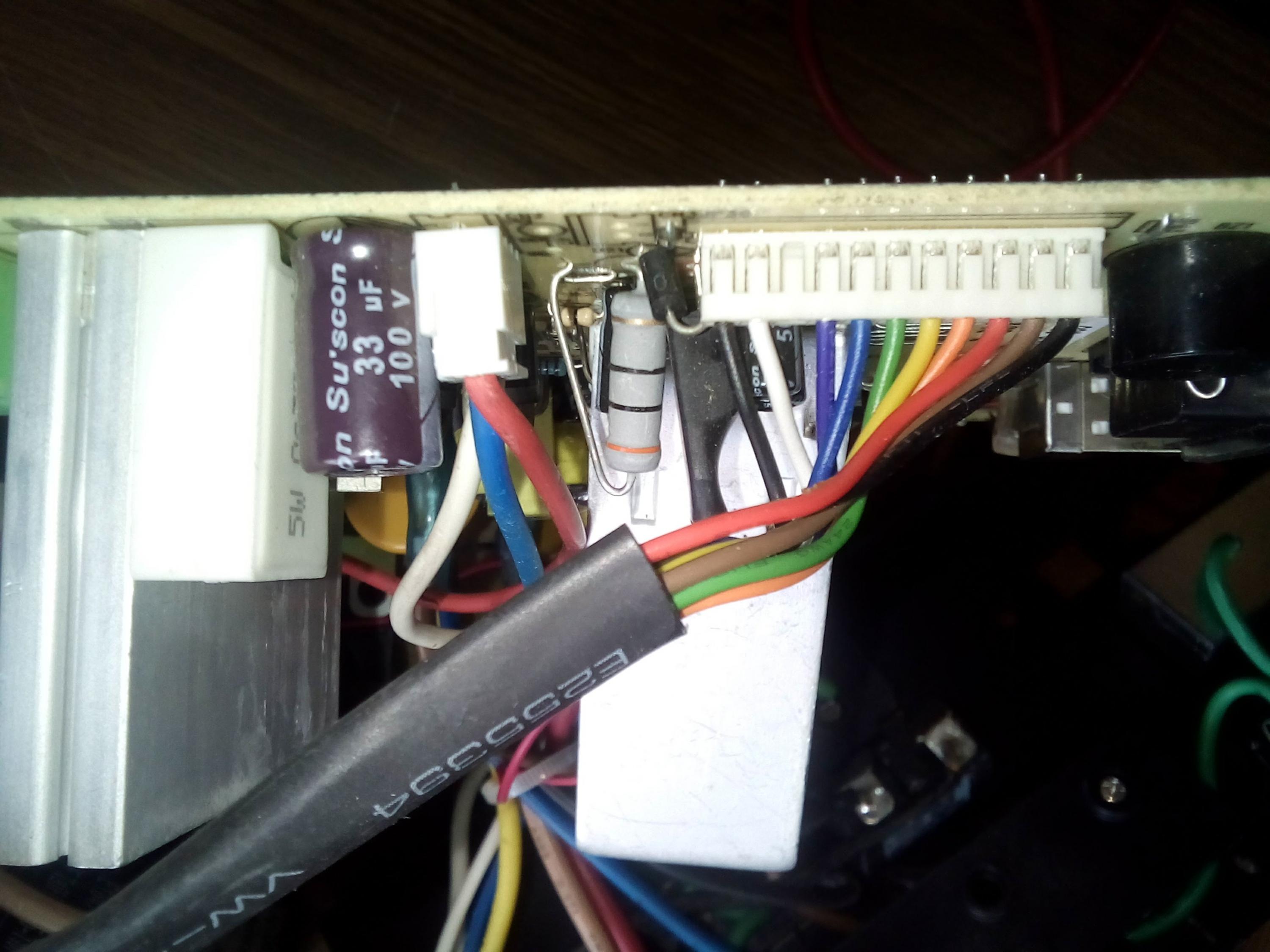

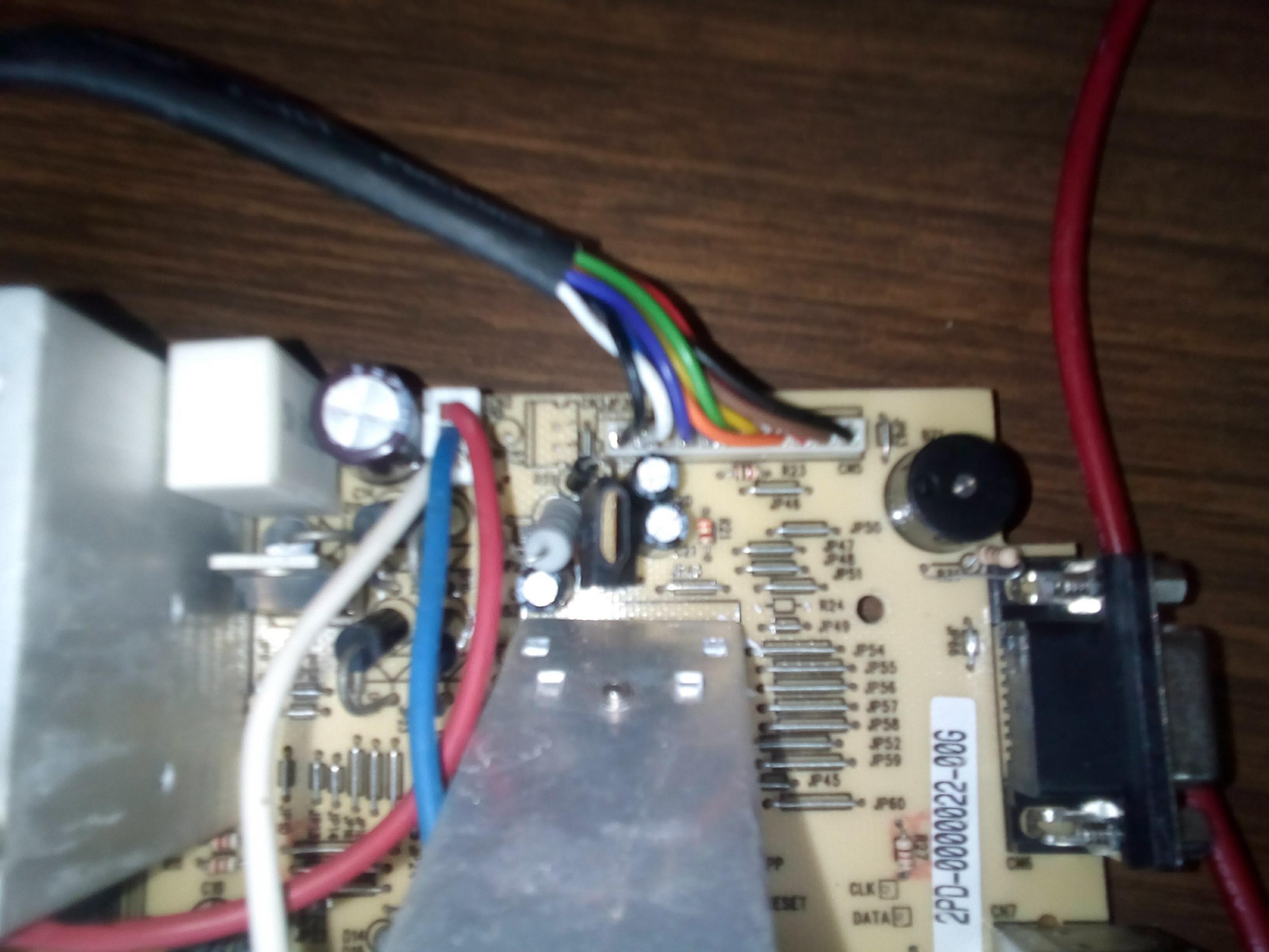

                      #70
                      The whole thing is pretty dense. It is hard to get good pictures.

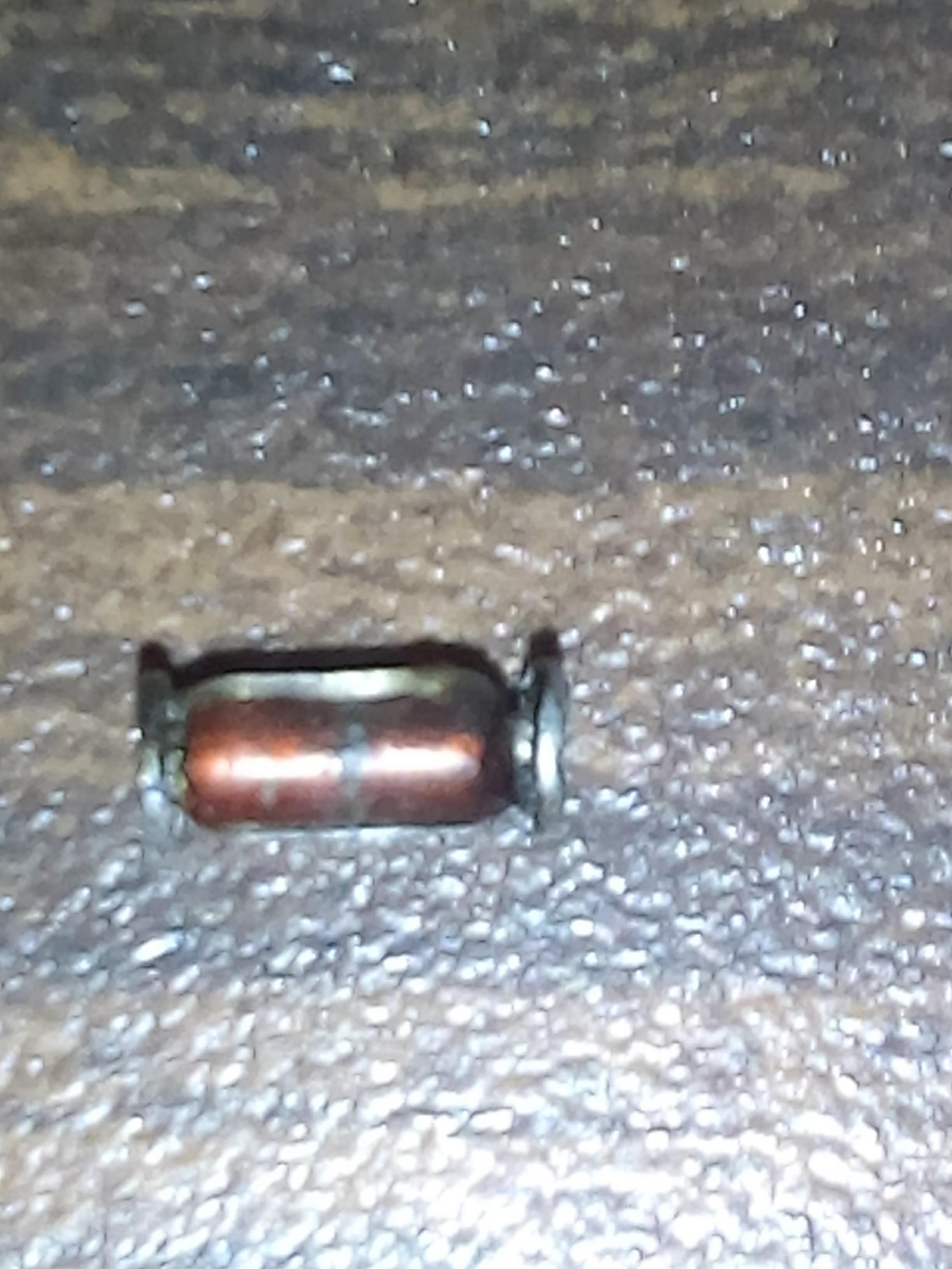

                                        #79
                                        Re: Cyberpower 1350AVR won't charge battery
                                        Hi Guys,
                                        Although I don't have schematics for my CyberPower 1350AVR I have found a diagram that approximates the circuit I am working on. I need to understand the VIP22A which really handles the charging. Like the 1500 units my batteries are not charging either. I have replaced the VIP22A which was burned and a burned out fuse but still no joy.
                                        There is a link to the document with the diagram that has been helpful to me.
                                        https://cdn.badcaps-static.com/pdfs/...4d8ae765c7.pdf
                                        On operations 4, 4.1 of that document the corresponding diode to my unit is D3. It is shorted. It is D23 on my attached pictures. I have attached some photos of the diode too. It is fed by a 22uf 50V cap that I have ordered.
                                        This diode is a really tiny glass case unit. I am going to try to get a powerful magnifying glass to augment my shop one which is indeed powerful. So my problem is that I can't read the part number. I am studying the 1500 schematics for an idea.
                                        Many of you are much much better techs than I will ever be. Your suggestions are desired and welcomed. What do you think it might be?
                                        Thanks so much,
                                        Roy

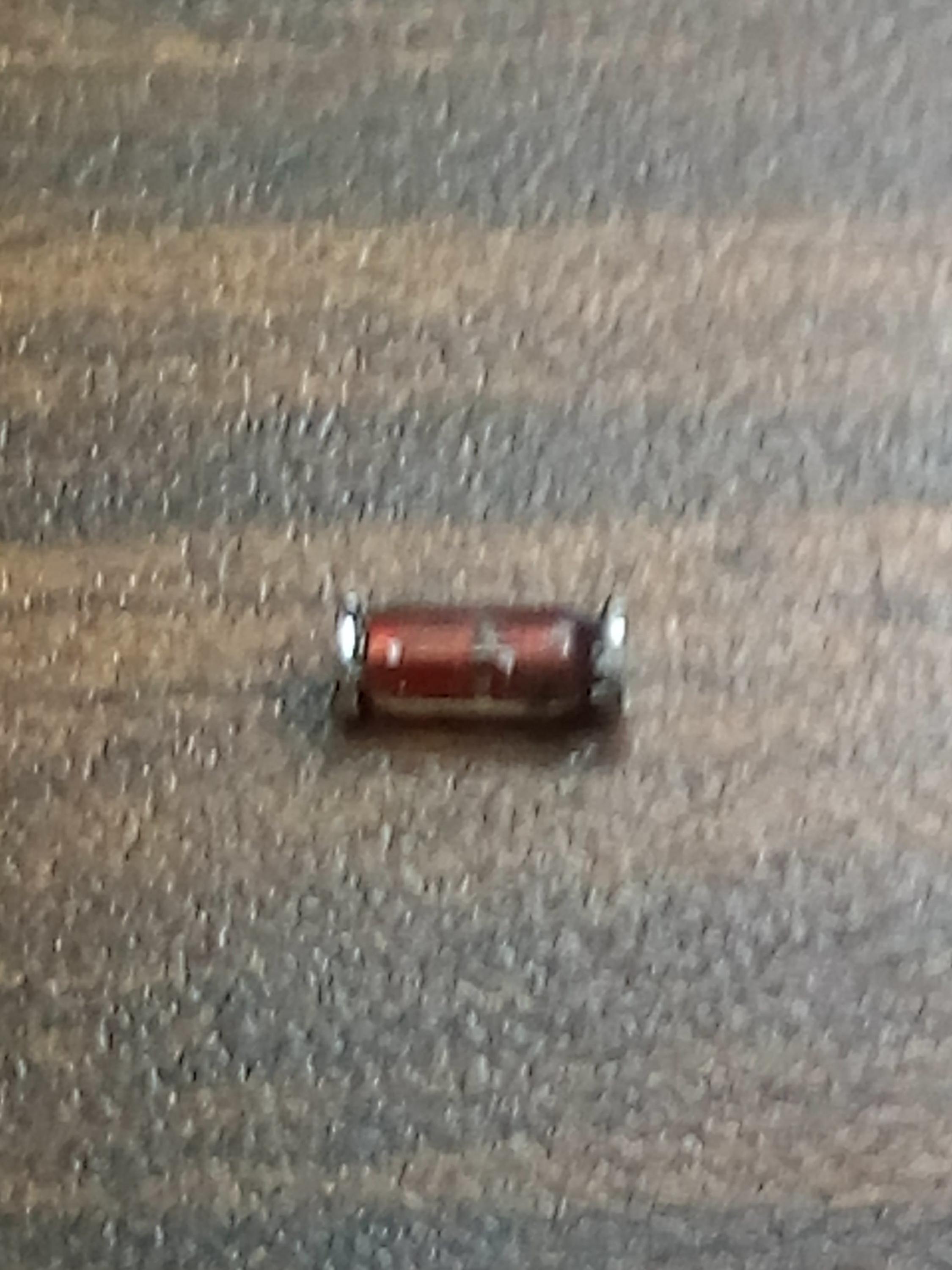

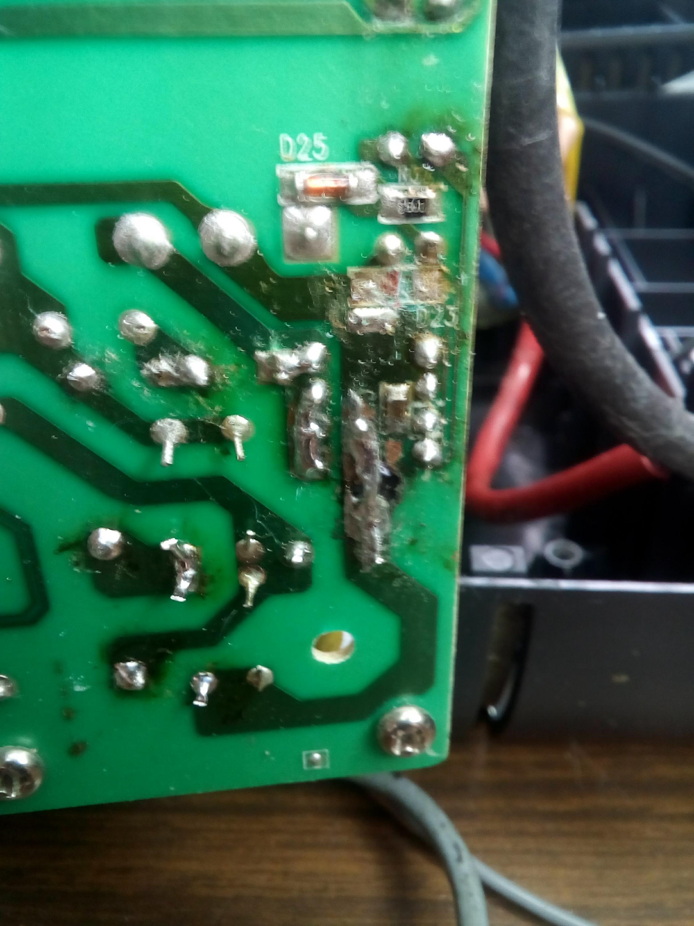

                                          #80
                                          Can we see the whole top and trace side of the board?
                                          I cannot tell using your pictures in your post 69 to figure out the circuit where D23 is actually used in the circuit.
