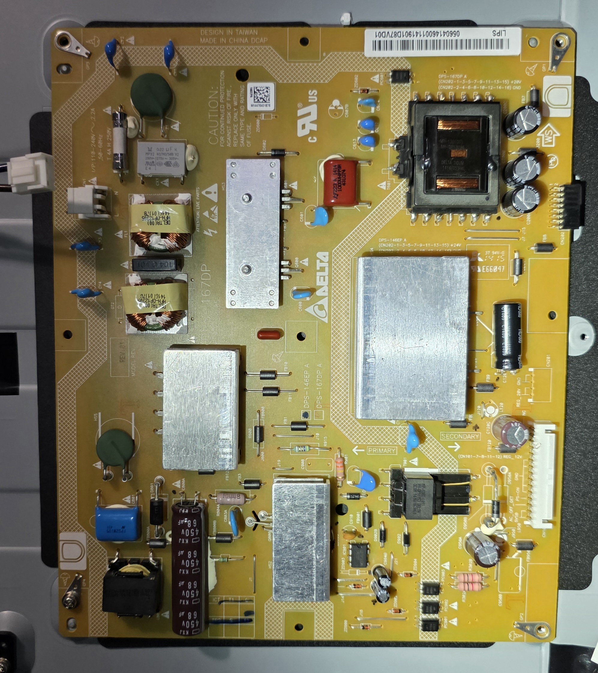

DSP-167DP LOW VCC at IC901

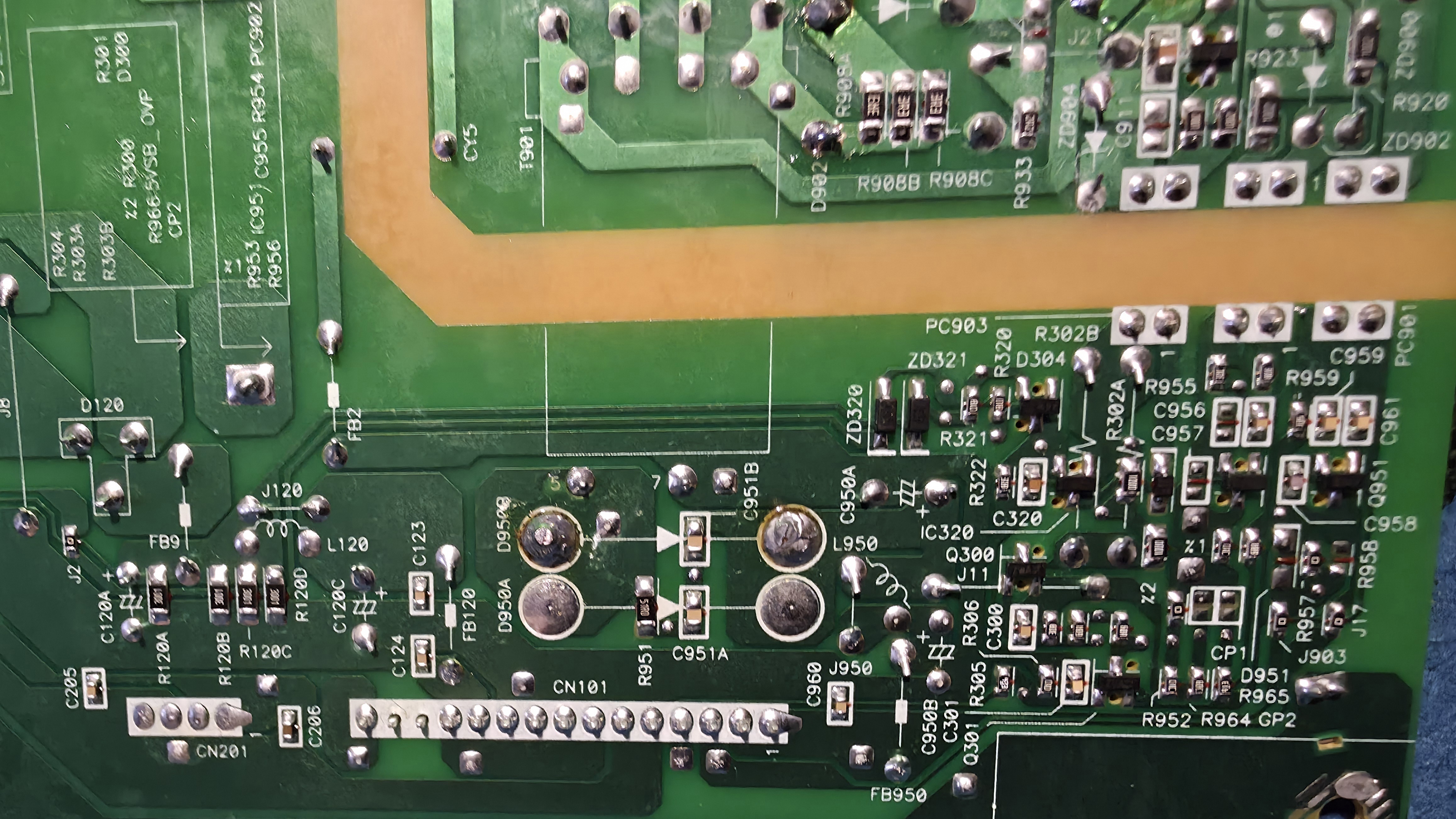

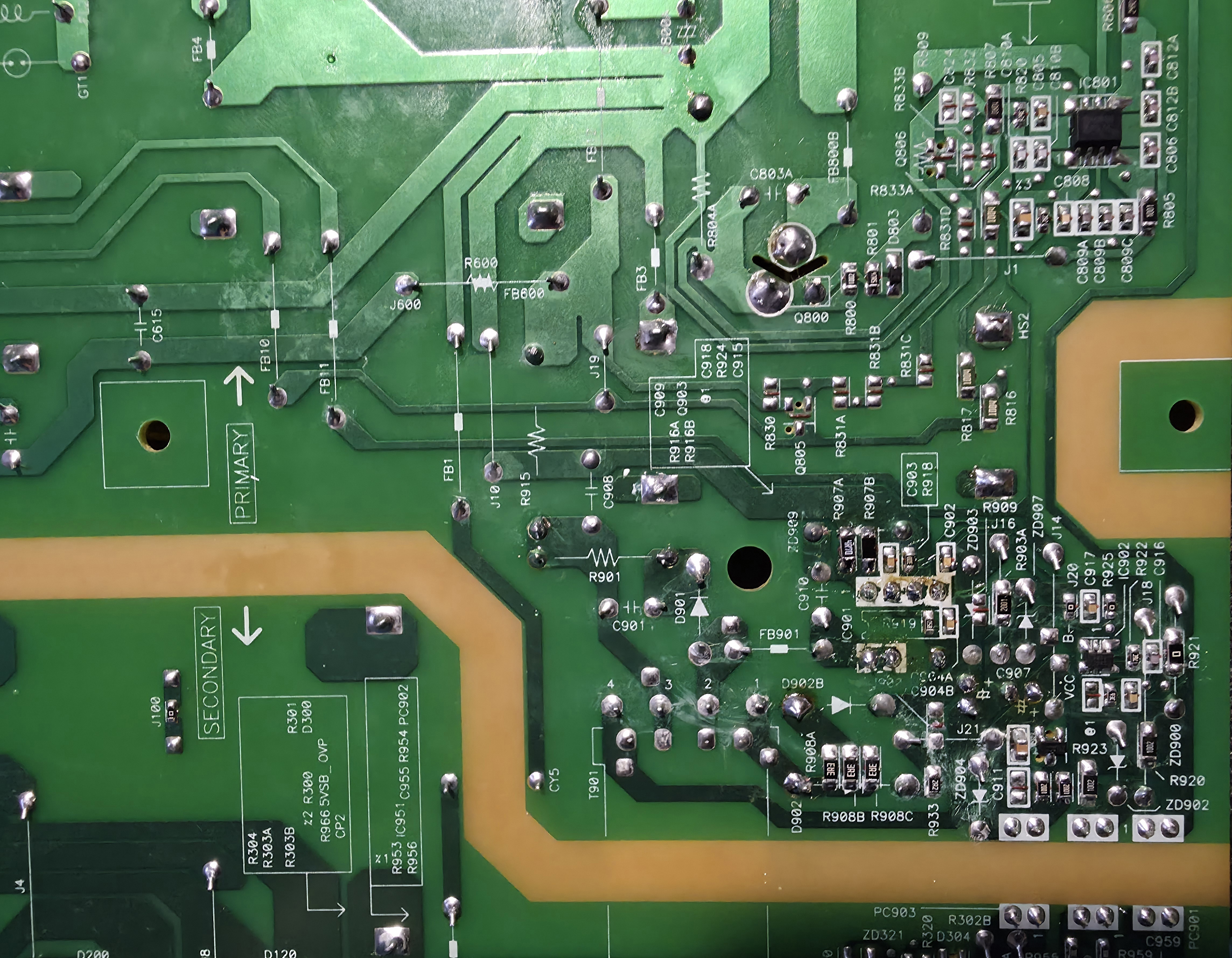

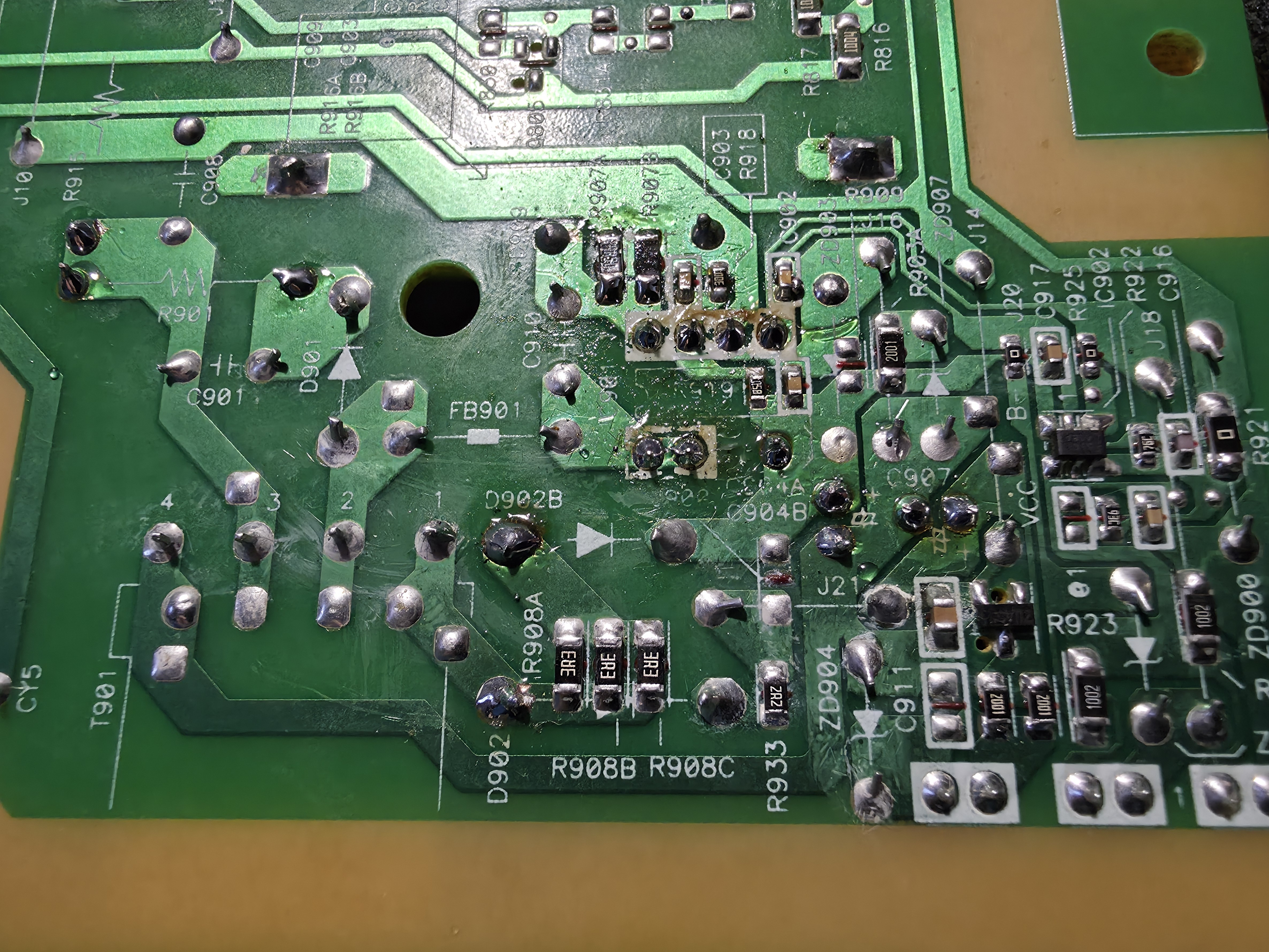

Also, can we get photos of your board, both sides, and showing the worked areas?"Tantalum for the brave, Solid Aluminium for the wise, Wet Electrolytic for the adventurous"

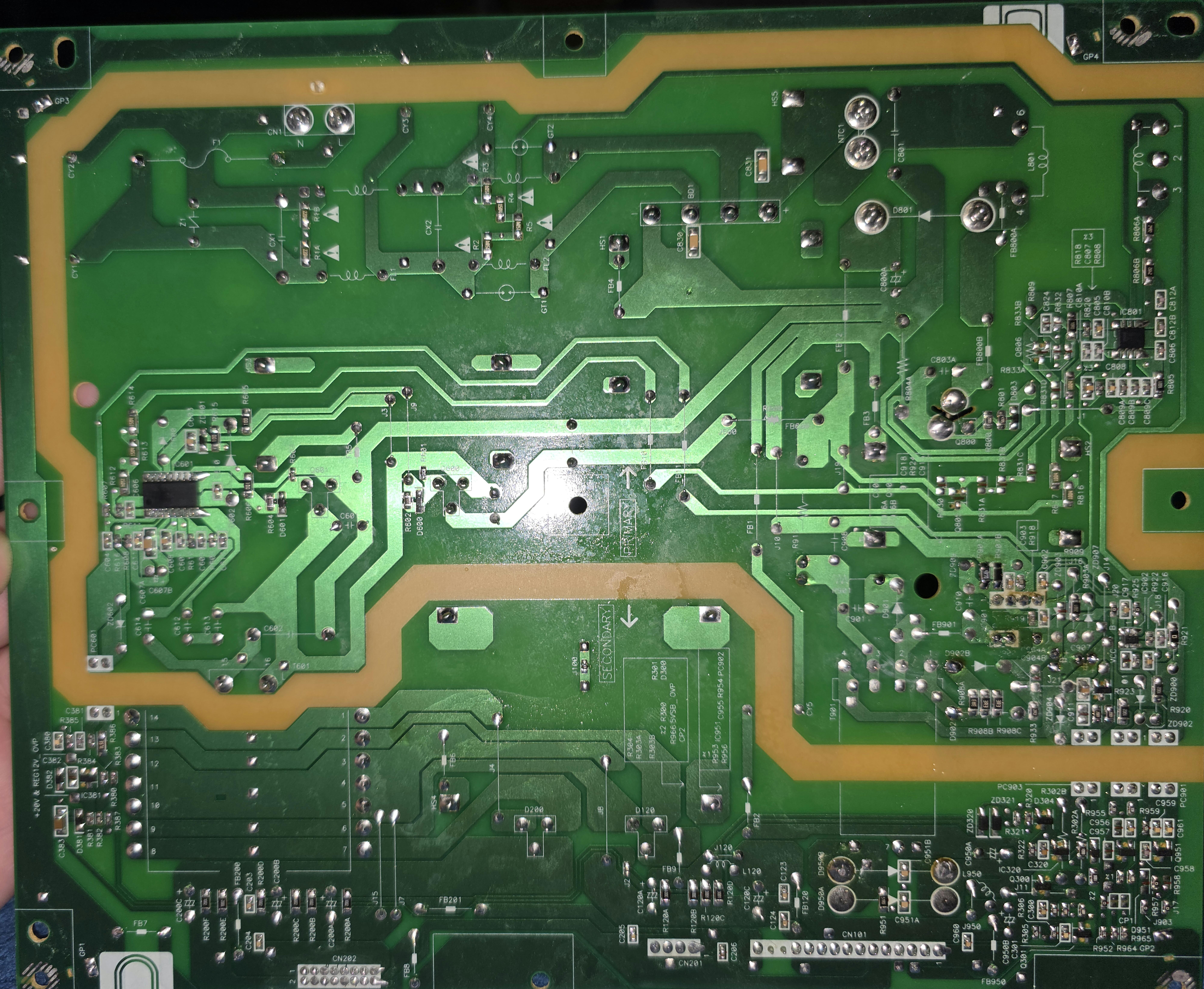

- Also, can we get photos of your board, both sides, and showing the worked areas?
- Attached, I tried to make them useful. If you need to see something else I can grab move.

I find it interesting you have 1.76k to ground on Vcc Pin.
I see that there is a 2k SMD resistor (R903A) that goes in series to ground with ZD907.
I guess this is to clamp the Vcc voltage.
I wonder if ZD907 is okay? If it were shorted, that may cause the problem.

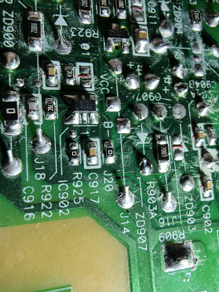

It looks like the Vcc supply of IC901 also feeds a pin on IC902. Can you confirm this?
If it does, then it's possible a fault with IC902 or its associated circuit could be pulling the Vcc pin low."Tantalum for the brave, Solid Aluminium for the wise, Wet Electrolytic for the adventurous"

Also I would definitely recommend cleaning the flux around IC901 given it runs from the high voltage supply.

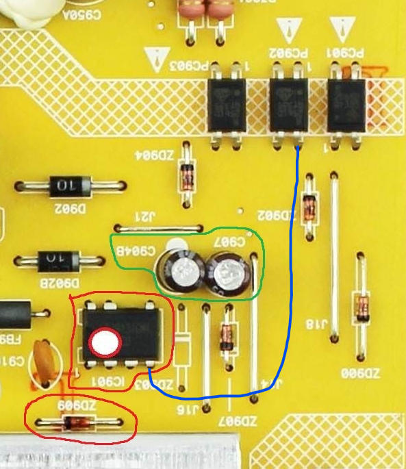

- ZD907 / .74 no shorts
- The blue line should be the connection from the comp pin to PC902
- It is the only pin on the hot side with continuity to the comp pin, amongst PC901 - PC903.
- I pulled PC902 from the board and powered it on, I am still getting 1.6V at VCC.
- It doesn't seem to be bad, I posted a couple of pictures of the old one vs a new one.
- I gave the flux a good cleaning, I forgot to clean it after I swapped the chip this afternoon.

Well, the next thing which might be a problem I can think of, is IC902, since it seems also connected to the Vcc pin of IC901.
It probably receives power from the same place.
Can you identify IC902? Or post a clear photo of the markings?"Tantalum for the brave, Solid Aluminium for the wise, Wet Electrolytic for the adventurous"

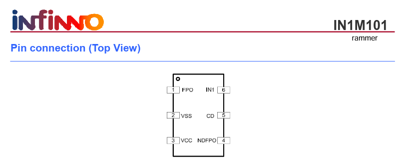

The ic should be able to charge the vcc capacitor before anything else would be detected, it should be able to charge the cap with about 1ma of current. If you can isolate the vcc pin from the rest of the circuit and only connect a 10~47µf cap from H-ground to only that pin and see if the ic can charge the cap, or try removing one end of ZD907 (it may be zenering at 1 volt?) and try to isolate ic902 vcc pin if you can (careful not to break pin) I would also remove one end of D902B in case it is leaky and loading down the vcc line.
It is possible the ic is defective
IC902 is likely a ST9S101-t6G or IN1M101 (marked S101)Last edited by R_J; Yesterday, 08:42 PM.Comment

- Is this the correct pinout? VCC would be under the letter A of 408A on the chip?

Looks like it to me. You should get continuity between that pin, and Pin 5 (Vcc) of IC901.
