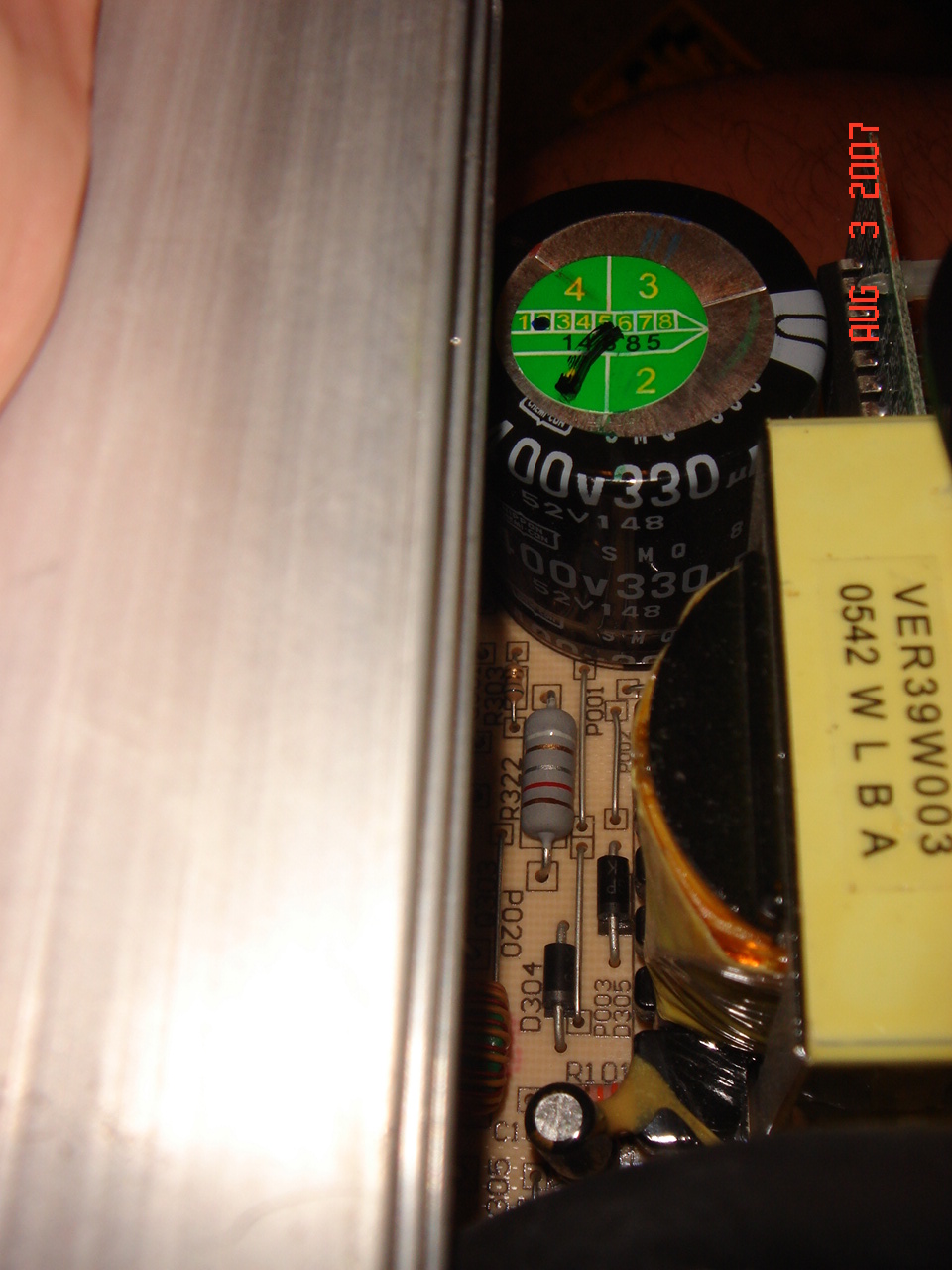

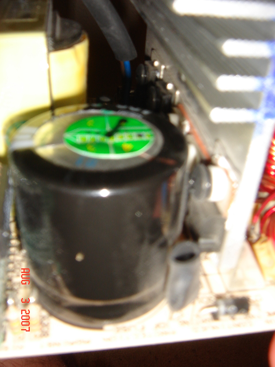

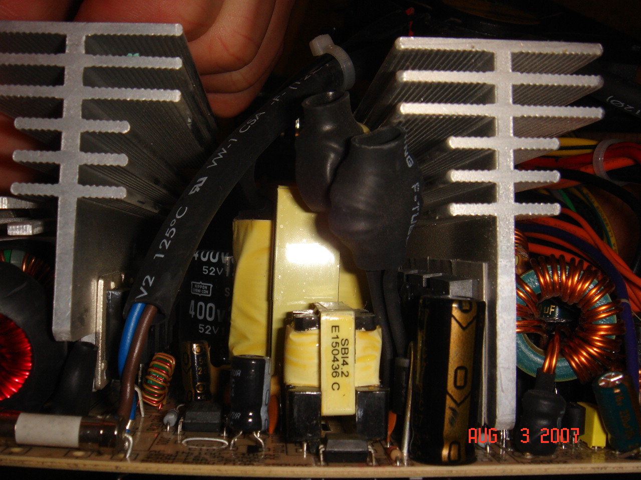

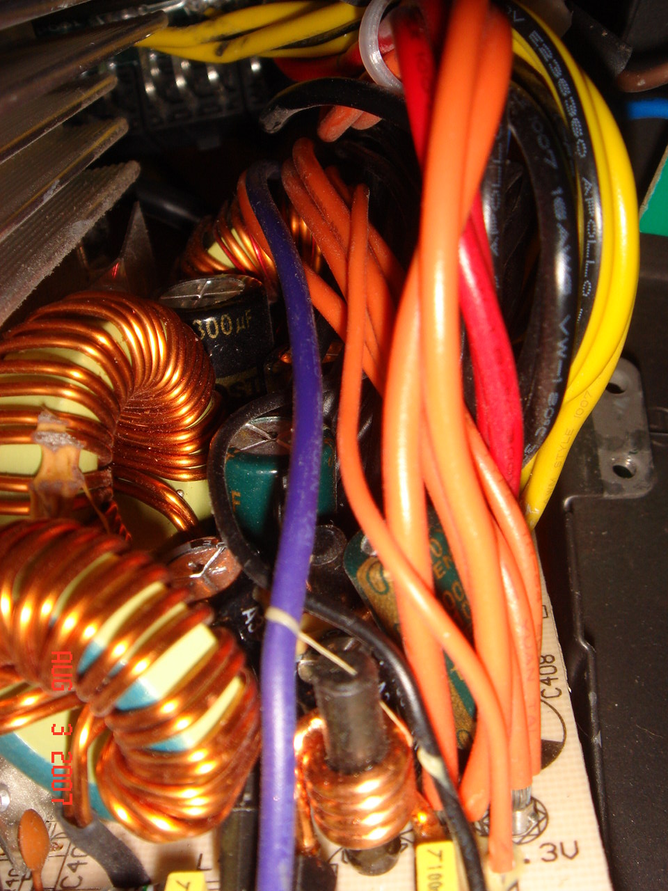

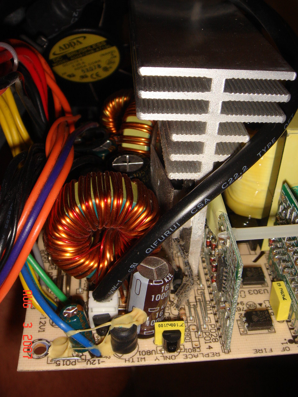

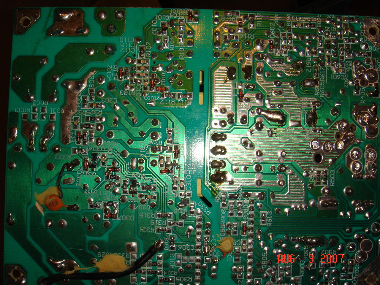

    Hi guys,
    This Antec died on me.
    Symptoms: When I start PSU it's fan spins for 2 secs then stops, PC doesn't power on.
    When I 'jump start' PSU without a PC the fan spins in low rotation and the readings in all rails are 0.0v.
    Where should I start to look first?
    I didn't see any sings of bulging caps or leaks, here are some pics:

    Re: DEAD - Antec Neo HE 550 (no signs of bad caps) - with pictures
    I have 4 of these, I hope whatever yours has isn't contagious!! In a PSU, just start at the beginning and work your way forward. Start in the primary, if its working on the primary side, move to the secondary (which is likely where the problem is). Check FET's and regulators. These are Seasonic guts, they don't have capacitor issues under any kind of normal use........but on that note, I know how you run your PC's... HAHA
      lOl Chris you bet! But those 18amps can't handle that DFI
      I use a OCZ Powerstrem 520ADJ, I need 32amps on 12v rail for that and ajust the volts to 3.35v - 5.18v and 12.18v for stability.
      This NEO I got from other PC that was supposed to be dead.
      PC is working fine but this Antec is dead.
      I'll try to follow your tips can you just poit on the pics what is the primary and secondary that you mean I should start working (my 1st psu ressucitation hobby/job).
      Thanks!
