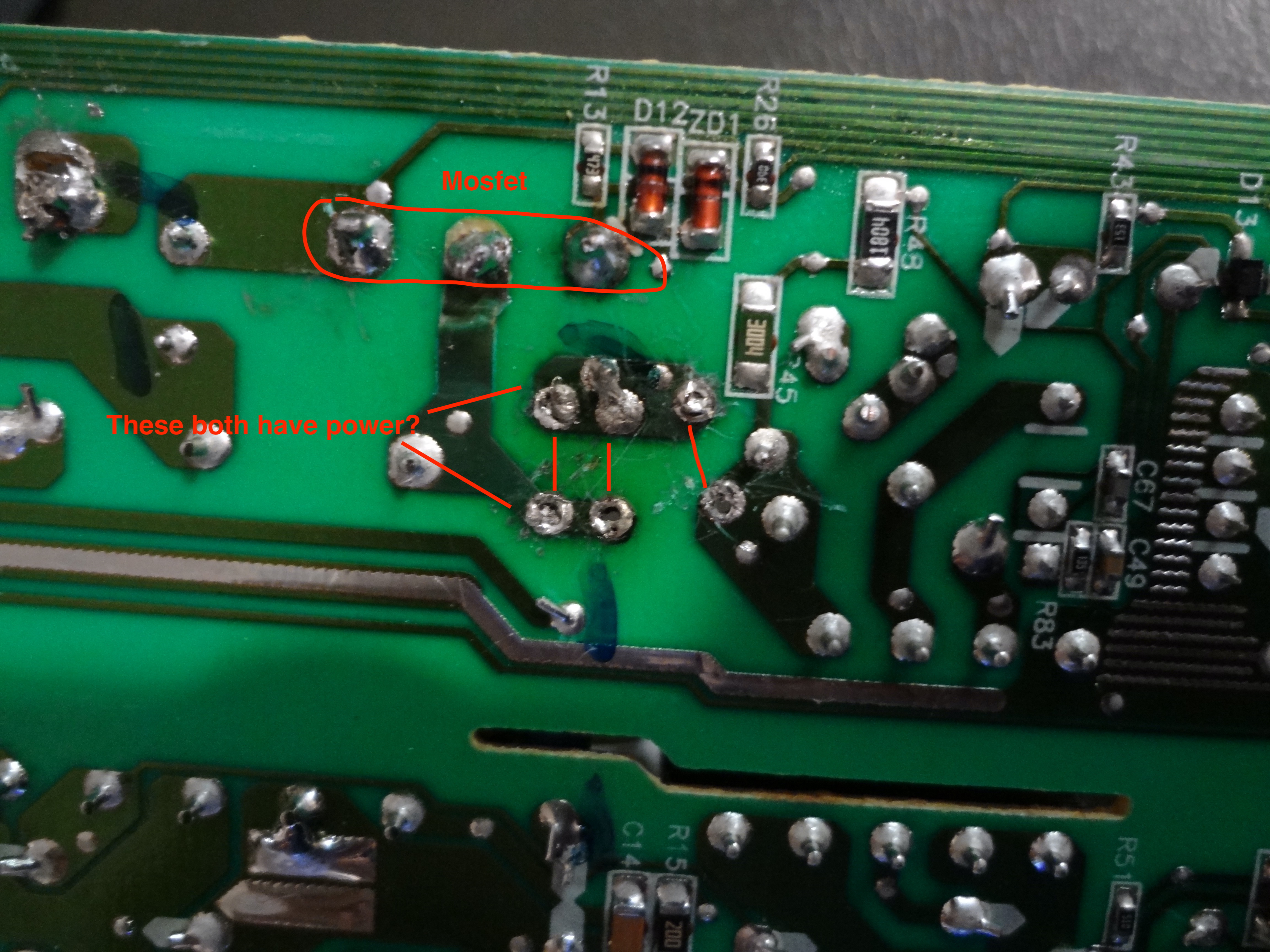

    I have 2 Dell Optiplex 790 SFFs that both have dead power supplies. When I plug them in I can hear a spark so they are at least drawing power. I've checked all the power rails and there's nothing whatsoever. The self test button on the back does nothing also. I took it apart, plugged it in and probed the back until the voltage stopped at a mosfet. Is the problem with the mosfet or something else? I de-soldered it and when turned on it stays closed for about 4 seconds before opening again (tested with a multi-meter). The mosfet is this: https://www.indiamart.com/proddetail...047252730.html . Any help is appreciated.

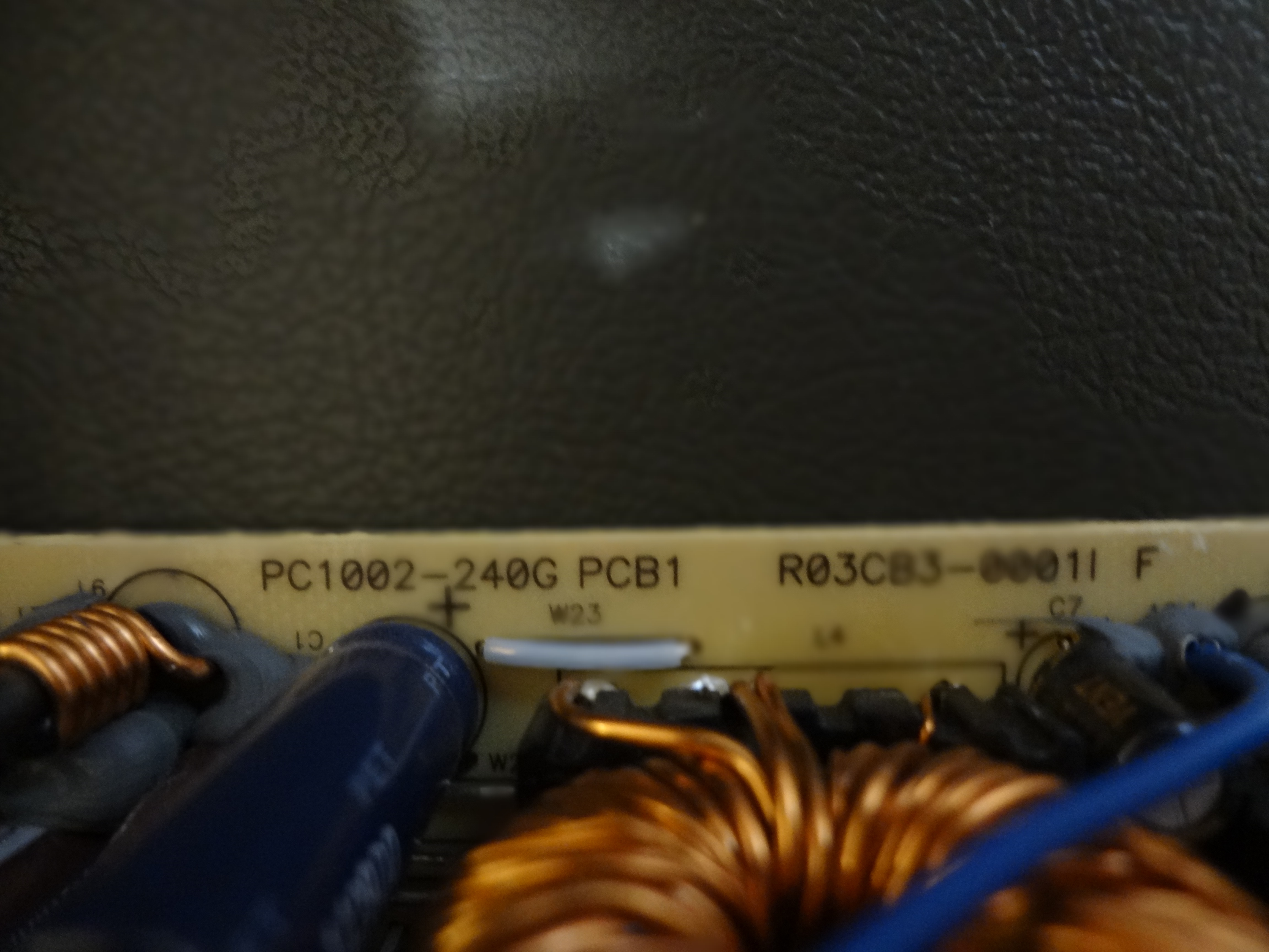

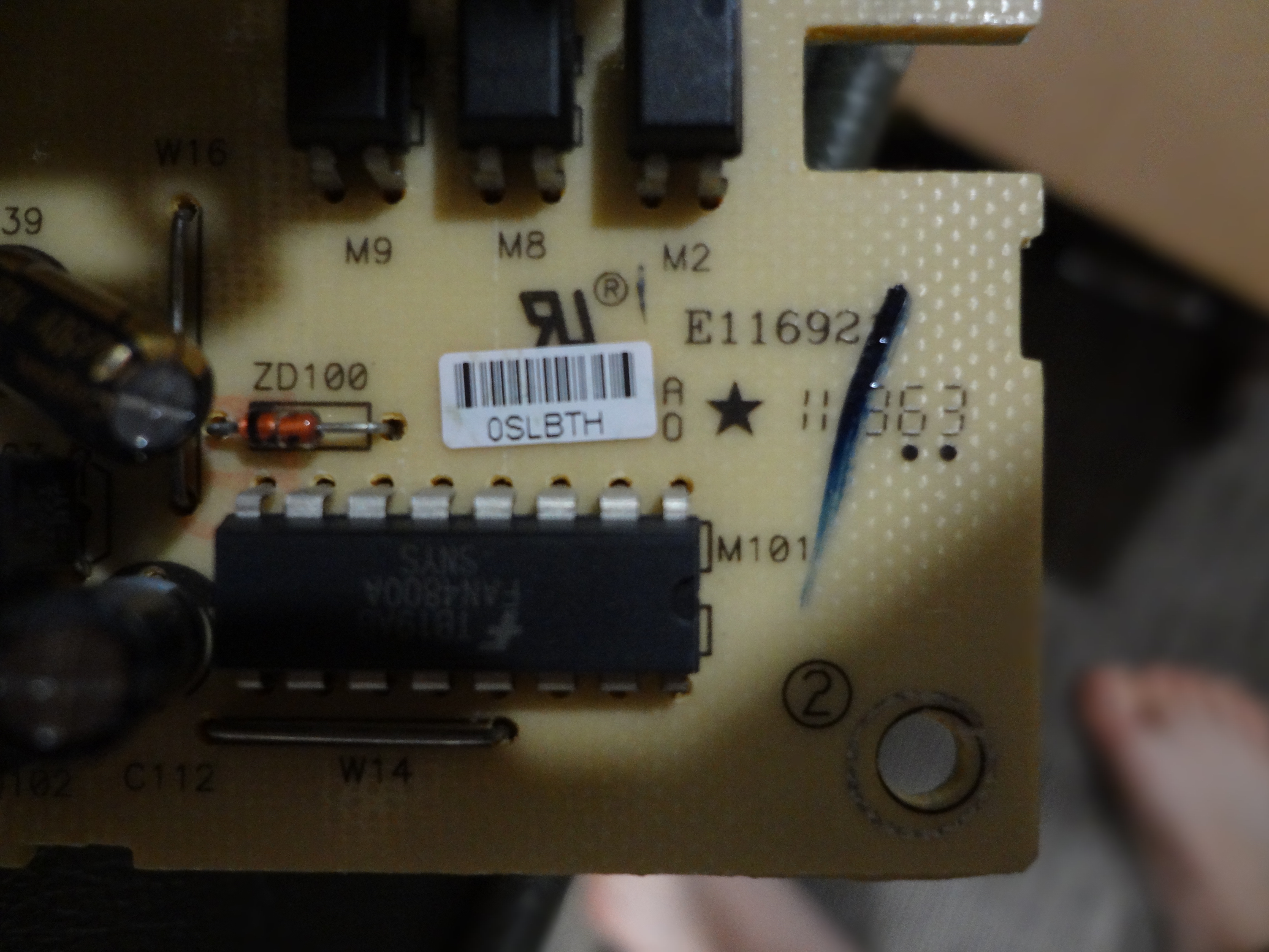

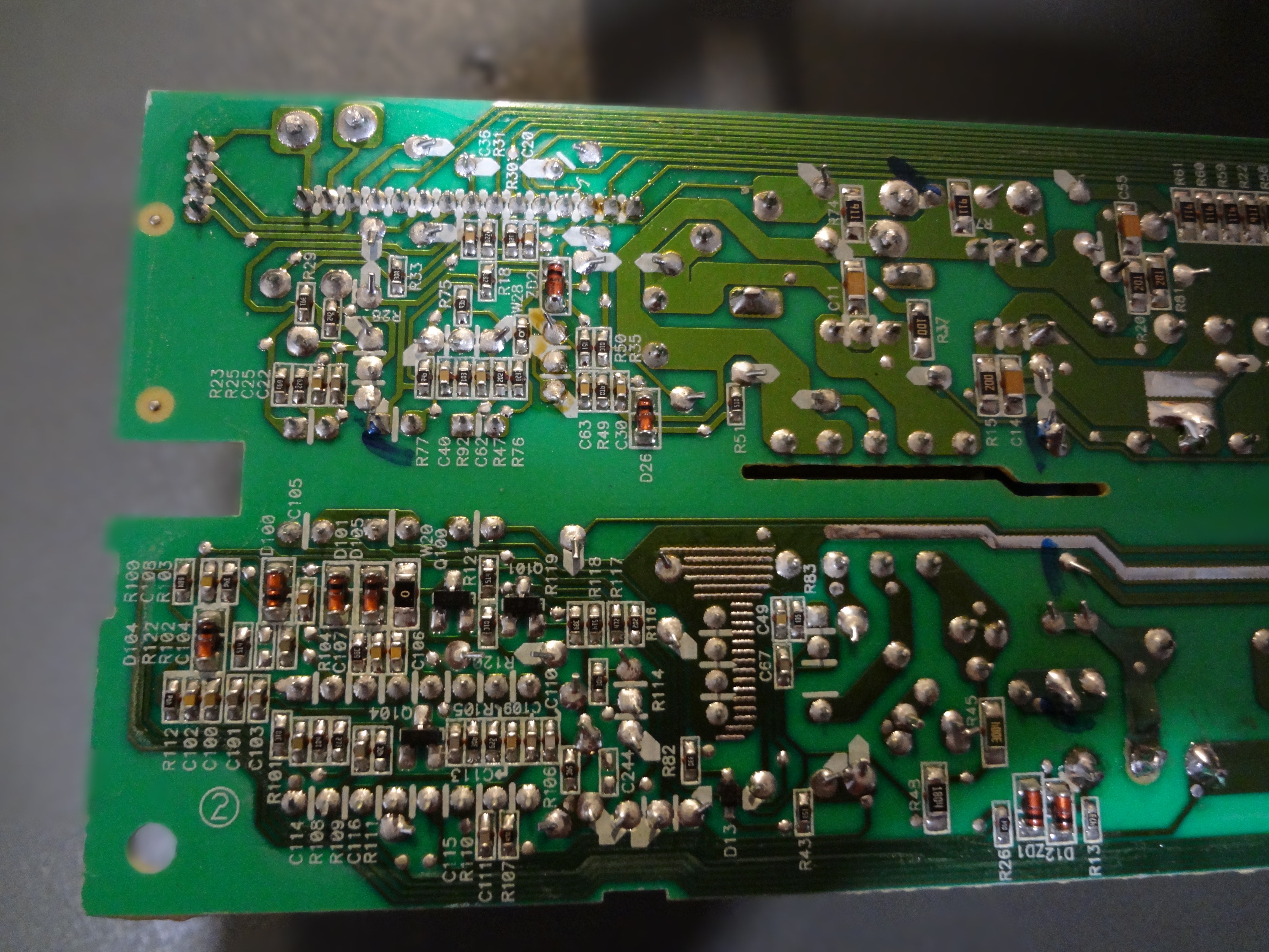

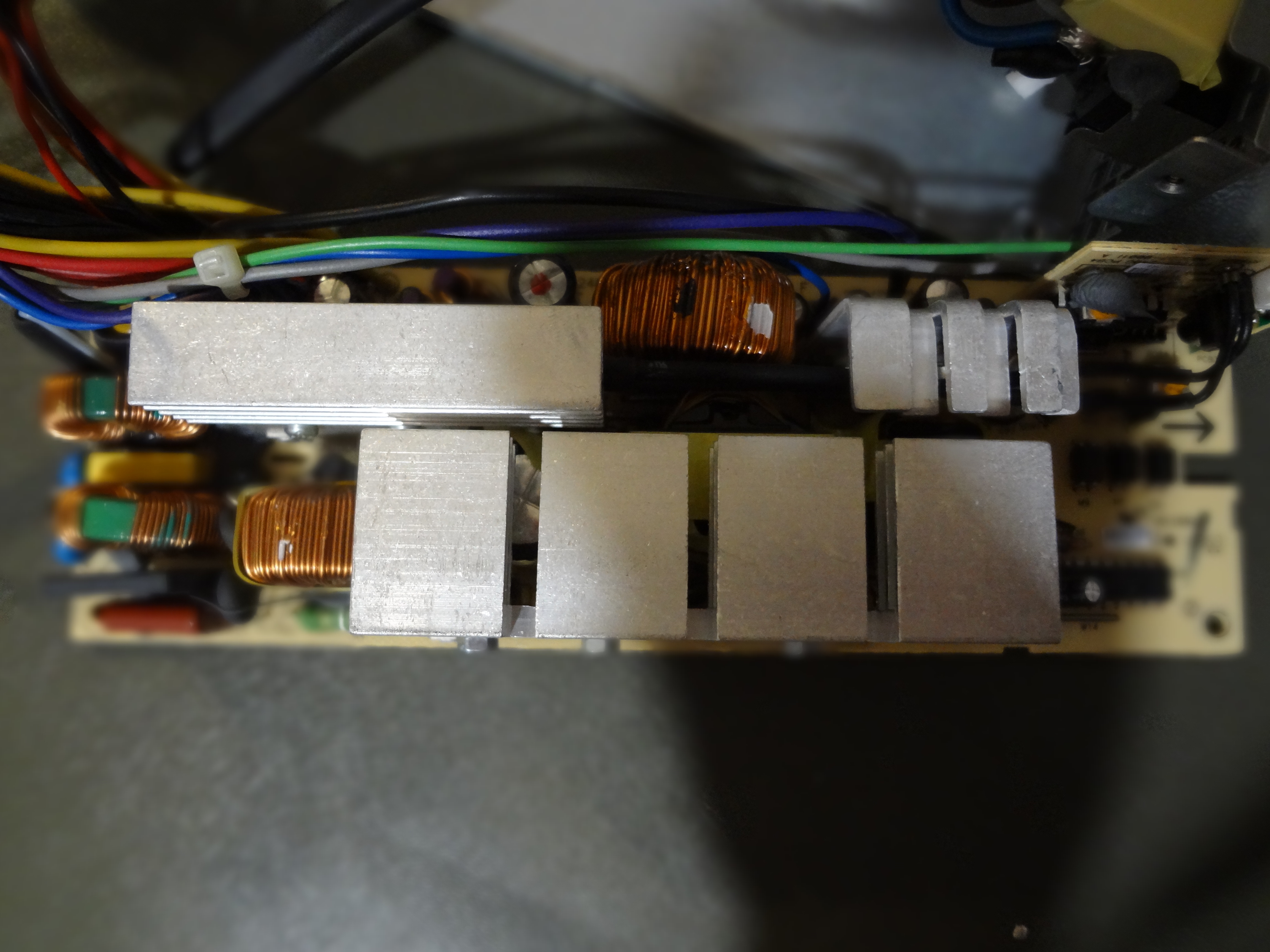

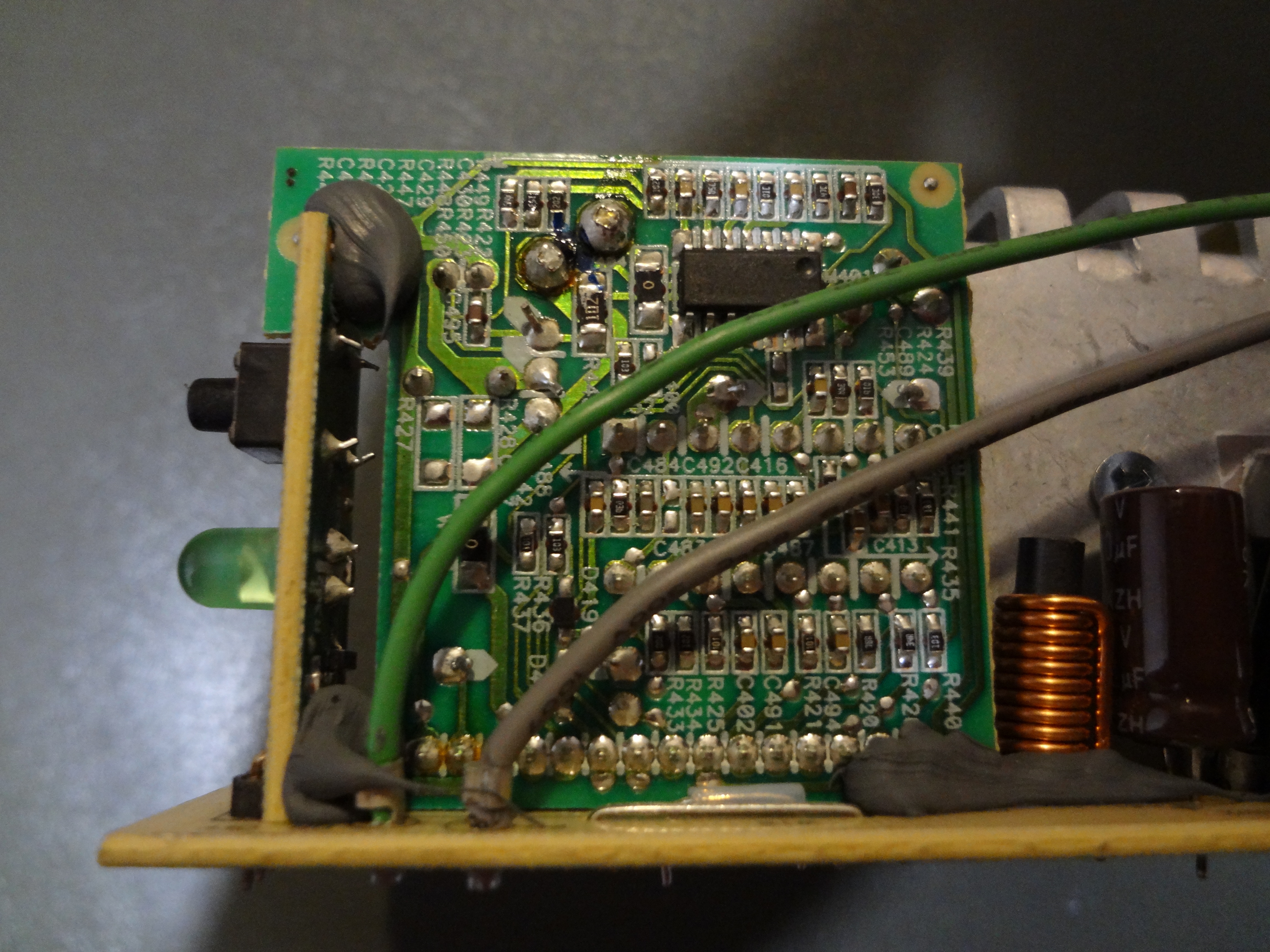

            I guess we need straight shot pictures of the board,. Upload them using the attachment function and choose like a small or no thumbnail.
            iI thought maybe the starter cap had dried out and that's why the PSU doesn't turn on when cold.
            • Luke Mawdesley
              • 20

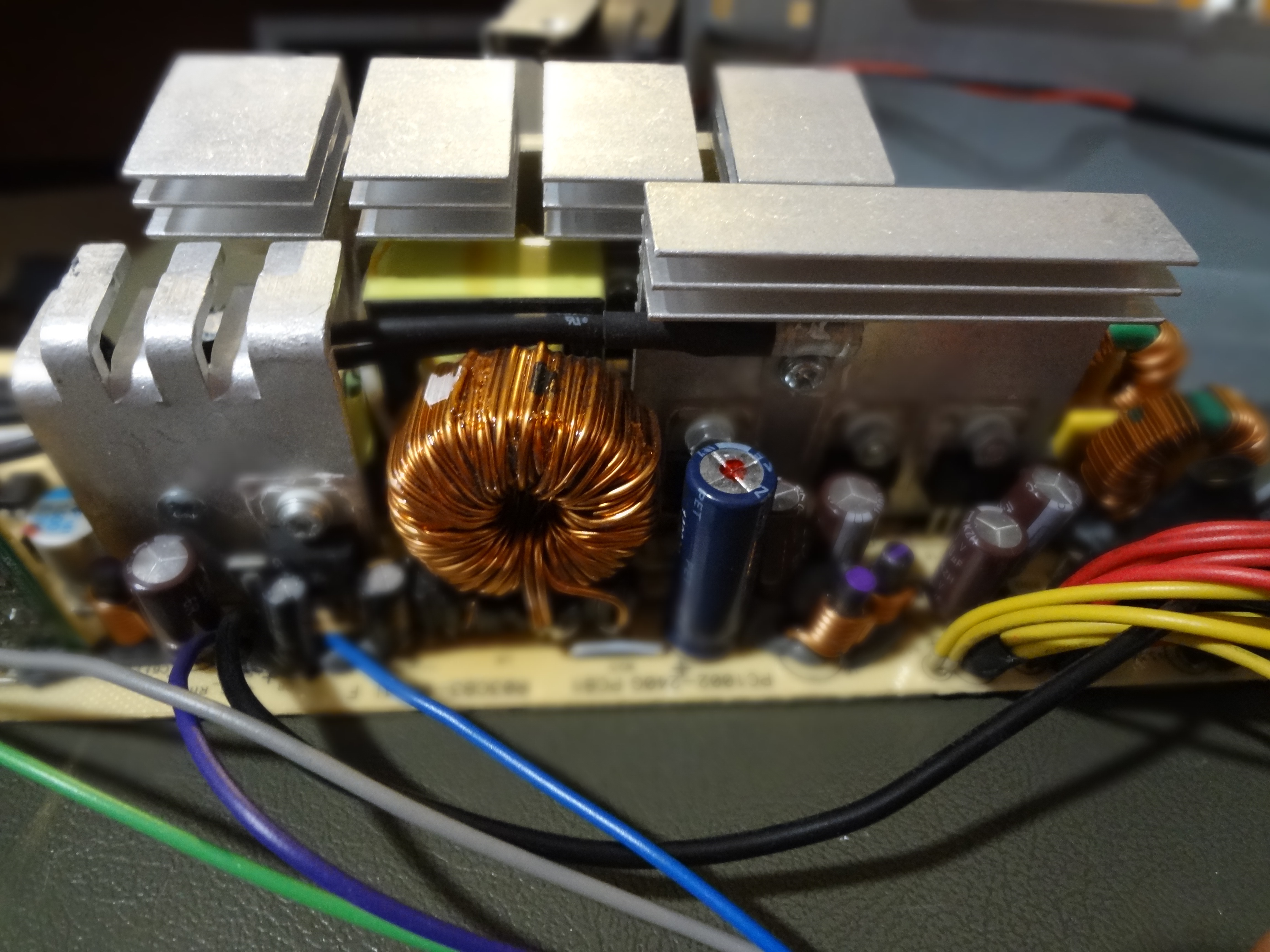

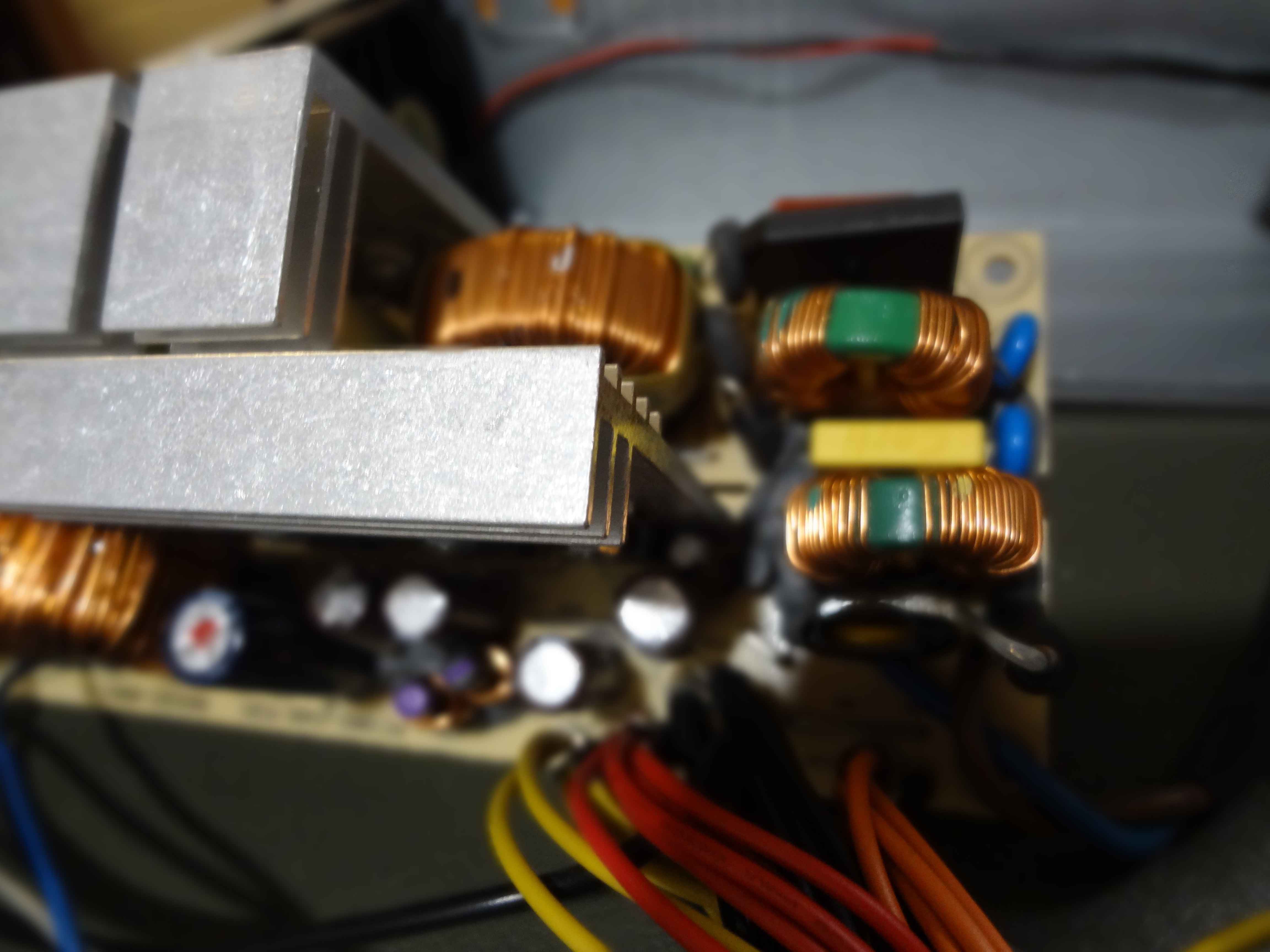

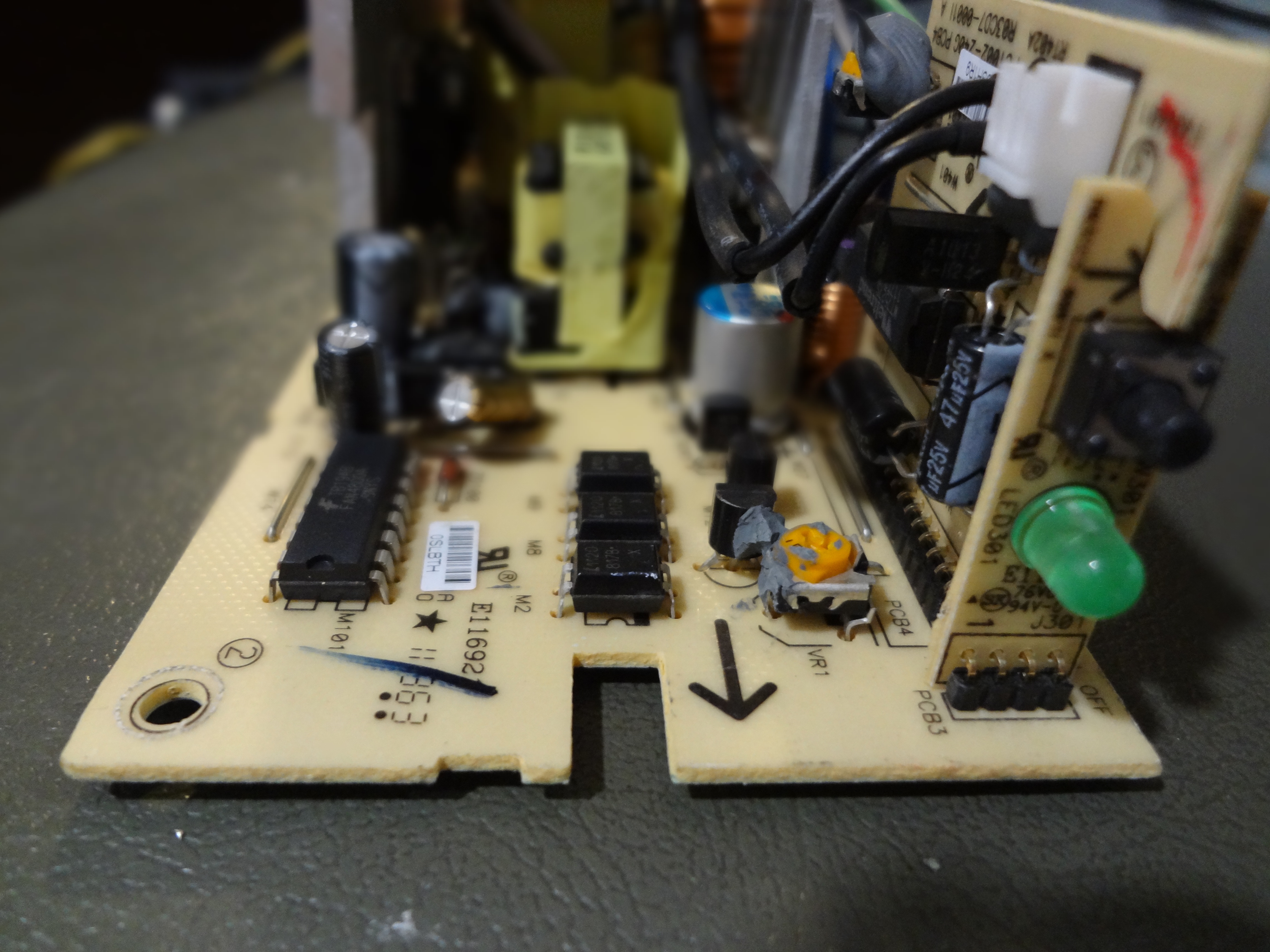

              Here are some pics:
                • 21830
                Originally posted by Luke Mawdesley
                Here are some pics:

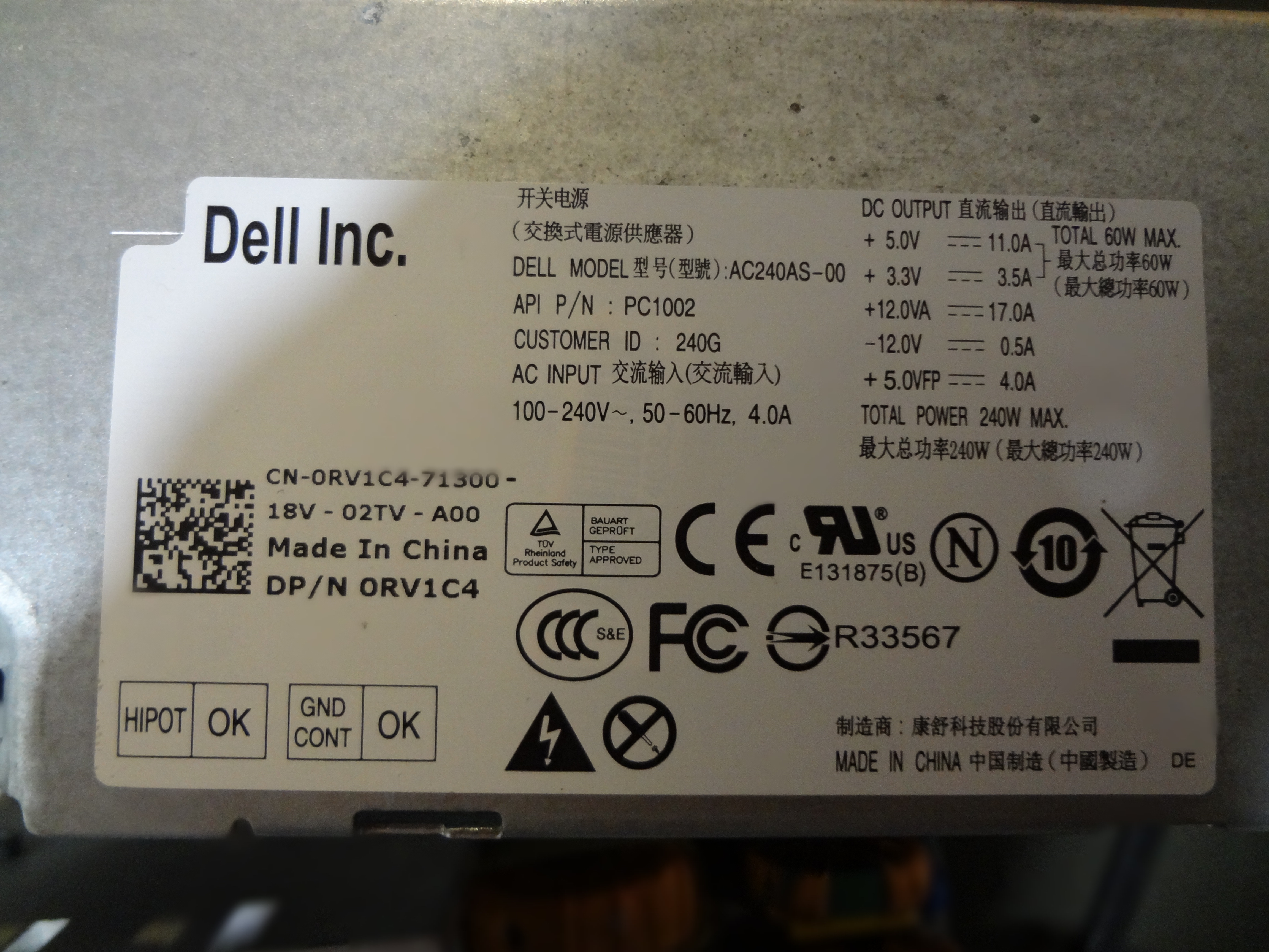

                What model number is on the PCB ,and on the sticker on the metal cover
                • Luke Mawdesley
                  • 20
                  Here

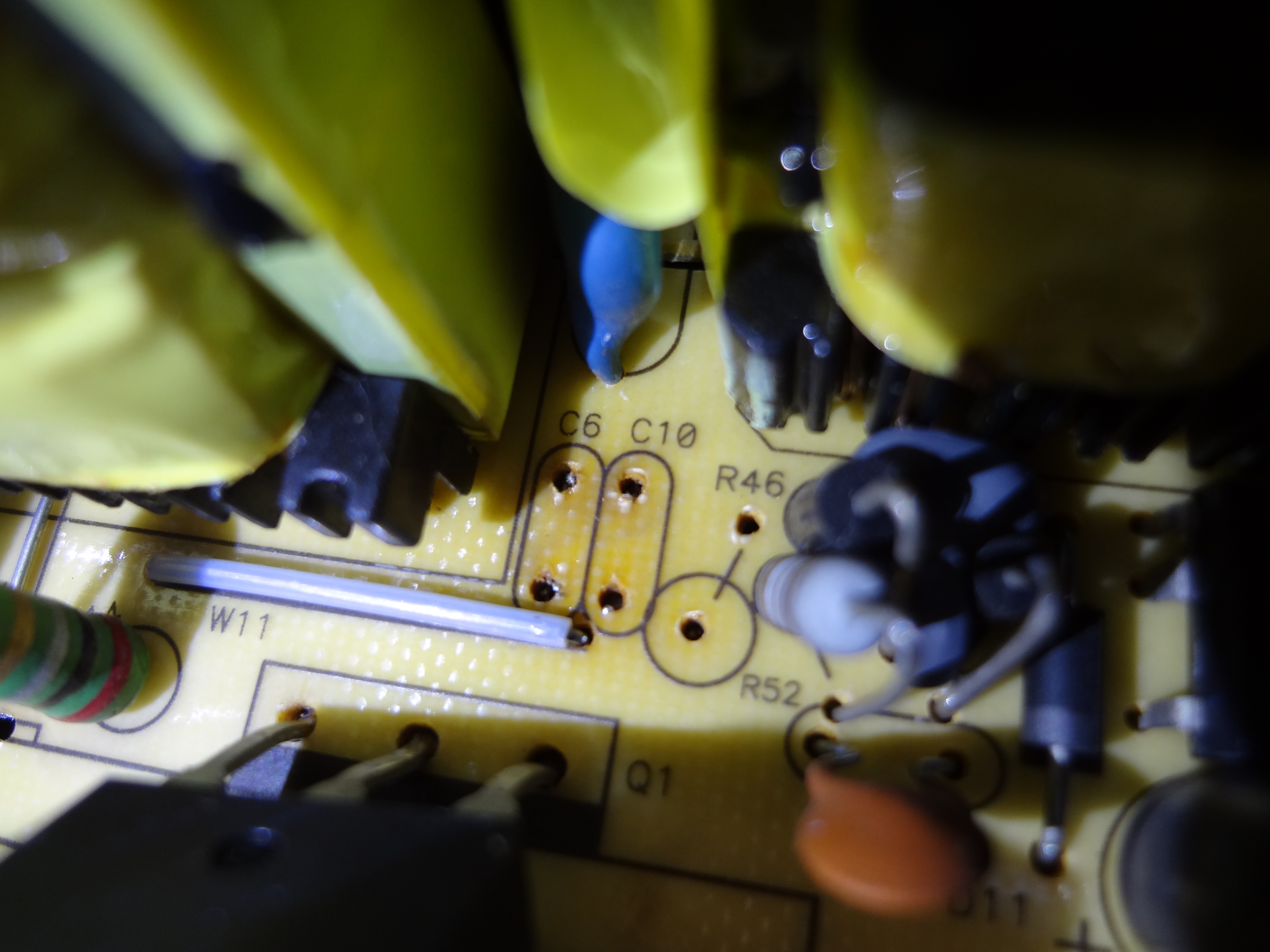

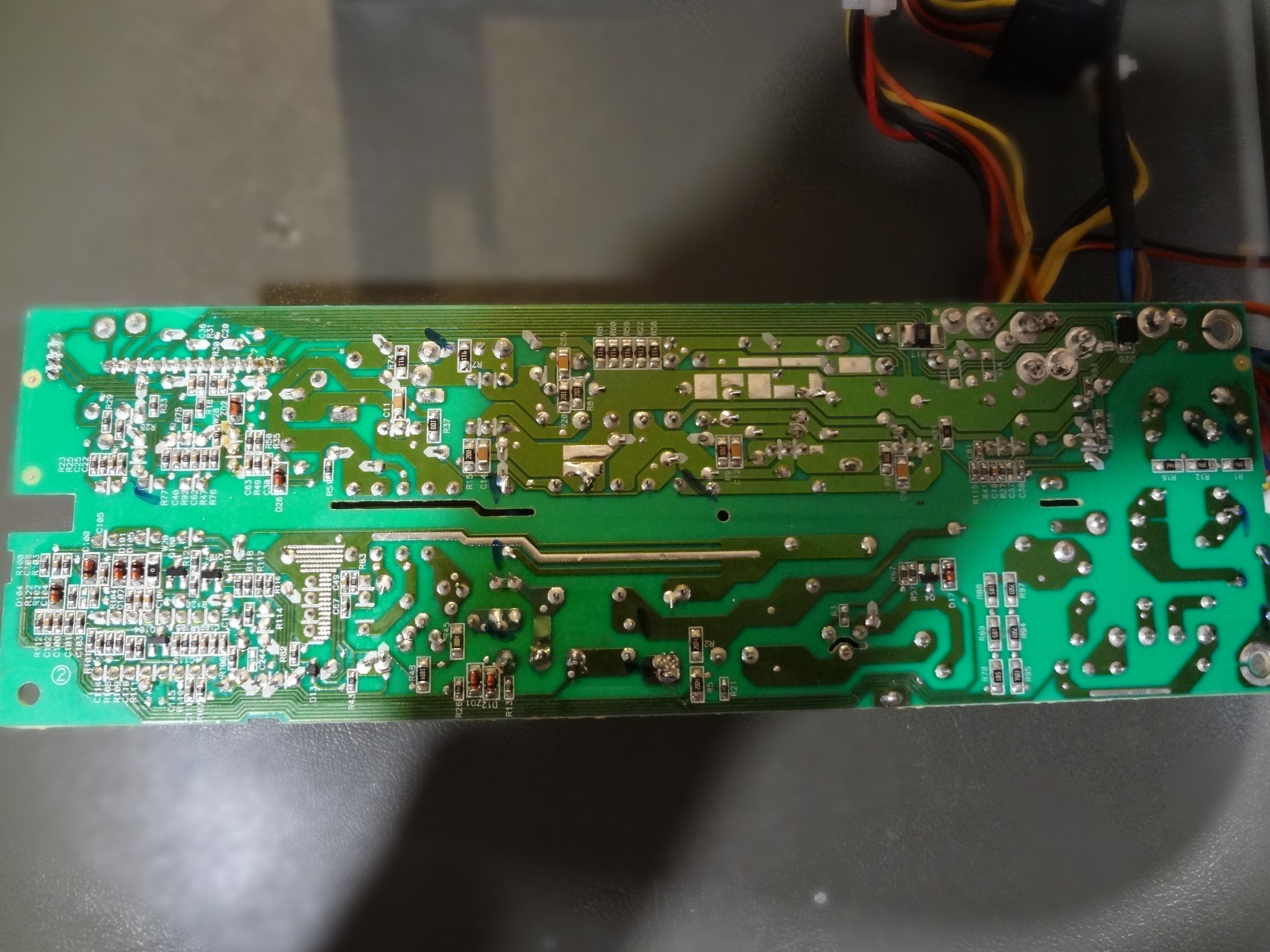

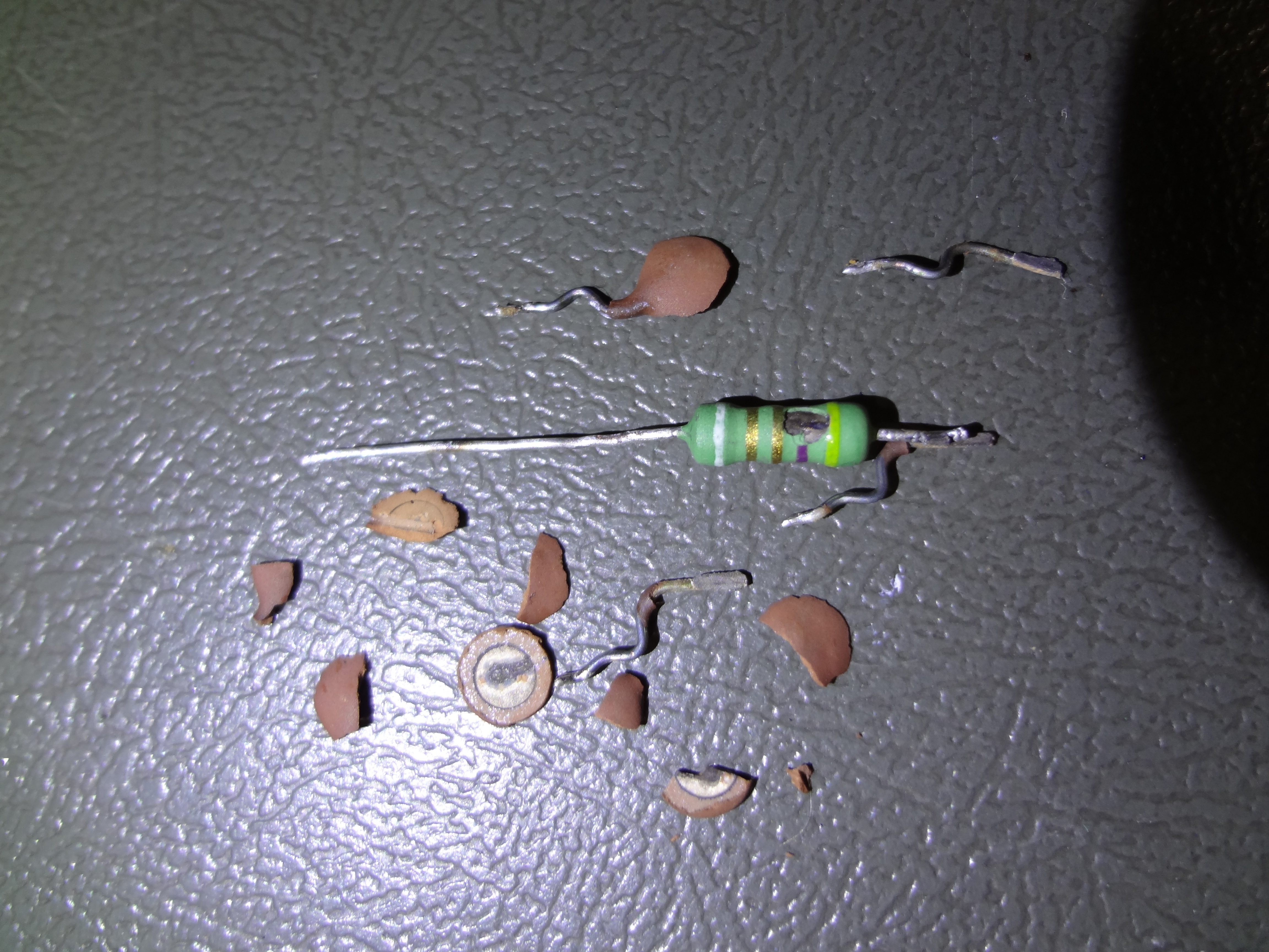

                                  There was no power anywhere near the chip, however I found the issue somewhere else. I was looking more closely at where the voltage stopped and saw that 2 small capacitors similar to these had blown out and were cracked as well as a resistor that was blown. Should I try replacing these or is there another problem that might make them blow again?
                                  Edit: The resistor is a 4.7 Ohms flame-proof resistor. The capacitors are completely destroyed so I can't tell anything about them.

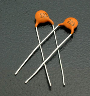

                                    The flameproof resistor acts like a fuse, since it so low in ohm rating. And there is probably where your voltage to the 5VSB stops. The capacitors… they are looking kind of these shown in the picture? Be careful around there we might need to be able to identify them. What colour are they? Anything printed on there or are they burnt to crisp? Pictures? What kind of circuit are they in?
                                    • Luke Mawdesley
                                      • 20
                                      Here are some pics. There is no printing as far as I can see. Also there was power on both sides of the resistors and caps so not sure what that means.
