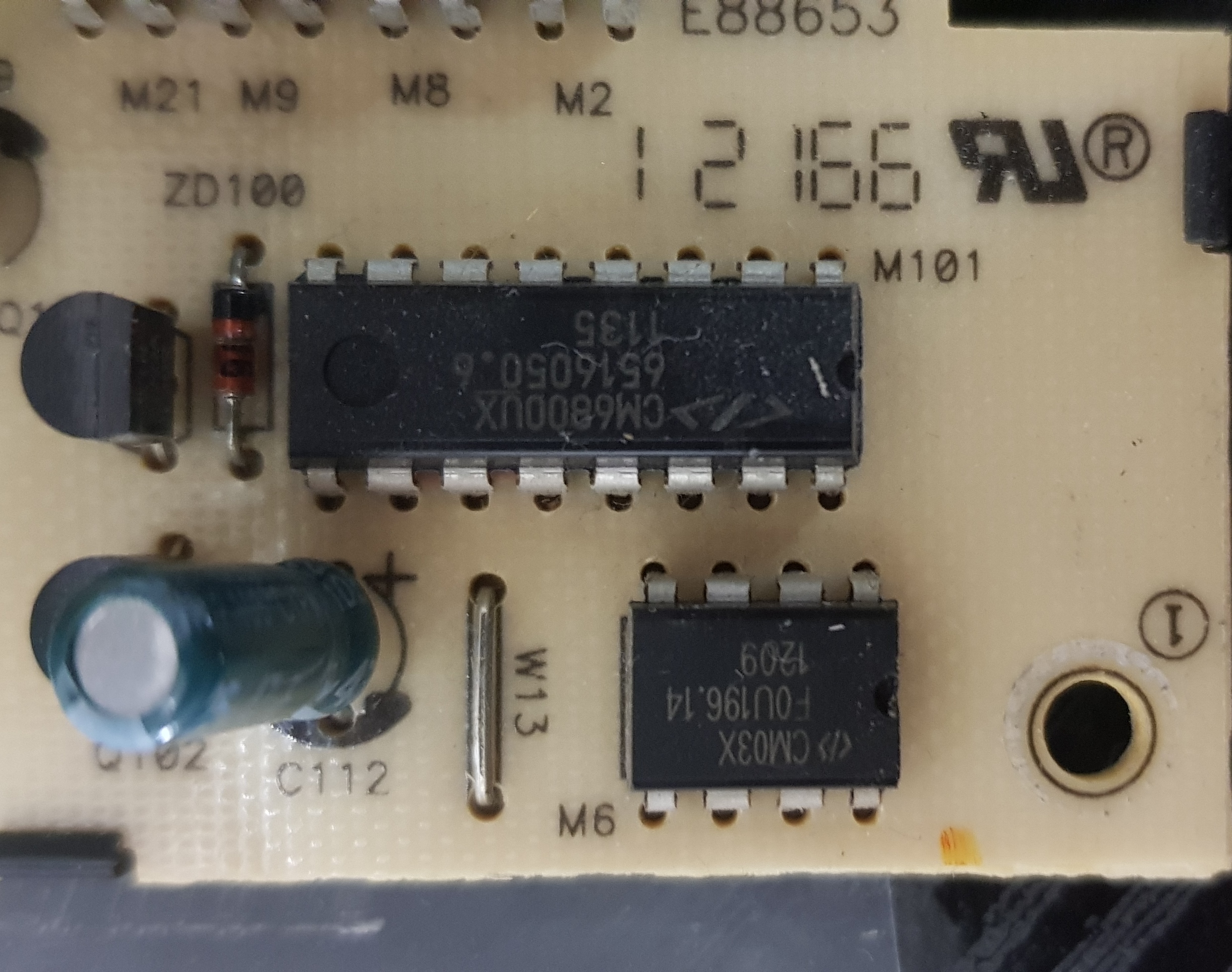

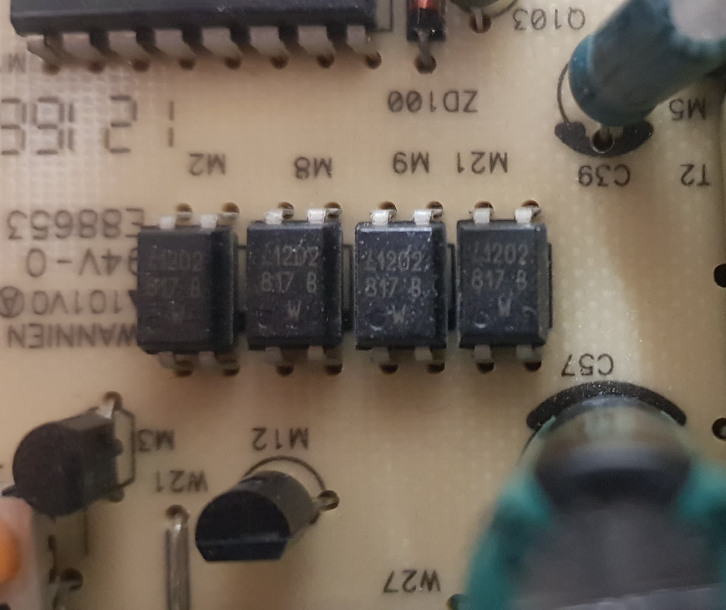

    Is it possible for you to tell me what the part numbers of IC chip
    M6 and M101
    M2, M8, M9, and M21 are they all the same part number and what is the part number

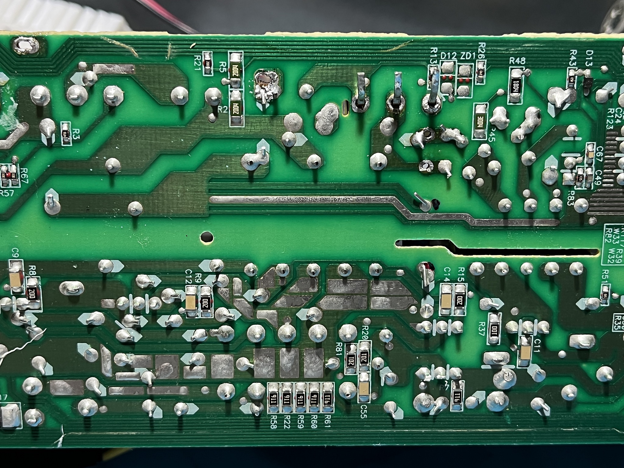

    Also could you please take a photo of the bottom of the board

      more pcb pictures please.

          thankyou for the responses here. Attached are pics showing the chips and board underside. Here are the caps I can see:
          c112 25v 47uf
          c34 50v 100uf
          c39 can't see (v small cap)
          c37 10v 2200uf
          c496 25v 47uf
          c61 10v can't see f

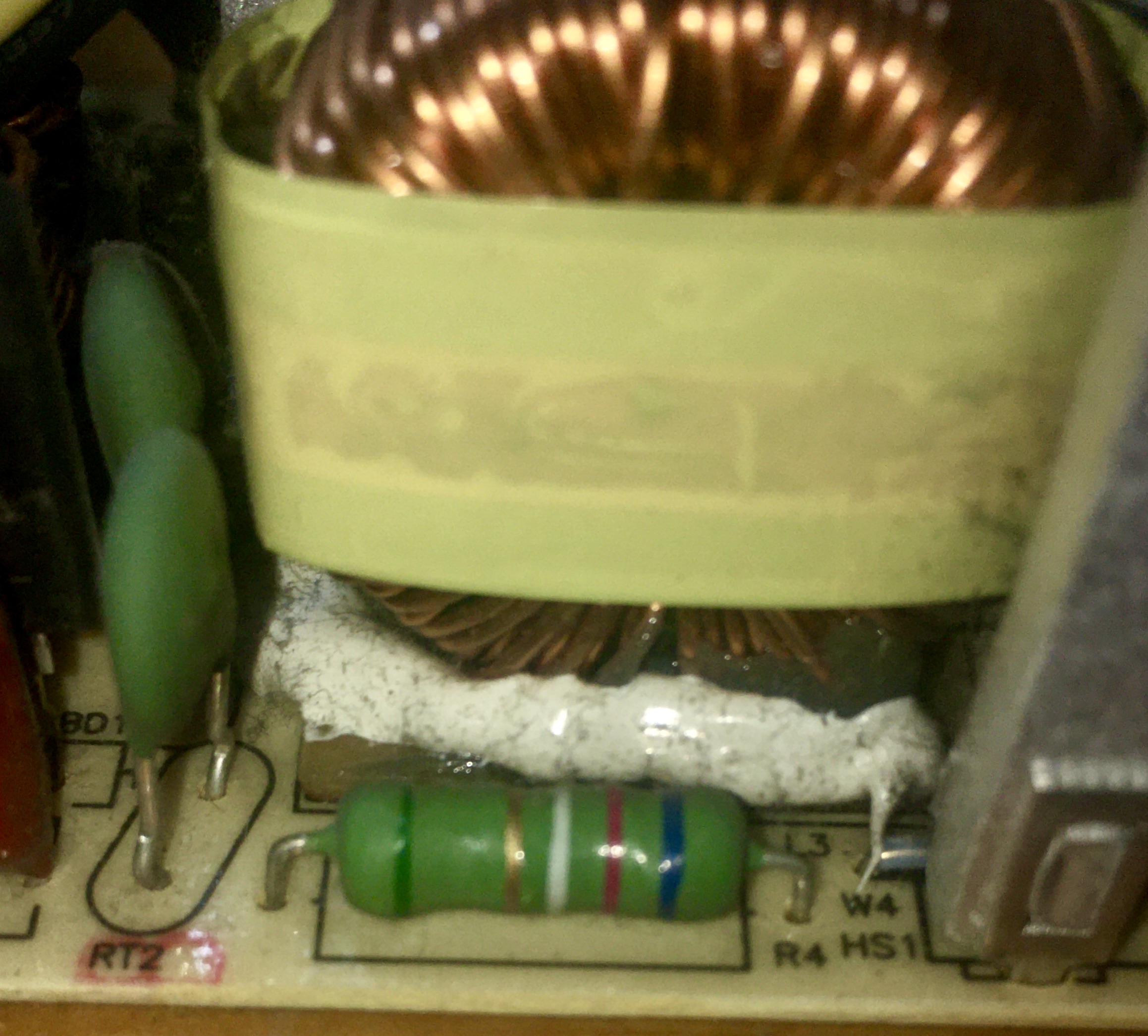

                  Hello guys, new here, I see the post pretty old , but can you please tell me the value in ohms of the resistor that I encircled in the photo, I have an identical PSU on my bench now that is not working because of that resistor being burnt completely and can't tell the values.
                  Thank you in advance!
                  • Taruga
                    • Dec 2013
                    • 20
                    • Portugal
                    Re: psu ac240as-01 dell Optiplex 7010 pc tower
                    5 Band resistor
                    BLUE RED WHITE GOLD GREEN
                    63 Ω ?! If my eyes got the right colors

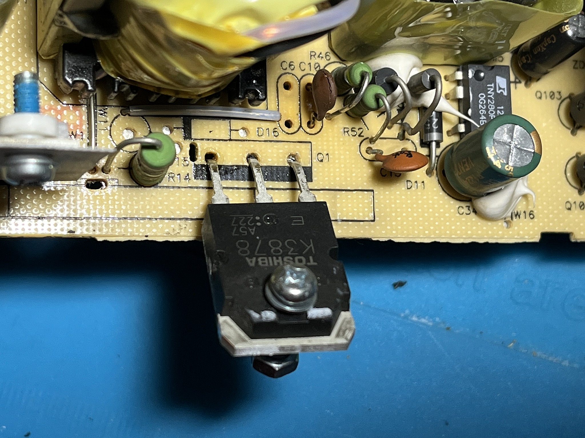

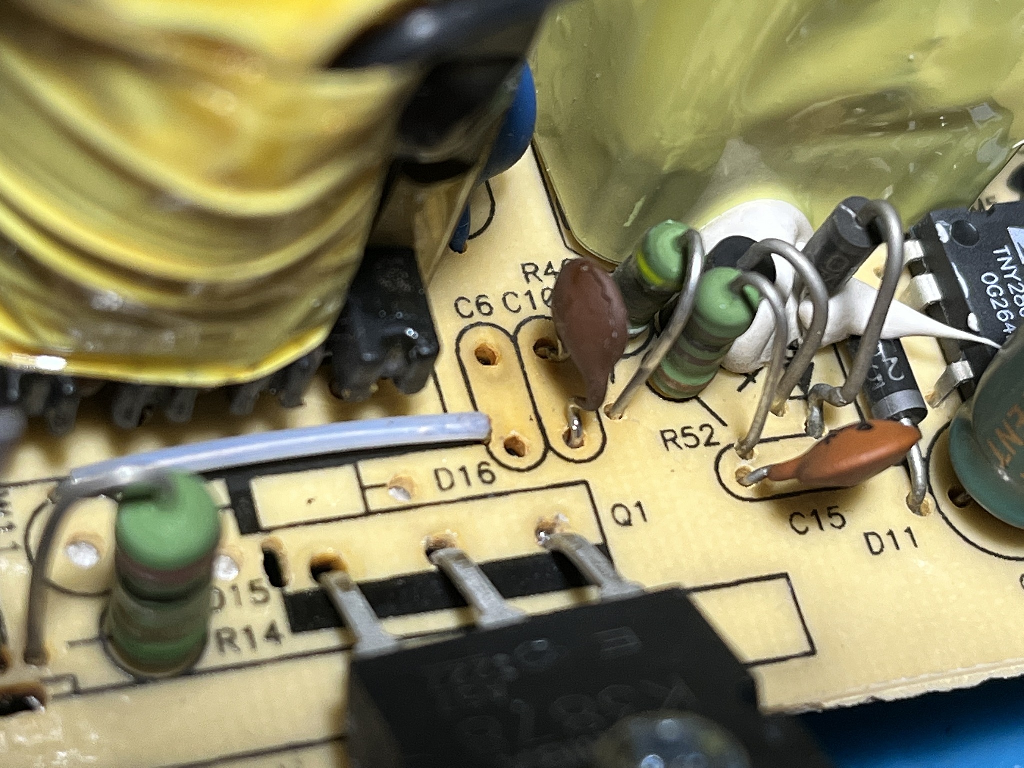

                      Hello everyone, in my case the Toshiba K3878 is shorted, also the C6 capacitor is broken and the C10 has a crack and should also be changed. The K3878 I've already ordered, but I'm not shure with this C6/C10 capacitors. Does anybody know which capacitors/values I should use? Thanks for any help ;-)

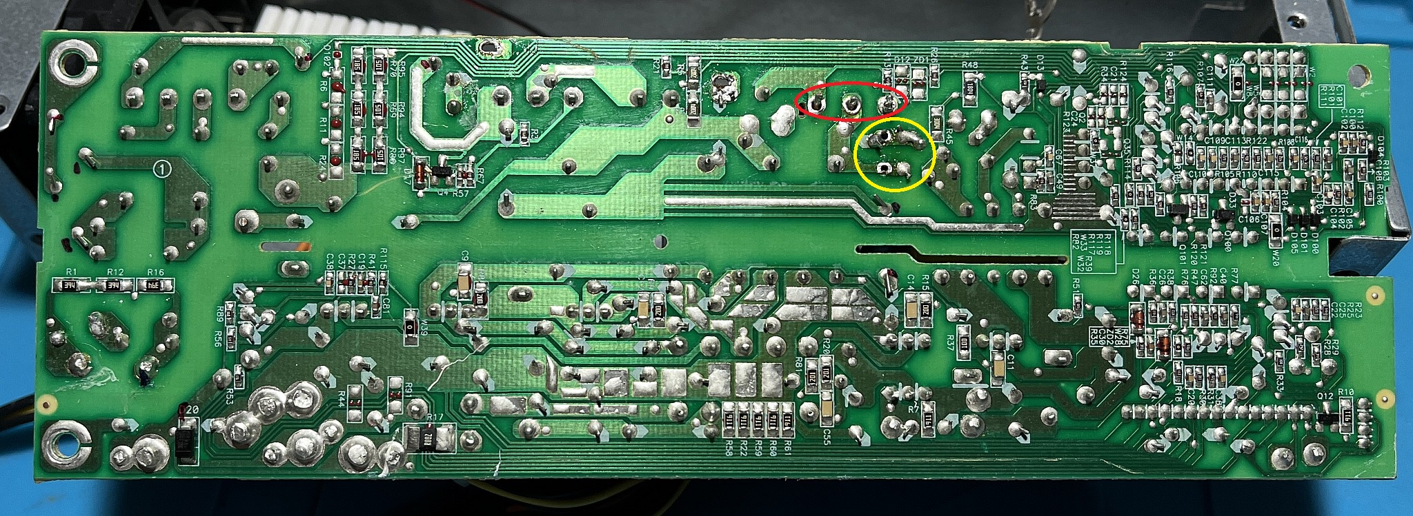

                          Thanks for the quick answer!
                          Yellow cycle on first foto: C6, C10 caps
                          Red Cycle: the shorted mosfet Toshiba K3878
                            • 31285

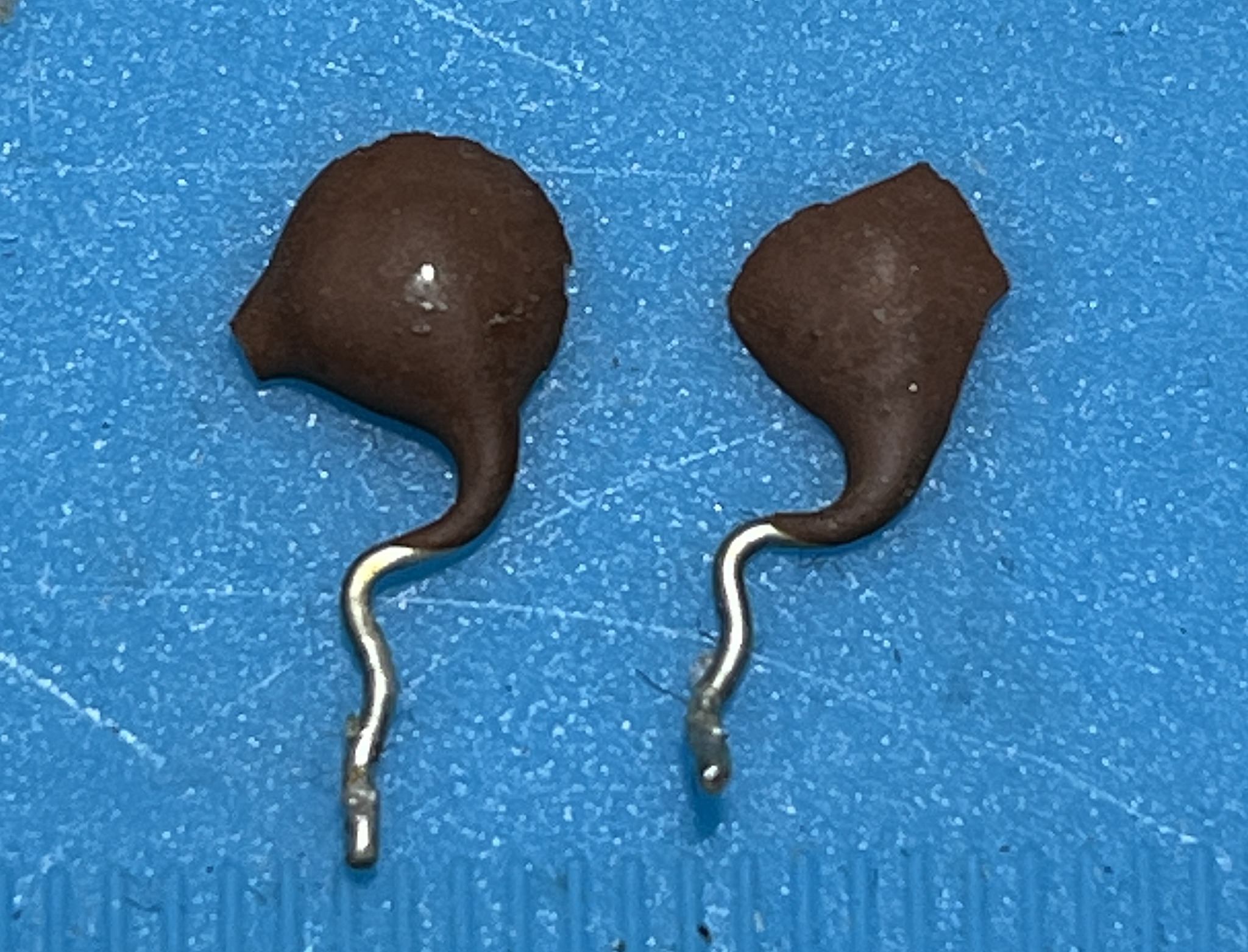

                            try using a single 680pF 2KV cap instead of c6 and c10

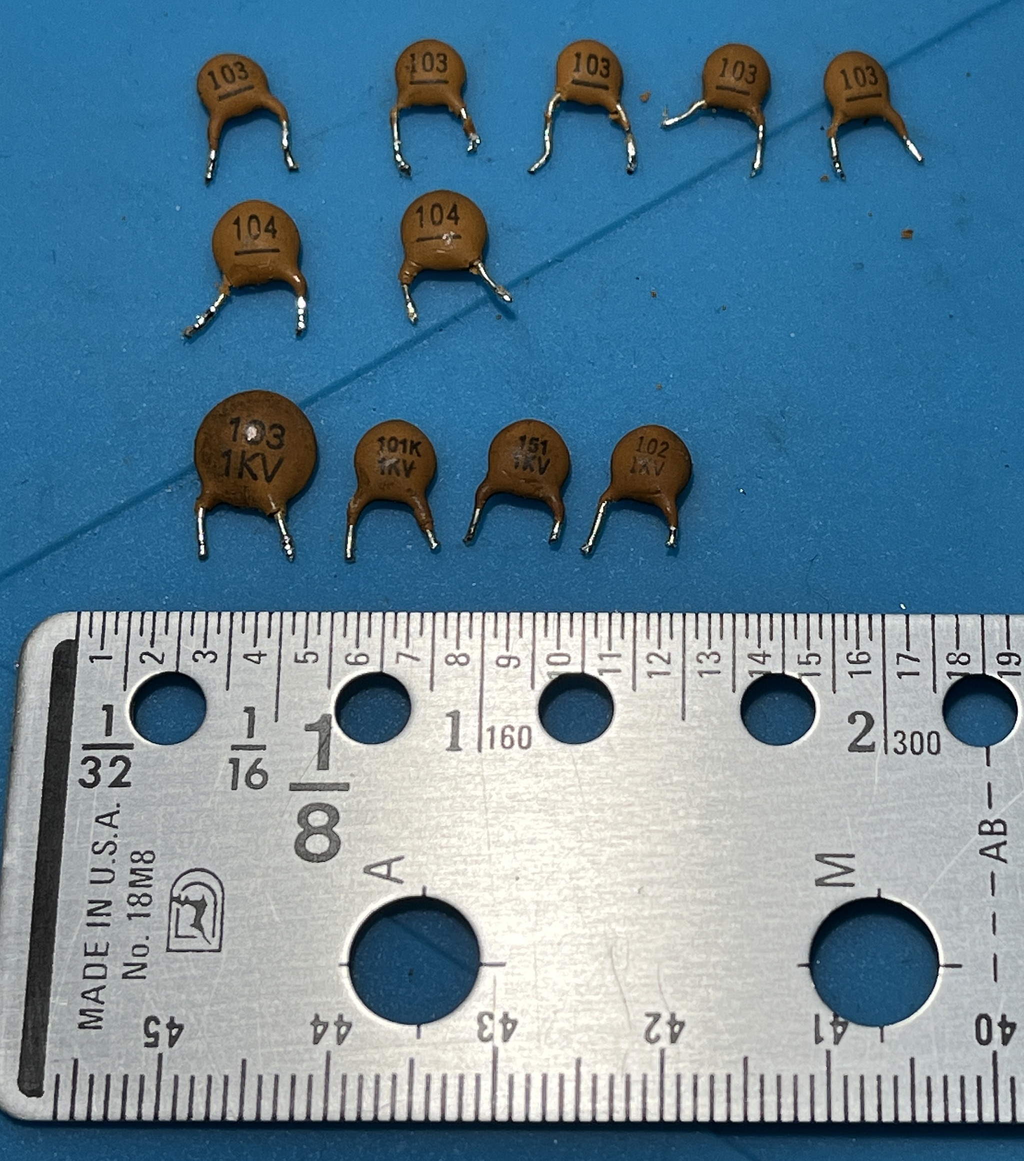

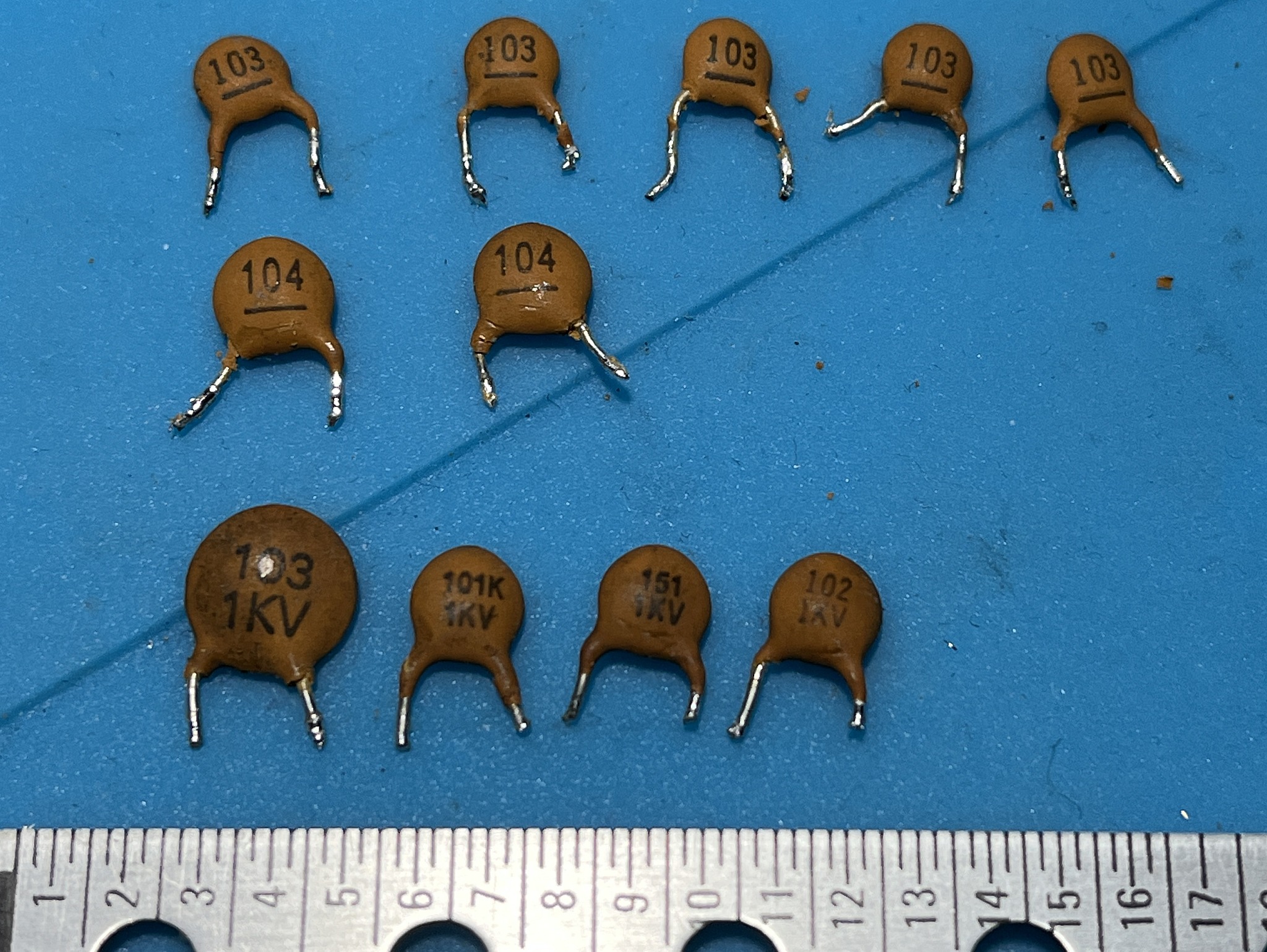

                              Thanks stj! One more question. I do have the following caps from another PC PSU at home. Measuring shows this data:
                              103: ~11-12nF
                              104: ~100nF
                              101/1KV: ~0,1nF
                              151/1KV: ~0,5nF
                              102/1KV: ~1nF
                              103/1KV: ~10nF
                              I don't know how much V the 103/104 caps have, but may I also try 101/1KV in combination with 151/1KV, or the 102/1KV alone, or is it dangerous because of the need of 2KV?
                                • 31285
                                1KV will fail - like before
                                that psu and a couple of similar ones have this problem - a 1KV cap cant handle the current.
                                2KV caps a physically larger and can disipate the heat.
                                btw, your 151/1kv is bad.
                                151 - 15 and one 0 - so it should read 150pF
                                • matser
                                  • Apr 2012
                                  • 30
                                  • Austria
                                  Thanks for your help stj, in this case I will order also a 2KV cap.

                                    The caps arrived today, unfortunately I'm still waiting for the mosfet. I have more of this Dell 7010 optiplex SSF, so I opened up a working PSU and C6 and C10 also have a crack, but the PC was running normal?! I changed both caps to a new 2KV/680pf cap, to be on the save side. Maybe the mosfet died because of the broken caps. On a third one the caps seemed to be ok and it looks like they are labeled R 331K 1KV (very hard to see, I tried to take a foto, but it doesn't work), I changed them also (got more of this 2KV caps. The good PSUs are still working after I changed the caps ;-)
                                    I'm not an electronics engineer so it is a little bit strange for me that meassuring between the 2 holes of C6 on the board are showing a short (of course also between the two poles of C10). This is the same on the working PSUs and on the faulty one where I have taken away the shorted mosfet.
                                    As soon as the new mosfet is soldered in I'll tell you the result ;-)

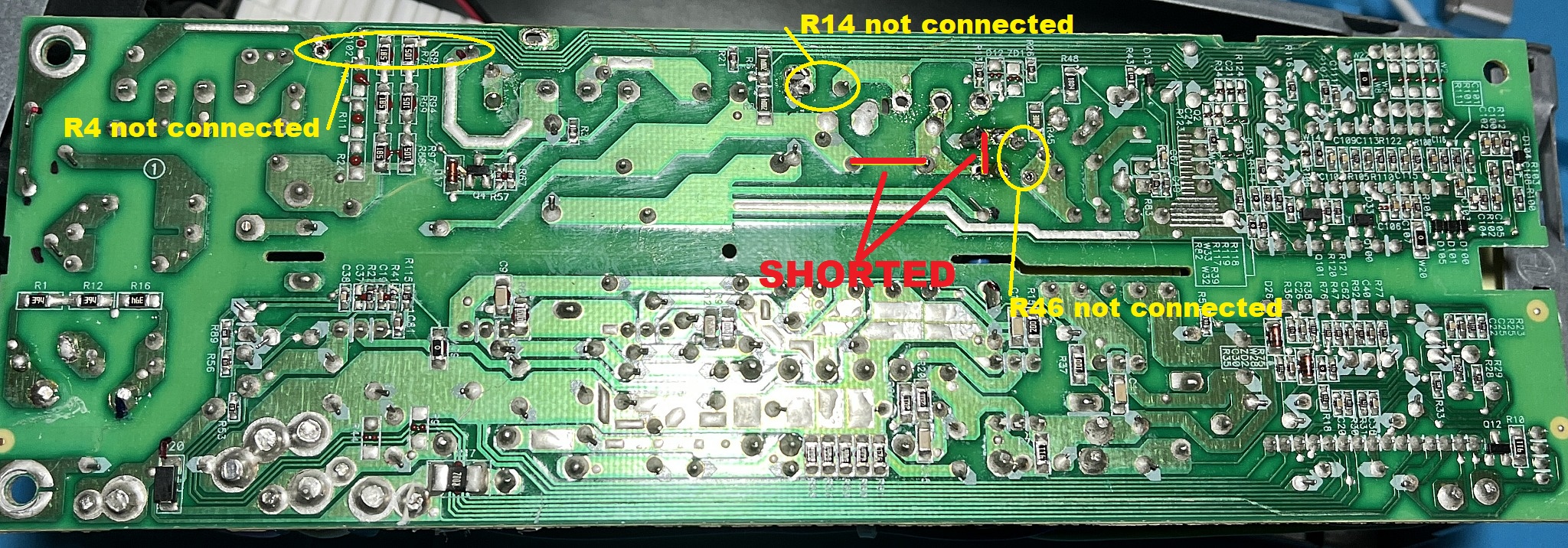

                                      you need to check all the resistors in the area, when the fet blows it can take other stuff with it.
                                      • matser
                                        • Apr 2012
                                        • 30
                                        • Austria

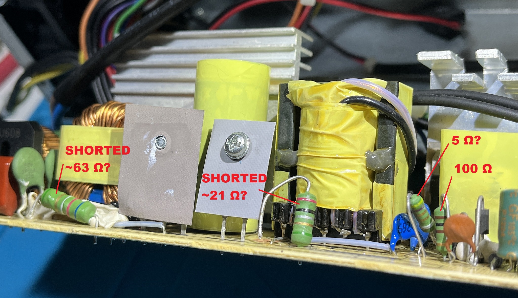

                                        I'm a litte bit confused now. Meassuring the restistors shows the following:
                                        R4 and R14 shorted (on faulty as on working PSU!)
                                        R46: 5 Ω
                                        R52: 100 Ω
                                        R4 should have 63 Ω, R14 not shure but I think ~21 Ω.
                                        Without R4, R14 and R46 connected, C6 (C10) is still shorted. I found another short with the near transformer (again also the working PSU shows the same short). Near diodes and caps seemed to be ok.
                                        Now I'm wondering how could the second PC work normaly with the same shorts in the working PSU?! The only difference I found until now was the shorted mosfet.
