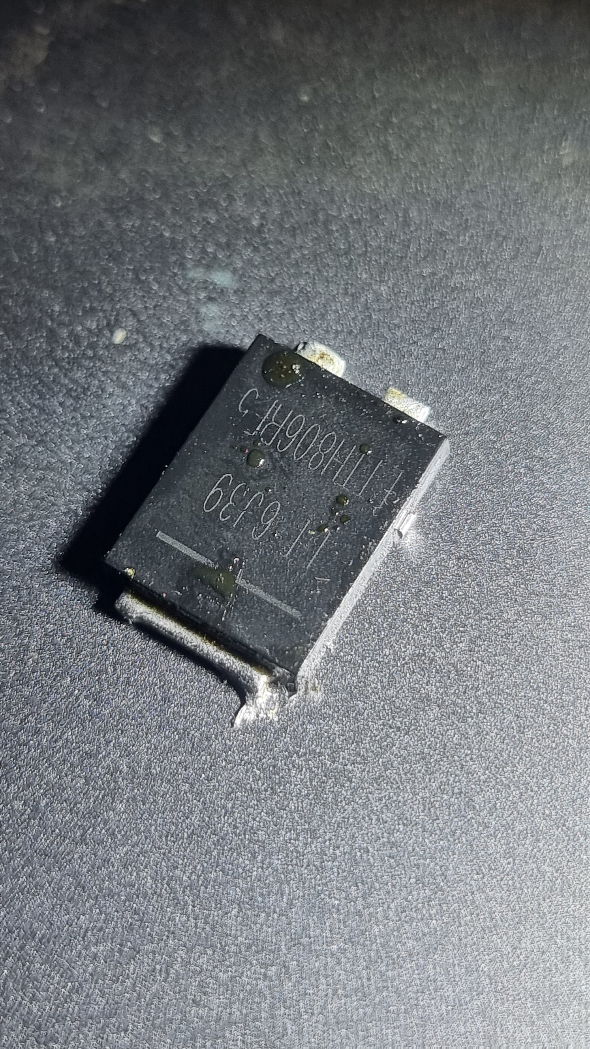

Help identify please LTTH806RF5
  • sikocan
    • Oct 2019
    • 338
    Can anyone help me identify this diode? Its from LiteON I believe it's rectified diode. I could be wrong. It's from a psu. It is shorted. Thank you
    LTTH806RF5
    • 20276
    It was a Lite-On part, but Diodes Inc. bought them out https://www.diodes.com/part/view/LTTH806RF5
    • sikocan
      • Oct 2019
      • 338
      Thank you, I bought these
      https://www.digikey.com.au/en/produc...zNhFcsIDyPjV1Q
