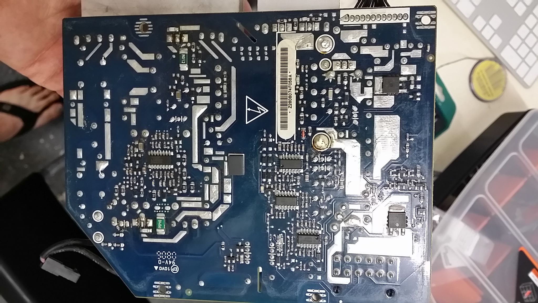

    Hi everyone, got an aluminum 24 imac with a faulty PSU. First LED on the motherboard is on so trickle voltage is OK. When pressing the power button, 3 lights flash and then only one, 2 seconds pass then again 3 flash then back to one. I've tested motherboard with working PSU and all is well so not a motherboard issue. I can hear a clicking sound coming from the PSU each time it tries to power on. Also, when the power cable is connected, I notice one of the fans on the imac twitches. Very ocassionaly the imac will power up a bit but will eventually die again. All capacitors look absolutely fine, no bulges, leakage etc. I've had a look at the back of the PSU and I think I found the culprit. One of the mosfets looks blown. The board is darkish in that area and the solder on the front of the mosfet looks bad and its slightly lifted. I've provided photos, problem mosfet is on upper right. Thoughts? Also, does anyone now the part number for the mosfet I can't really make it out as it's heated so much, the numbers arent really legible? Would like to try soldering a new one. So if anyone know I would greatly appreciate it... Thanks
  • bosscharles
    • Mar 2013
    • 83
    Re: iMac 24 PSU LITEON PA-3241-02A1 250W

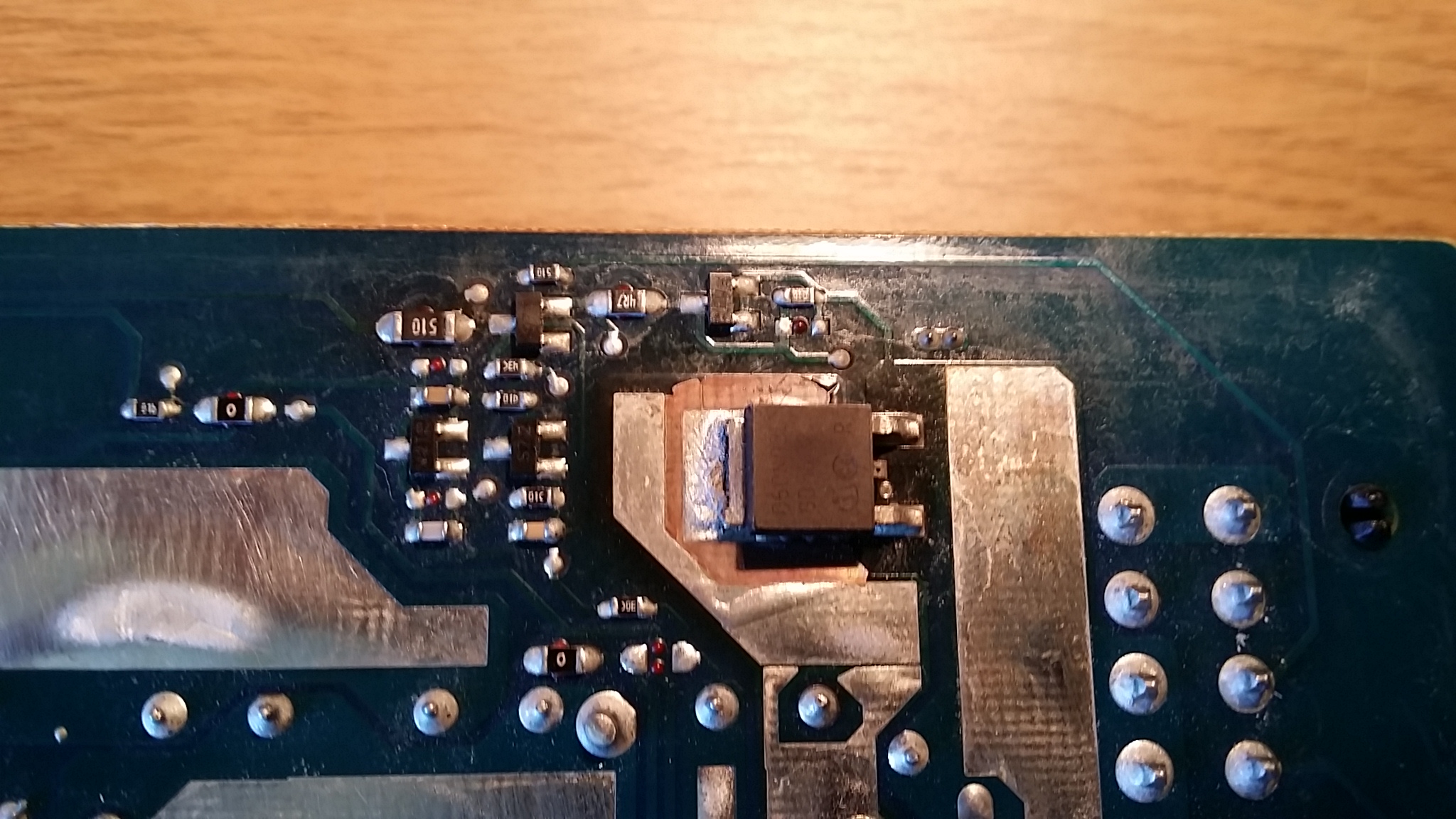

    Put a really strong light on it and figured it out....
    mosfet 060n03L
    Package: PG-TO252-3
    Cheap find on ebay...
    http://www.ebay.co.uk/itm/MOSFET-N-C...item3f265fcce0
    Schematics here:
    http://www.ic-on-line.cn/search.php?...03l&stype=part
    Thoughts of whether or not this will work? Appears to be the only rough looking area on the PSU

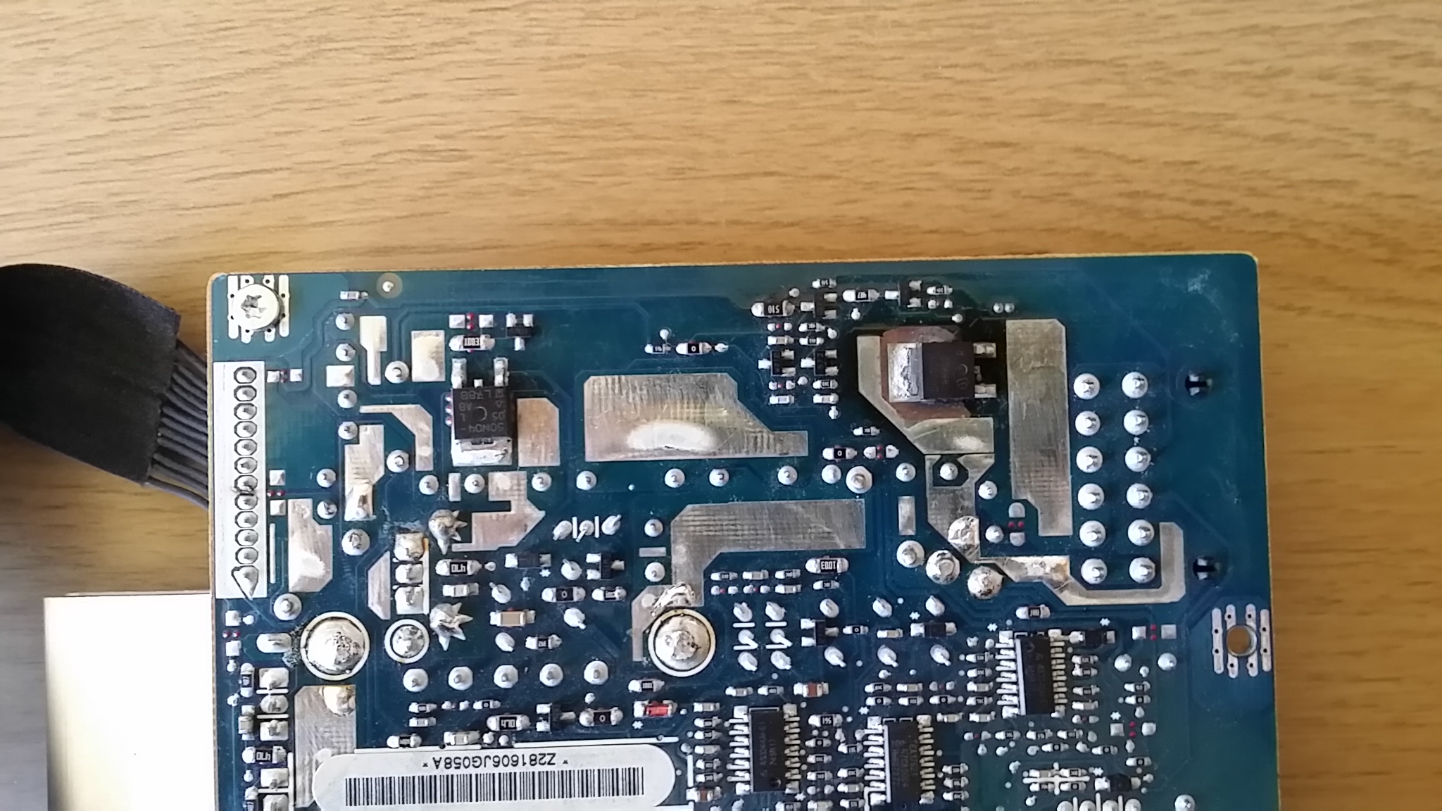

      It's cheap enough so why not? Check the MOSFET with your multimeter, it's probably shorted
      -David VanHorn
      • bosscharles
        • Mar 2013
        • 83
        Well, received the mosfet yesterday. Desoldered the presumed faulty mosfet and soldered the new one on and success! Working PSU for £1.70.
        For anyone that is interested, the faulty mosfet wasn't melted or anything but the numbers on it were very difficult to read and color was greyish black so must have gotten really cooked at some point. Hope this helps anyone with a similar issue in the future.
        Is there anything else I should look out for? Presumably, the mosfet may have gotten cooked due to another failing component on the PSU? Or it could have just failed through normal use..... I've power cycled the imac several times, had on for hours and everything is fine... Just want to make sure...

            could be the internal diode failed, and then the mosfet ran too hot.
            i'v noticed this on some invertors.
            when you have several fets,
            and you meter them to find the bad one, you often find that even the good ones have failing or dead internal diodes.
            i suspect in most msfet failures it's the protection diode that goes first.

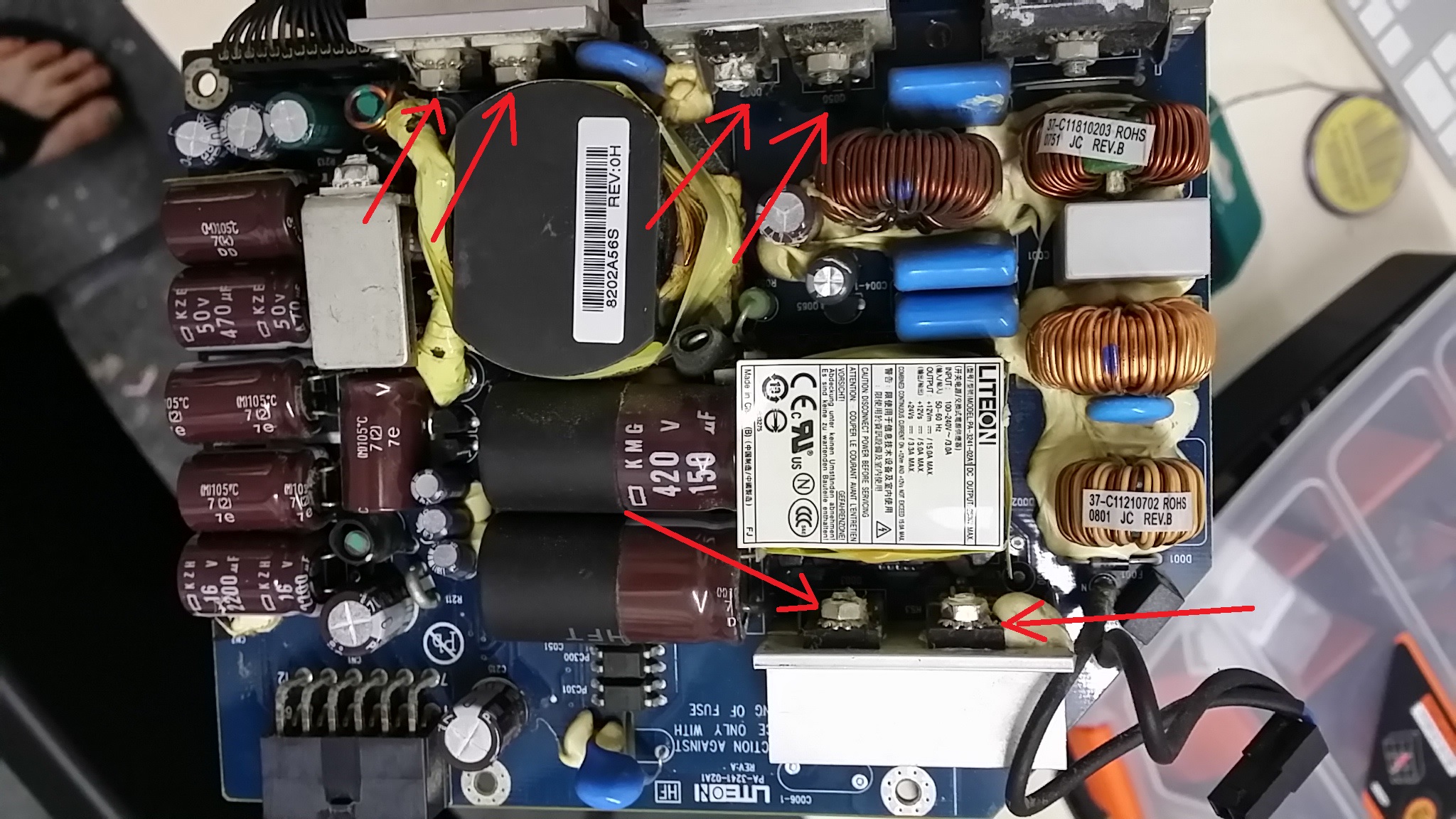

                          • bosscharles
                            • Mar 2013
                            • 83

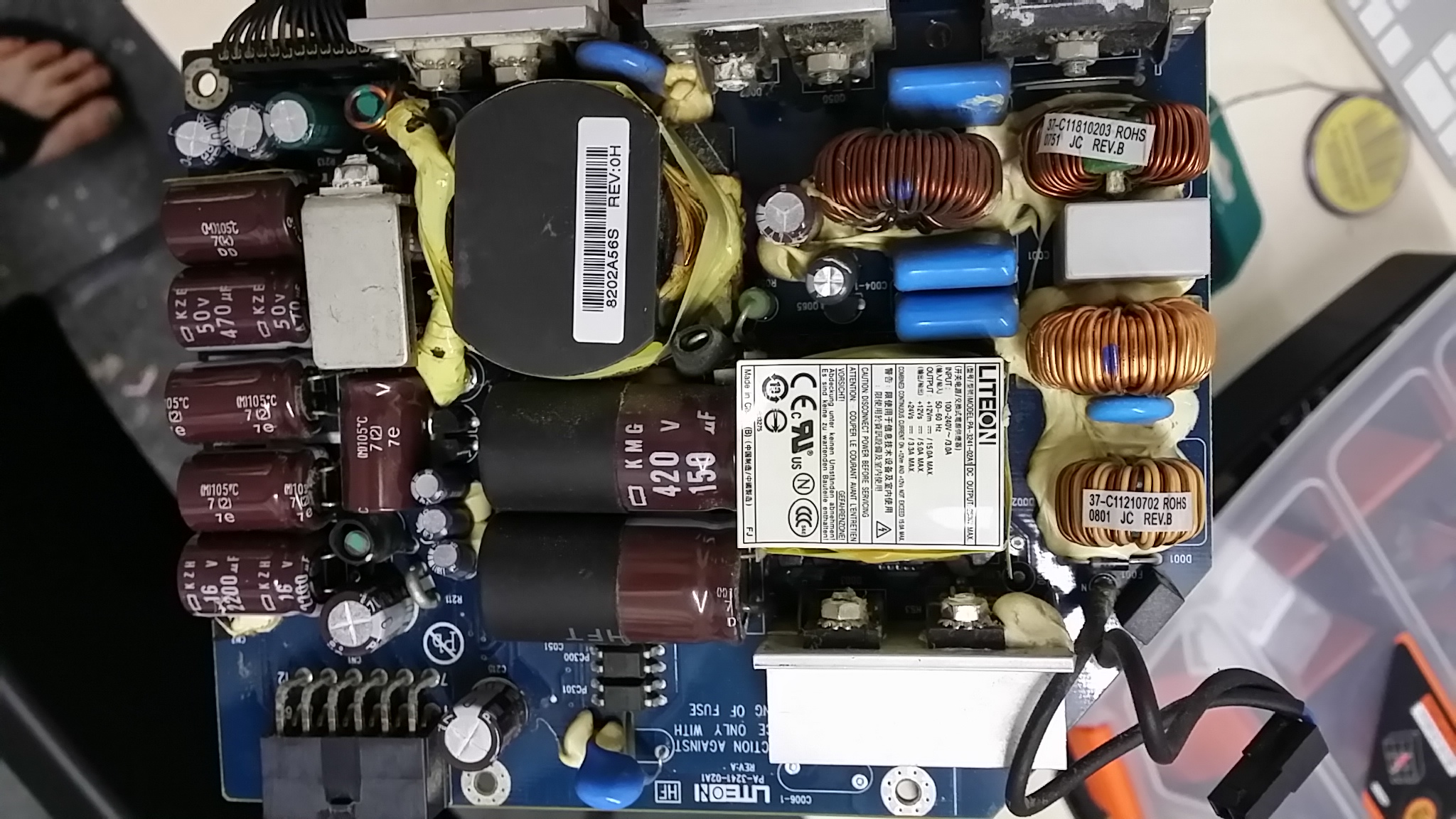

                            Originally posted by Agent24
                            Could be a shorted\leaky rectifier on an output somewhere. That would be the easiest thing to check first at least.
                            What does it look like? Can yuo pinpoint it on the photos I'va attached? thanks,
                            • Agent24
                              I see dead caps
                              • Oct 2007
                              • 5091
                              • New Zealand
                              Most likely the diodes mounted on heatsinks in TO-220 packages. There may be some big single diodes too. If you follow the traces from the output power connector, you will find them easily. There will be capacitors and inductors between the output and the rectifiers. The other side of the retifiers will be the secondary windings of the main transformer.
                              There will be at least one diode (usually a pair) on each voltage rail.
                              http://www.giangrandi.ch/electronics.../smpsfix.shtml
                              http://www.repairfaq.org/sam/smpsfaq.htm
                              Might help you too
                              -David VanHorn
                              • dj_ricoh
                                • Jan 2013
                                • 2073
                                • uk
                                those !
                                bend over the board and desolder the legs.
                                solder pump or wick.
                                check with meter on continuity test so it Won`t touch the pad and check the FET.
                                this is a solution so you wont have to take the heat sink out.
                                good luck!

                                      Replace the 2 small start-up caps to the right of the large transformer in Post 16. One brown sleeve, the other black.
