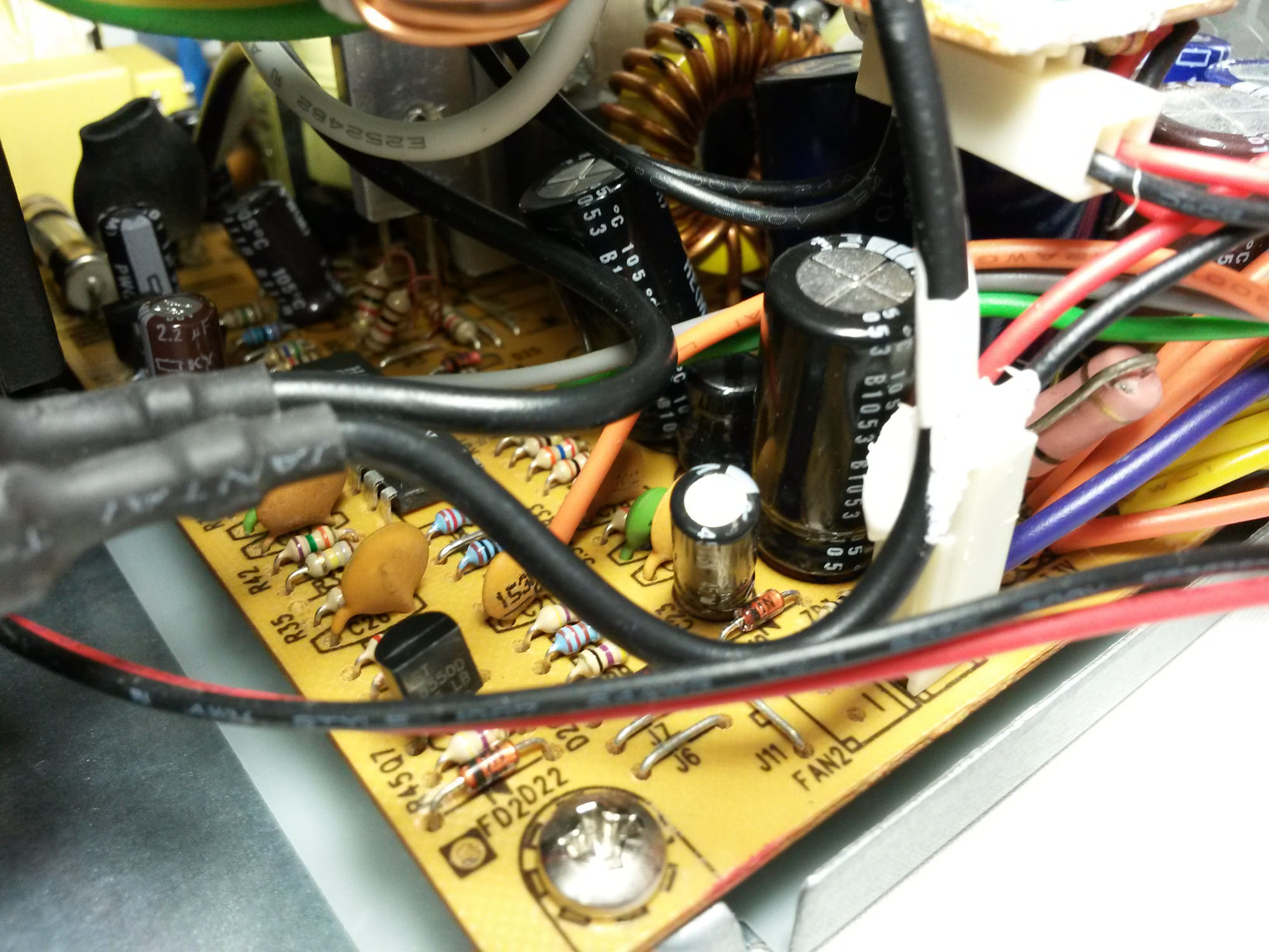

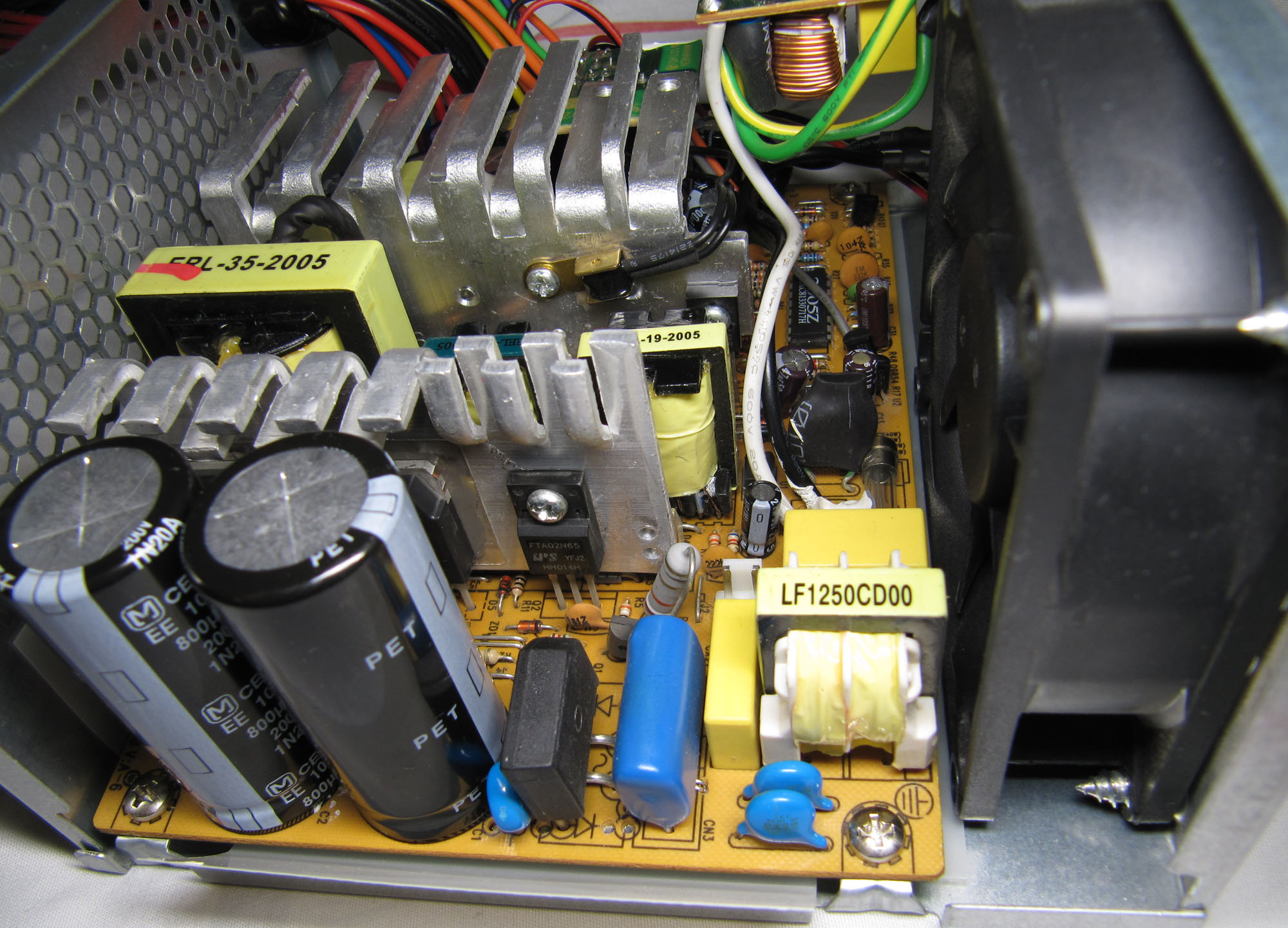

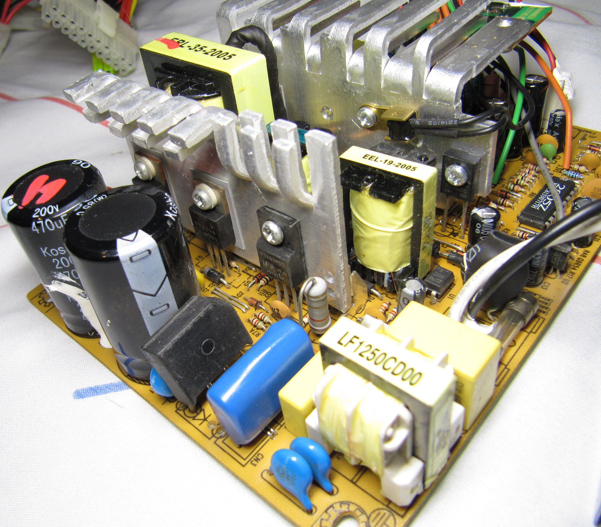

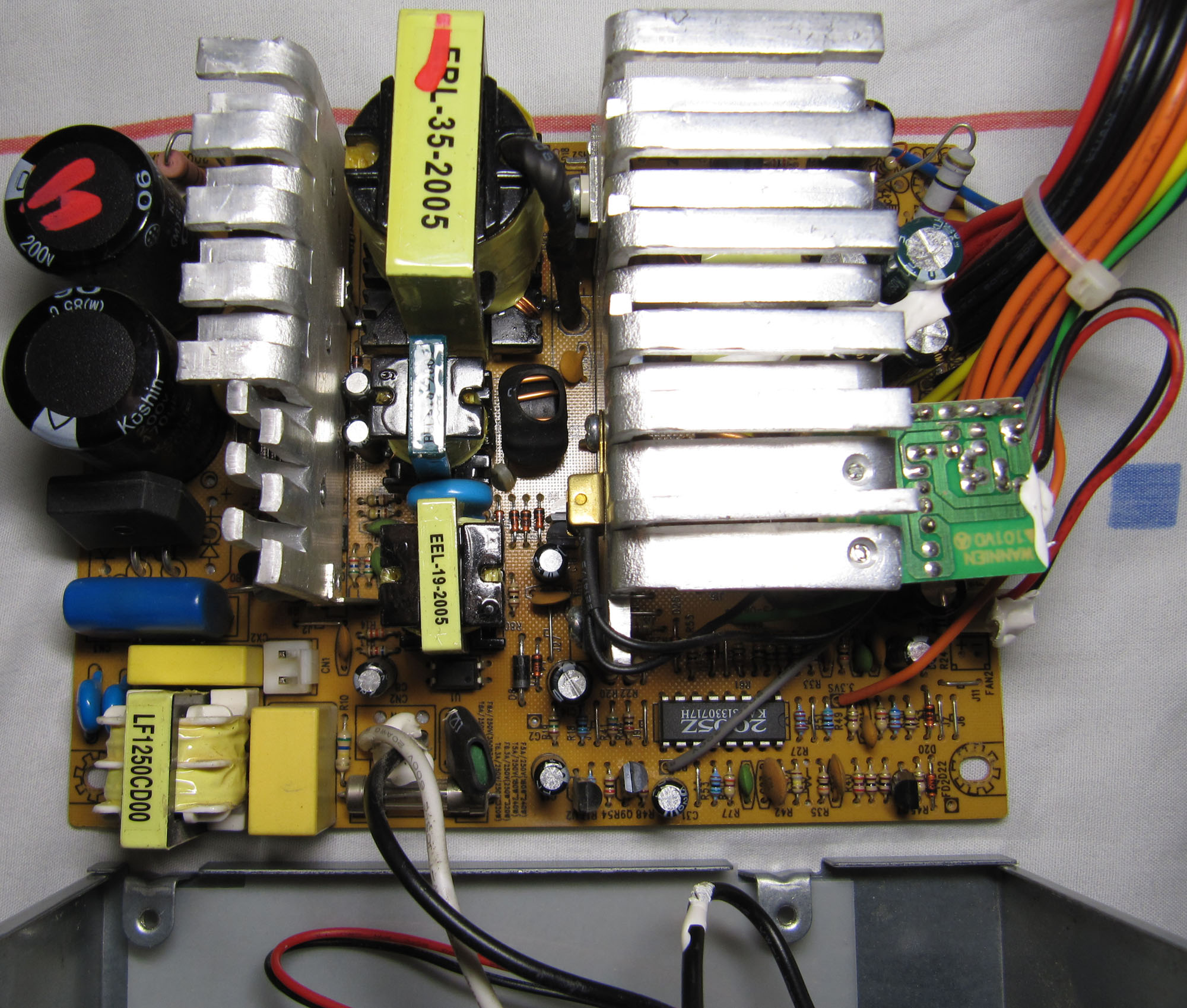

    This power supply uses the same layout as those Solytech psus, reviewed by c_hegge:
    http://hardwareinsights.com/wp/xigma...rp-vc503-500w/
    http://hardwareinsights.com/wp/the-2...ply-roundup/5/
    They all made it to 350-400W with very good voltage regulation and low ripple output except the Xigmatec's 3.3V.

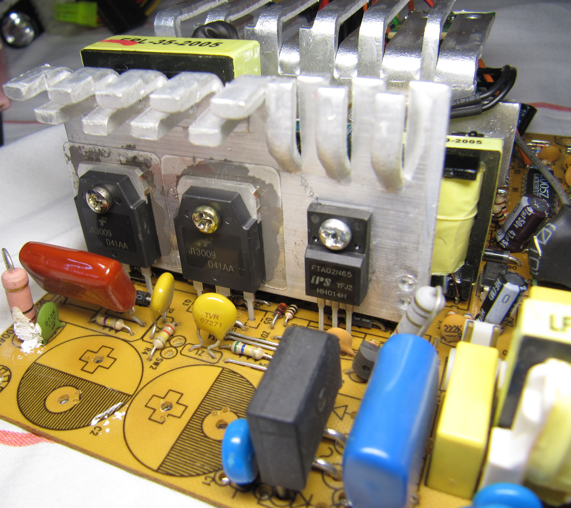

    The Allied has full input filter, including MOV protection, 2x 470uF 200V primary caps, 2xTT2194 NPN transistors and FTA02N65 mosfet for 5vsb.
    There is passive pfc coil, not fake.
    The main transformer is true ERL-35 and the 5vsb transformer is EEL-19.

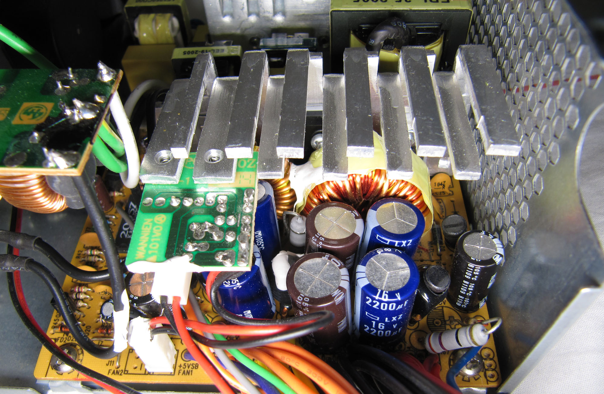

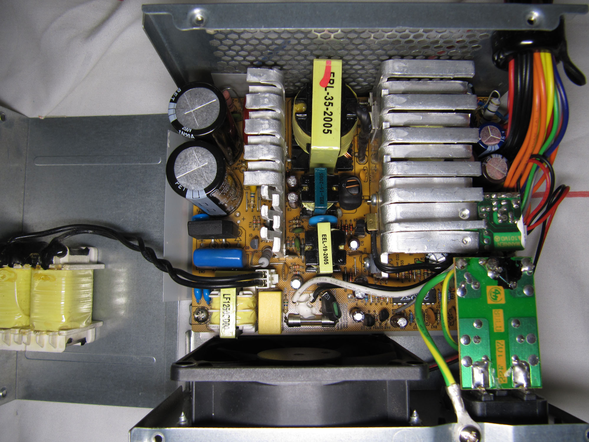

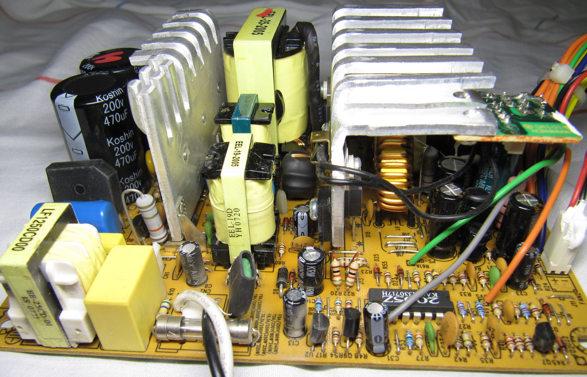

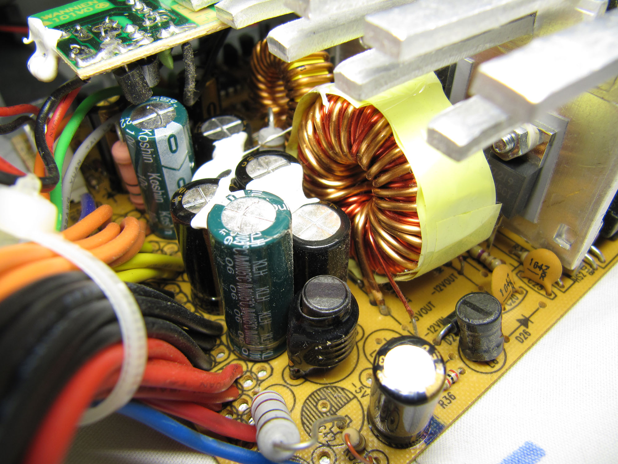

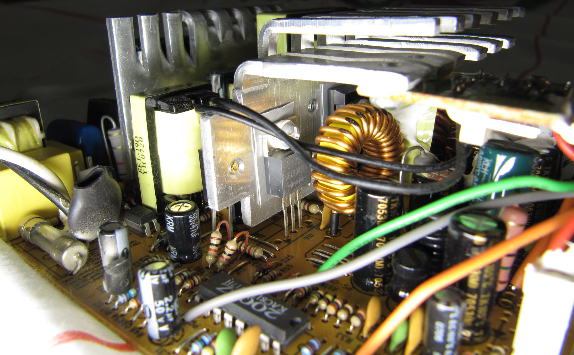

    Secondary:
    PWM controller is chip of the year 2005Z.

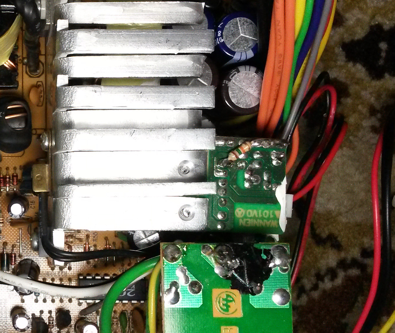

    As you can see, this psu has a fan controller board attached to the secondary heatsink.
    5vsb: 1xSR560 2x1000uF 10V YC TK
    3.3V: 1xSBL2045CT 1x2200uF 10V Koshin KLH, 1x1000uF 10V YC TK
    5V: 2xSBL2045CT (total 40A) 1x2200uF 10V Koshin KLH, 1x1000uF 10V YC TK
    12V: 1xSB3060PT 30A, 2x1000uF 16V YC TK
    -12V: 1x470uF 16V YC TK
    There are pi coils installed in every single output including 5vsb and negative voltage rail -12V.
    Do you think it is worth recapping?
    Btw the bleeder resistors are not of the same value:
    R3: 462kohm
    R4: 330kohm
    so, the rectified voltage is not divided equally. I have no idea why they do this.

    it looks pretty good.
    only thing i'd do is ditch that small pcb with the fan-crippler on it - connect the fan to 12v.
    btw, what type of fan vent is it?
    cutouts, or a proper wire guard?
    if it's just cutouts then jigsaw or dremel it out & fit a real guard.
    you will move more air & make less noise.

        Nah. You don't want it wearing the fan and sucking up more dust than it really needs to. I'd just give it a full re-cap and treat it as a 300W unit, and it should do OK.
        EDIT: You could also bend the bottom row of fins downwards somewhat. That might give the coils and caps a bit more air.

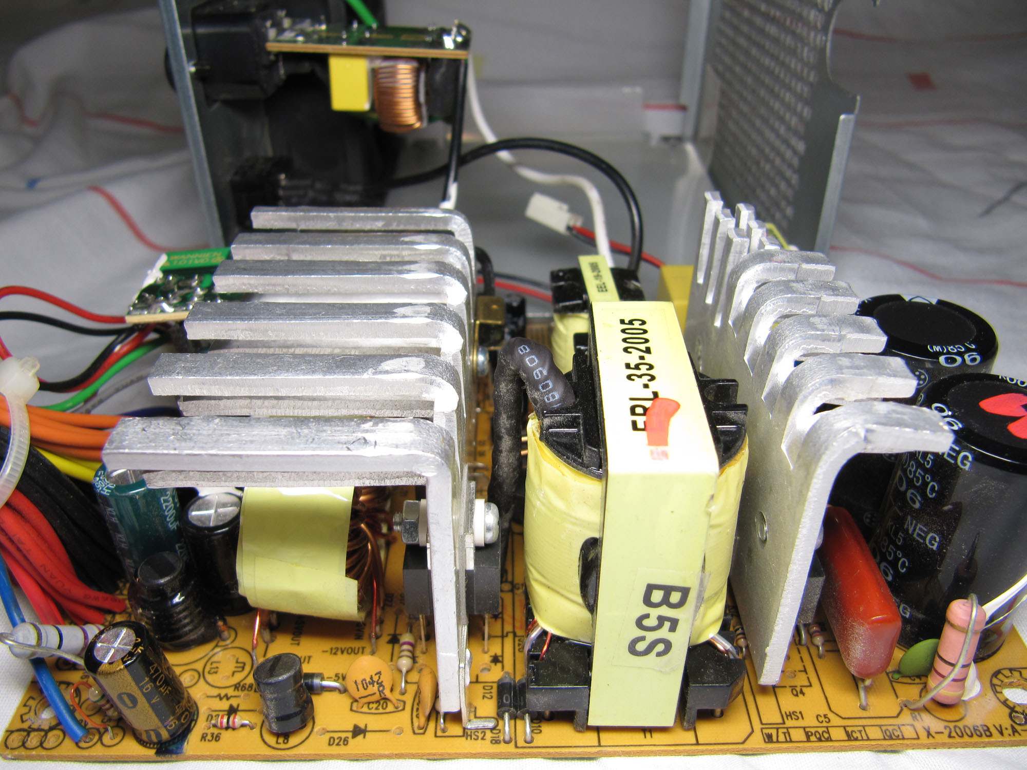

                  Please ignore that post. It turns out that the pcb trace connected to the + and the - leads of the 2 primary capacitors is part of the 5vsb circuit or something like that. That's the reason the 2 bleeding resistors have different values. One of the 2 primary caps stored DC voltage, part of it, is used by the circuit. Sorry for the bad English.
                  I replaced the TT2194 NPN transistors with FJA13009. I used mica pads and Arctic Silver 5.
                  I fully recapped the power supply with 100% Javanese capacitors.
                  I replaced the 470uF Koshin primaries with 800uF 200V Panasonic EE.
                  I used Chemicon LXZ and Nichicon PW 2200uF 16V caps for every main voltage output.
                  Finally, I soldered a 14.8Kohm resistor in parallel with thermal sensor to tweak the fan controller circuit to move more air.
                  It's a shame I don't have a psu load tester. How many watts do you think it can do now?
                  I also got to add an extra cable providing 1 SATA connector, cause the psu had none.

                        Cool PSU. Back before they exclusively used YC. Koshin caps are pretty terrible. Excellent job fixing it up, it looks good! I dare say it could do 375W with ripple well in spec, these do surprisingly well with ripple suppression, and i'm sure even better with the caps you used. Considering that smallish primary heatsink, those upgraded switchers would help quite a bit, that's usually what fails first on these old Deer PSU's.
