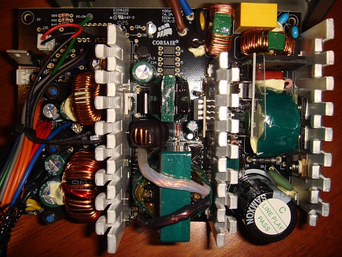

    Anyone know if Corsair Builder CX430 PSU have a weak 5VSB circuit?
    I built a system with one about a year ago. Nothing special, dual core Athlon II with integrated video and one HDD, DVDRW. It rarely sees a load (never full load, used only to surf the 'net, email and office), idles at about 40W I'd guess, and only runs a few hours a day, staying shut off the rest of the time.
    With no changes to the system it recently started shutting off by itself and won't turn on until the PSU AC power switch is turned off and on again. I wouldn't have though it a crossloading issue since the system is basically the same load as an entry level OEM system.
    The odd thing is the system is completely stable to POST, boot, and use, then only shuts down after the user has left it sitting idle for a while. Power management's shutdown and sleep timers have been disabled so it shouldn't shut down on its own.
    I haven't had a chance to go check out the system and am hoping it is a one-trip repair. Do you think it is likely to be one or both capacitors in the 5VSB circuit? Has anyone else experienced the 5VSB circuit being a problem on Corsair CX430?

    Considering the Corsair Builder CX430 uses Samaxon GF and/or Capxon caps (with the occasional Teapo thrown in) a failed cap would be a likely culprit, I'm not familiar with any specific 5 VSB issues with the CX430 but the CX430 uses poor quality caps in general and the 5 VSB caps are usually the most heavily stressed (since they are always "on") so it is common for them to fail first, though I would likely replace all Samaxon GF and Capxon caps while you're in there as they are both known to fail and likely will in the future if left alone (you may want to replace the Teapos too but these tend to do ok in PSUs as long as they don't get too hot).

              Looks decent enough to me. You should re-cap it rather than purchase a brand new PSU... I think the 5VSB circuit uses an IC, and I think it's located on that daughterboard near the primary cap.
              If you re-cap it, change the Samxon primary, I think I read here somewhere that Samxon primaries are not that great.

                                There was nothing wrong with the CX430 PSU.
                                BAD CASE SWITCH!
                                Grrrrrrr... It threw me for a loop because the system was shutting down but apparently a contact in the switch was floating around loose and would close the circuit if the user's foot bumped the case.
                                I didn't take a spare switch with me so I ran over to Radio Shack and got a pack of the following then put a fender washer on it to secure it in the square hole where the OEM plastic switch mount was.
                                http://www.radioshack.com/product/in...ductId=2062539
                                Oh well, I can't complain about having a good spare PSU for $26.
