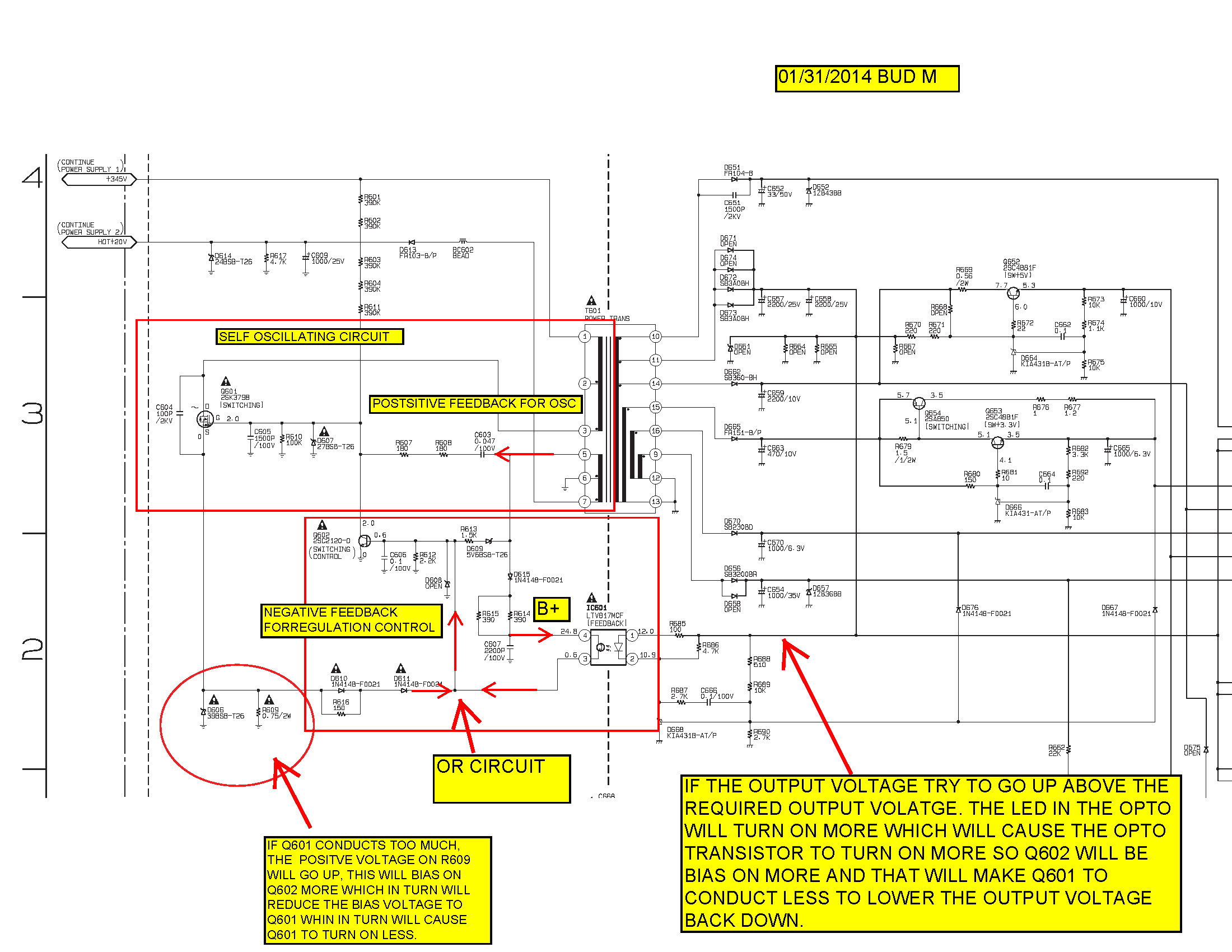

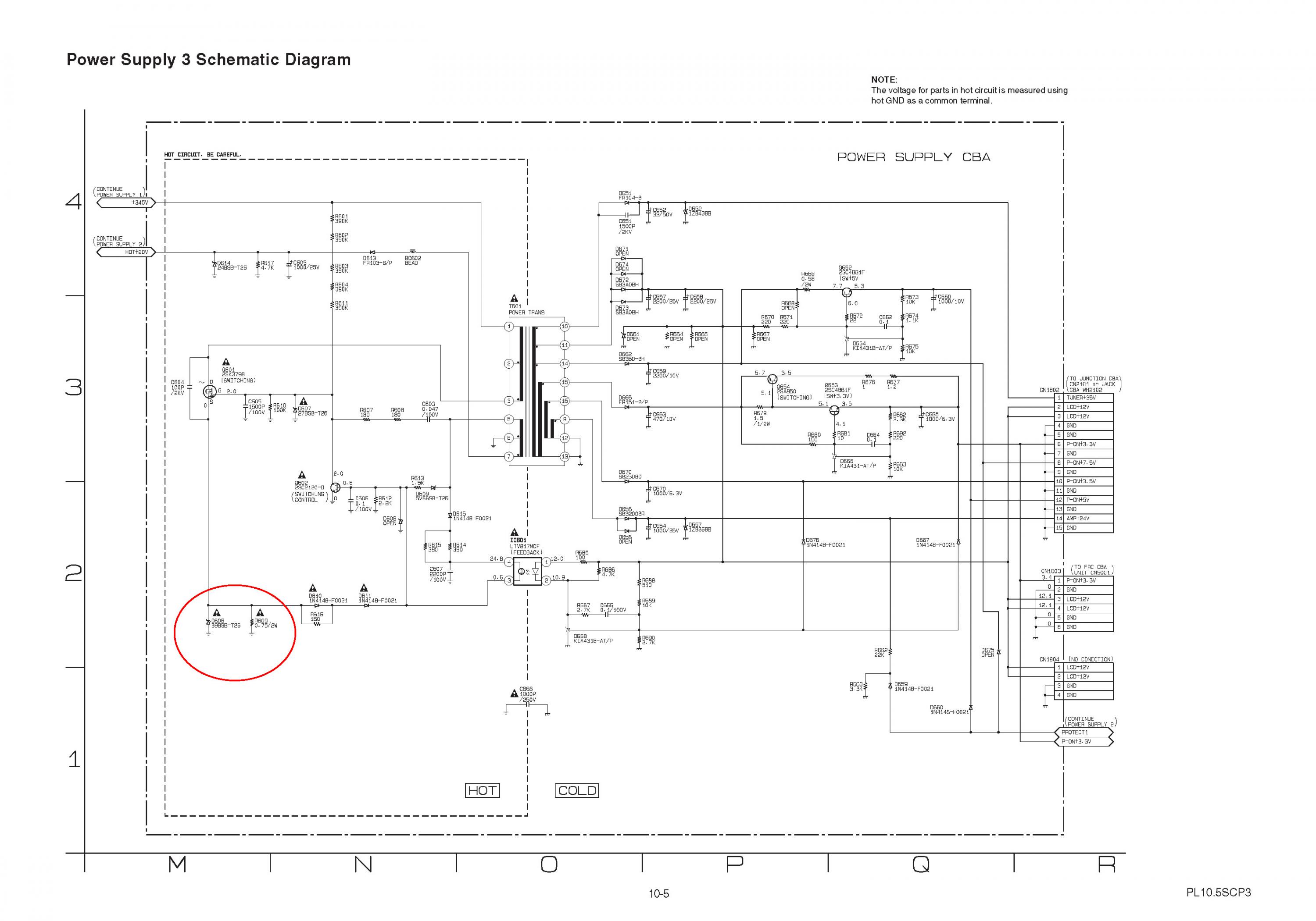

    I replaced some components on a power supply. Afterwards the set would still not power on. I checked for shorts and found that there is continuity on both through holes for one zener diode. I pulled the diode to see if it was shorted; however, it was not and tested good in diode mode.
    With the diode out I then tested the through holes again and found continuity.
    My question:
    Has anyone ever seen this before? Is it normal?

    That means you still have shorted components on the board, we cannot tell much without pictures and where the Zener is located at.

            It test for short but as bud said it's inparallel with a low ohm resistor so it sets off your meter.
            I discovered same thing in the Y Main I was working on - can't say I understand the theory behind it but meh

              For a long time I also wonder WTF would you have a resistor in parallel with a diode, until one day BudM posted something that explained it. So hopefully this will help you out.
              The diodes in parallel with a resistor are to allow a faster discharge of a device. Usually in power supplies it is there to discharge the gate pin of a FET so it will turn off faster.

                In this case it may be used foR the limiting the maximum voltage across the resistor not to exceed the Vz of the Zener, probably part of the Current feedback circuit for the SMPS.

                        Re: Continuity across zener diode
                        This is the explanation how the circuits work.
