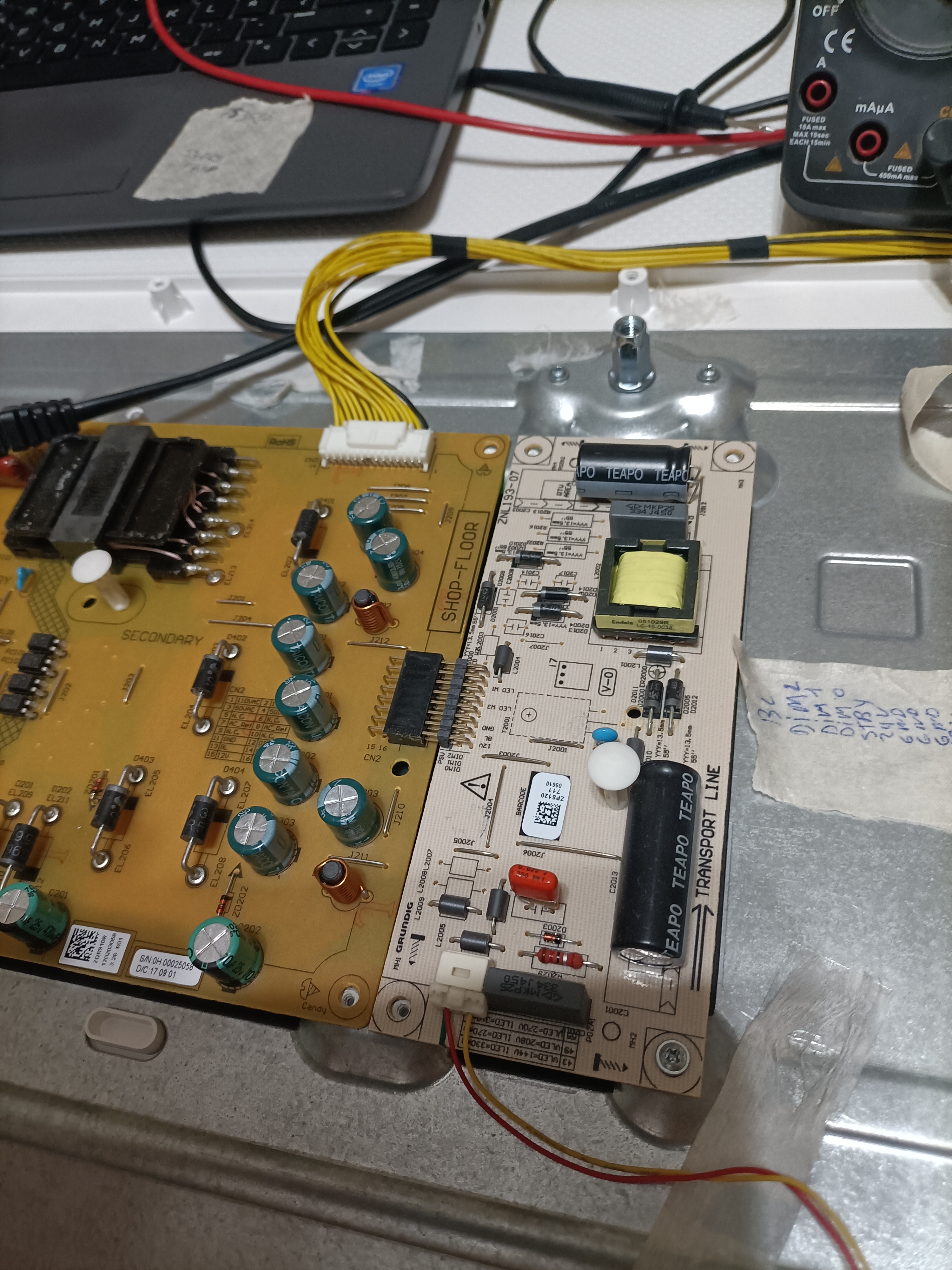

    Hi.
    Could someone tell me which pins to jumper to activate Power board fsp123-3f01. It is from a Grundig TV model 49 vle 6621 wp
    Thanks un avance
    Click image for larger version  Name:	IMG20240302121341.jpg Views:	0 Size:	2.45 MB ID:	3227247
  • Answer selected by spantor at 03-05-2024, 02:41 PM.

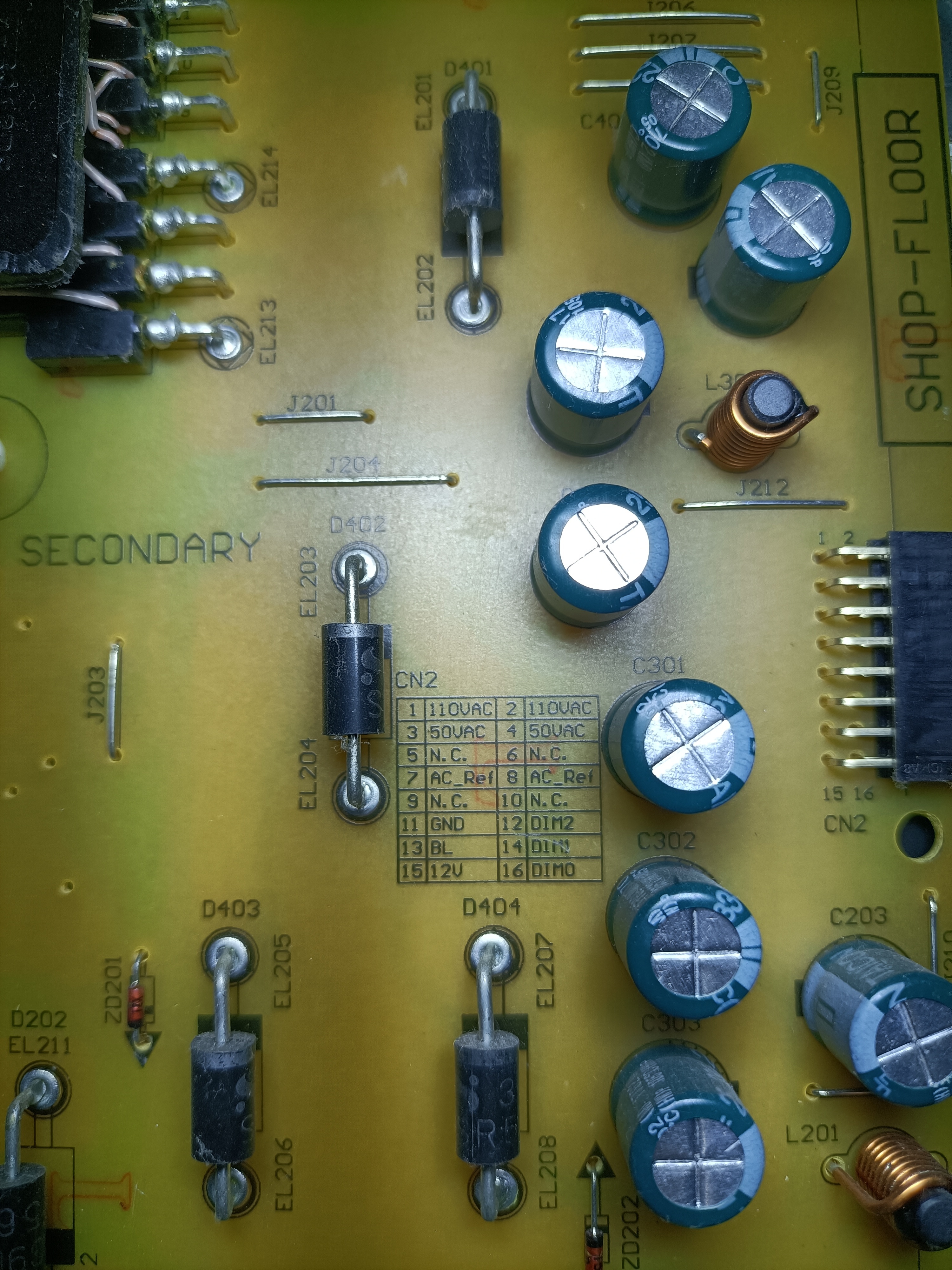

    yes-Pins 110vac and 50vac should be measured in alternating current.
    If 5 volts do not appear on pin BL, then there is a problem on the motherboard.
    to check the operation of the backlight inverter, connect pin 5v with pin BL via a resistor with a nominal value of about 1 kOhm

        Hi, measure the voltage at STBY to start

                  When you turn on the TV with the remote control, how does the voltage on the pin STBY change?

                    standby has around 3v when I turn on the tv.The problem is that the standby leds make 2 flashes and then the TV turns off.When TV tries to turn on there is no any image and there is no back light, however there is 90v in the LED backlight + cable but there is no - in the LED backlight cable.I have my doubts about using this power board, for that reason I want to turn on this power board without the main board connected

                      How does the voltage at the pin BL change when you turn on the TV using the remote control?

                        There is -5.31voltage between pin bl and gnd when I turn on the TV. Then the voltage disappears definitively at the end of the cycle of the two flashes of the standby LED

                          This board have another board for leds

                            where do the pins DIM0,1,2 go?

                              Dim 0.... 0v
                              Dim 1..... 0v
                              Dim 2.....1,6v.

                                In the last photo, the pin table CN2 is not completely visible.

                                    The measurements I have made so far have only been in cn3
