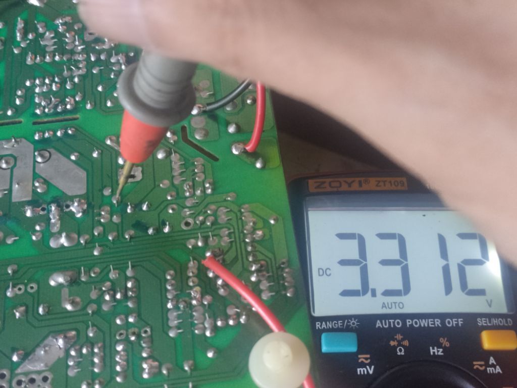

    Ok, that was weird. For a couple of tries, 3.3V rail was 1.68V, TL431 cathode was 1.25V and reference was 1.68V
    But now 3.3V outputs 2.25V, the same as TL431 cathode, reference remains at 1.68V
    Interesting point, without the TL431, I get the same voltages.
    What next? Change the final opto coupler that is connected to this 3.3V FB circuit or change the TL431 reference resistor?

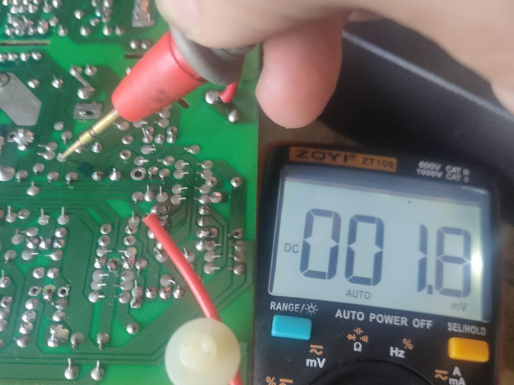

        So the reason why the outputs are very low is because UC3845B VREF pin is 1.2V instead of 5V.
        It's connected to the opto coupler collector pin, and despite I have replaced it (again!), nothing changes. I'm not surprised being that the feedback is pretty much also screwed up (TL431s cathode and reference reads a few hundreds mV instead of the minimum 2.5V)
        I lifted one leg of every passive components that are on the main PWM and both feedback circuit to measure them individually and they're ok.
        ​​​​​Not sure what else to do.

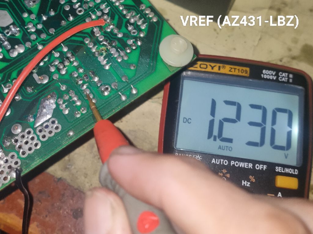

            12V TL431 cathode was shorted to anode.
            I also put in the wrong TL431 with 1.24V REF.
            Fixed that and 12V, 5V output rails are back to normal (yay!)
            3.3V is still very low, because its REF is at 1.47V (1+5K1/15K) x 1.47V = 1.968V
            if REF is at 2.5V, the 3.3V rail would be normal.
            Not sure what caused it to drop. Could be a bad TL431.
            Unfortunately I don't have a spare TL431 with 2.5V REF anymore. I still have some 1.24V REF ones though, so I guess I could I use it and change the resistors divider network instead, something like this: (1+10K/5K6) x 1.24V = 3.3V

                  Well that didn't work at all. Quickest way to test the theory, I swapped the resistors divider around, thus:
                  VOUT = (1+15K/5K1) x 1.24V
                  which should be 4.8V, but it doesn't.
                  No matter what, 3.3V rail will not go above 1.99V (2V)

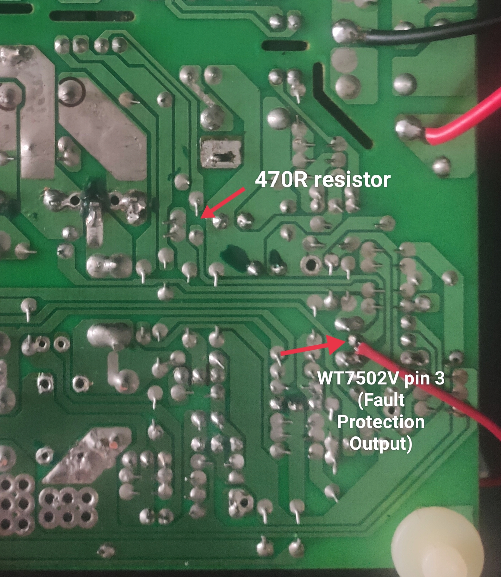

                  Interesting point, I do see 3.3V going to the opto coupler pin 2. I have no idea why would there be a 3.3V
                  It's only a single trace connected to the supervisor IC (which is dead when 12V aka VCC was 33V) pin 3 (FAULT PROTECTION) via a 470 ohm resistor and this pin has to be shorted to ground to start the PSU without the IC.

                    I injected 3.5V from my bench supply at the 3.3V rail and I could see the TL431 working as it should. 3.1V is also present at the supervisor IC VS33 monitoring pin. Which means there are no faulty components that would bring 3.3V down to 2V.
                    Perhaps the reason why it can't go higher than 2V is because I'm still using UC3845B instead of TL3845P. When the part gets here, I will confirm if that's indeed the culprit.
                    Addendum:
                    Reconnected the lifted leg of a 180 ohm 1W resistor that gotten hot before and brought back the -12V rail. Now 3.3V rail has increased to 2.6V and that resistor still gets very hot to a point I can smell the heat. I don't like it.
                    I also don't understand how 3.7V (if without supervisor IC) can appear at the opto-coupler pin #2 even though the other end of a 470R resistor in series with it is 0V. Can someone explain this to me??? EDIT: Nevermind, I figured it out. Pin #2 is cathode of the opto coupler LED, so 3.7V appears because of 5VSB to anode, and the LED has 1.3V voltage drop.

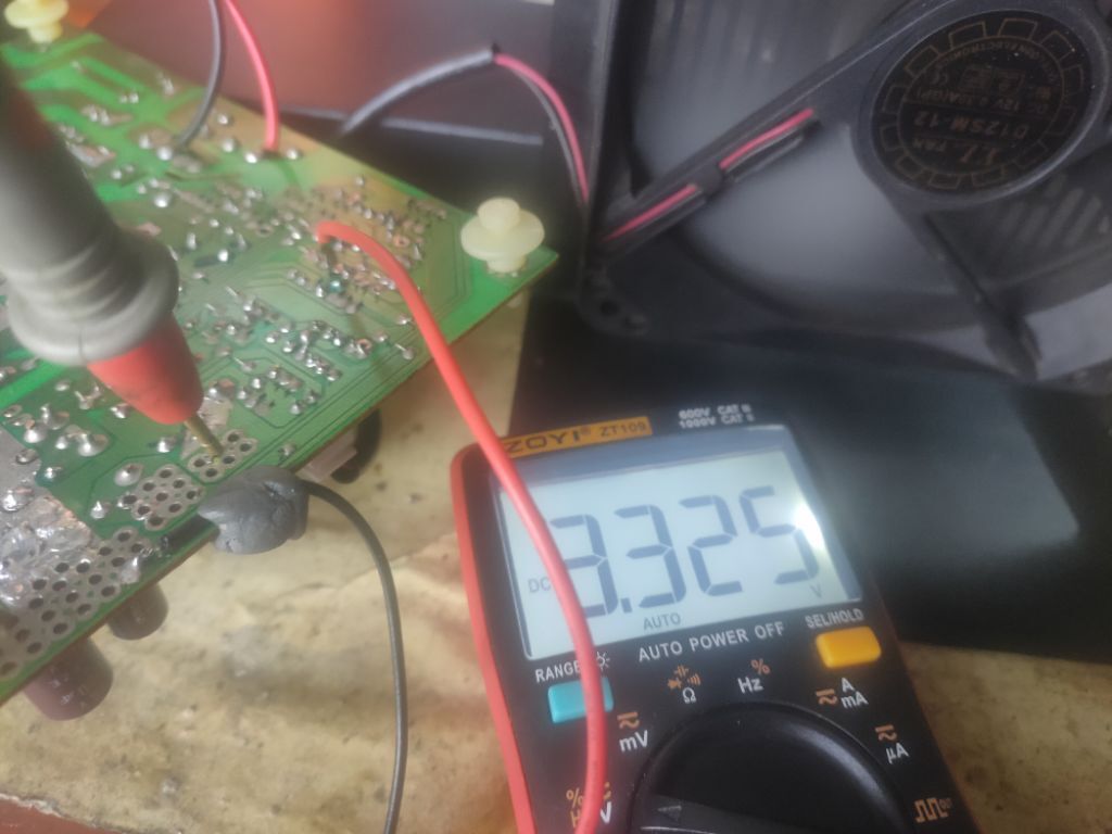

                              Bloody hell! I FIXED IT GUYS!
                              I was watching a YT video about UC3845 and out of curiosity I decided to measure its duty cycle. Was surprised to see it's only at 4%, so that got me thinking, is this PSU experiencing what Richard (dicky96) had in one of his ATX PSU repair videos. Turns out it is! All I have to do is just add a load to the 12V rail to push the PWM chip working a bit harder, so I attached the fan, then I couldn't believe what I saw.
                              3.3V rail is now 3.3V
                              Thank you all! especially harp
