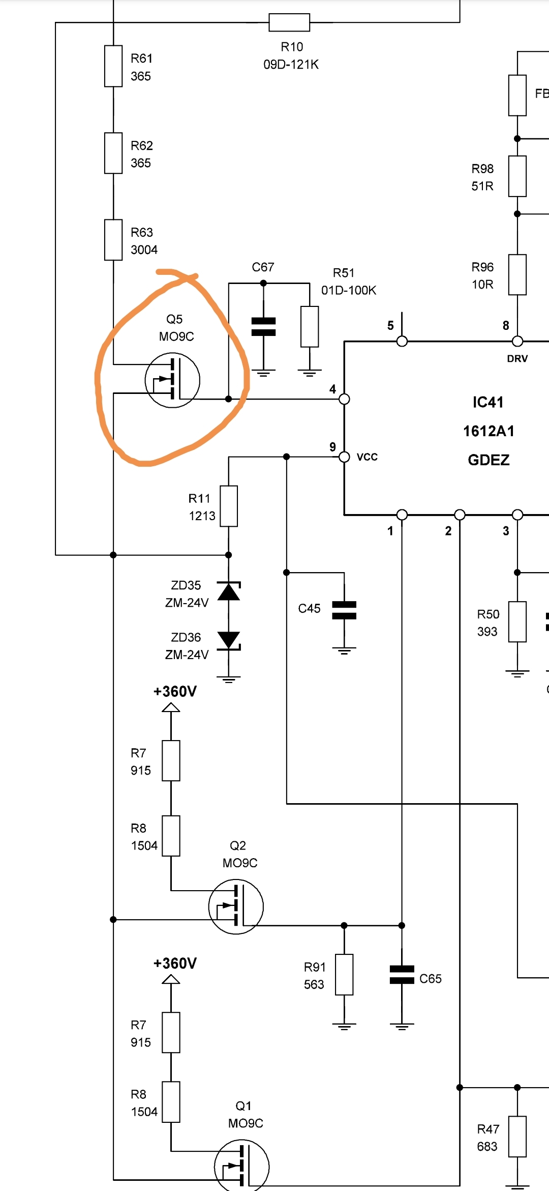

                      #30
                      Could you please help identify this component in the ps4 power supply diagram. I just know it's some kind of voltage supervisor ic but different ps4 psu's have different markings on the same component. I'm trying to find the manufacturer part number.
                        • 31303
                        #31
                        it's a mosfet transistor.
                        • playgoods
                          • Jan 2014
                          • 18
                          • South Africa
                          #32
                          It is something like a max809 ic.
