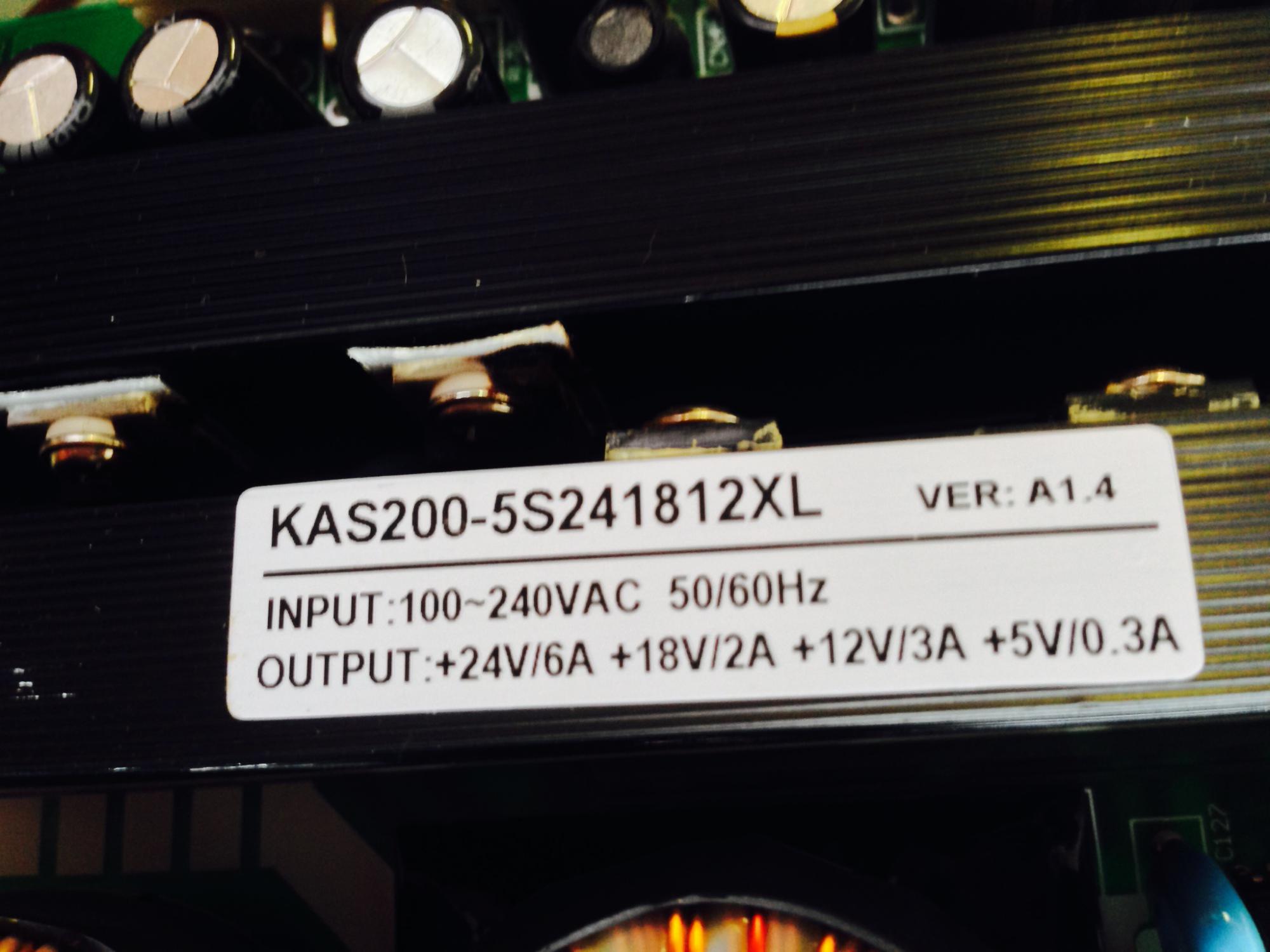

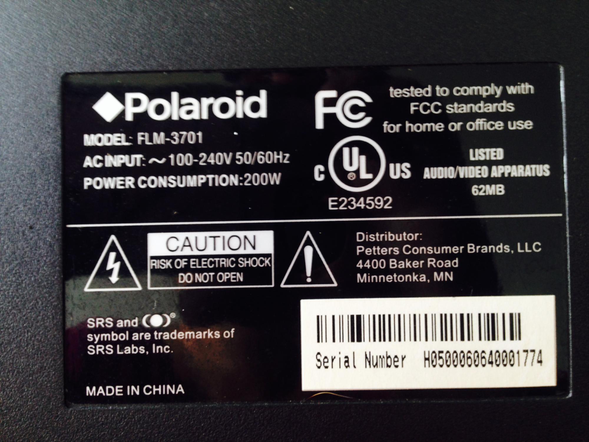

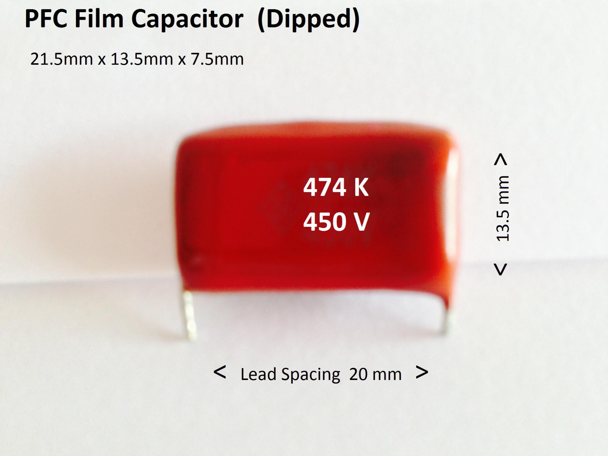

    I've been having a lot of trouble locating a 474k 450v pfc film cap for my polaroid flm-3701. It is used as the Primary for the KAS200 power supply.
    I've tried all the usual sources : Mouser , Digikey , Lcdalt., etc...
    and to no avail.
    The problem I seem to be having is in the Lead Spacing (Pitch) - 20 mm.
    The ones I can find that are even close are either a space/dimension issue or I have to create a rather large lead bridge/crimp (approx. 5mm).
    If anyone has or knows where to get one, please let me know.
    I have attached some pictures as a ref. with the best specs. I have.
    I appreciate any help I can get, Thanks.

        Re: PFC cap for a KAS200
        Thanks for the help.
        The one from Mouser has a 10mm lead spacing, unfortunately I need something just like that with a 20mm.
        I just ordered one with a 15mm - the closest I can find.
        I'll see what it looks like and see if maybe I can bridge it to fit.
        I'll let you know what happens.

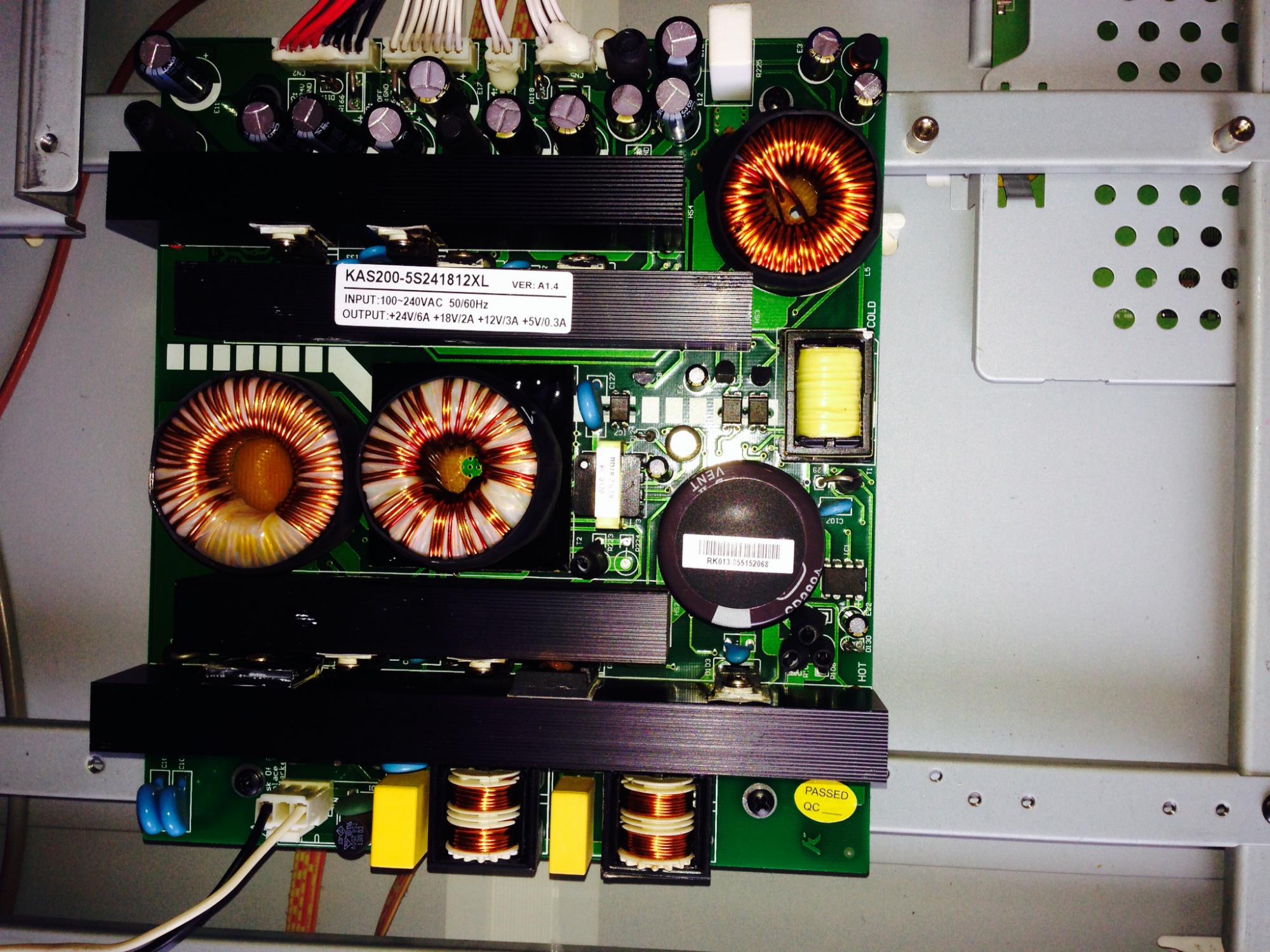

          BTW, where is this cap located at on the board? I cannot see it in post 1's pictures.
          C905?

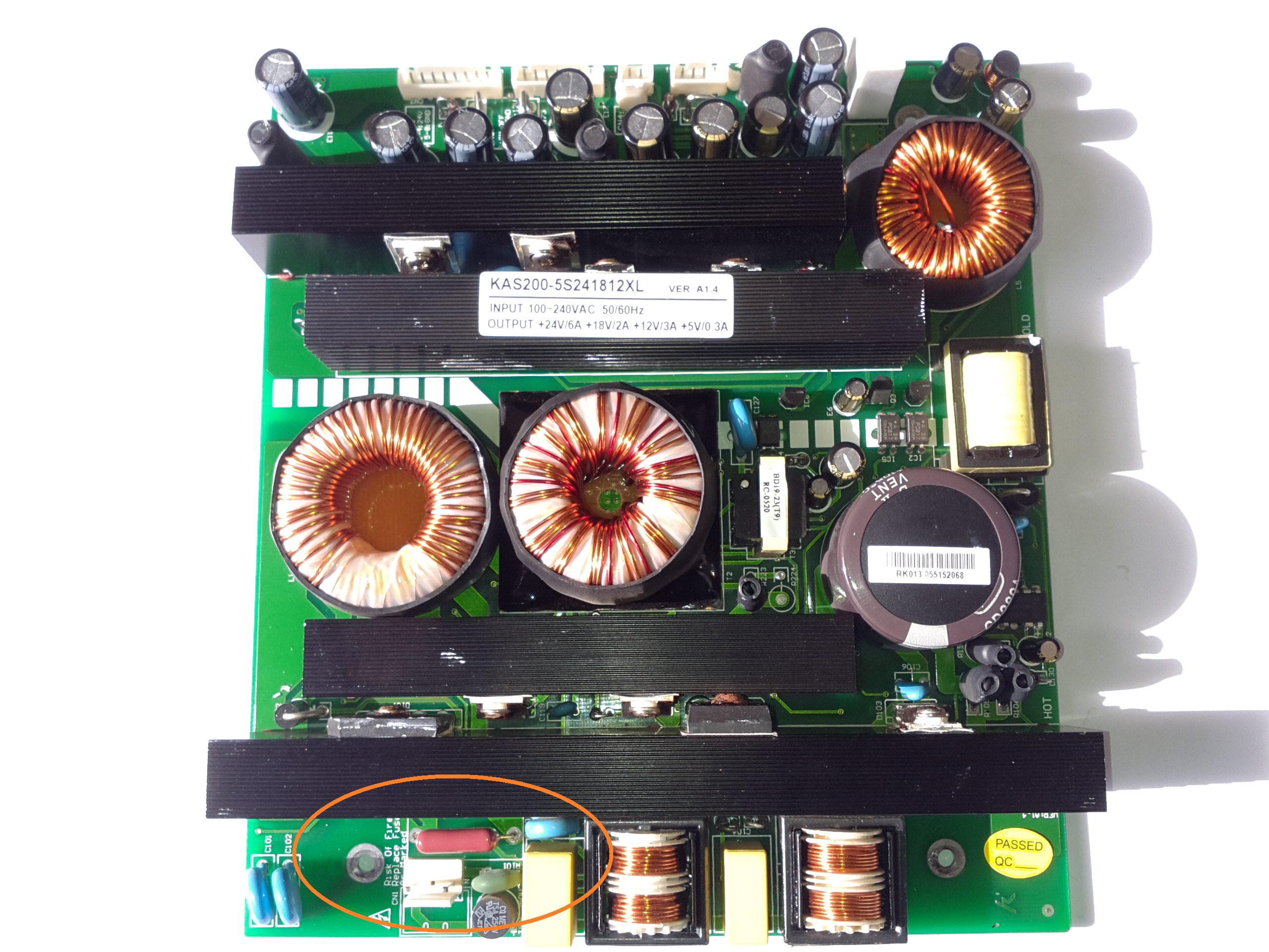

              So I bought a replacement Cap from Mouser:
              http://www.mouser.com/ProductDetail/...c/ECW-FD2W474K
              Success, the 5vdc standby has now been restored !!!
              Didn't realize it but, in my original pic. it had already been removed
              (sorry BUDM ) my mistake.
              I have attached a better picture.
              Although the dimensions are a bit smaller than the original, I was able to bridge the leads to fit the original pin hole design of the board.
              The PSU is still not working properly - it has almost no output voltage.
              But, that's ok - it's a start.

                Thank you for that OEM KAS200 (sch).
                I'm not sure, but I believe that mine may be an - " LC-37K5" PSU
                The values and track-line seem to be a little different for the " 5s241812xL "
                as opposed to the normal LC-37K7 units and/or schematics that I have been able to find.
                Any thoughts ?
