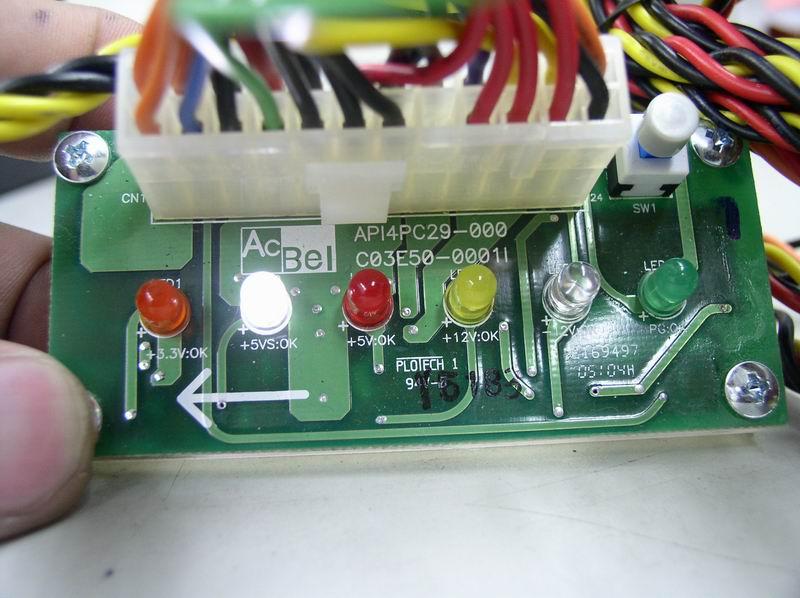

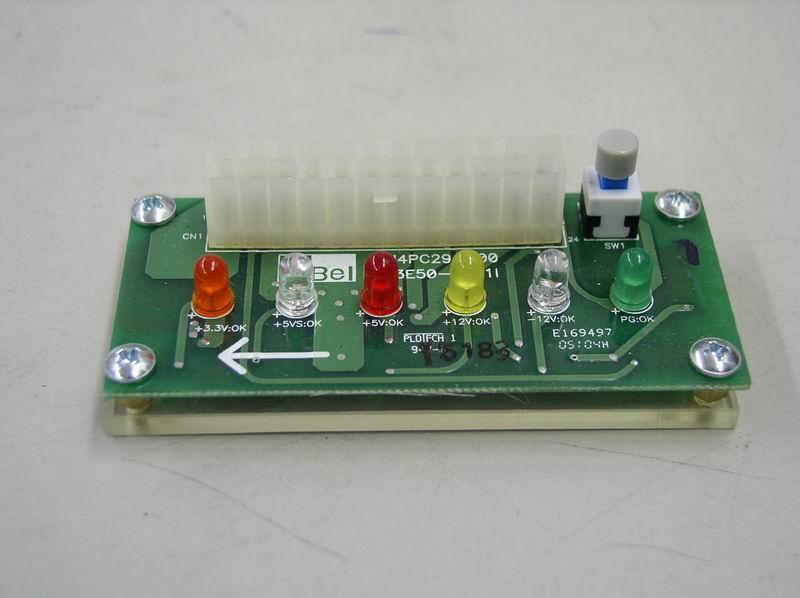

    It seems a nice tooling for computer PSU, i am planning to order one.
    It semms made in Taiwan, not mainland China.

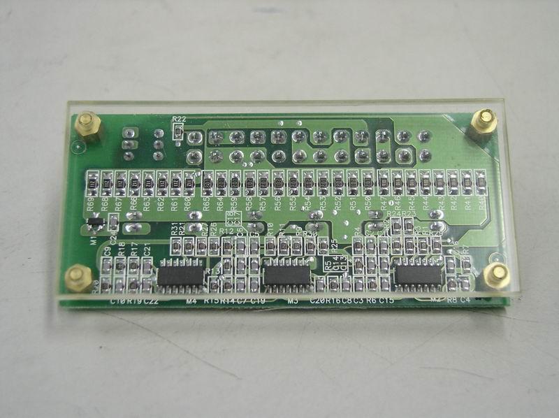

    Re: Acbel Power Supply Tester
    Very cute. I'm guessing M1 is a reference IC. The other four look to be LM339 quad comparators. Probably the sections are paired to form a window detector for each voltage (12 sections, six pairs, six voltages monitored) so that it detects both out-of-spec low and out-of-spec high conditions.

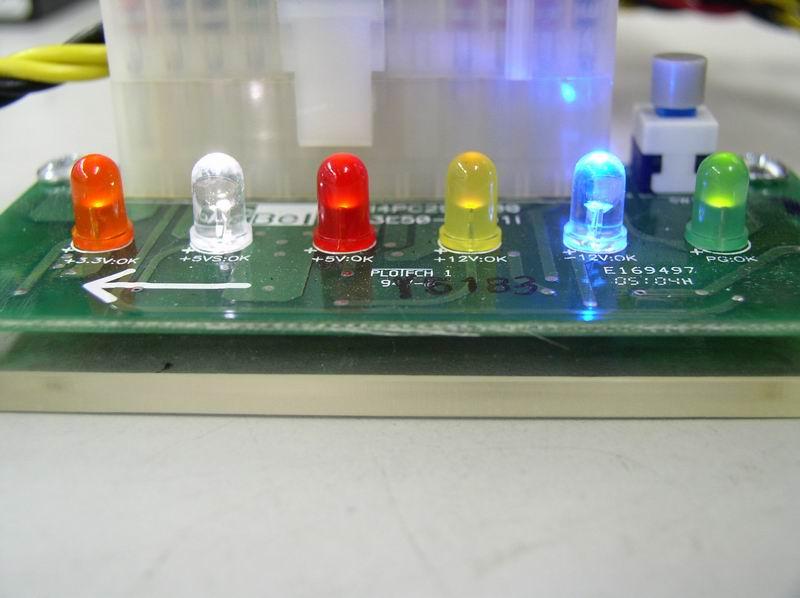

      You only have to add a seriouse load to it and you have a realy good unit.
