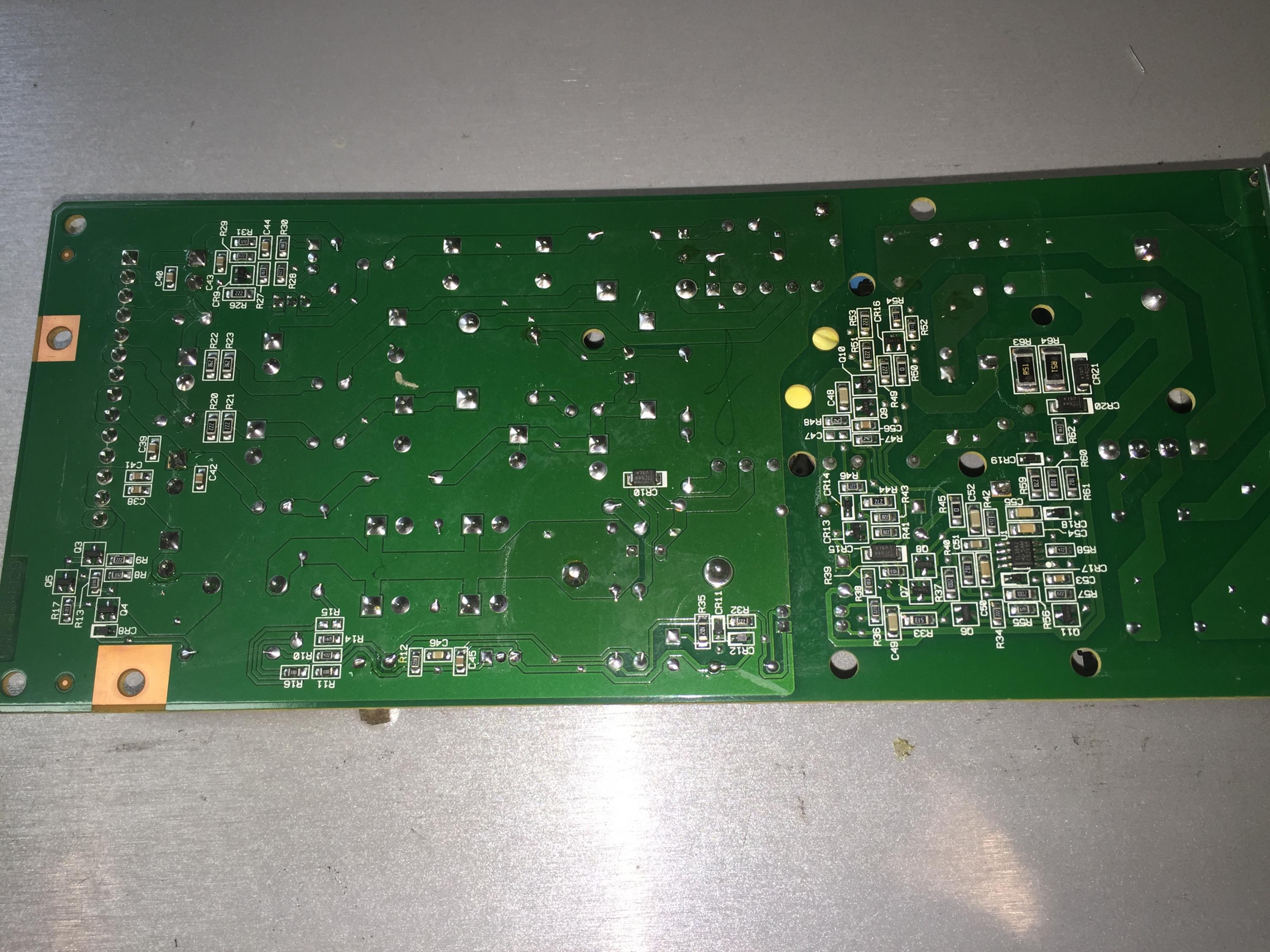

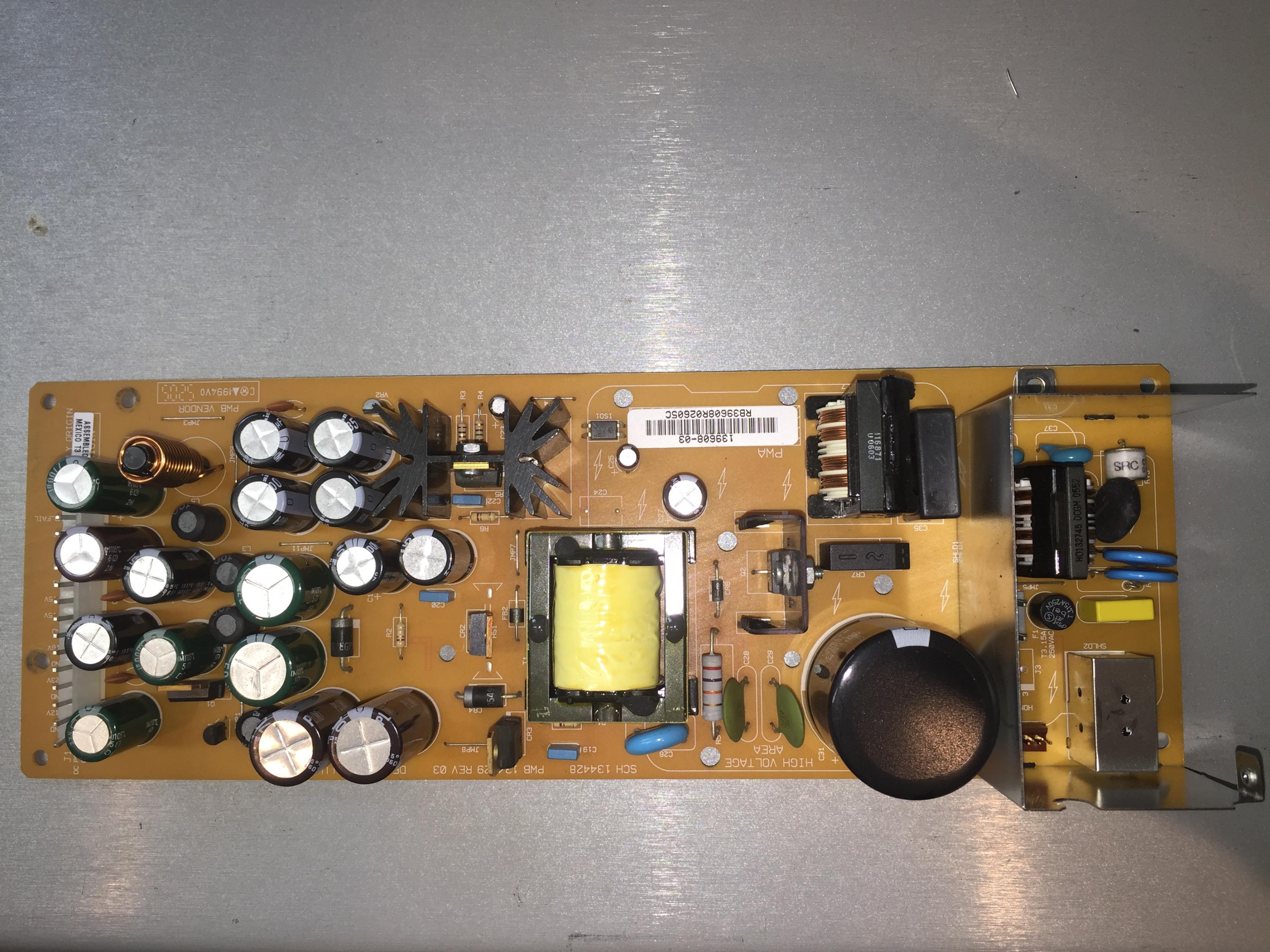

                              Okay, so after many years and having issues with many similar power supplies, i have about 20 of them with similar issues. I've found something there is a SMD capacitor C55 that if i apply pressure to it, some of them will start. After trying to remove the cap on about 10 of them, it seems they are cracked between the connection metal part and the middle of them, they all fell apart when removing. Tried removing other smd caps, never did that.. So, really, that C55 cap is killed by something maybe heat.
                              I need to find the value of this capacitor, and have no schematics of the power supply. I tried using a working power supply, removing the cap, and checking it with my peak atlas esr meter, and it doesn't find any value.. like the cap isn't there.
                              Again, all other caps i'm checking with it show a value. It's a non-sence and i really don't understand what's happening here.
                              Put the cap back in the psu and it works. Without it, no workie. So really that capacitor is good, and it has a value, but the atlas can't find it. What the hell ?
                              Thanks for any input on this !!!

                                Put a straight shot, hi res pic here so we can see the circuit.
                                With the PSU unplugged check each voltage rail on the secondary against GND pin to see if any of the rails is shorted. If it isn't a short on the PSU, there could be one on the main board, making the PSU go tick tick tick

                                  Re: Dish Network VIP622 Power Supply Ticking
                                  Here are 2 pics. Quality good enough ? Thanks

                                    I'd say that C55 is probably a 0.1uF, a 0.01uF or something in between.
                                    Btw. That PSU is different than the pic on the first post.
                                    • cheebster
                                      • May 2008
                                      • 374
                                      #38
                                      Um. Can i safely replace it with a 0.1uf? what about voltage ?
                                      Yes it's from a 9200, a bit different but works in either model (9242/vip622 or 942/9200)
