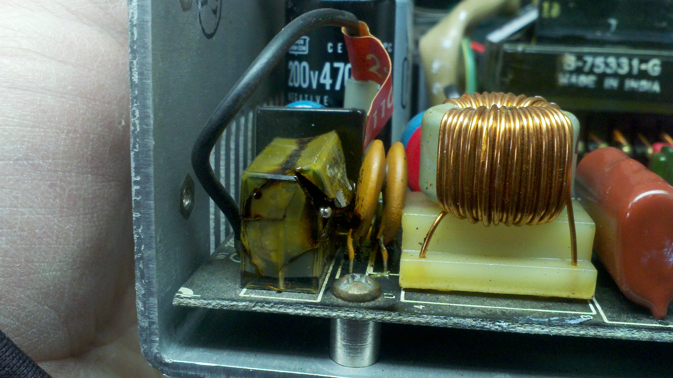

              Re: Apple II Europlus Power Supply Failure (ASTEC AA11042C)
              The same thing just happened to me. In looking for a replacement from mouser for my exploded .1uf RIFA, the replacement looks almost exactly the same. Can someone help me find an equivalent replacement that this wont happen to again?
                • 31191
                got a foto of it?
                the problem isnt the cap really,
                it's just that the epoxy casing shrinks and cracks after about 20years and lets moisture into the guts.
                if your replacement is new, and not made decades back then it will be fine.
                  Originally posted by stj
                  got a foto of it?
                  Its the exact same as the .1uF pic at the top of this post. They must have just added the larger cap for Europe.

                      • 31191
                      #30
                      but is it very yellowed or cracked?
                        C2, if you're dealing with an Apple 2 P/S, the thing is 20-30 years old (maybe over 30). Things made by humans have finite lifetimes, and 30 years for electronic parts is pretty good. The Rifa PME271 series has been around a very long time (since the late 1970s that I know of). It's as good as any competitor's parts. If it hasn't been mentioned already, a principal failure cause for these parts is voltage surges from the power line, so the cause of your failure may have been the utility power at your home, not some internal failure mechanism. If you're in an area that gets lots of thunderstorms, that's not a good thing. If you use power strips with surge protection, I recommend replacing them ever couple of years.

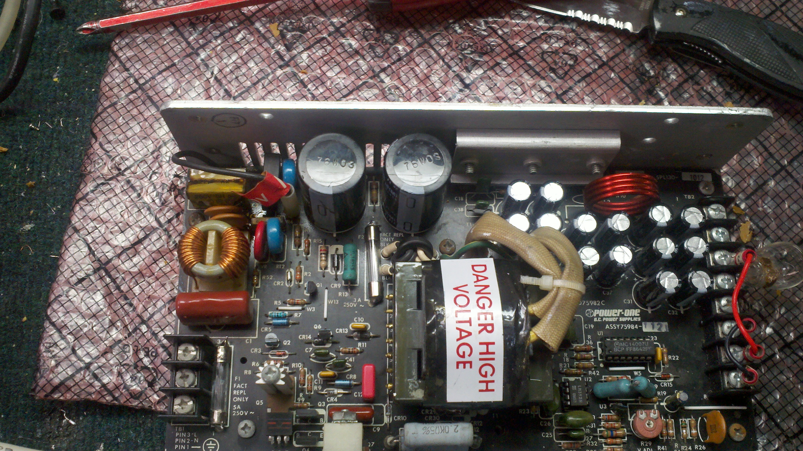

                          i suspect that case cracks letting moisture in is what kills these most often.
                          i rebuilt 2 of these units and the caps blew up in one after 15 minutes of running.
                          these had not been run in 10 years.
                          the caps went bad and they were given up as dead.
                          new caps there too and these are ready for another 20+years of use!
                            I think I saw a 1986 date code on the 14-pin IC, and it looks like it might be a discontinuous flyback. Maybe a single O/P, 120W-150W? Power One made good stuff.
                              those datecodes are about right.
                              a friend got these during the cb craze and the deact amps(motorola eb63 reference design)
                              these power supplies took some incredable pounding running these amplifiers.
                              they died from output lytics leaking.
                              you can see what i used.
                              an amp and one of these rebuilt supplies is running behind my yaesu ft-817.

                                I decided to perform a more extensive overhaul of the PSU and Floppy Drive recently. I had a small mishap that involved connecting the floppy drive to the Disk II controller card one row of pins over. Toasted the drive, and the PSU hadn't sounded right ever since. It was hissing while running, and the noise would become louder with additional load.
                                The toasted component inside the drive was the 74LS125 Bus Buffer IC, apparently a common failure when mis-connecting the drive like this.
                                I replaced it with a Texas Instruments SN74LS125AN from Element14, and the drive now works again. I'm fortunate in this case, because sometimes the MC3470P amplifier IC can also burn out when this happens, but mine survived.
                                As we know, the capacitors inside this power supply have always been suspect throughout the entire time I've owned it, and I figured that 33 years was enough. I replaced every capacitor inside the supply with new Panasonics and Rubycons (with a 105C maximum operating temperature).
                                Sure enough, it doesn't hiss anymore, and it can sustain whatever load on the power supply the Apple II throws at it.
