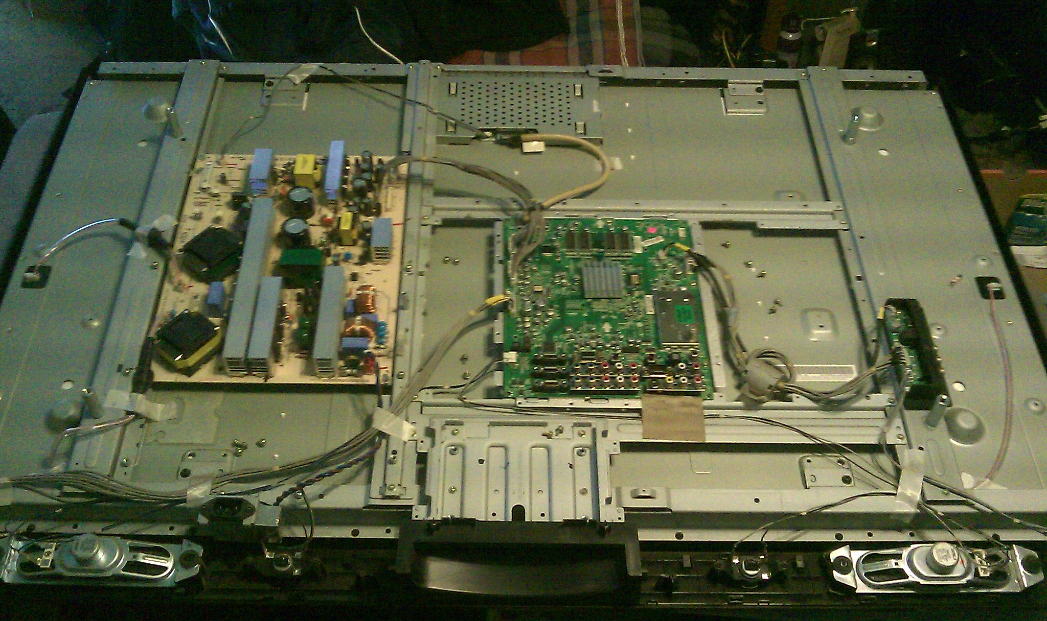

    This is a TV power supply and it powers up the speakers and everything seemingly except the LCD panel.
    What i have done so far is replace the 2 large CAPs, the fuse that was blown near it, 2 large MOSFETs, 1 smal MOSFET and 1 Diode. I pulled a couple of the bigger transistors and they seem to be working & i pulled the main bridge rectifier and it seems to be working correctly. Please keep in mind when i say they seem to be working correctly this means i used my Fluke 87 and used the stripes on the transistors to see what it should read and i read a few things on how to check the bridge rectifier (seen a video too) and it works according to both of those.
    After i replaced those 2caps, 3MOSFETS, 1Diode & 1 fuse i turned on the TV and after load up a popping noise came from the PS within a few seconds so i switched it off asap and unplugged it. When i gave it sometime to cool down and disconnected everything the stuff i changed is now like the damaged ones i replaced, So now i am where i started basically
    I am looking for help to where to look next.

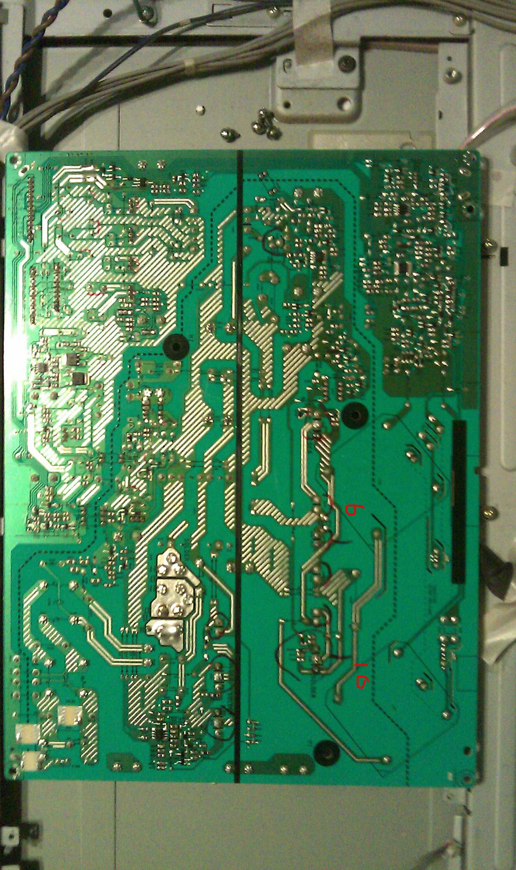

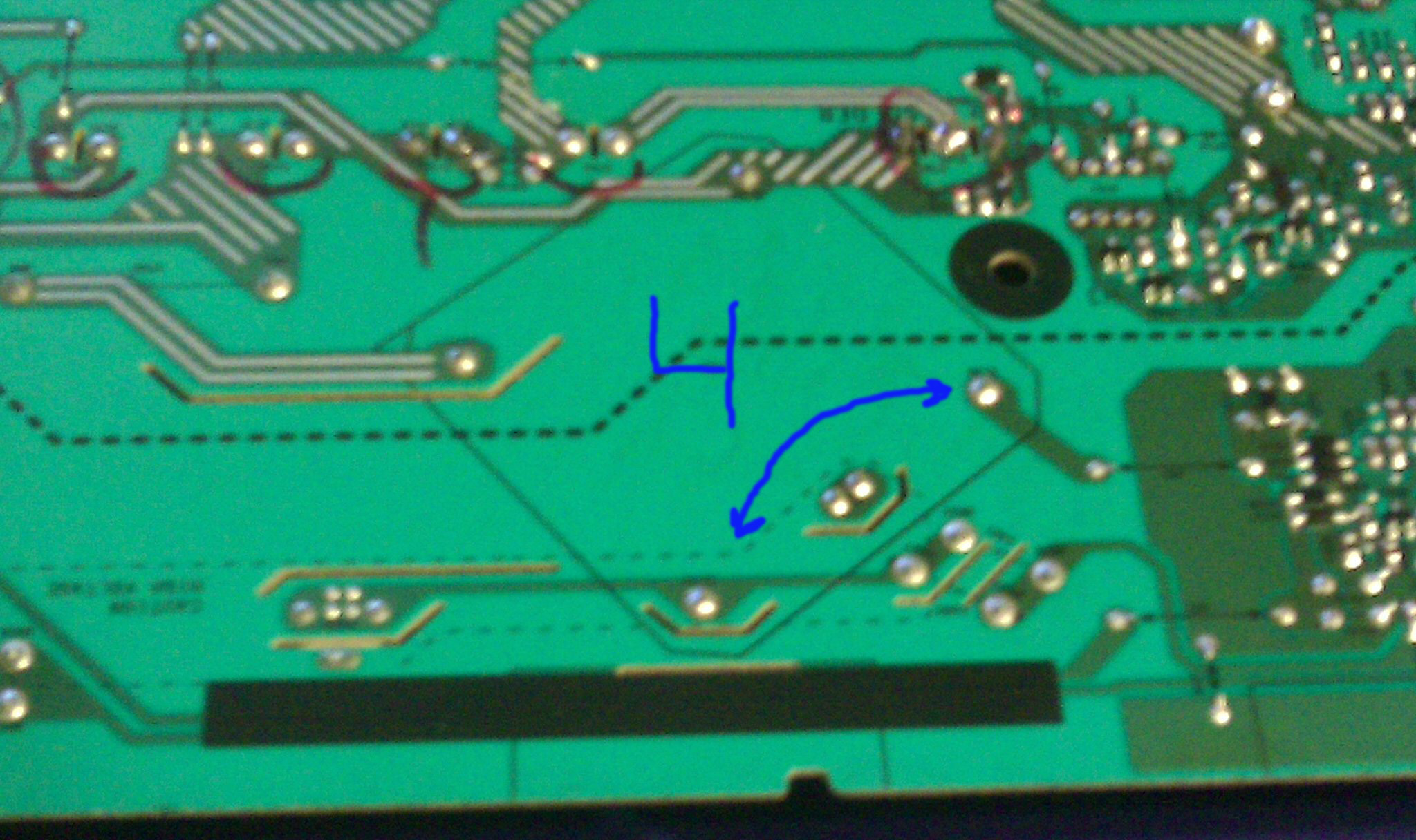

              Re: EAY36781302 PSU Partial power
              This board the way i understand it is a Power Supply/Inverter board (there are no inverter boards for this TV just the PS/Main/TCom). As far as testing diodes could i get some sort of guidance please, reason i ask is because i am a novice and i am confused between Schokky FRD and semiconductors. They are currently on board and i can pull if needed (i am new to this but like using my new Hakko FX888D) i own a Fluke 87 (not V) DMM
              • Behemot
                • 4845
                • CZ

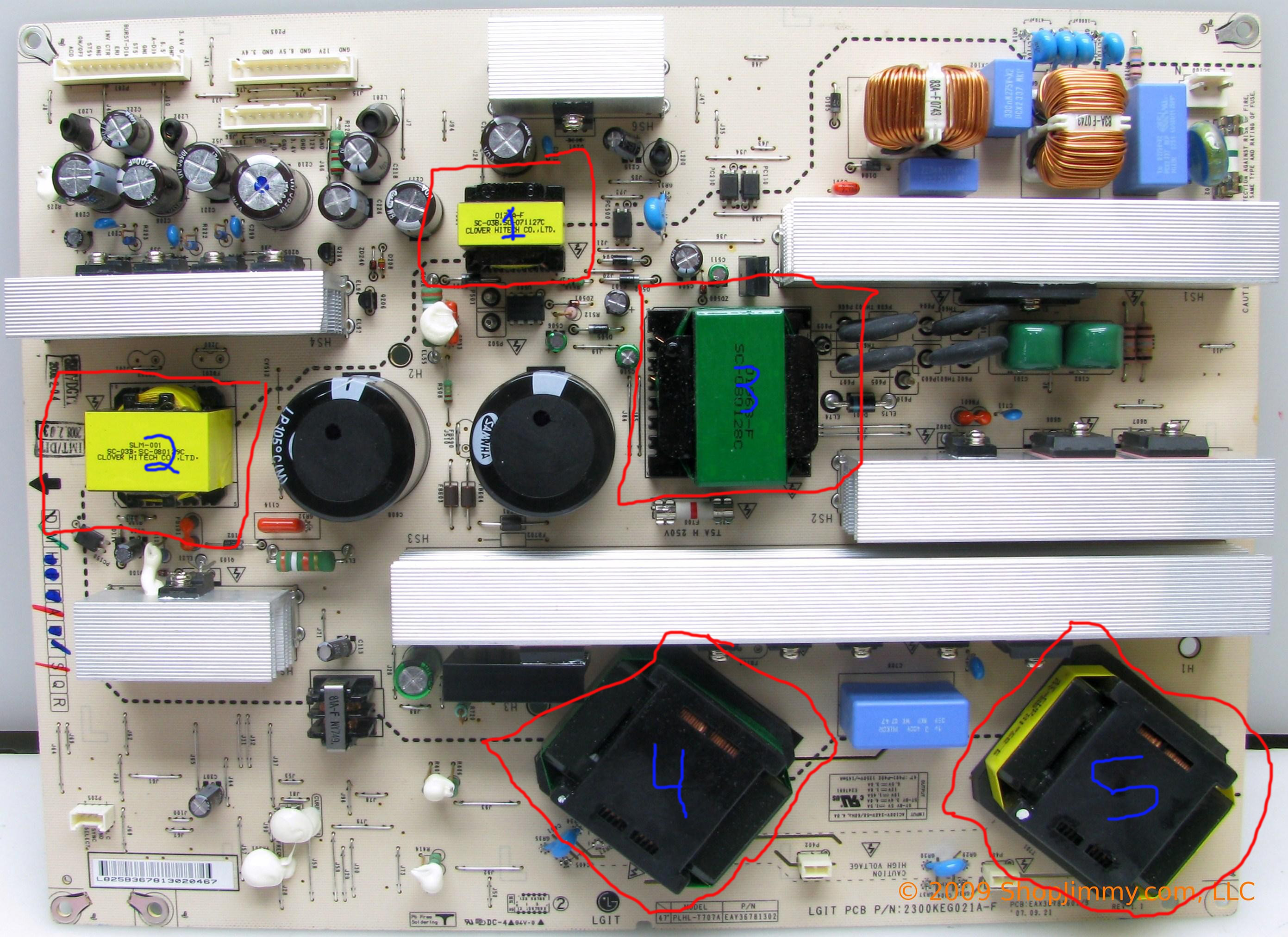

                Right you are, I haven't noticed those two connectors. Those new images are terrible man, I guess you are using compact and some kind automatic settings. And there is not light enough. It uses too high ISO for the sensor quality making the images look like mosaic paving.
                Anyway, start from transformers: measure resistance on their secondary side, usually it is arround 1200 ohm and the difference between both transformers should not be higher than 1-2 %.
                As for semiconductors, there should be settings for diode testing on the multimeter.
                  These are transformers right?, also i need to remove them from the board or can i test on board?
                  I am falling a sleep i am sorry to say because it is past 4am here but i will take any direction you are willing to provide me with after i wake up and please understand your help is very much so appreciated.
                  • Behemot
                    • 4845
                    • CZ
                    No. 4 and 5, you can test in circuit.
                      Ok the readings on the transformers read the same no matter which lead i put where and this to my math is more than 1-2% difference
                      #4 25.6 OHM
                      #5 24.1 OHM
                      I included a pic of the board and circled the diodes with blue and red. and measured with the meter set to diode and to hold/beep.
                      All the Reds were -0.001V no matter which direction I think these are diodes not sure.
                      All the blues were between .438 to .455 and no reading when i reversed bias so other than being just below .5 they seem to be working according to the way i understand how to read them.
