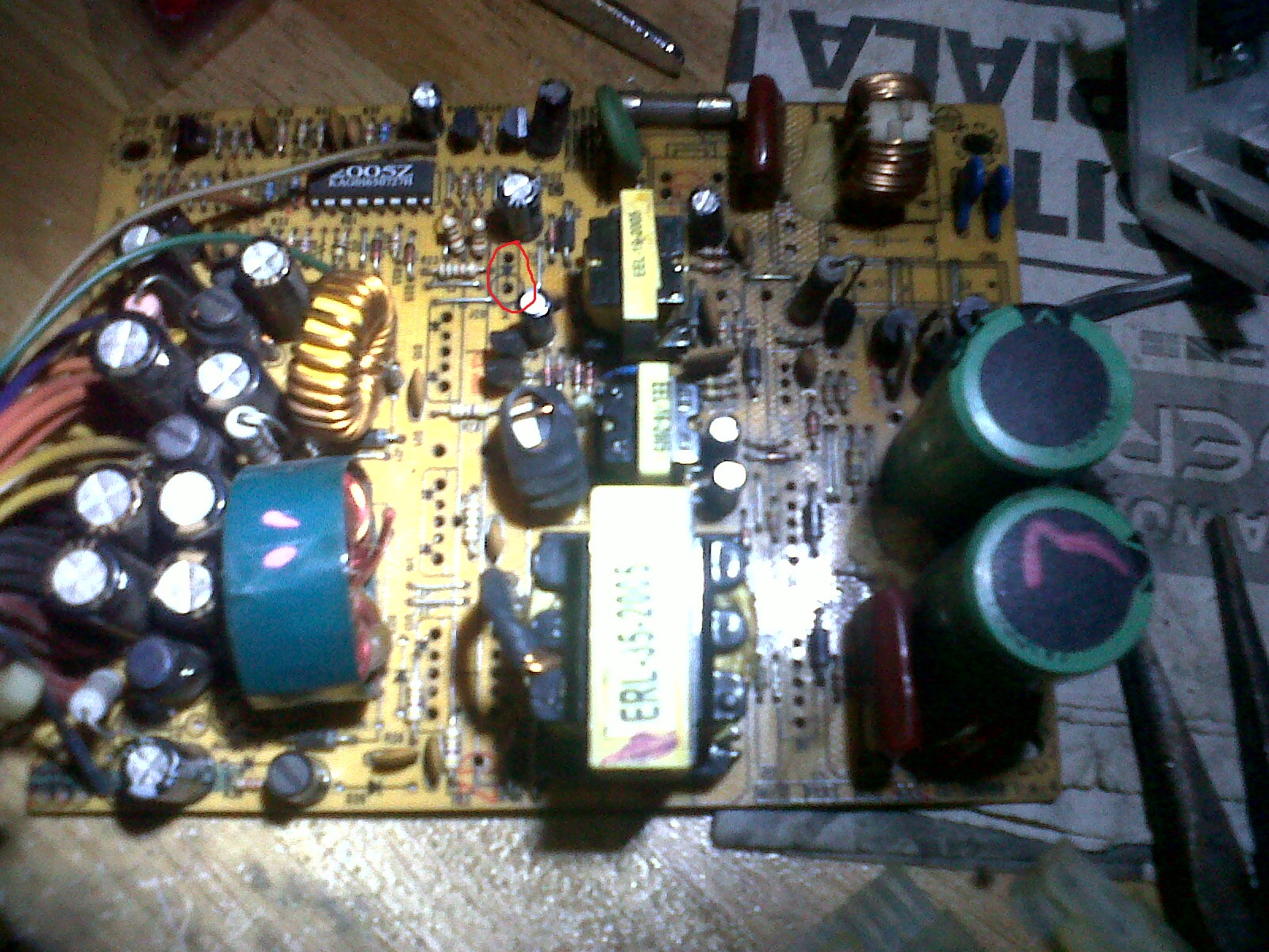

    anyone could u mind to help me fix this power supply please?
    i have 2 power supply like this specified and i just try to fix it after have a time. maybe u can tell me to buy a new cheap one. but i just wanna make a training for myself because that PS looks like a challenge for me, i haved repaired the other 2 piece PS before. and the problem just a bulked caps so it's not a very hard of course.
    i just think that power supply can be used again with this problem that is not very bad i think
    1. one PS have a voltage in rail likes 12v, 5v but the problem is I get a little electric shock when i touch the probe meter to measure volts, of course that is a problem so my PC can't turn on when i use that. i can't figure out the problem.
    2. for the second one there is almost have'nt any voltage in rail. i just try to open it and like the other's guide maybe the power transistor, mosfet, or diode schottkhy have a problem, i try to use my AVOmeter test that, the transistor and diode looks like no problem, Mosfet is the one I don't know to to test it. so i can't tell you that is fine or defective.. this photo below is the second one power supply..
    So anyone could help me what is the problem with my PS? for note i have already test filter capacitor and mains filter capacitor 200v with my homemade ESR meter, every caps looks like fine and have a low ESR and didn't have a bulked, leakage view of course.. i think the problem maybe the IC 2005Z on this photo, but it just a predict. my fuse looks fine when i tested it. no sign likes burns, or stinky smell.
    any advice or guide to test the predicted defectice component is really helpful..

    On the first PSU replace the Y caps which are most likely failed and leaky, and dangerous. They are on the primary side from line to earth and neutral to earth. Also make sure you are using a properly grounded outlet.
    On the second one, what do you mean by "almost haven't any voltage?" Numbers please.
    By the way, your photo does not show.

      first at all, thanks replying
      Y caps is caps means filtering mains current? it has 2 caps that i tested good with my homemade esr meter. but i'll try your advice.. i have a unused caps on my store box.. sorry i think that my upload success. and sorry for late replying bcoz busy on my college. haha..
      i means that it hasn't voltage when i measure it. just 5v on standby mode. the others no voltage absolutely... is there any advice?

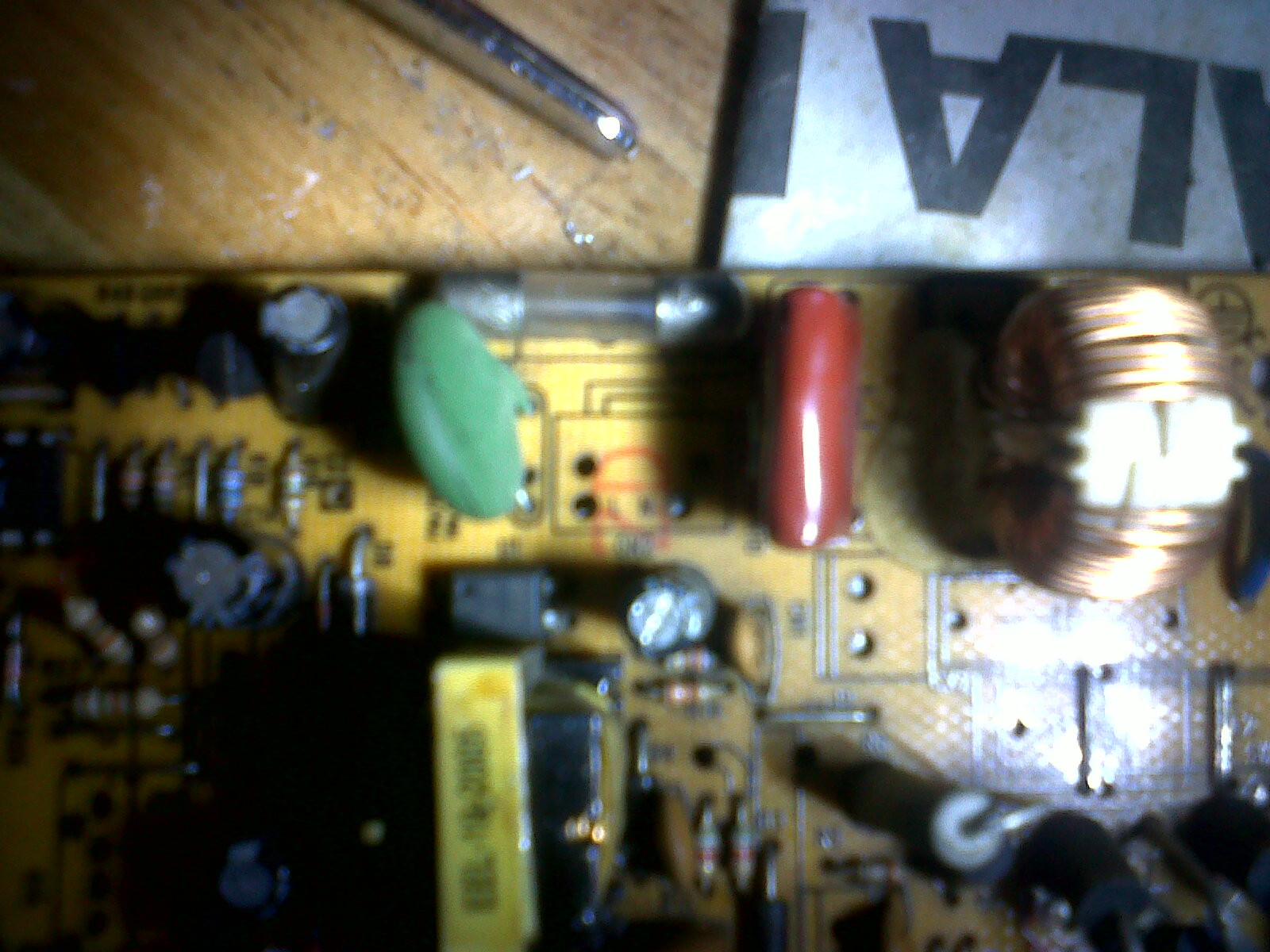

        The Y caps are the two blue ceramic caps in the corner.

          Y are usually the blue ceramic caps which should be safety certified as Y caps but they often use cheap uncertified ones in this crappy PSUs.
          As Th3_uN1Qu3 suggested, check that you have good ground in your plug (aluminium conductors for example get loose quite often in the plug and you need to tighten them). I would also add to check the grounding inside the PSU. The earth wire (middle pin) should be connected tightly to the casing.

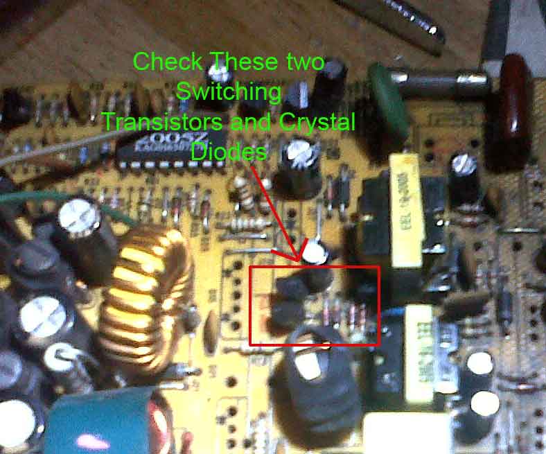

            For the Second Power Supply - If you get +5VSB and Both C13007 in Primary Side are OK then, --> Check those Switching Transistors (C945 or C1815) and Crystal Diodes (1N4148) Which I have shown in the Image . May be one of them or Both transistors (C945 or C1815) or Crystal Diodes (1N4148) are faulty .
            For First Power supply - one of the Capacitor or Diodes or Y capacitors is leaky . But it is very difficult to find the Faulty one !!! I think you should leave this First one otherwise it will crack your brain !!

              thanks the advice.. i'm gonna change it and maybe it fixed my problem issue..

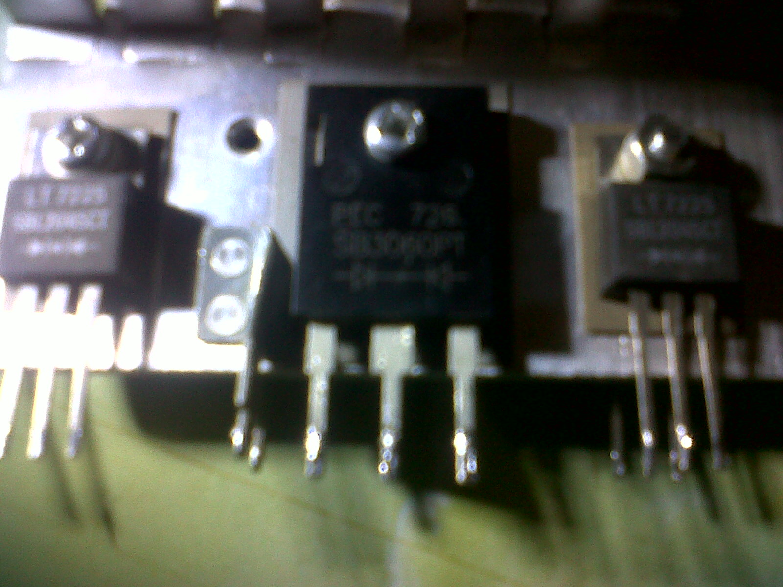

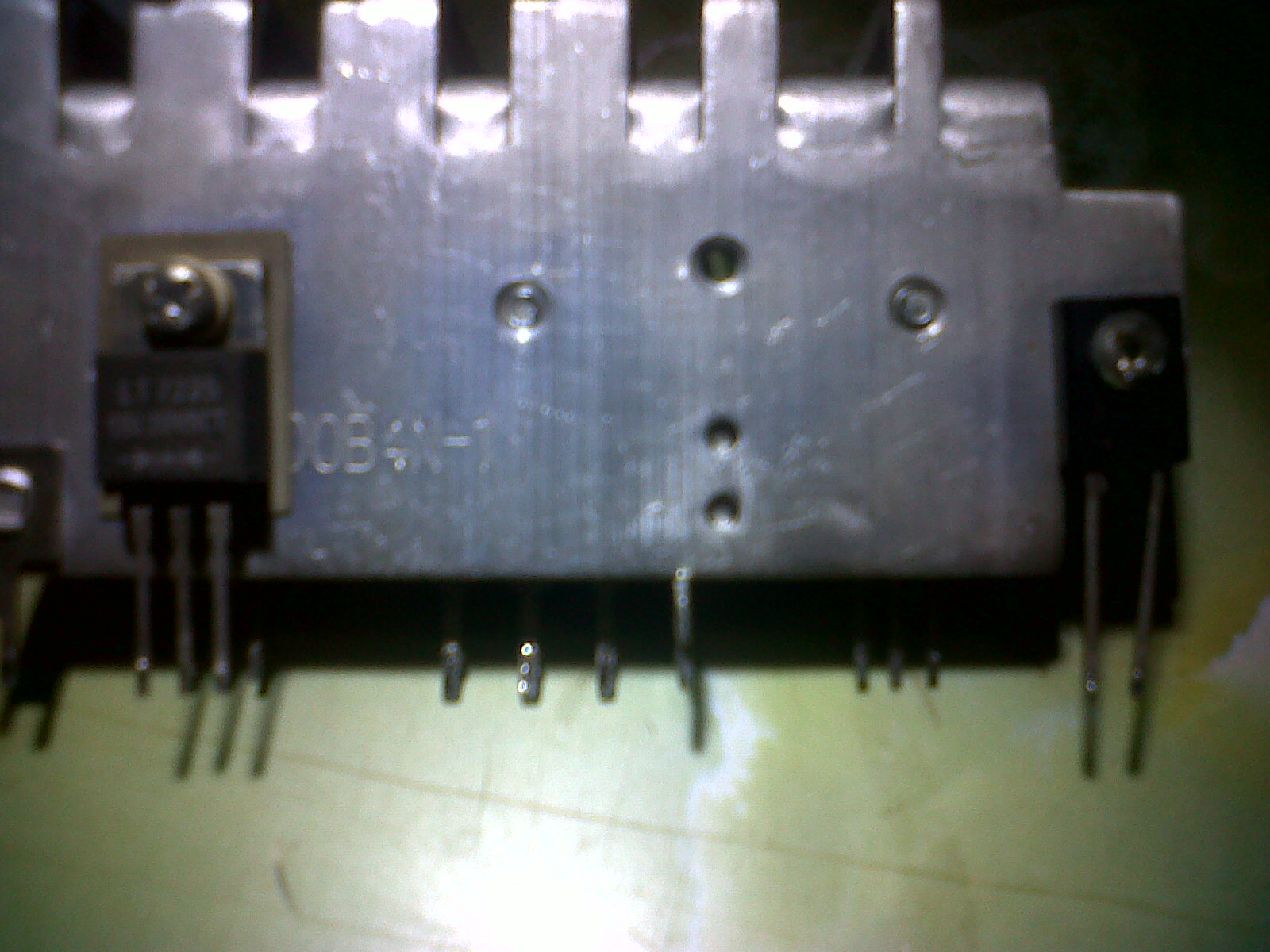

                Did you check the diode that you pulled that was just to the left of the 5VSB transformer? (Probably SB540 or SB560) Also check the little 50V caps in that area (and the two by the feedback transformer), seen YC caps dry out and die

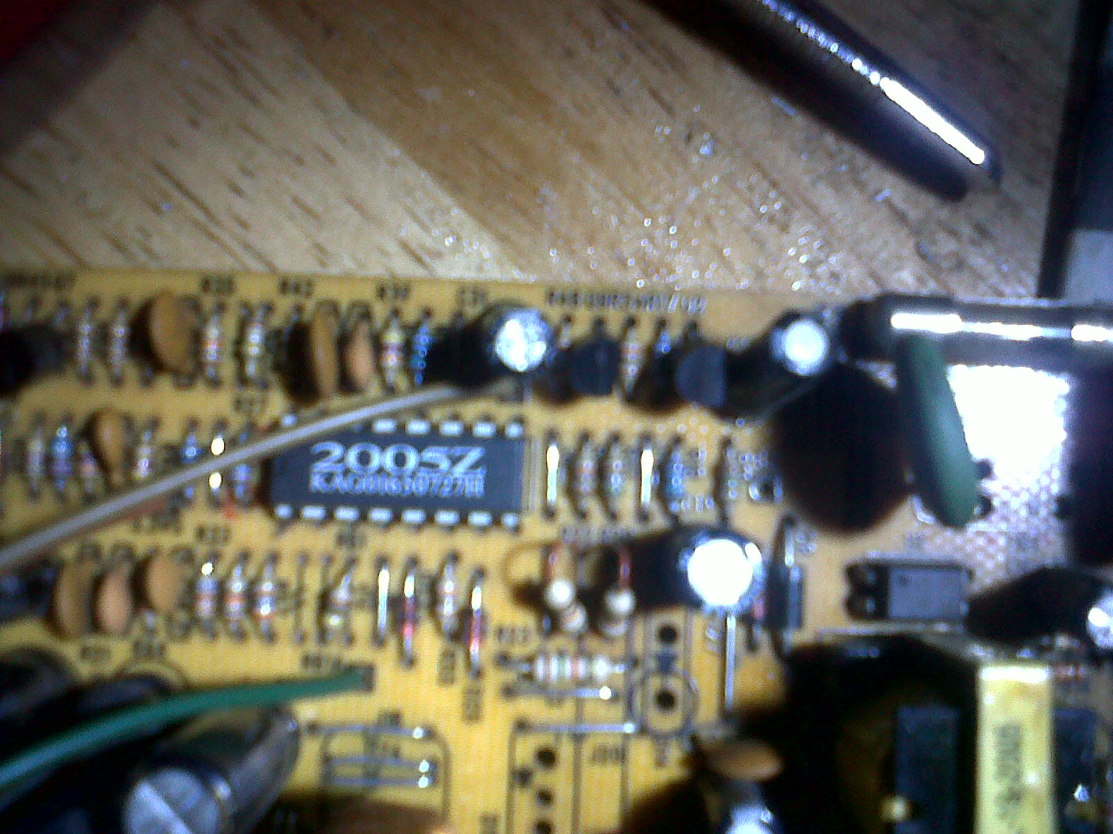

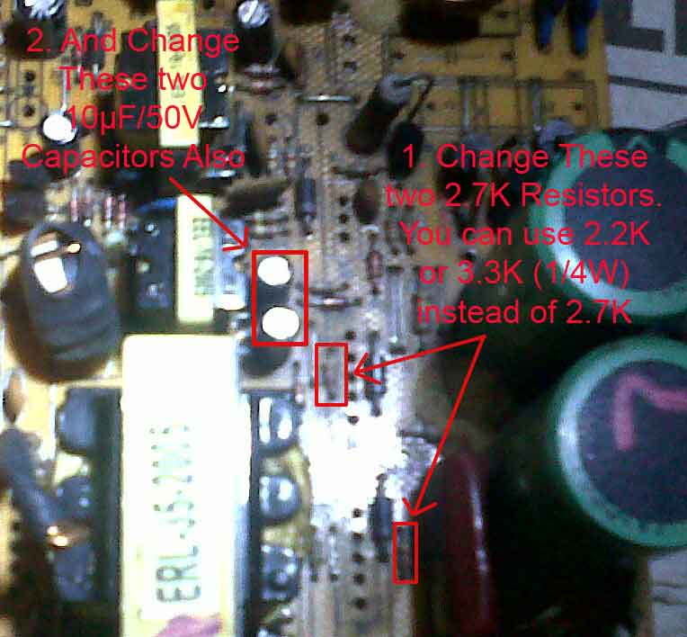

                    If the both Transistors and Crystal Diodes are OK, Then change ---
                    1. Those both 2.7K Resistors. If you don't find 2.7K Resistor in the market, then you can Replace it with 2.2K or 3.3K (1/4W) . (Shown in the Image)
                    And Change -
                    2. Those both 10μF/50V Capacitors also . (Shown in the Image)
                    And let us know what is the result ......

                      did you mean schottsky diode on the heat sink sir? component on the heat sink is already checked likes i said in the early posted.. but just the one mosfet i still no confidence to say it is defective or not because i don't know the way checked mosfet with my cheapy analog VOM.. the other's has good result and i just checked it good..YC caps where it is exactly?
                      for note : i have already change two blue Y caps on the corner (472, 1Kv) that suggested from the other's kind and tighten ground cable in mid of mains socket to the case already. but it is still got me electric shock
                      And Change -
                      hmm.. i don't checked the transistor and diode already, but i have already change the Y caps because i thought that lead me to good result..but it is still got me electric shock.. there is exactly another defective must to change !! I think this night i wanna make it clear.. to check all about you suggest sir.. this night gonna be a long long night of course i'll be as soon as give you the result..

                        I attached a picture of the diode i was referring to.
                        Are the blue Y caps you used safety certified?
                        It looks like all the electrolyitcs are YC, I would check all of those small capacitors probably ranging from 1uF, 2.2uF, 4.7uF, 10uF, 22uF, 47uF all rated at 50V

                          the resistor, transistor is fine and diode also..both capacitors value 2.2μF/50V in my case (not 10μF/50V) like the one u point me on photo to check also fine.. so i didn't change anything.. just the Y caps.. what is the next step that i have to check the component sir??

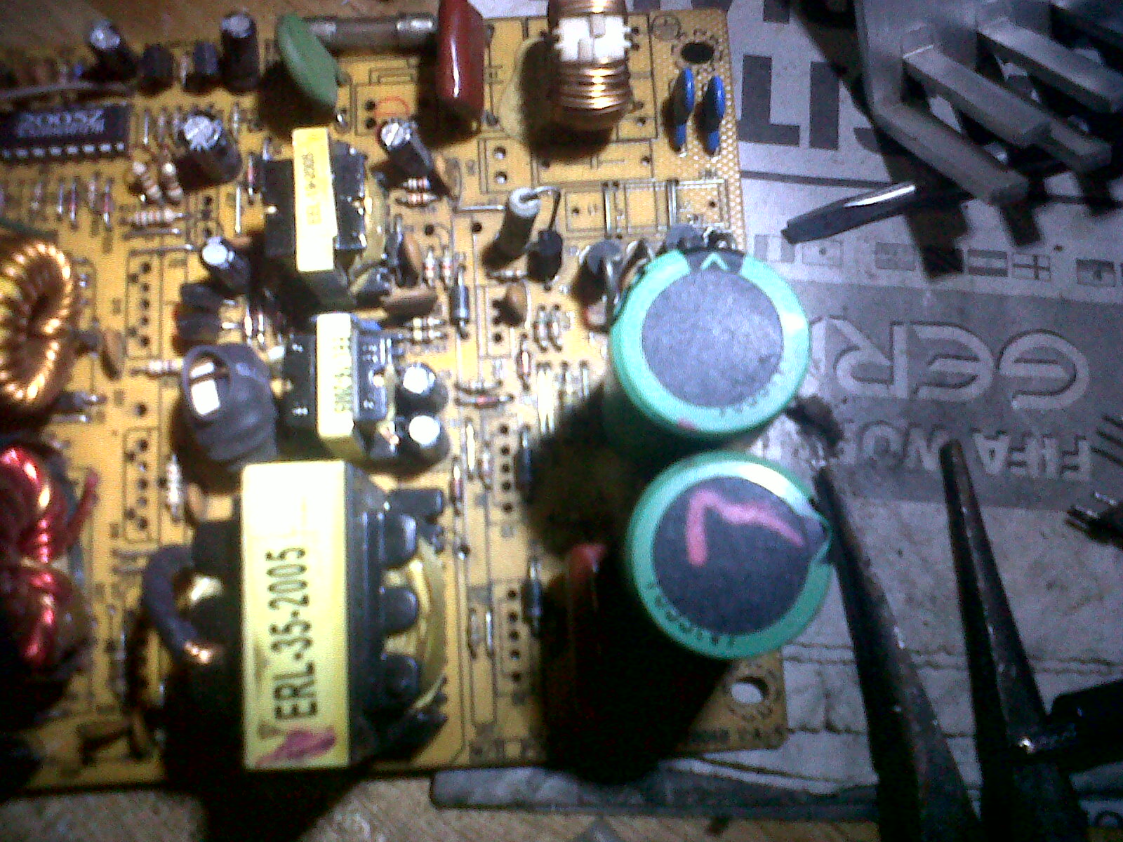

                          i think i have to upload my changed capacitor and hear ur opinion about that.. as soon as i will give u the photo sir..
