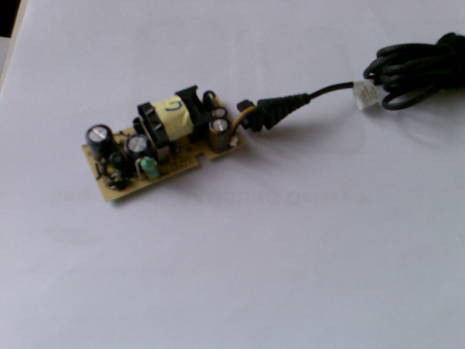

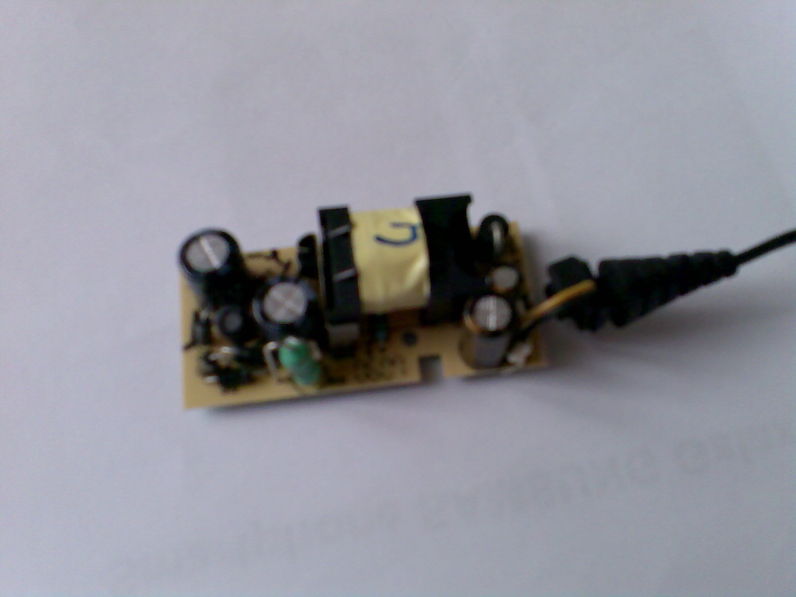

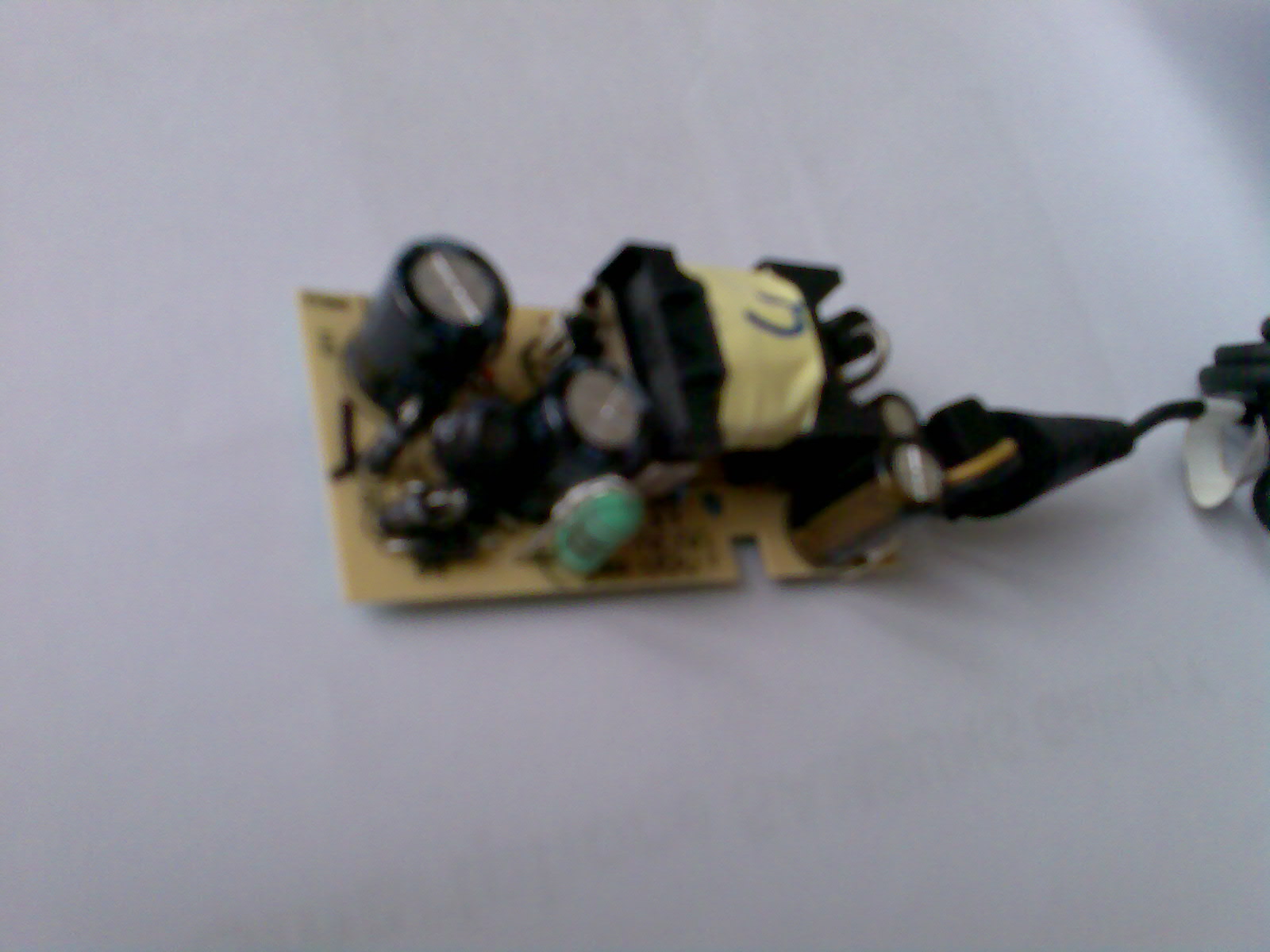

    I have several Nokia charger - ACH-6E, AC-4E ...
    All of them have a 10 Ohm resistor in the 220 V.
    220V -> 10 Ohm -> 4 diodes -> 2x 6,8 uF 400 V ...
    and in AC-4E the resistor is burn.
    Tested the Caps with EVB - ESR ok
    SMD with Smart Tweezers ok ... several caps and resis.
    Why 10 Ohm blow ?

    Re: Nokia ACH-6E, AC-4E
    Shorted out diodes, or power transistor.
    The 10 ohm resistor is used as a half-assed replacement for a regular fuse, because it is cheaper
    Can you get some good pictures?
          Originally posted by neuron
          Thank you ben7 and cheapie,
          I have LCR and ohmmeter - "Smart Tweezers".
          I will check and report - the 4 diodes or the T.
          The L10 is very low and the reading is very nH ... its strange
          The quality is bad ... Hope you can id.

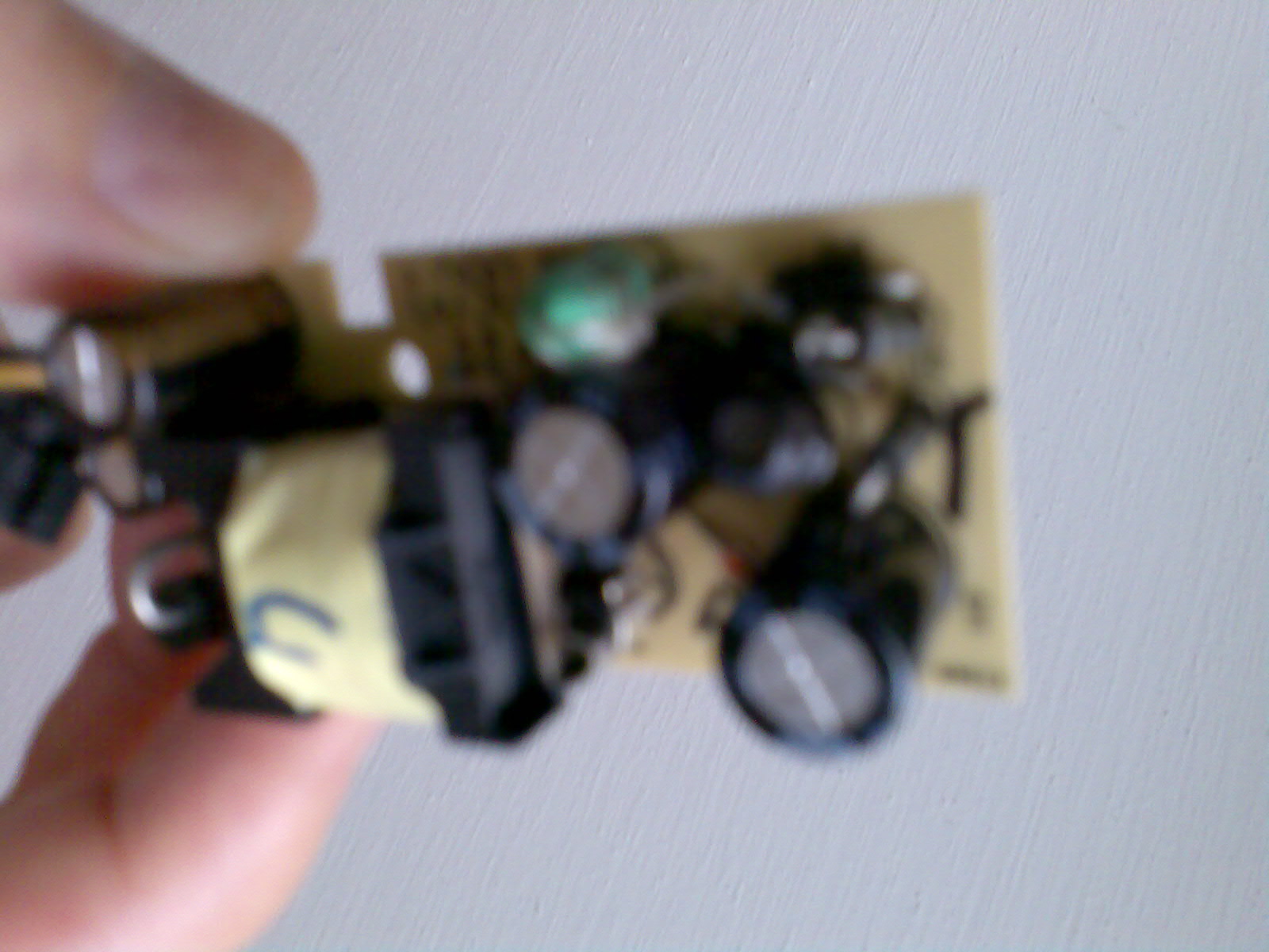

              Pictures are useless. Move the camera further away and try to snap pictures again. Get the pictures in focus, it's not rocket science.

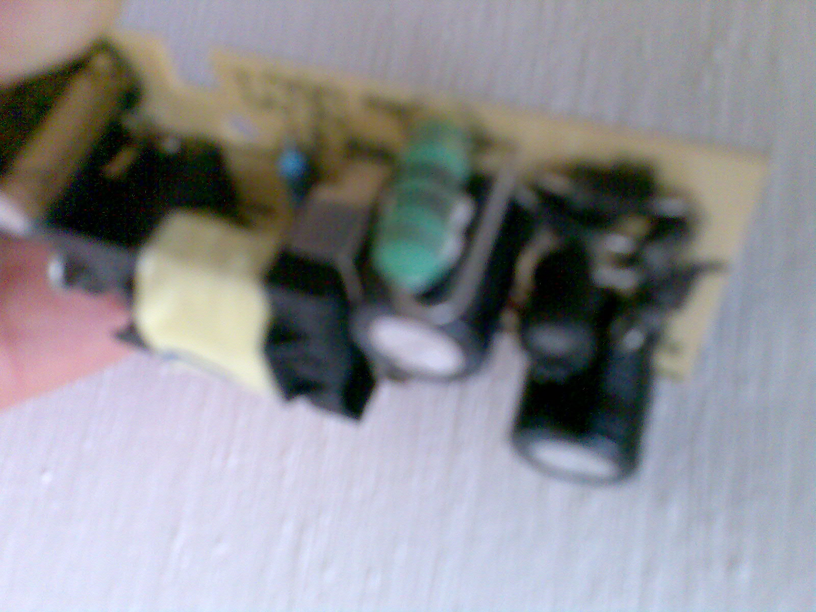

                Transistor (in circuit)
                Z= 114 Ohm, 4.941 Ohm, 116 Ohm
                The two big caps in left 6,8 uF 400 V.
                4 diodes 1N4007
                The green Resistor 10 Ohm - burn.
                The Inductance L10 between the 2 big caps and the 4 diodes
                I can't measure the Henry ..... very low mOhm
                And 2 SMD - R21, R14 usually are black with the Ohm numbers, this ones are green ...
                Regards,
                Ruy
                    Again, please provide us with focused pictures. These are useless for us

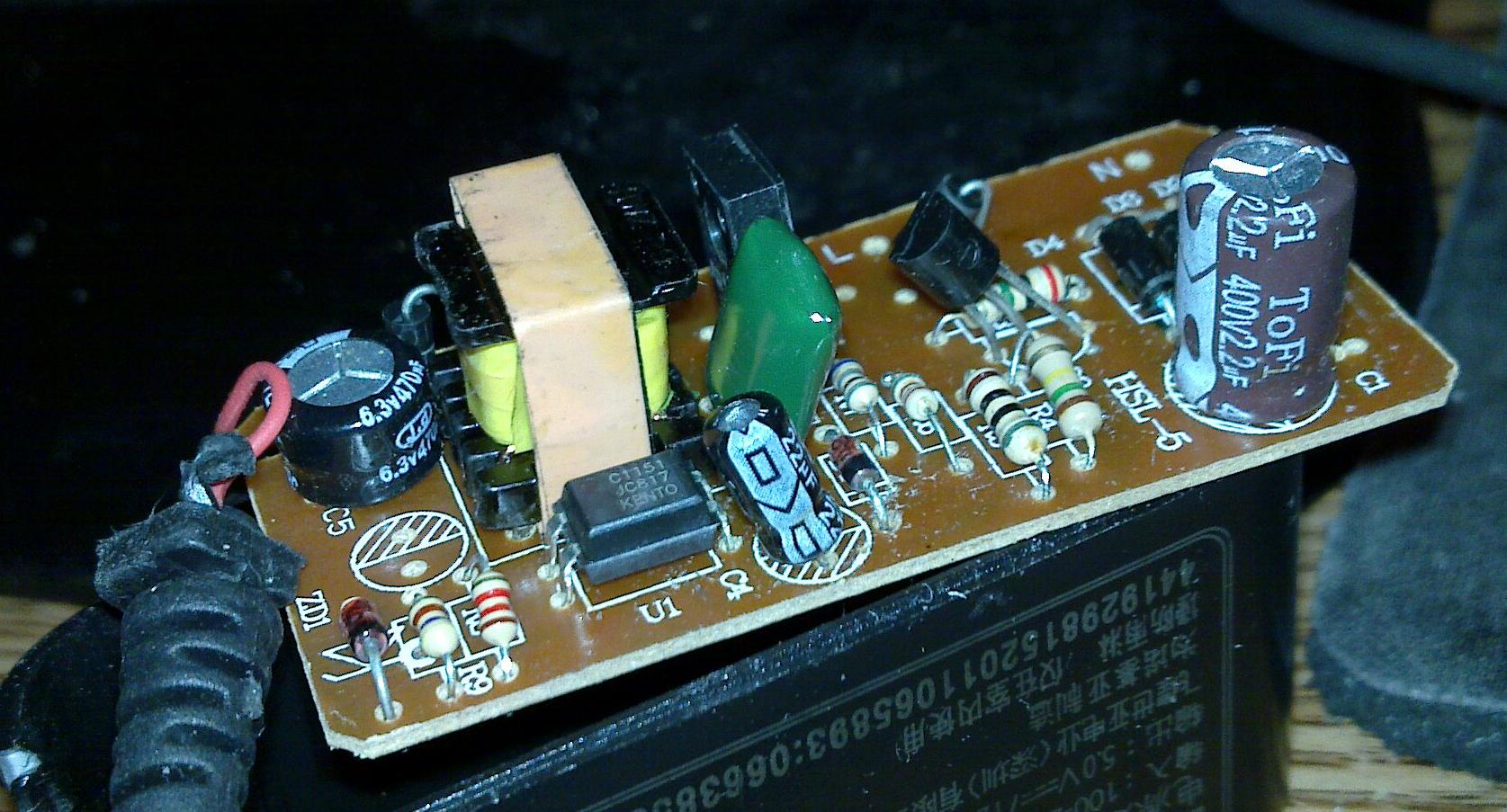

                      I don't know if this is any use but here's my Nokia AC-10C guts:
                      Fairly common 2-transistor optoisolated feedback design with fullwave rectifier. This one works actually, but the problem I had with it turned out to be mechanical...

                        Thank for your comments,
                        But at moment I don't have a camera with better resol.
                        I described the components in detail, If you have any doubt about any piece please tell me.
                          I can´t see any faults in the pictures you provided - they are to blurry.
                          You must understand that it´s impossible for us to help you (or any other member) without proper information and, in most cases, clear pictures. Otherwise it´s like telling a blind person how the color red looks like ....

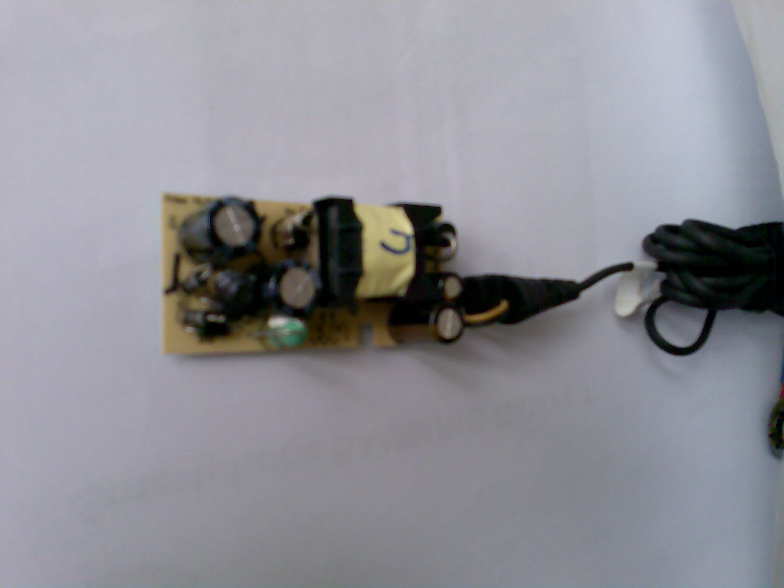

                              Thank you for your comments,
                              Update
                              I removed the coil (between 2x 6,8 uF 400 V).
                              And the short-circuit disappear (test with a series light bulb).
                              The diodes and the first 6,8 uF-400 V ok - the first cap has hundred volts
                              Insert again the coil and removed the second 6,8 uF 400 V ... short on.
                              The 2 caps and the diodes are ok.
                              The board has TH 2267.1 0706.
                              I searched and this is a special IC.
                              Regards,
                              Ruy

                                Replace the main switching transistor
                                  Removed the transistor and
                                  |_1_2_3_|
                                  Pins 1 - 2 -> 4,6 Ohm in all directions.
                                  The T. has a short.
                                  "Petit Problem" the bottom is all burn and I can't get the name and the number.
                                  Measured the main path in caps, in main transf. and now
                                  we don't get low Ohm.
                                  Connected 220V and "no short".
                                  The only problem, I can't read or get the type of Transistor.
                                  Best Regards,
                                  Ruy

                                    Which pin on the transistor connects to the "-" of the 400V filter capacitors, and which pin on the transistor connects to a pin on the transformer?
                                      Pin 1 -> TH 2267.1 0706 right pin (bottom),
                                      Pin 2 -> The transformer,
                                      Pin 1 -> "-" Caps but there is a serie of SMD
