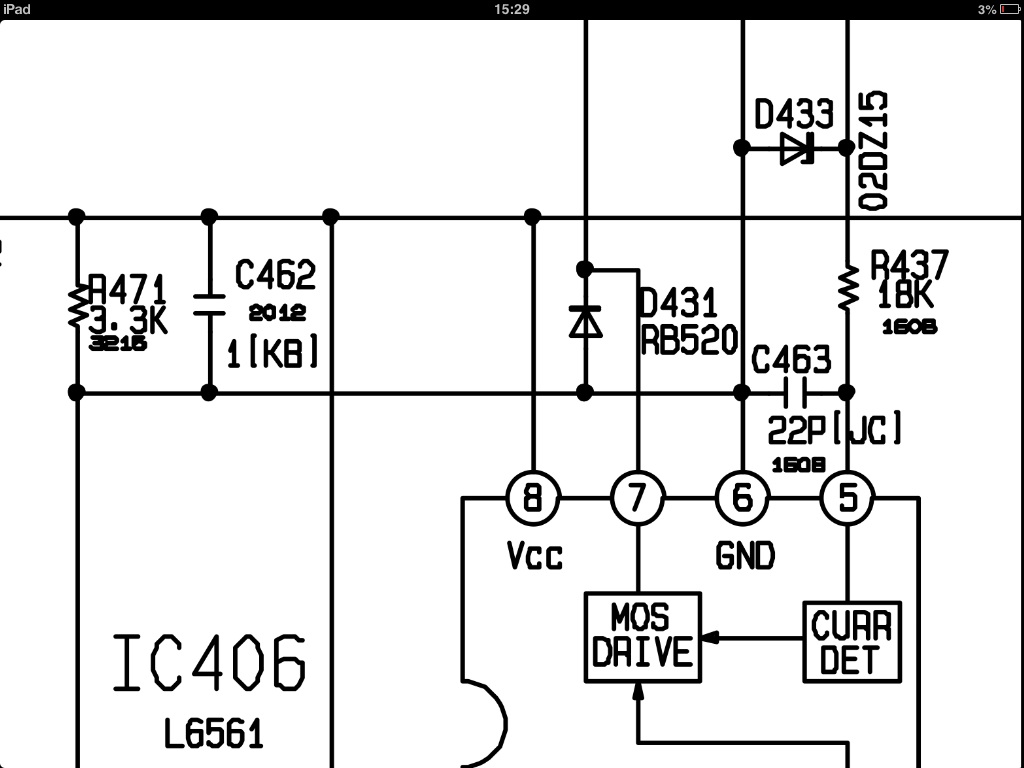

    Hi guys I have a Panasonic power supply iam repairing and can't figure out what size c463 and c462 capacitors are in the picture am sure some of you guys will know straight away
    Re: What size capacitors are these
    C462 = 1uF, MLC (Multi Layer Ceramaic) capacitor type, 2012 SMD body size
    C463 = 22pF MLC (Multi Layer Ceramaic) capacitor type, 1608 SMD body size
    16V or more voltage rating is more likely, need to check the VCC voltage.
    IC L6561 PFC IC.

      Thanks budm
      Here you don't an equivalent to an 00jc5w voltage regulator as the only place I seem to be able to get one is china
