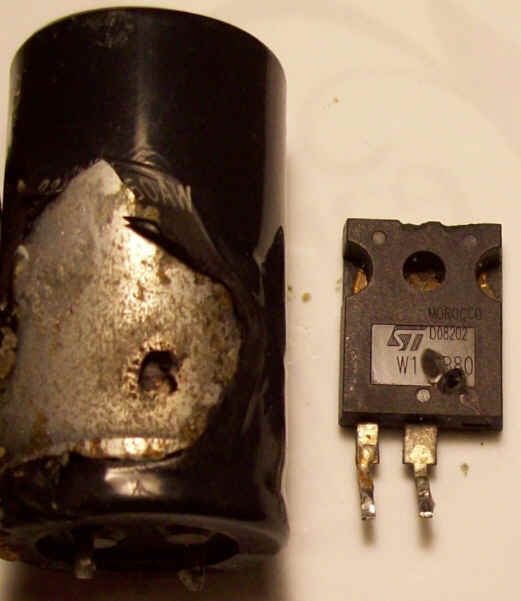

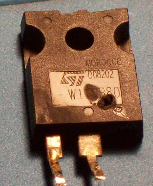

Are you absolutely sure it wasn't the way the transistor blew a hole in itself while also flaming the nearby capacitor? Cause if the cap blowed, it would be either from top or bottom, never side. Side is made from not-that-thin aluminium in a shape of can.
The cap may actuall be fine, you'll just need to strap some tape around it to isolate the can.
