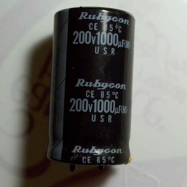

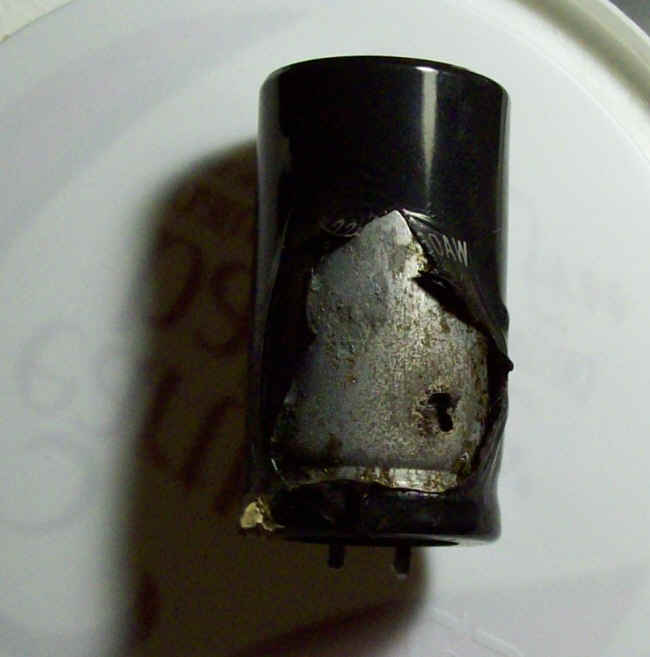

                                        The Antec TruePower480 had Rubycon 1000uF 200V filter caps. see pics.
                                        Any idea why one of these would just blow a hole in itself? It was kinda dramatic. Resulted in burning a hole in a nearby power transistor!
