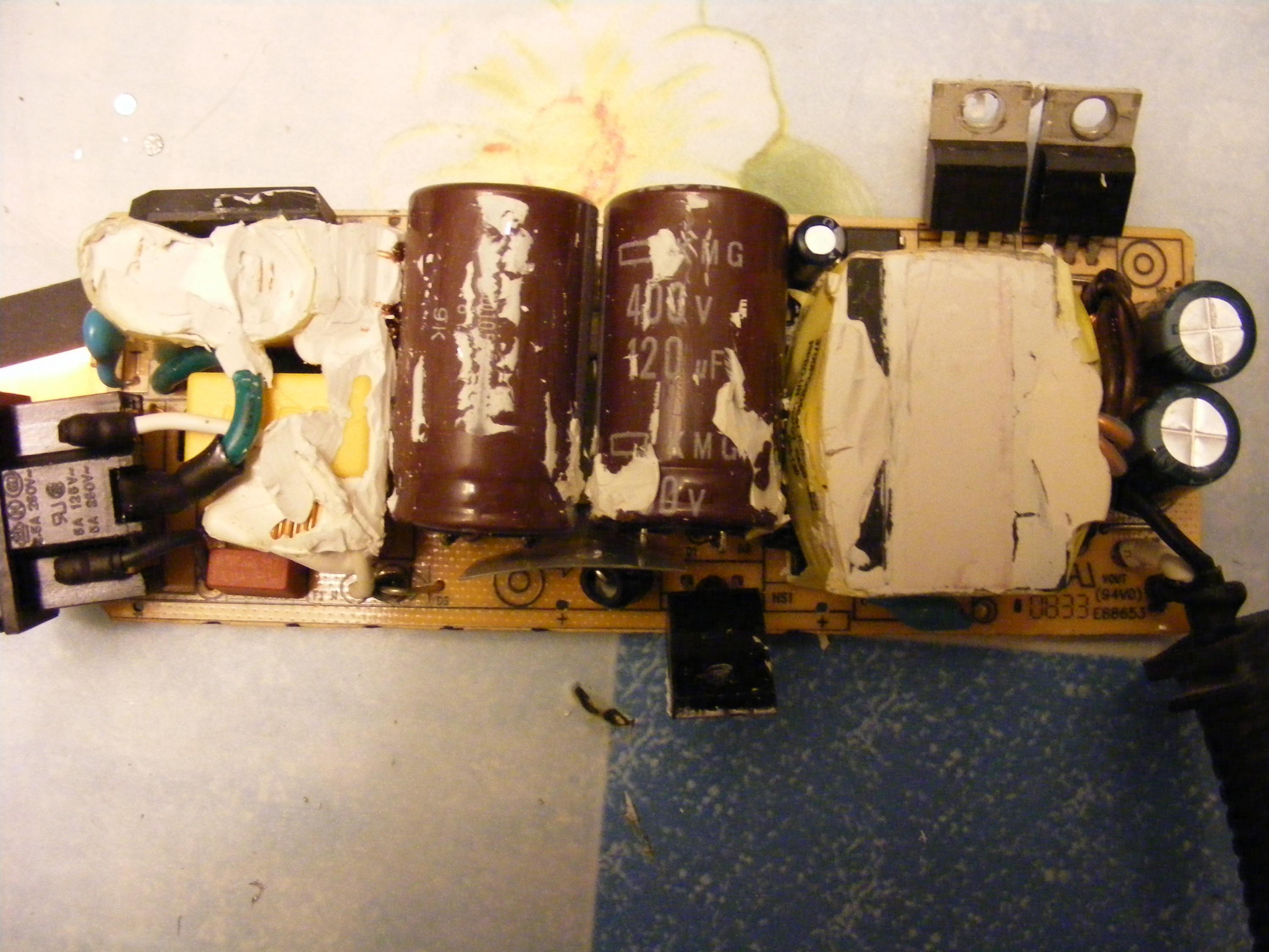

    I have a 19V 4.7A HP laptop P.S. I get this high pitched very faint ambulance like noise......WE-DO-WE-DO...you get the idea. Oh, yeah, and no power leaving the P.S.
    So, like the annoying troublemaker I am (tinkerer/explorer) I open it up. And it's full of white silicon glue, so I can't see anything!
    NO PROB! One boxcutter and ten minutes later, take a look at the pics!
    The caps look good, nothing looks burnt out. But I WANT to fix it.
    BTW, there is a black rectangular ?? with 4 prongs to the right of the 2 large power caps. What is that?
    please help!
    All I have is a DVM, no cap testing function.

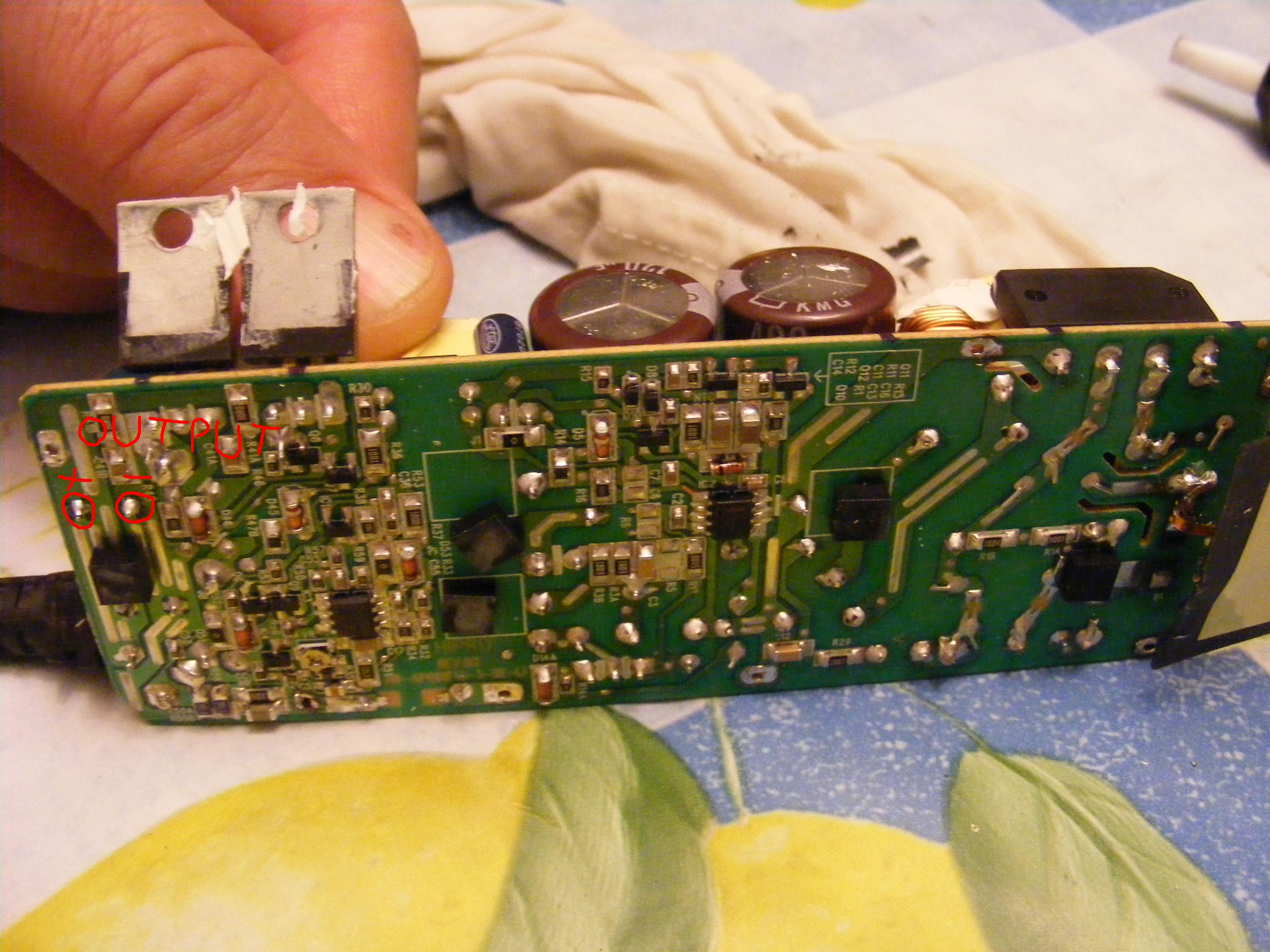

    To the right in the first picture, or on the second ? If in the second, that is a Bridge Rectifier. With the multimeter, test for shorts between its legs.

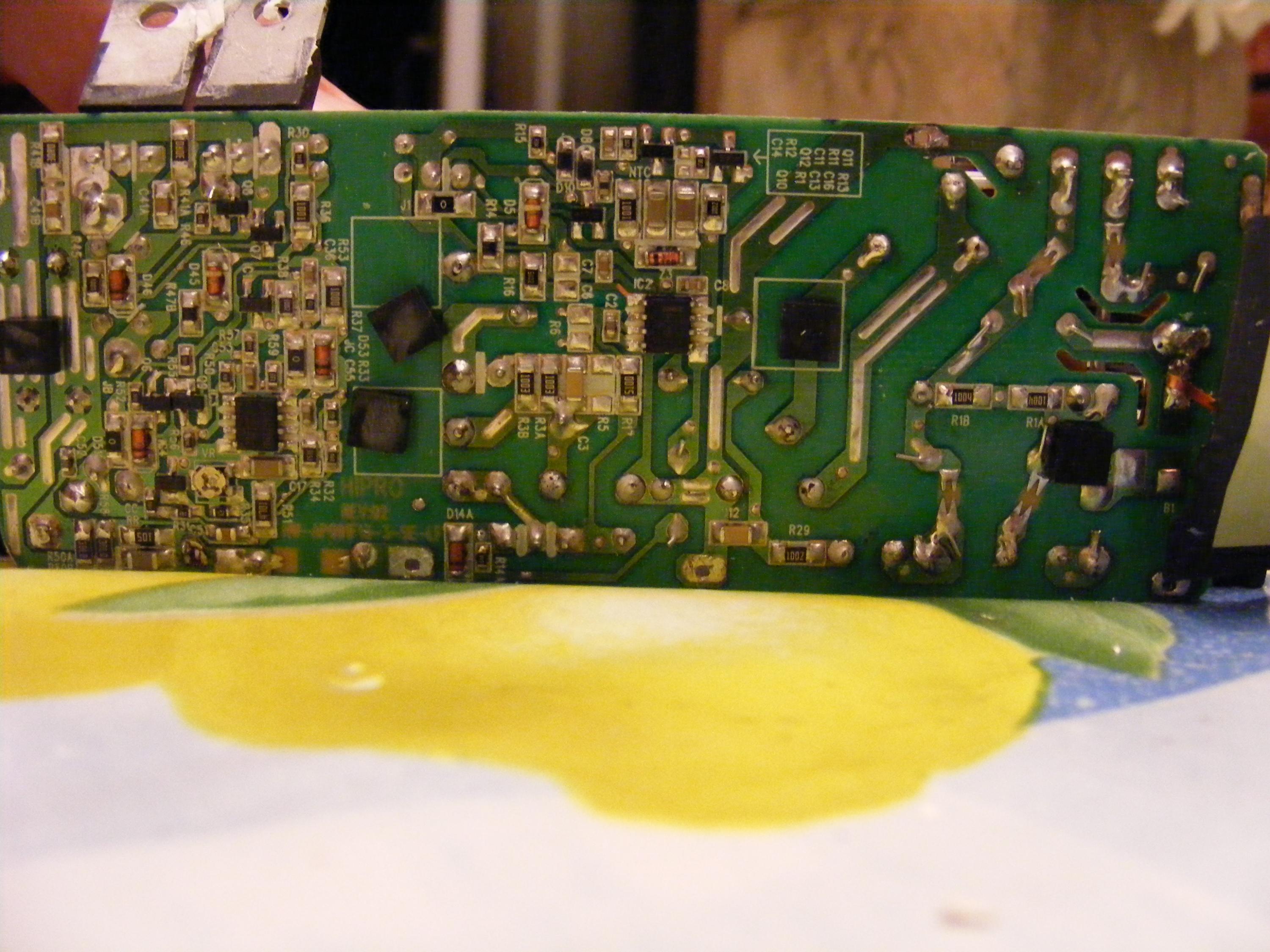

    Also, try to get a clearer pic of the undersido, so that the labels in the ics can be seen.

      You should replace the LTec caps. Most of the time they go out of spec without showing any signs.

        Likely power cycling from going into protection mode, because of DC-side short.
        Probably makes a sound like a rodent repeller.
        Back in July, someone brought a ThinkPad with that problem, it was fried!
        (I sniffed it around the keyboard.)
        And when unplugged from the laptop input, that sound stopped.
          thanks. It's the second picture, so I guess it's a bridge rectifier. Do I take it off the board to test?
          If it is shorted, how can I buy a replacement if it has no numbers on it?
          More pics to come

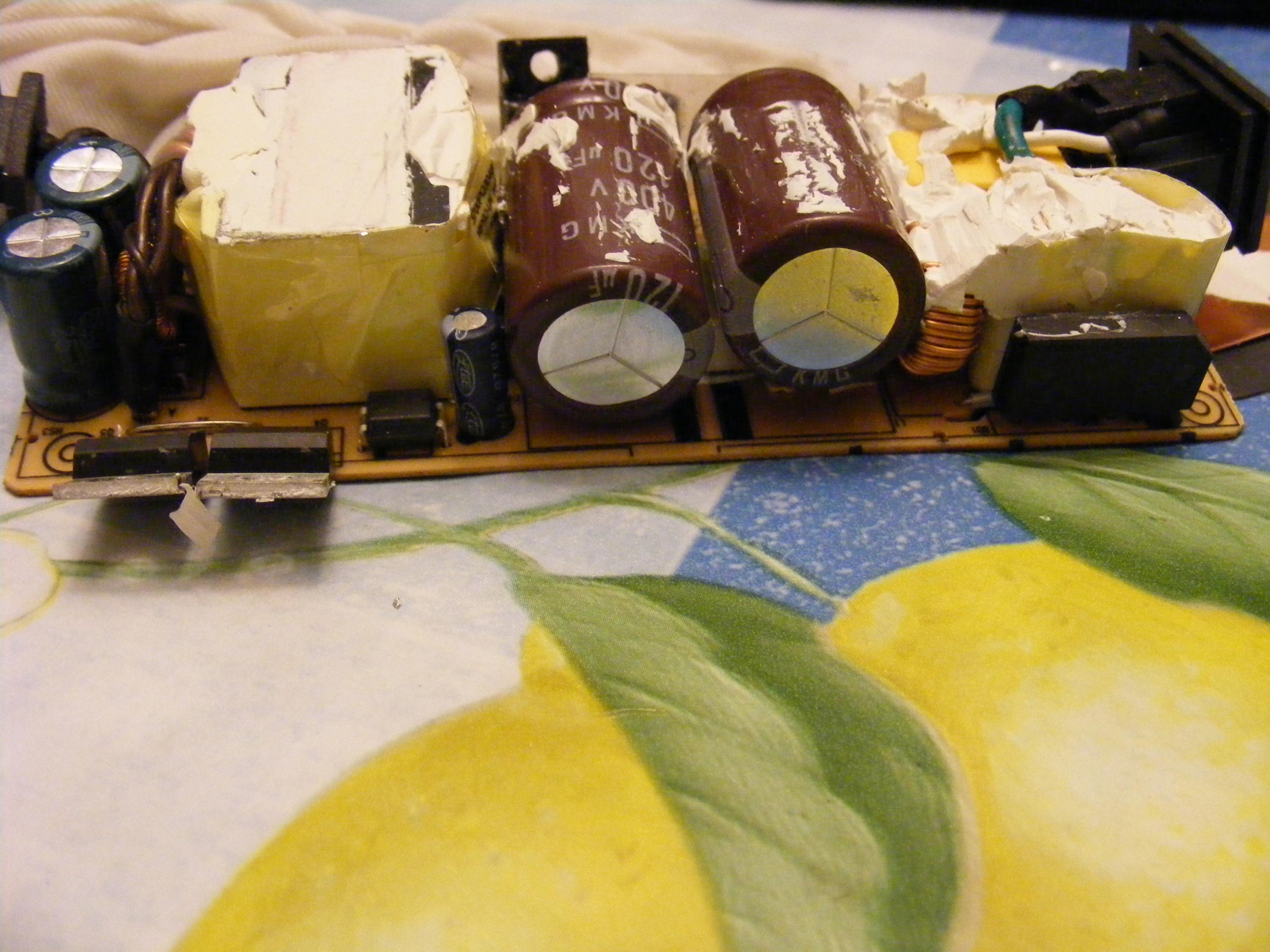

            forgive me, but are those the two 400V 120uF caps, or the very small ones?

                I would like to add in a clue (maybe). after getting bitten a few times, I decided to discharge the 2 large caps. (with a screwdriver).
                I did the first one (the one on the left in picture #2) and got a really big spark and loud crack noise.
                Then I did the second one, and got a very feeble noise and a few short weak sparks.
                Does that mean anything?
                  The small one near the two large ones, and the two medium size blue ones on the left side. They say "Ltec" on them in cursive.
