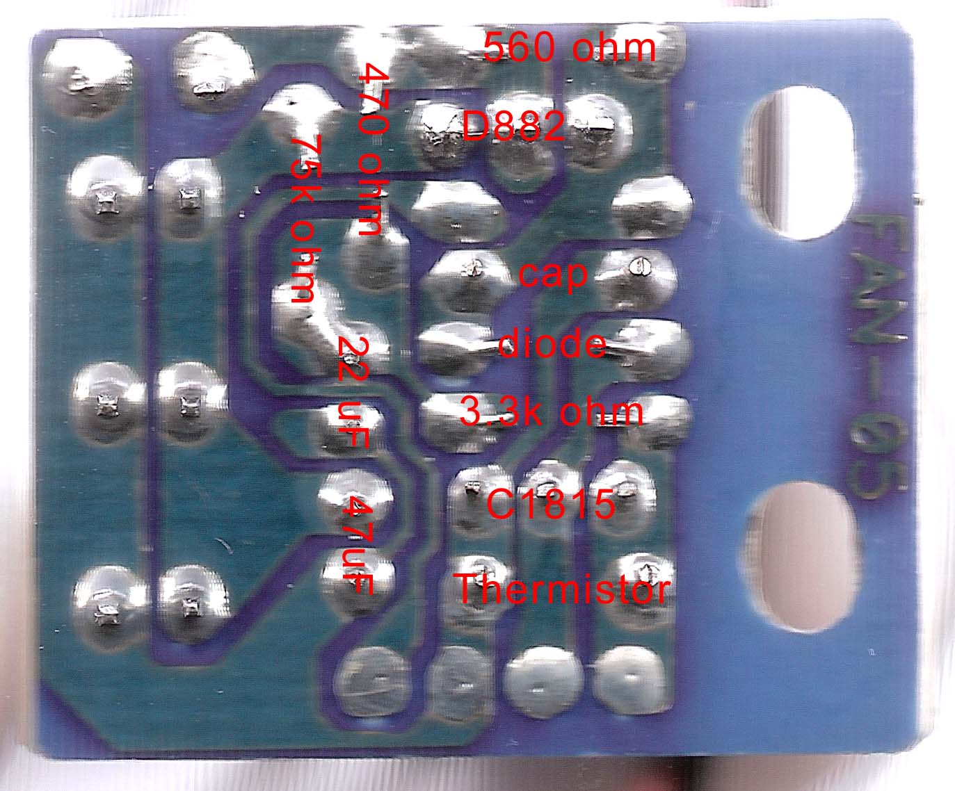

      can you take a picture of your board? both sides please
      i have a spare one i am looking at now, and I see a resistor connected to a thermistor, try changing that one to one with lower value, it is marked as FR7 on my board.
      My thermistor is reading 2.7Kohms in +20C ambient temp.. it got as low as 0.6-0.7Kohm as I heated it with a lighter if your does the same, you will know how resistance is related to temp and change components accordingly

        made a sort of diagram of the fan controller
        left you can see the 3 fan headers and on top is the input going through 470 and 560 and so on

            only the fan-mod resides, should be the 3.3k ohm i guess ?!
            • Behemot
              • 4845
              • CZ
              Re: Tagan TG480-u01
              You may try pot to find the right value
