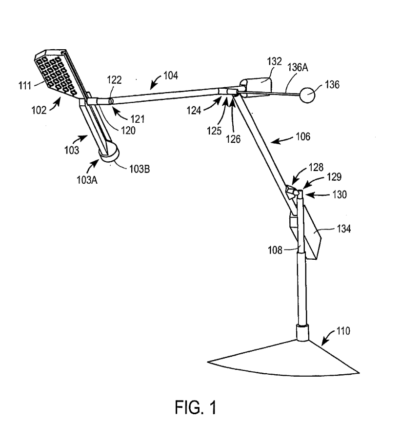

    I have a LED lamp by Richard Sapper which, was the last product Lucesco made and it probably took them out in 2006/7, with the crash of course.
    Anyway the patent concerning the lamp allows for 360 movement between joints and a counter-weight. So you have 3.5mm audio jack connectors between joints. Finally, at the base a weird Power controller which is connected to a external 20v 1a power brick.

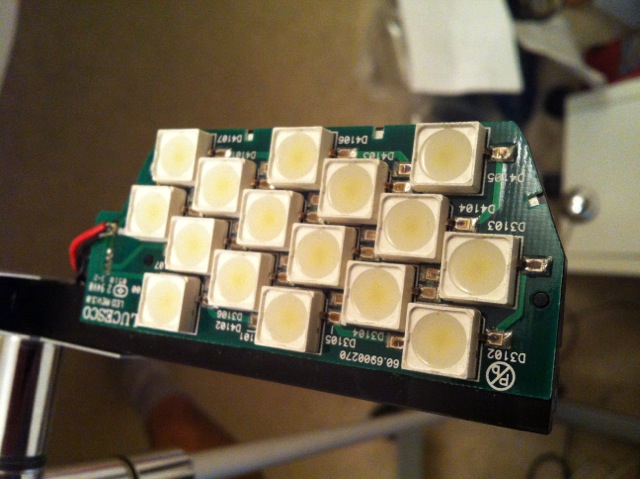

    heres some shots of the board

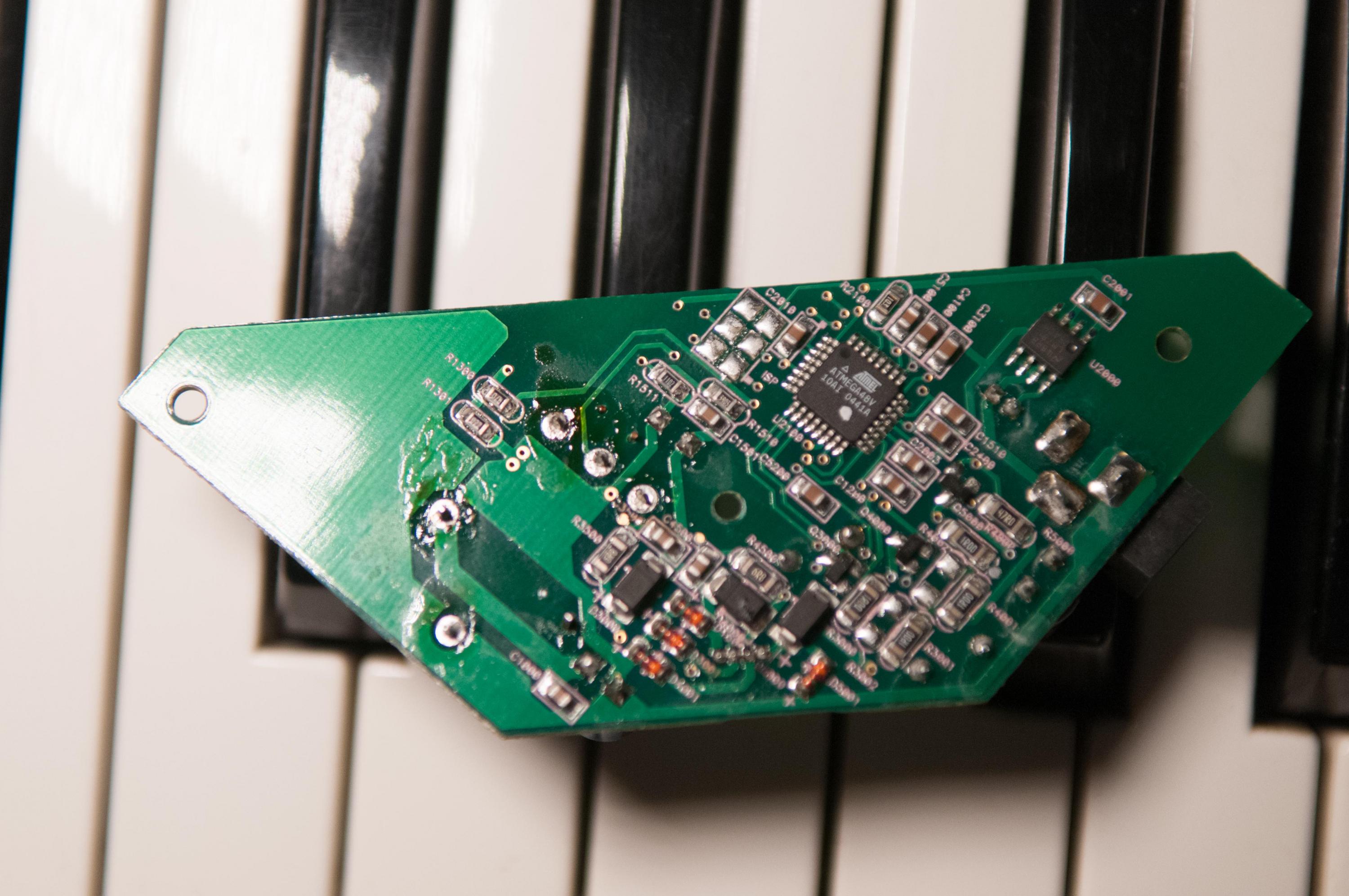

      Re: Lucesco Halley (Richard Sapper) Lamp PSU
      Underside has three more schottkys : 10BQ100
      a 3 terminal positive regulator and then a ATMega48V 8 bit Microcontroller
      The Powerbrick is fine and puts out 24.1v and the correct current.

        Looks to me like one of the diodes on the bottom of the board has gone pop, I see it has this slight bulge/crack in it. Can't make out the part number, but it is the middle of the three black ones. Check to see if it is shorted or open circuit.

          hi thanks for responding.
          I was beginning to think that it could be a faulty SMD LED but willing to check out the board some more as i the schottkys did bring it back to life 50Pc.
          Which diode are you referring to? The small zeners on the underside DSC_9381.jpg or the larger black Zener on the topside

            if your referring to the group of 3 shottky's 1A 100v SMB's (on the underside) i've changed them over already and its made no change. I think the crack was just cosmetic
            I think given there is power to one row of LEDS the problem must be one defective LED in the other row the problem I now have is sourcing those 2pin SMD Leds or a substitute.

              Yeah, I guess the current surge popped the leds.
              Could you get us some up close pictures of them? How wide and how long are they?
              When replacing them, you might as well replace all of them because the new ones are likely to have a different color temperature (I.e. "cooler" as in bluish-white, or "warmer" as in yellow-white)

                hi the problem is finding two pin SMD leds with the this pin configuration. You will see that the legs on the pins on either side are not symmetrical, they are stair-stepped.
                you are right i may as replace the lot as there is already a dull one on the working array. I don't think a surge blew-it more likely a short because of the way the joints come together. Its a design defect or compromise.
                If you have any ideas of SMD LEDS that could work do let me know. there are about 2.9v forwards voltage
                  What are the dimensions of them? (In millimeters please!)

                      its 9mm x9mm with a slight notch on one side to indicate which way it should go in.

                        one way to tell if the powerboard is at fault is to see if the green light on the DC powerbrick goes off when you plug it in. It should stay on at all times.
                        I think when the light shorts it kills off some of the Schottkys on the powerboard and at that point the DC powerbrick must have a failsafe to stop voltage going backwards and so shuts itself down. It is a product design fault in my opinion.

                              thats likely a series paralell arrangement.since you say part of it works i would test each led with a dvm in diode test mode.a good led will glow.
                              iirc those are a nichia part.they may have a similar footprint to the luxeon/k2 from from phillips lumileds.

                                    those are anode connected to heatsink pad on led.
                                    the next issue is thermal management.how are they cooled?
                                    the originals may not have been cooled well.looks like some browning around the die in your pic.is there a real heatsink?
