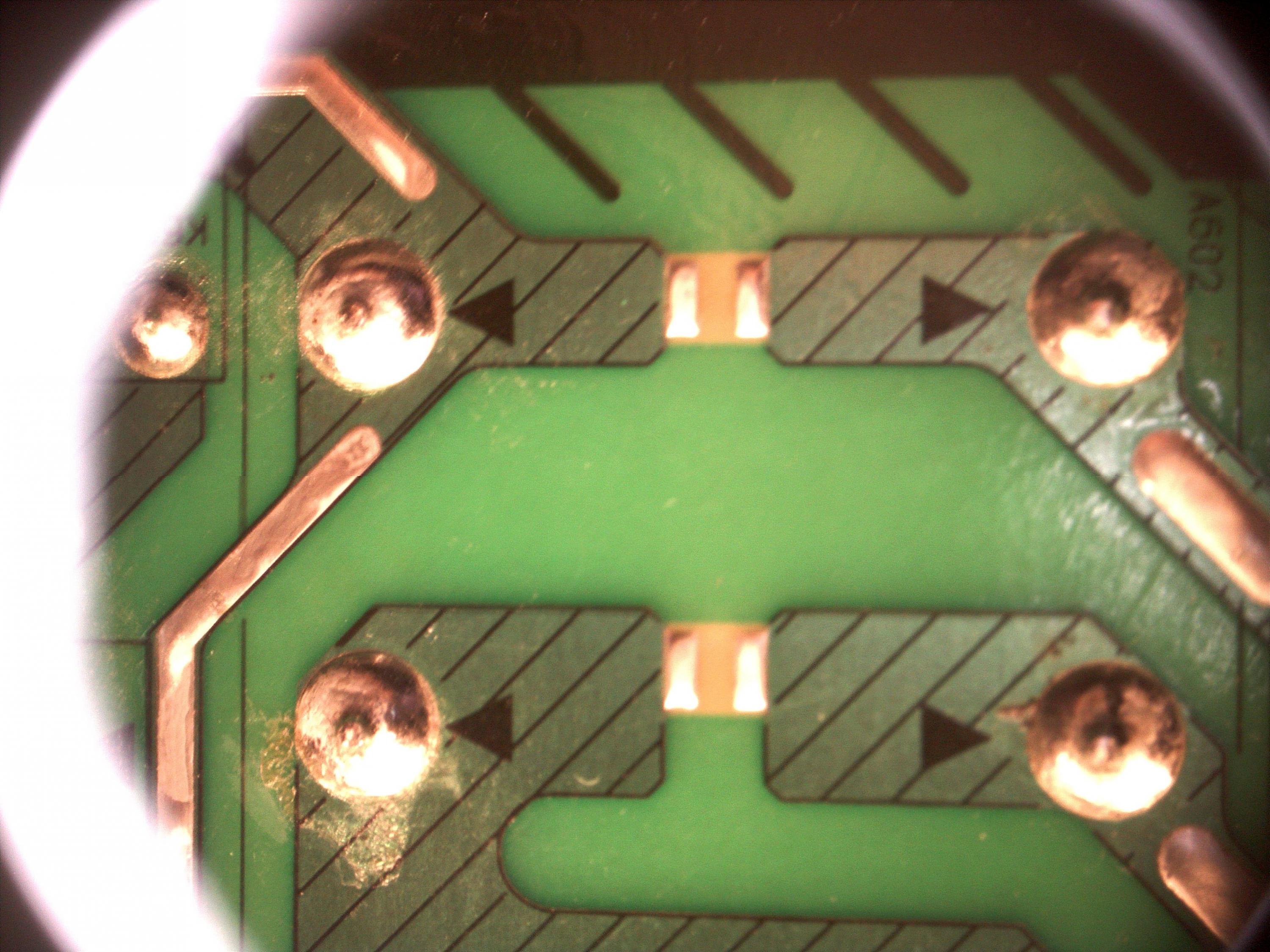

Can could someone tell me what these arrows/black triangles mean when they point to a contact. They are on the foil side of a PCb powerboard. I have included a photo with a few on.
I have here a Magnum IA.100 which belongs to my parents.
The unit powers on & when the relay kicks in, you get a pop from the speakers (this might sound weird but is usual behavior for this amp). However, you get nothing coming through it from any of the inputs & no pops and crackls from any of the controls.
Because of the sound from the speaker when the amp turns on I have assumed that the output section probably works but I could be wrong & I'm not sure how to test that side of things further.
