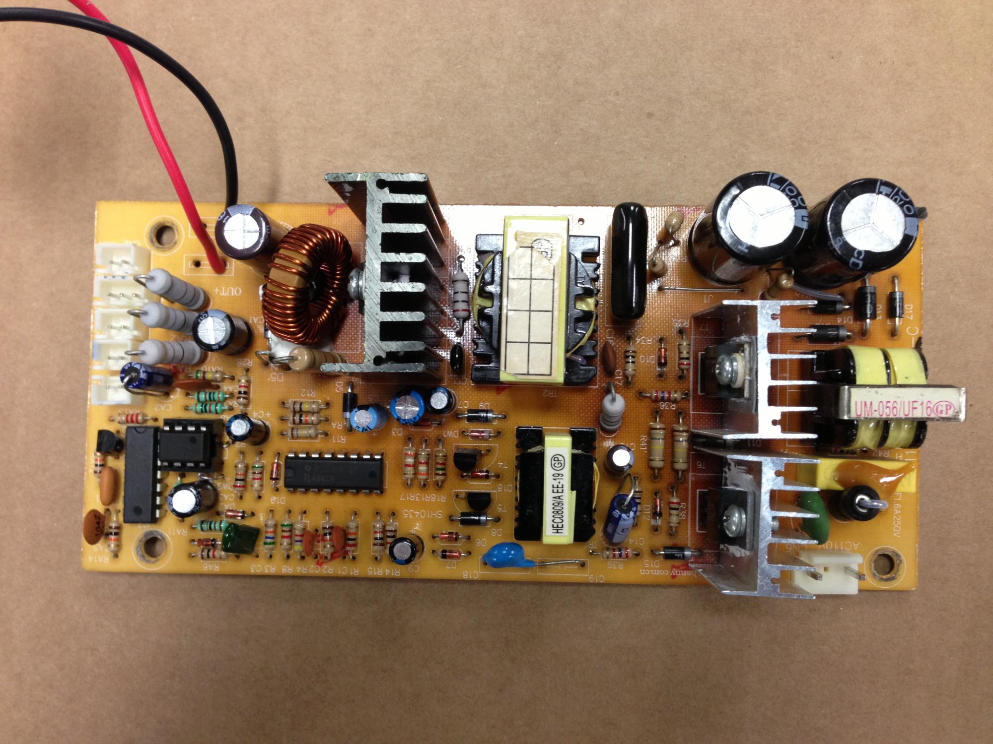

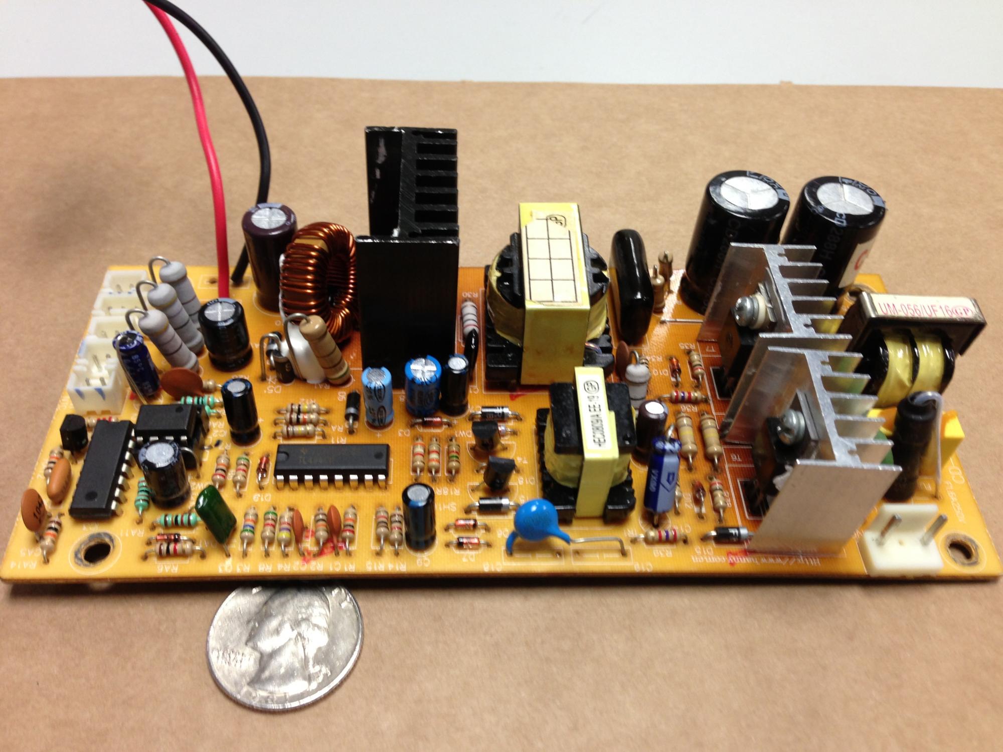

I have a Haier thermoelectric cooler that will not cool. The fans may twitch or come on at a lower speed, but the peltier cooling module will cool.
I read this thread, but I still haven't been able to find the cause of the problem.
The power output seems to vary greatly for no apparent reason. I'm getting everywhere from 2-17VDC from the output terminals. When I start to draw current with a load, regardless of whether it's a fan or the peltier module, the voltage drops drastically. When this happens, I hear what sounds like dripping water (or arcing) coming from the area with the two largest capacitors.
I went over everything several times with a lighted magnifier, but don't see any signs of burnt or damaged components.
Is there something I may have overlooked that may cause the output voltage to vary so much? It varies even after I remove the load.
I've replaced all the electrolytic capacitors. I also tried swapping out the 13005-2 rectifiers. I swapped out the LM358P Op Amp, too.

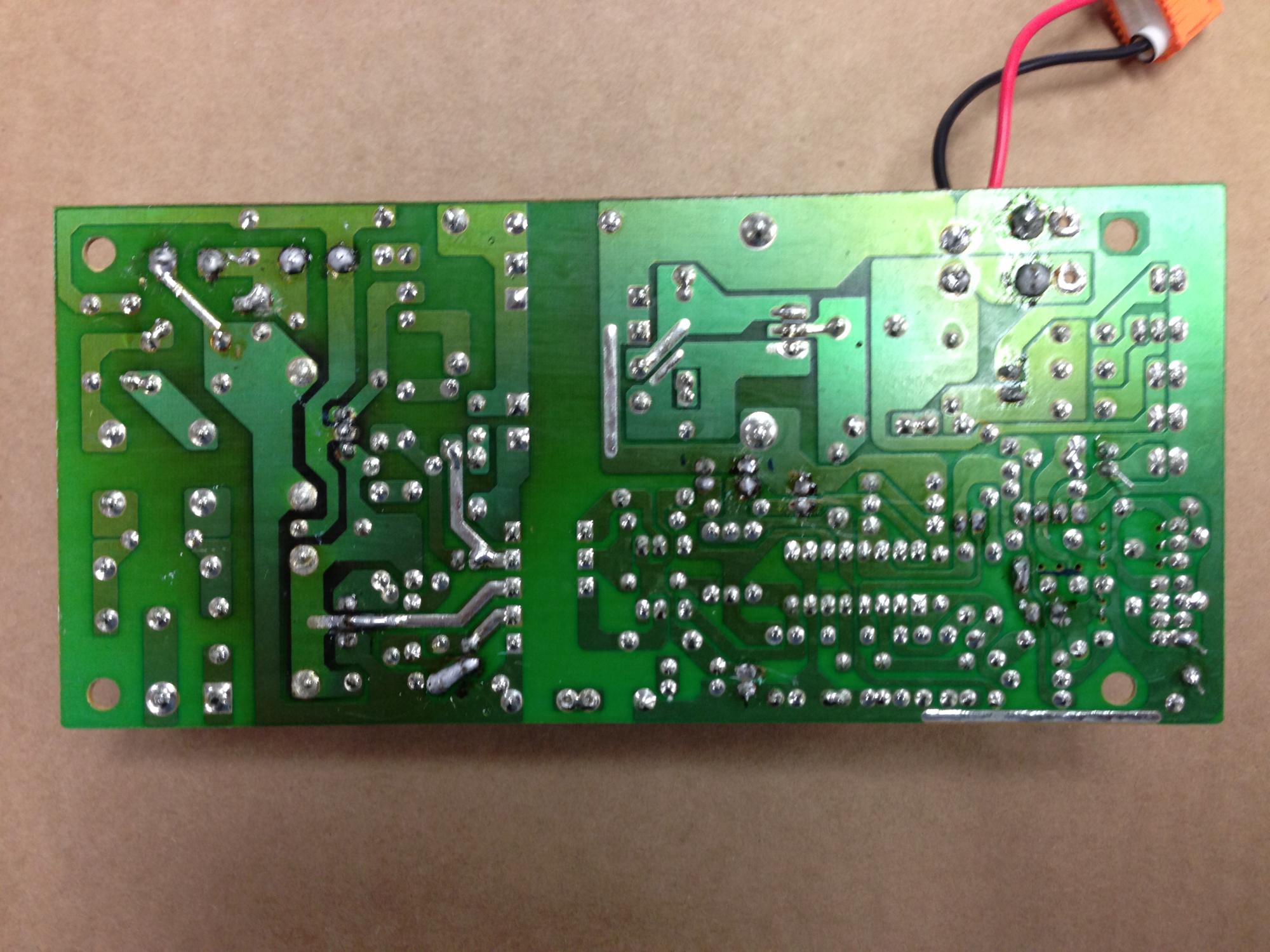

For some of this soldering, I was left with only a cheap 30w soldering iron from Radio Shack. Please excuse some of the butchering that may be apparent in the solder-side pictures.
