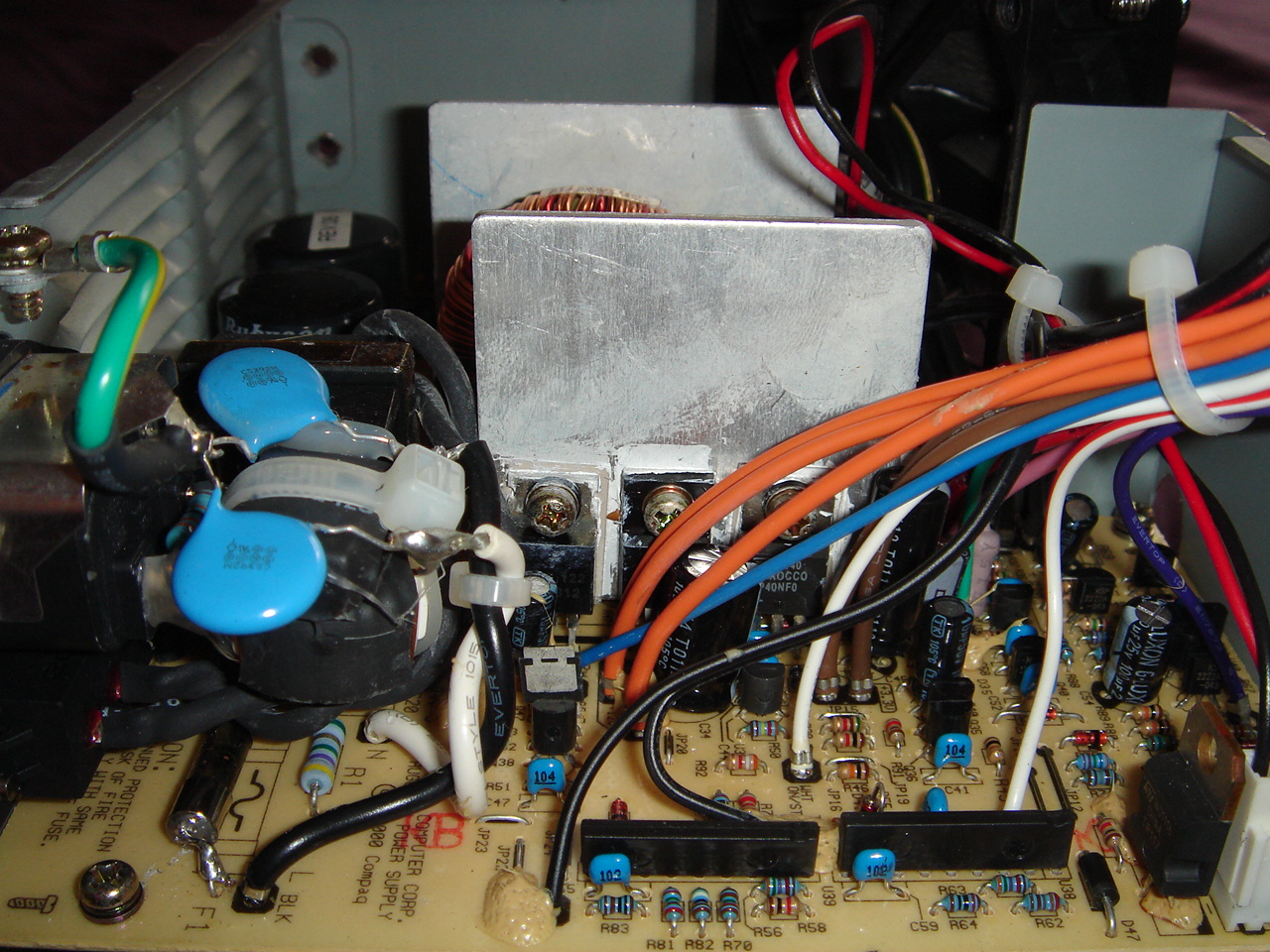

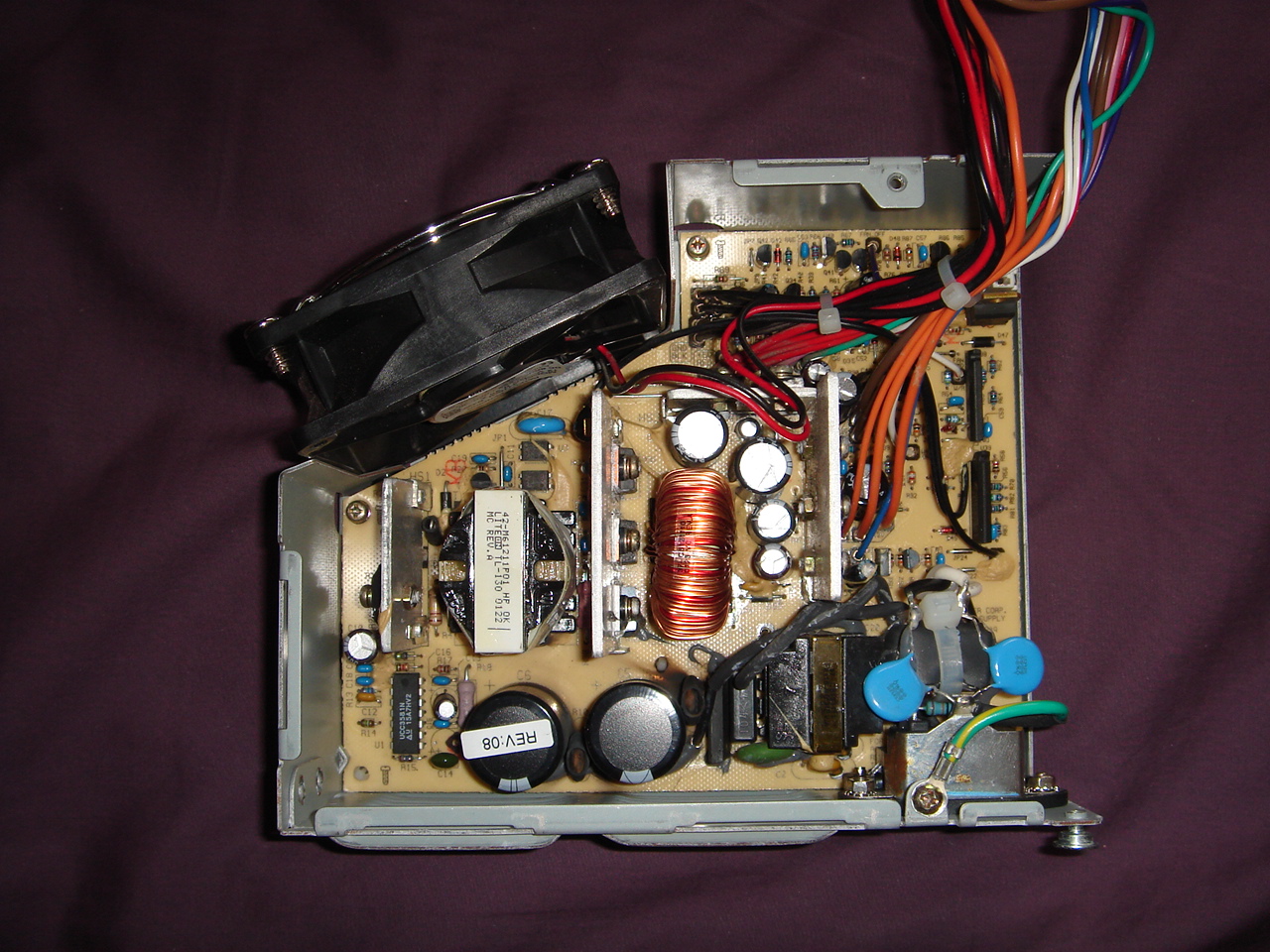

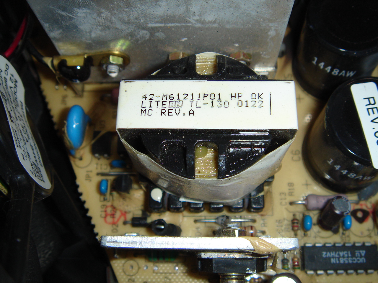

            Here are the internal pictures of the "dead" Compaq Power supply.... could someone please tell me what components to look for which are probably dead?
            All i can guess thats dead is that "Lite ON" transformer unit since that area stinks like burnt plastic.... you can see that fuse turned black in one of the images....

            • kc8adu
              • Nov 2003
              • 8832
              • U.S.A!
              Re: Compaq Deskpro EN PSU
              the mov's near the input caps are burnt.
              see the splatter on the board and heatsink?

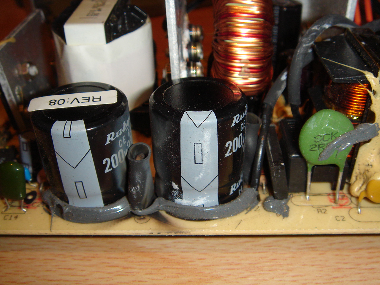

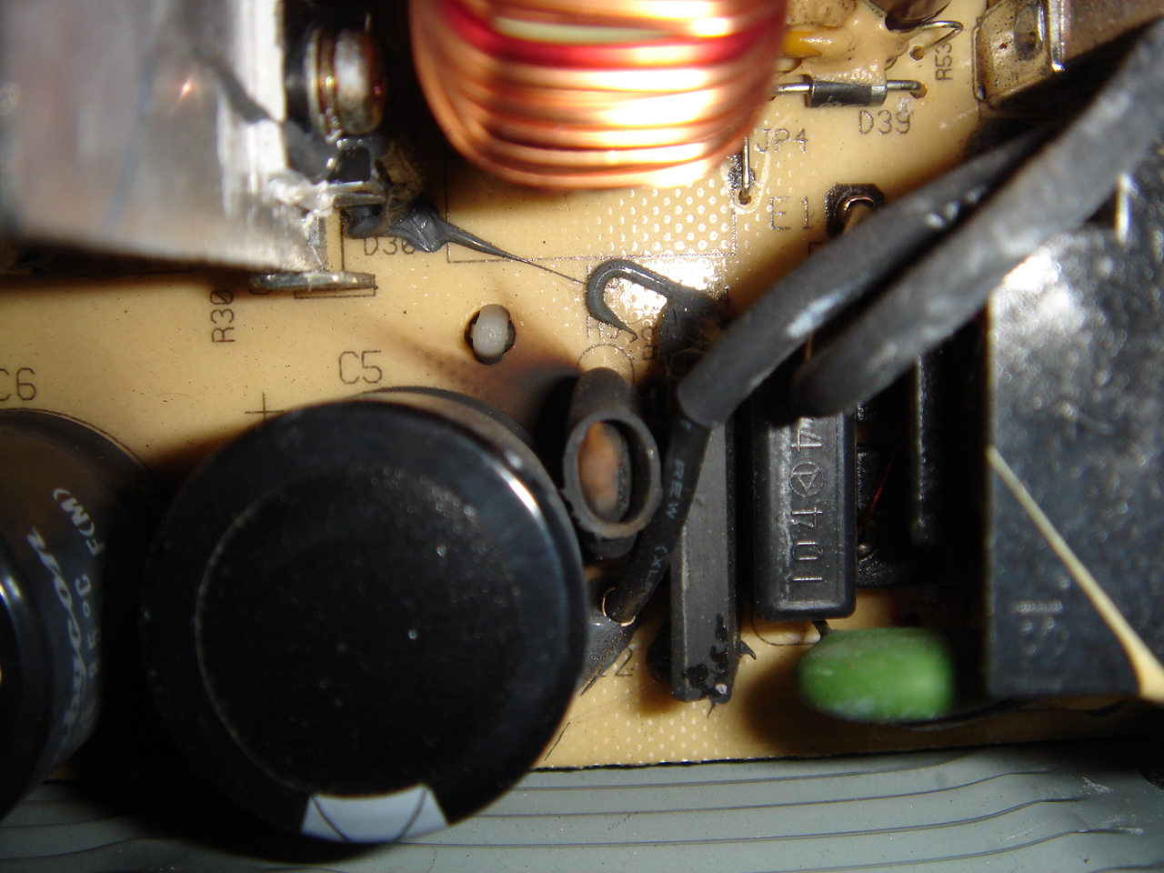

                  Lookie what we have here....
                  Well.... now i have been game enough to open the power supply up completely, and i actually found 2 components which were charred completely black and also cracked! , it looks to be like a ceramic capacitor or similar.... sorry im quite new to the world of electronics.
                  could it be a MOV like kc8du said?
                  well i want to know what this component is and what its value is so i can go and buy one, unfortunately it's wrapped in some rubber sleeve.
                  I looked at the heatsink into those mosfets and the white stuff is just heatsink paste. Theres some factory glue residues which are grey stuck onto the circuit board.
                  In the pictures, it's that component in between the Rubycon caps.... the Rubycons look fine except for a bit of smoke on the sides of them from which "this component" spattered on. Theres also a little bit of black smoke residue on the circuit board.

                        Yep, you've got two fried MOVs, and they may have failed short circuit (or low resistance). If the P/S was set for 115VAC and turned on into 240VAC, that could result, and the damage is permanent even if the P/S is reset to 230VAC. If that mistake didn't happen, there is another mechanism that could cause a failure. MOVs are used to clamp power line surges and spikes. And they are fast and handle quite a bit of energy. Unfortunately, every time they clamp a surge, they suffer a little bit of damage. With a lot of surges and spikes, MOVs gradually deteriorate until they conduct even with normal line voltages and fry themselves. Of course, it is possible that a really big surge with lots of energy might have exceeded the MOV's energy capability, frying it with one surge.
                        If you are techie and have test equipment, you can remove the fried MOVs (desolder or clip out) and check for other damage. If not, I suggest getting a new P/S.

                          It's probably fixable - you'll need a couple a 9D431K or similar MOVs, and maybe a new primary bridge rectifier. If the fuse still keeps blowing after replacing these, the primary switching transistors are also gone.

                                    Your MOV is burnt, ought to be replaced, but may not be dead yet, it's failing would not blow the fuse (typically) and it is not the primary failure point. So yes, you ought to replace it but it's not the main problem.
                                    I think your switching transistor is blown. I doubt the bridge rectifier is (but if you needed to later, you could still check it on your DMM).
                                    On this picture,
                                    https://www.badcaps.net/forum/attach...achmentid=4287
                                    pull off (desolder first of course)) the part screwed to the leftmost heatsink, get it's datasheet from the markings on it,

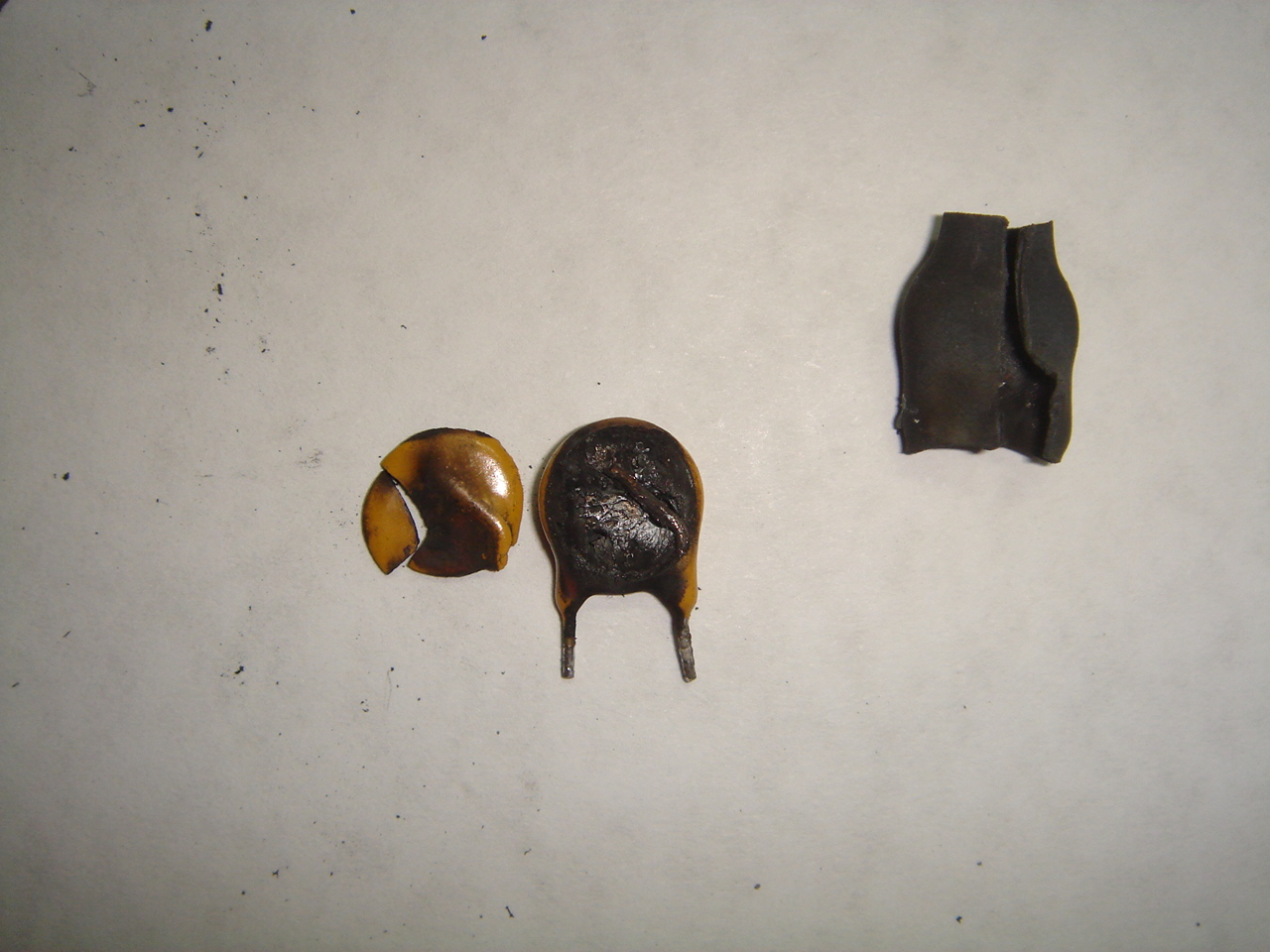

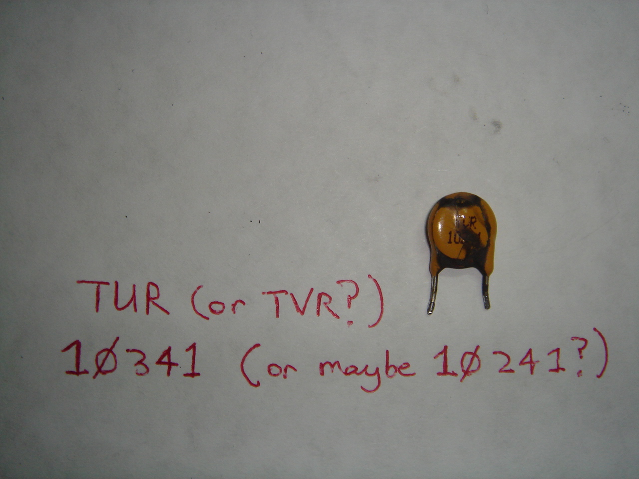

                                        I unsoldered the MOVs the other day and cut the sleeves open. I also unsoldered the bridge rectifier.
                                        I tried to dertermine what the markings are on the MOVs and the only problem is that it's covered in black soot so I am only guessing what it says.
                                        This is what I can see on the MOV.
                                        TVR?
                                        10241?
                                        There are two MOVs but the second one is burnt beyond recognition so I give up on that one.

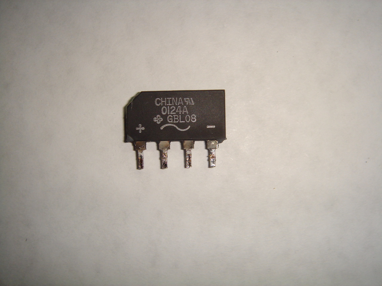

                                        The bridge rectifier also looks a little burnt on one of it's legs (far left on positive pole).
                                        I only have one multimeter so I think I'll have to replace it anyway to be sure.
                                        The text on the rectifier is:
                                        CHINA
                                        0124A
                                        GBL08
                                        Are the markings that I think are on the MOVs correct for a 240V circuit?
