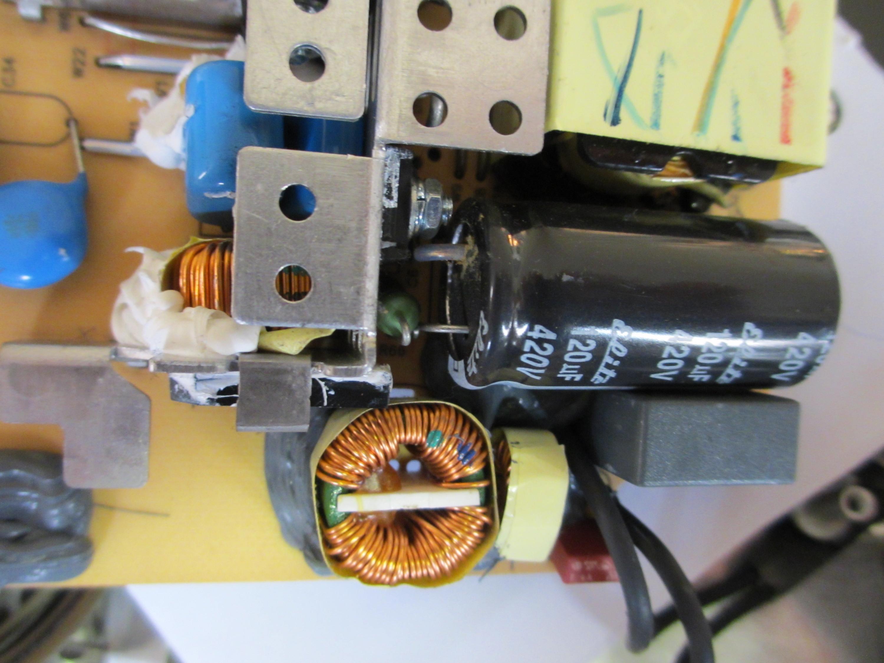

    Mac won't power up, nothing, as some of you will know its not easy to strip down, anyway,got to the psu,no obvious signs of bulging although the 120uF 450v had some goo on one leg, I'm not sure of the value of the other 3 caps.

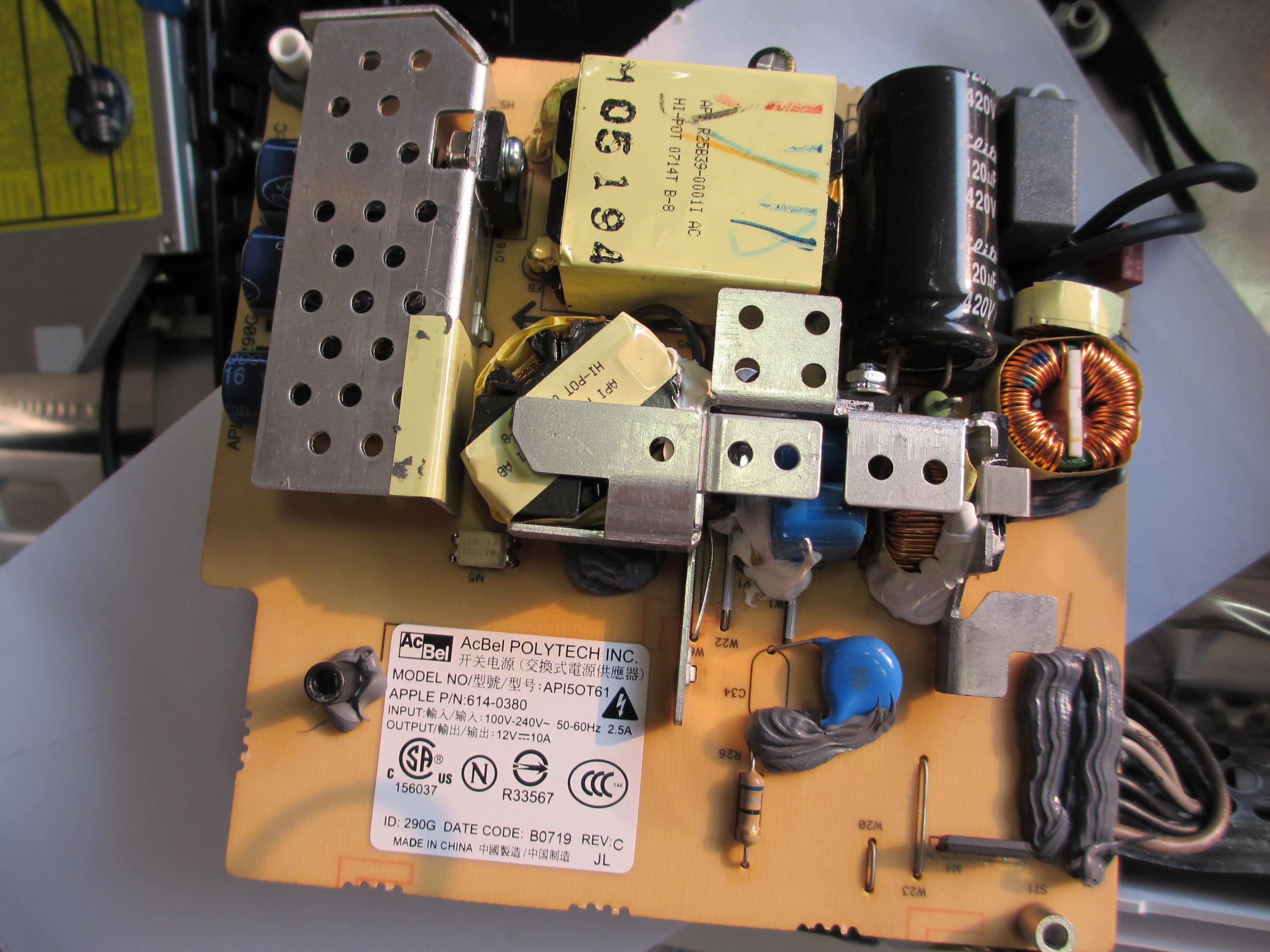

        Apple can be confusing, its not the desktop but the flat panel all in one mac, the output side has a 5 pin plug,
        AcBel AP150T61 psu 614-0380

          BTW - show a pic of the "goo" on the mains cap. Also, aren't there 5 caps plus the mains one?

            The goo was on the leg that was insulated as it went into the cap, I did think it resembled flux but there's no reason for it to be there, no obvious signs of swelling, prob better to check for 12v but not sure how to check on this one.

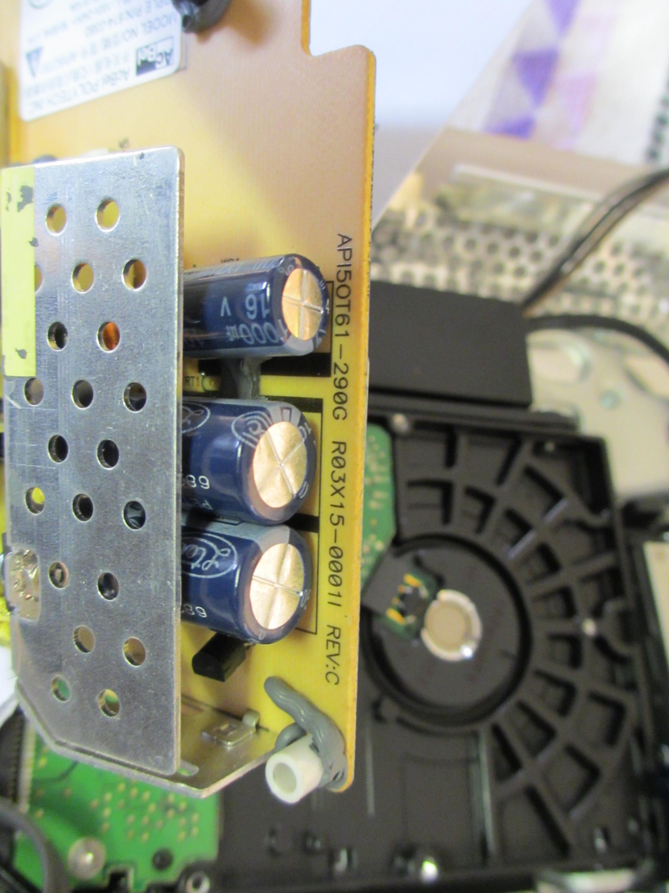

                There are only 3 caps 1 is 1000uF 16v, I can't read the other 2 ( they appear ok), 1 small cap at the side 68uF 25v, and the mains cap 420v 120uF.

                  I'd say the mains cap is bad. It appears to be electrolyte leakage at that leg.
                  Check voltage input at bridge rectifier - AC
                  Check voltage output at bridge rectifier - DC
                  Check voltage across mains cap - DC
                  Report findings please.
                  Check fuse(s) - brown square device at mains input area.

                      My next step would be to replace the small cap. The mains cap "leakage" has me concerned, but without the ability to test it, leave it for now. The fuse intact and no obvious burned components would also lead me to believe the boost section is okay.

                              Something close? Higher voltage is okay @ 47/56/82/100 uF.
                              Two lower voltage in series (capacitance divides) - e.g., (2) 100uF @ 16v in series = 50uF@32v.

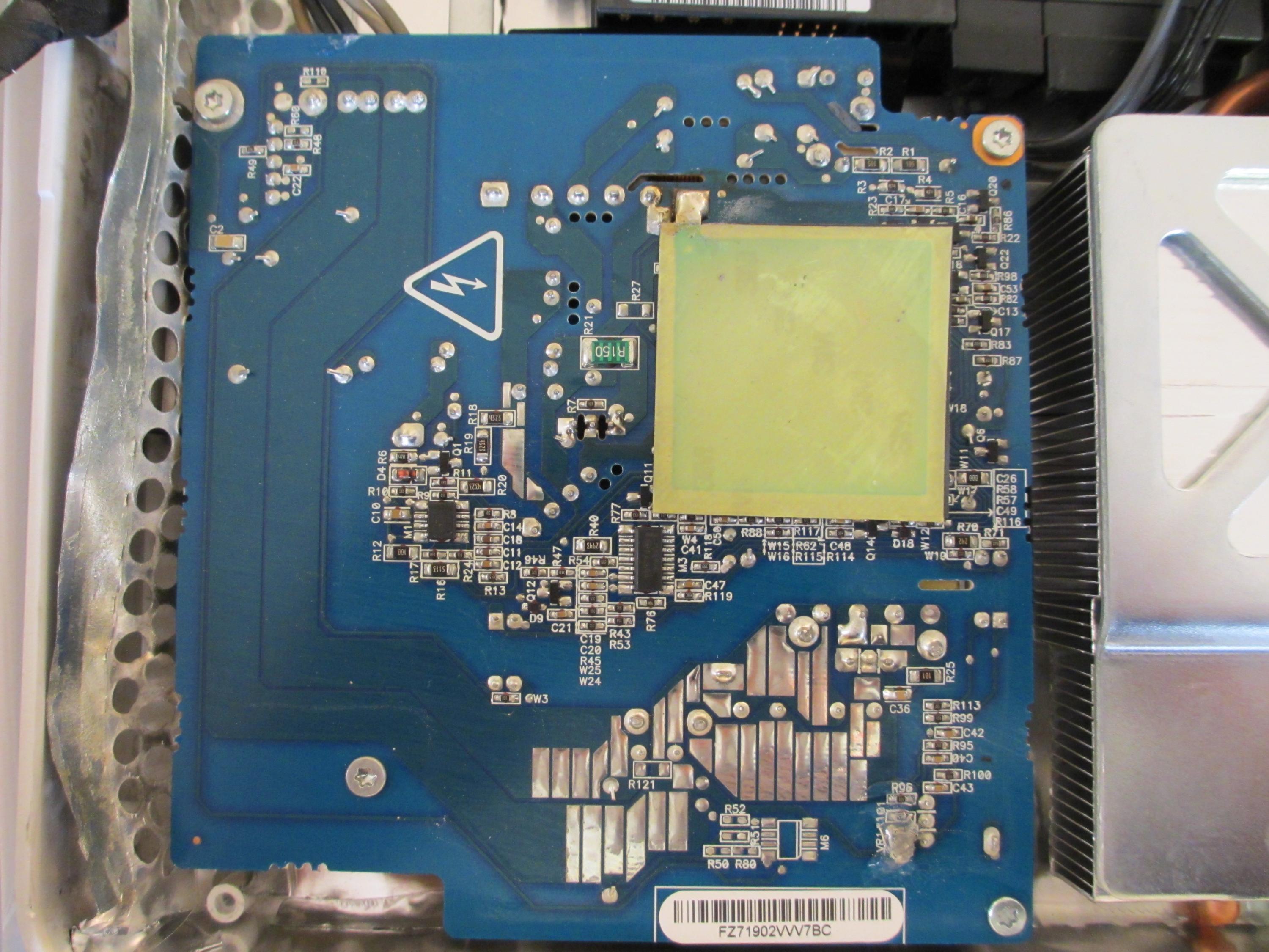

                                        Try removing that shield from the foil side as it hides 50% of the components. Another pic like #14 above with good lighting & no glare, please. Nice and sharp.
                                        Start looking for torched resistors or transistors.
                                        What are the 2 components mounted to the heatsink next to (1) the mains cap, and (2) on the other side under the lip next to the 2 blue caps? Report markings please.
                                        Inspect and verify the value of the large (2 watt?) green resistor next to the mains cap.
