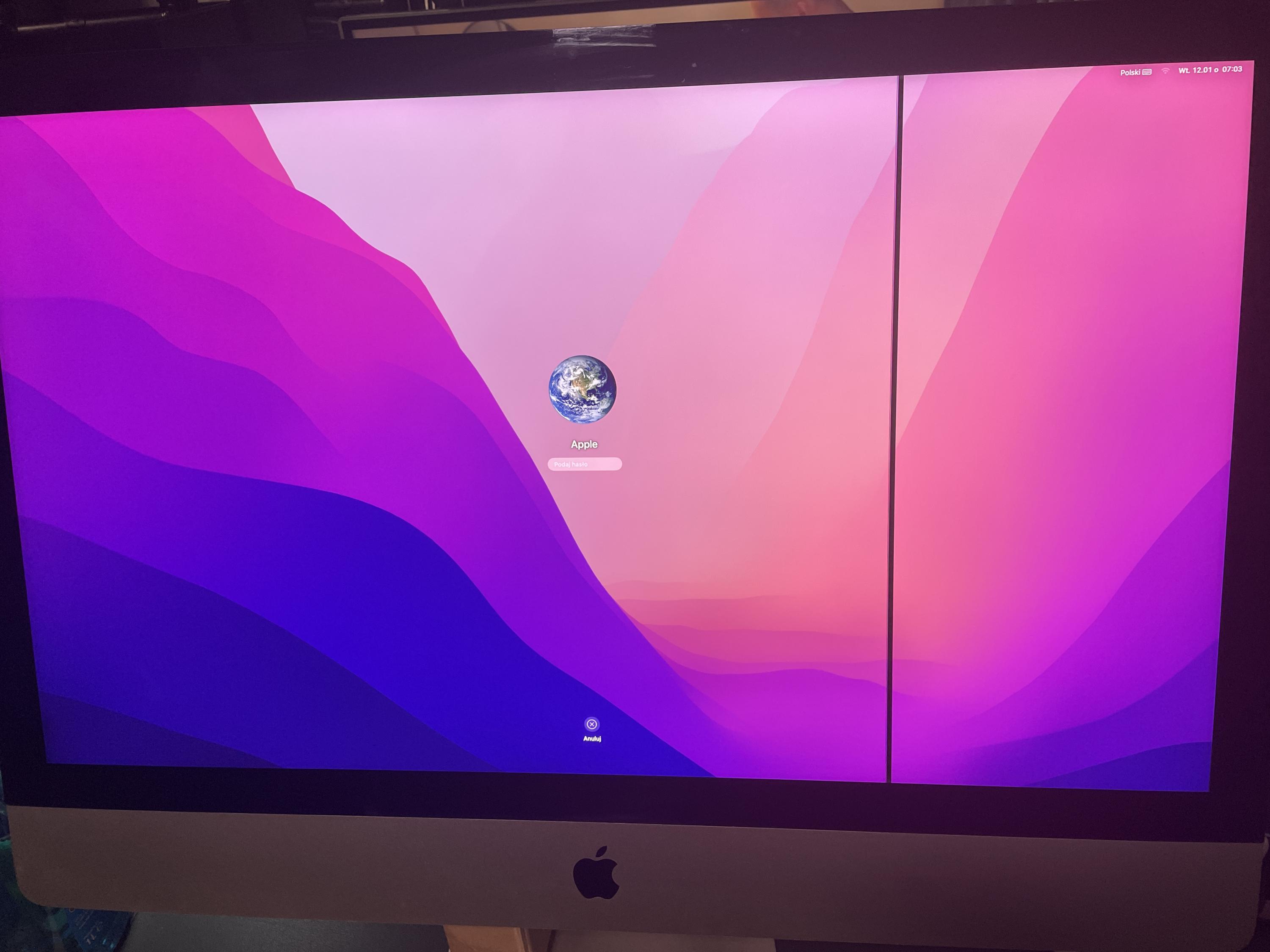

    Sorry for double posting but I managed to "fix" the display. Maybe someone will have the same issue and comes across this thread via google.
    My screen was completely dead - no backlight or image at all. I tried flashing directly at the screen with a flashlight and got nothing. The diagnostic LEDs only showed 2 green lights.
    I noticed F4400 fuse on the logic board was blown. It's 32V 2A fast acting fuse. Mine was welded to the board and I had to use a lot of force to remove it...
    This only recovered the backlight but I still couldn't see anything on the screen. The iMac was displaying image via thunderbolt port and I got 4 diagnostic LEDs after replacing the fuse.
    It indicated there are issues with the panel itself. I decided to check the electronics in the panel next. I hooked up 12V to VIN on the board and the board was drawing 2A - something was definitely shorted. What's more - the main voltage regulator TPS65168 was getting extremely hot. I thought it's blown and actually replaced it but it didn't fix the issue and I also learned this IC is programmable and you can't use factory settings, it has to be programmed via I2C for correct voltages. After more checking I noticed a capacitor near BUF16821 on the left side of the board that was also getting hot. It's directly connected to VIN line so if there was a voltage spike it's understandable why it blew. After desoldering it my LCD started working. Unfortunately in my case I got thin black bar on the screen from heating up the area near TPS65168 And I was extremely careful to avoid that :/ I was very close to getting this screen fixed but broke it in the process.
    In case someone needs to program TPS65168 or check the voltages:
    OUT1 3.5V
    OUT2 1.9V
    OUT3 7V
    SWO 14V
    VGH 24V
    Find the datasheet on google and you'll get pin numbers.
    Working LCD panel when connected to the bench power supply should draw around 250mA.
