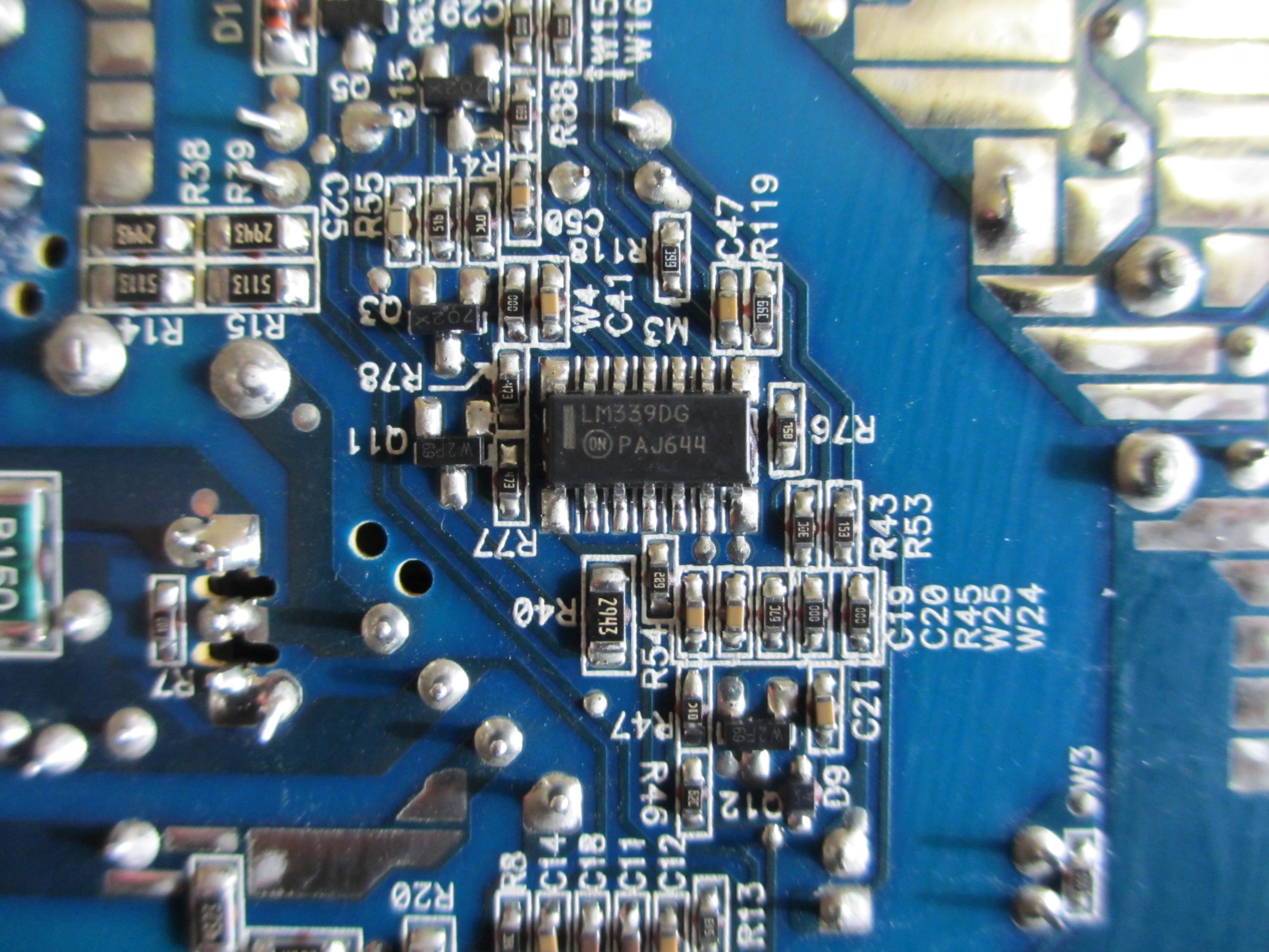

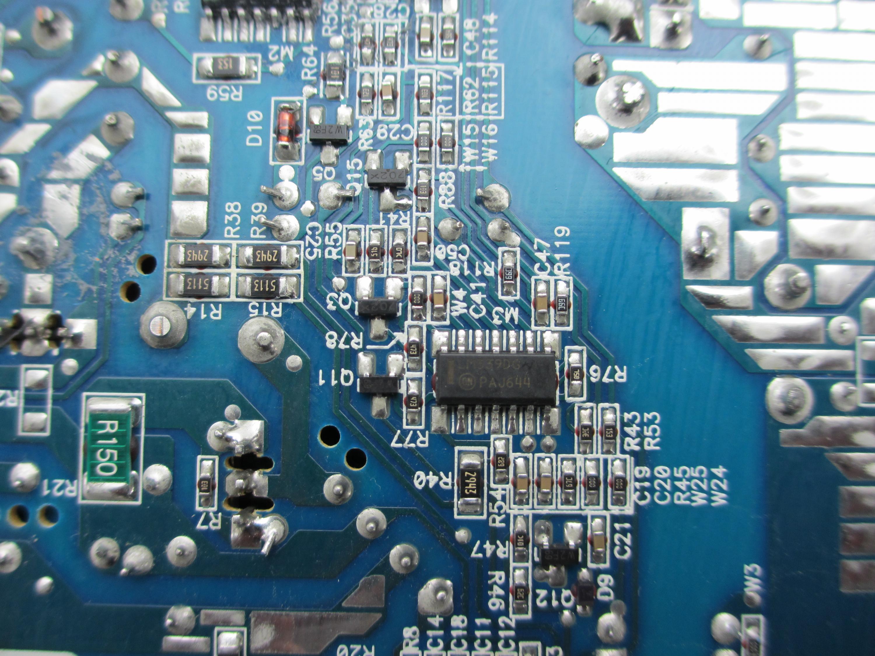

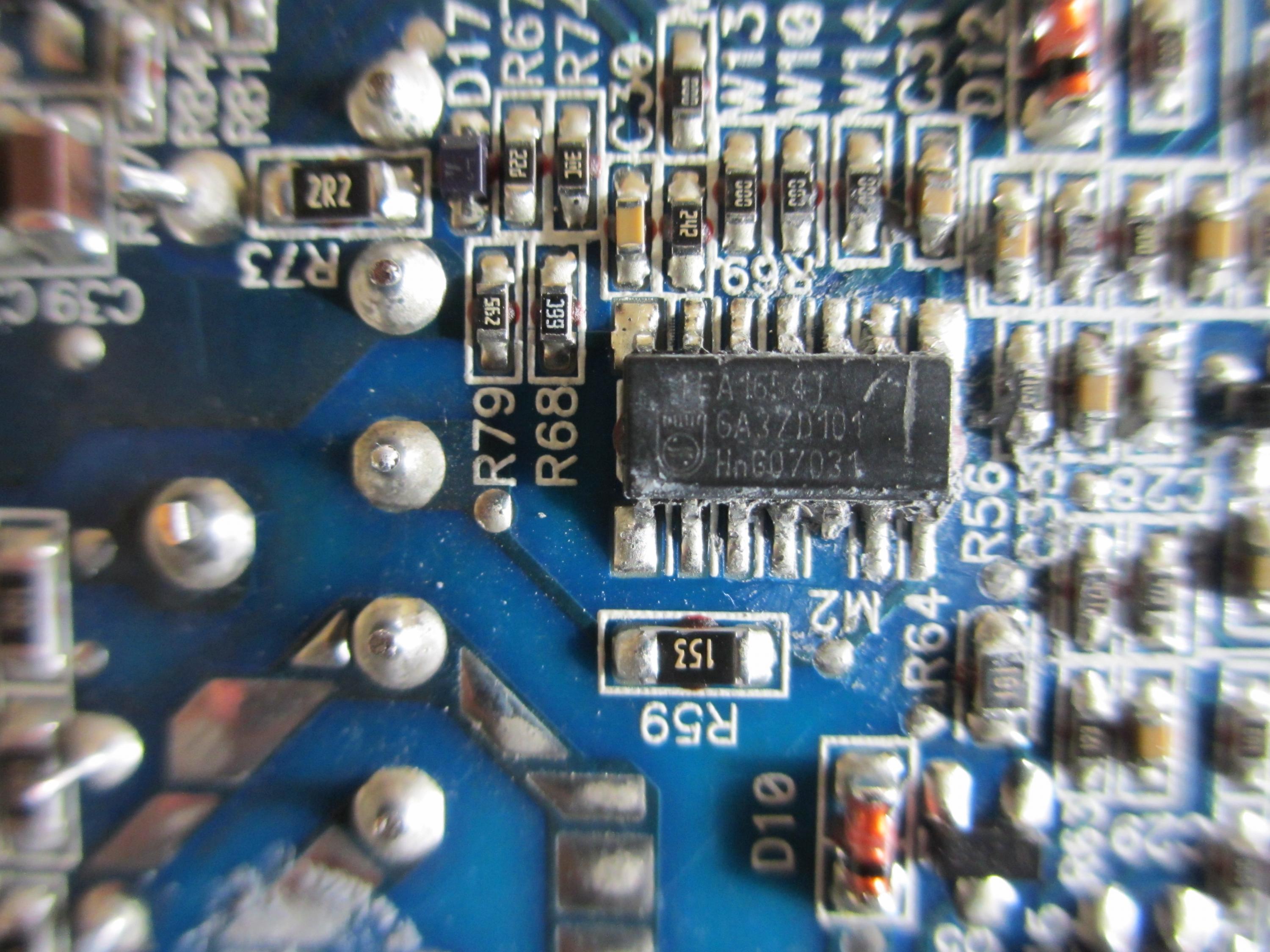

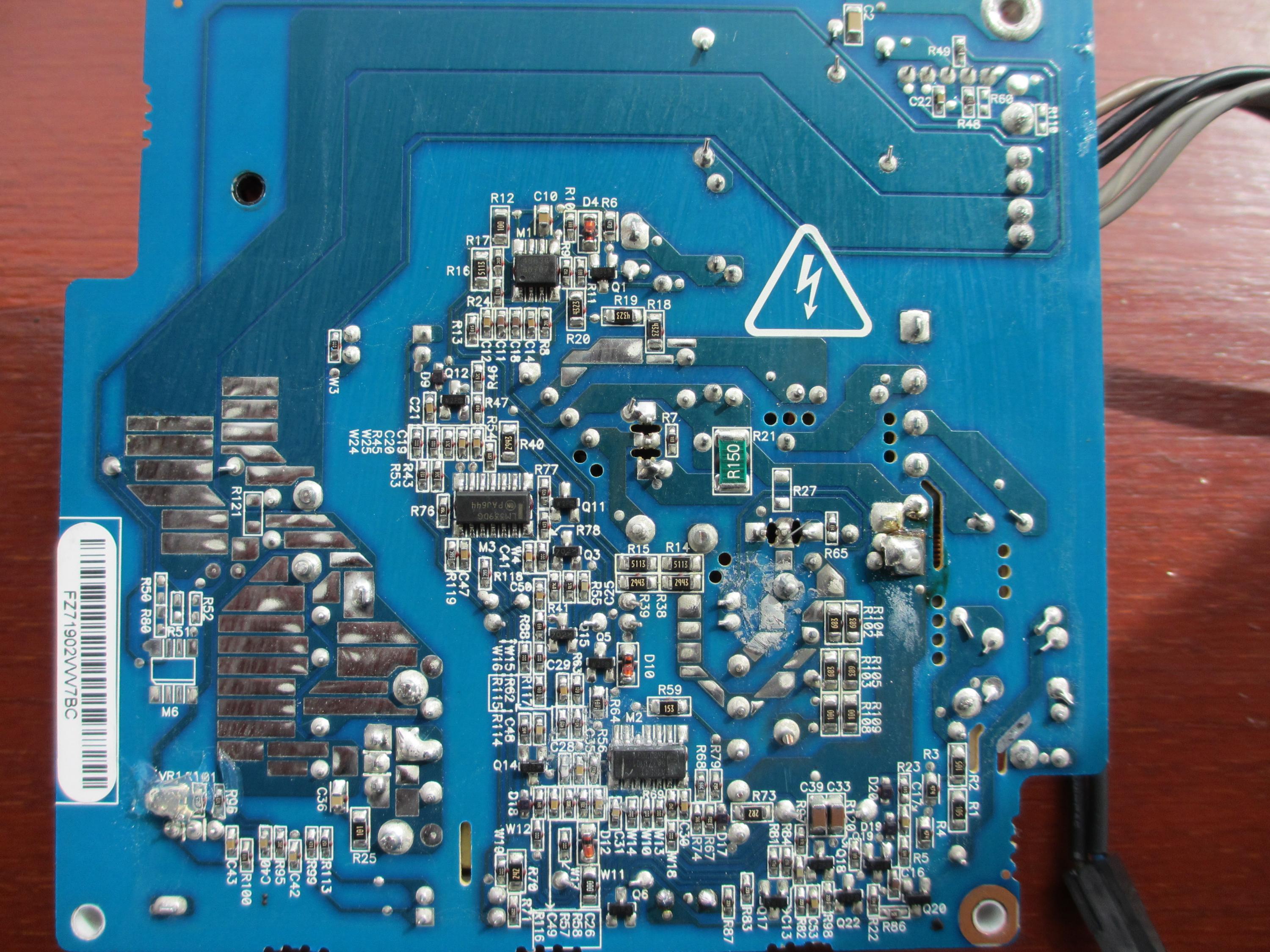

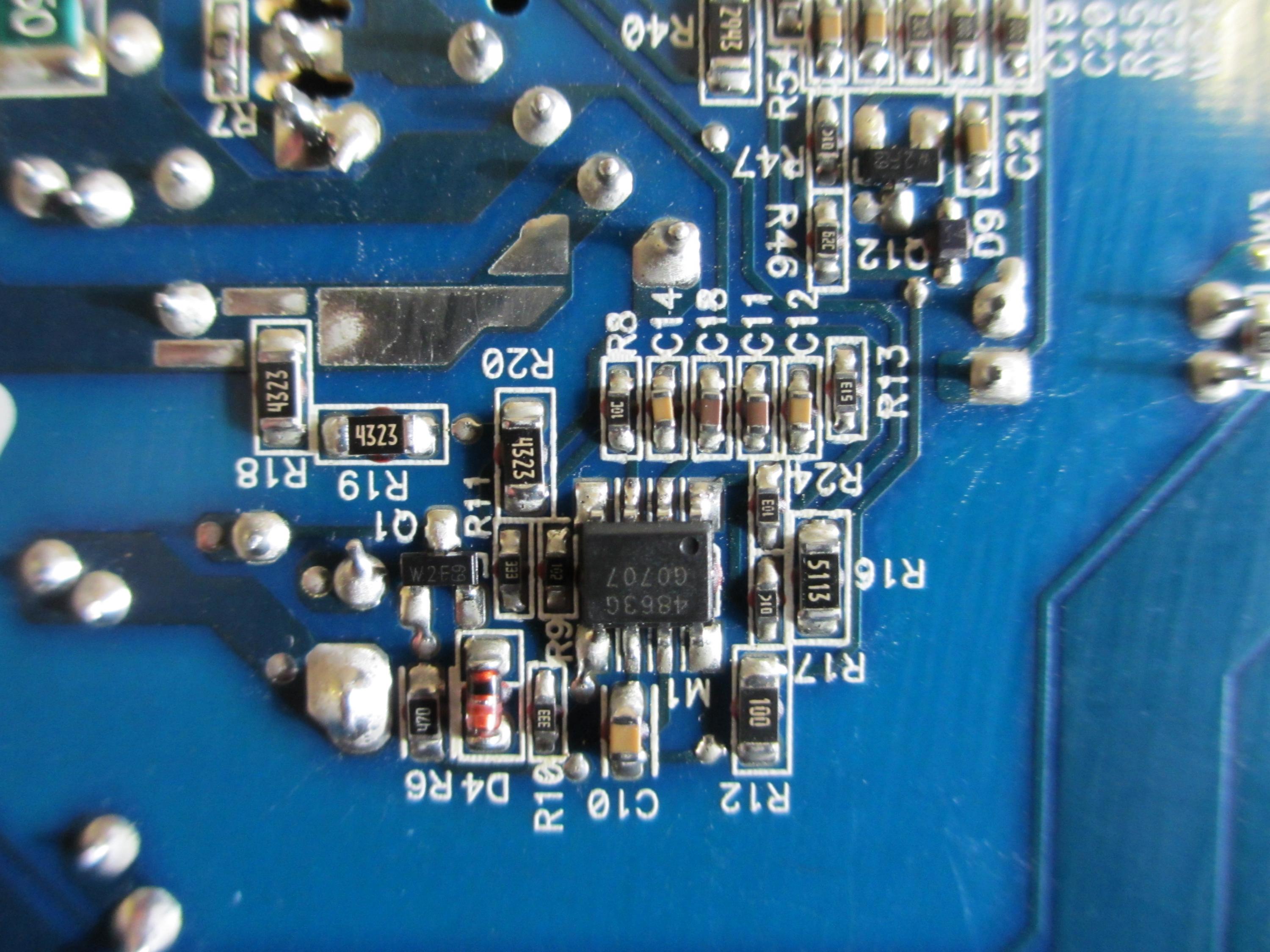

    I'll get a pic taken tomorrow, I've already had the cover off to measure the mains cap voltage and didn't notice any signs of blown components.

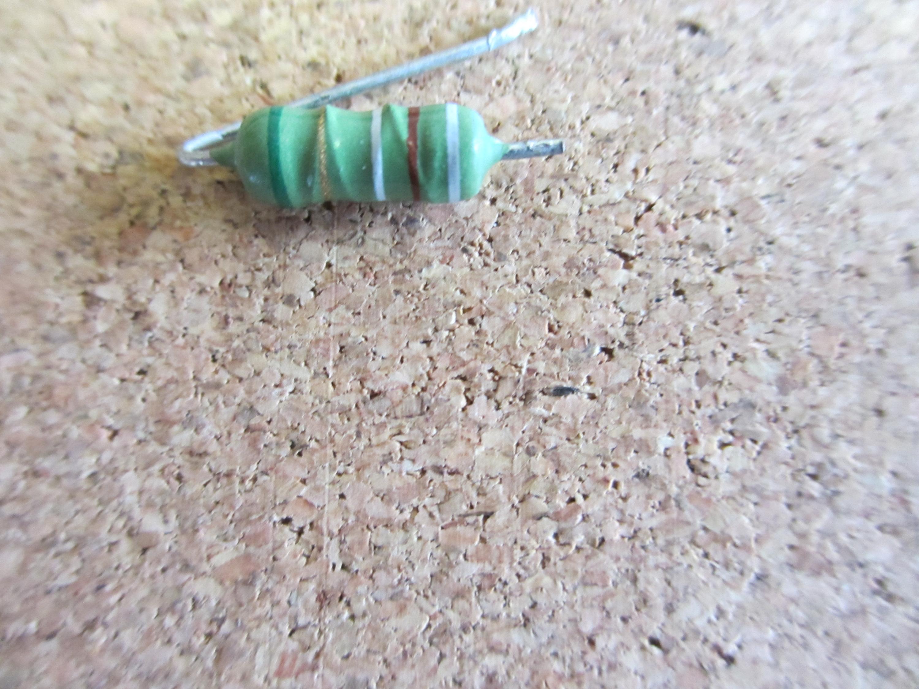

      Resistor not sure could be white brown white gold green or grey brown grey gold green, I've attaced a pic of it

        Pretty sure its white brown white, anyway the dmm shows it to be 0.3 ohms not 91.9 ohms

          Measured out of circuit...? I think you need a new DMM
          White-Brown-White-Gold-Green -is- 91.9Ω @ 0.5% --> REALLY tight tolerance
          Resistors go up in value when failed / burnt. This does not appear damaged in any way, especially being a wirewound.

                                    If you short the leads together, does the meter read zero or nearly zero? Try different scales to confirm.
                                    "tried to check the resistor with another dmm still no reading"
                                    ??? You said it was 0.3 ohms ??? (Post 23)
                                    If the resistor is in fact open, then doing the cap will have no effect. You will need to replace the resistor first.

                                      The resistor is a mystery, on my 2 meters, 0.3 ohm, on another autoranging dmm it didn't show any value? What's your thoughts on the resistor?

                                          On the resistor, I don't have a clue as to why except that perhaps the meters are way off or the batteries are low. I would get some resistor values together from low to high and test each meter and compare.
