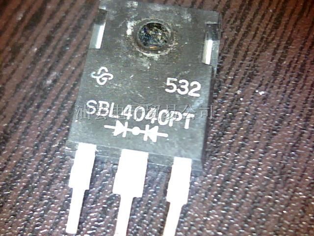

        yes in some case that was the problem. and to add my headache, is design of second diode brigde.
        i mean high speed diodes diode tha has three legde.. the code that show on their is too various..

          The center lead is the common cathode, each of the two outer leads is an anode.

                  but how did I read current ratings? I mean is there any meaning on sb**** or mbr******, is there any standard for their code example sbr2100
                  (just my guess)
                  sbr = shotkky barrier rectifier
                  2100 is 100 amps?? or maybe 10 amps??
                  which one says diode current ratings.
                  as for the transformer is there any standard for their code too
                  I mean some trafo code is ERL 33 PSG blah blah blah
                  (my guess again)
                  ERL is manufacturer code
                  33 is current ratings or maybe wattage 330 watt maybe?? or wattage limit?
                  as far as I know if I can access those datasheet.. maybe is possible to increase PSU wattage by huge margin... or make the PSU become pure.... I have lot of component to be wasted in my search for knowlegde...

                    There's no standard, but usually the name contains the maximum voltage and the current.
                    There's a picture a few posts above that says SBL4040 ... that's probably maximum 40v, 40 amps.
                    ERL is a type of transformer core type and a soft of "standard" of transformers suitable for switching power supplies.
                    Depending on the number after the ERL, the coils have various inductances and the higher the number the more wattage the transformer can usually handle (but it also depends on how the circuits around work)
                    A rough approximation, a real ERL-33 can do up to about 200-220 watts, a ERL-35 can do about 300-350w, ERL39 may do about 450w ...
                    But like you've already read, it really depends on the switchers and other things on the PCB - if one uses more high end ICs and transformer is a quality ERL-35 you might even do 500w with it.
                    Keep in mind a no-name Chinese manufacturer can lie on the label, i've had a 450w power supply that had a sticker saying ERL-35 on top but I desoldered the transformer and on the bottom the real sticker said ERL-33.
                    I kinda knew it wasn't ERL-35 because it was smaller in volume, when you see a lot of them you can usually tell from the volume how good it is.

                      that was very handful... thanks for your repply... must search more info about switching transistor...
