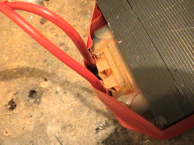

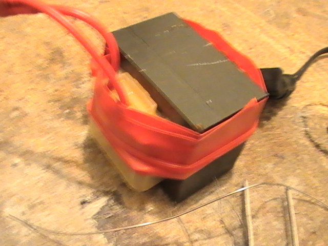

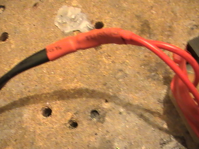

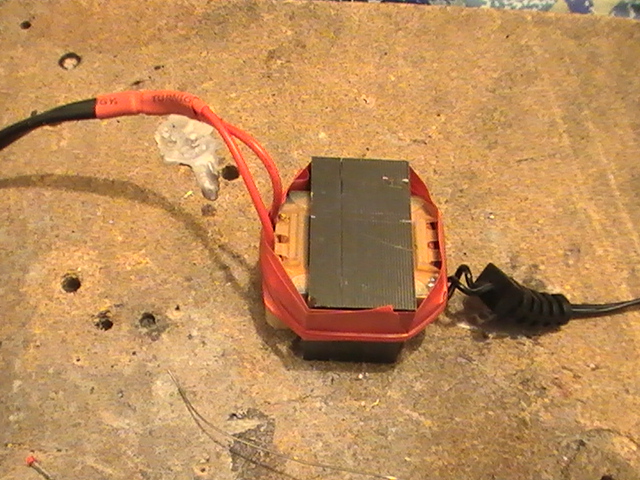

      Okay Guys So I went the easy way, I removed the thermal fuse, then re soldered 2 red wires to the enamel coated copper wires. then connected the 2 red wires to a larger wire to connect to the mains, heatshrinks everything uses some contact cement epoxy to attach the old transformer tape and then placed some electrical tape over it and a cable tie. done. connected it and there is power
      briefly connected my computer fan and it spins up and I did notice a short in there / spark but I think its okay?
      But I am not going to use with my decoder until I check it with a multimeter for the current its delivering. Any idea what I need to set the multimeter to check that? and what values I need to be sure it wont damage the decoder?
      Also you guys mention its a fire hazard now? I really dont see if this will melt the casing and catch on fire? any suggestions and feedback would be appreciated.
      The thermal fuse thing helped the most since I went the route to eliminate it completly. thank you mariushm, josh, budm and everyone that helped, great information,.
      oh forgot to add some pictures of the finished product..

        If for some reason, there's a short in the device your transformer is connected to, the short makes the transformer give more current than its rated for, therefore it will overheat.
        If this continues, the fuse is supposed to cut the primary side, so the circuit is interrupted.
        Without fuse, the transformer may continue to heat up until the insulation on the wires breaks down and now you may have a short on your mains side, which can get the mains cable super hot and burn the plastic insulation, burn the case of the adapter etc...

                I f ed up.
                I was putting it all together in the case and the enamel coated wire on one of them broke right off the beginning. needless to say there is no more enamel exposed wire left for me to solder on. unless you guys have any more ideas.

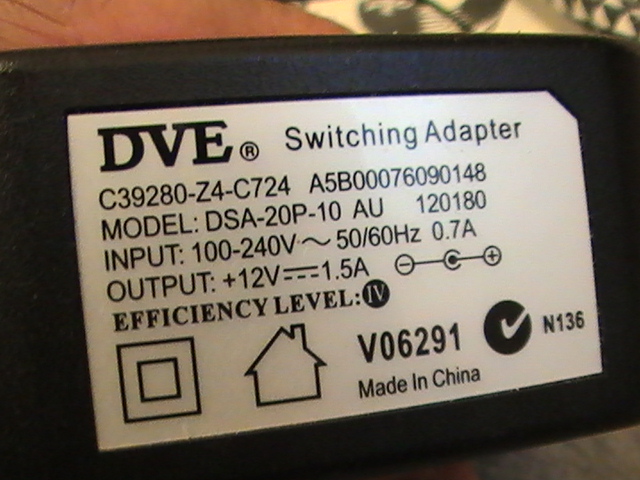

                              Oh guys, I emailed the friend, he said he knew the adapter was bad so he said there was a second adapter he used for it in the box.. this is the one.. I plugged it in and it did work. I dont know, he said it worked for him....should I use this?
                                  I'm suprised it works with low voltage, as for it running off dc i expected that due to the bridge rectifier, I would say it will be happy with it if it works normally.

                                    he said this is how he ran it for a few years? I dont know but should I use his +12 adapter or my 15V one. I mean if I had to chose between he two.. would you pick this one or the one I showed in the first picture? I would guess 15 is more close then 12 so..hey if these two would work, why not..

                                      I'm cheap I would use the 12v dc one.

                                        The laptop one plugs in too.. just saying
                                        stuck between the 15v dc and 12v dc now..heck saves me $50..
                                        anybody here know how to open a laptop power brick? then maybe I could rewire it nicely with the cord from the original adapter.

                                          Look man, this decoder would normally run even on 3.3v or 5v, the decoding stuff doesn't use more than 5v.
                                          But the decoder also has an audio amplifier for the headphones output and for the 5.1-7.1, whatever it has there as connectivity.
                                          The electronics that decodes the dolby signal and makes 5.1 or whatever the decoder does powers itself from an internal converter somewhere, which takes power the box receives and generates 3.3v or 5v or whatever low voltage is used. So that doesn't care about what you use at input.
                                          The audio amplifier used for headphones output and so on does however care how big the voltage is. Depending on what type of amplifier it is, the higher the voltage at input, the more watts the amplfier can produce and the louder the volume.
                                          So you can probably safely use even a 12v DC, but don't be surprised if you turn the volume up a bit and it sounds bad.
