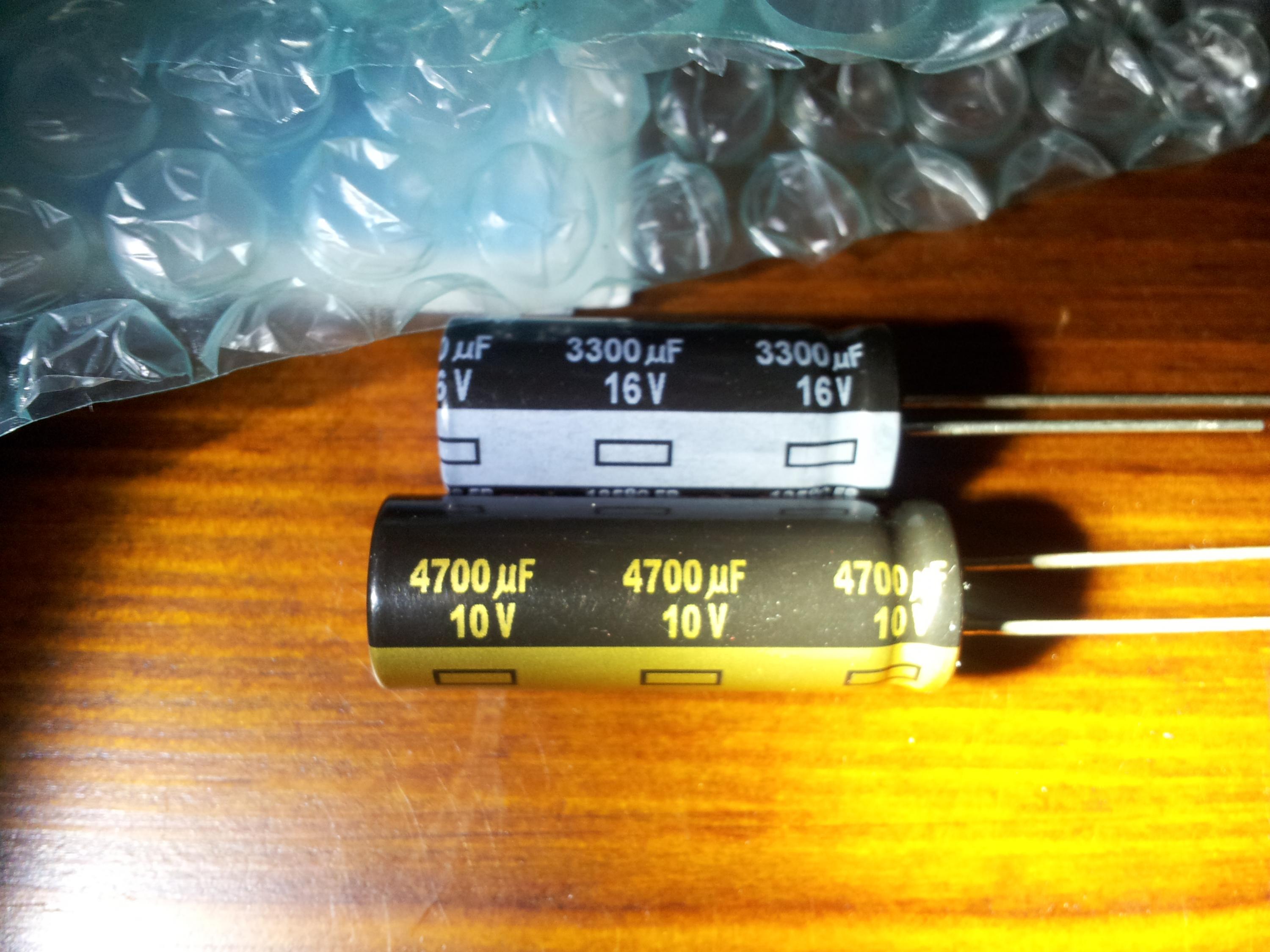

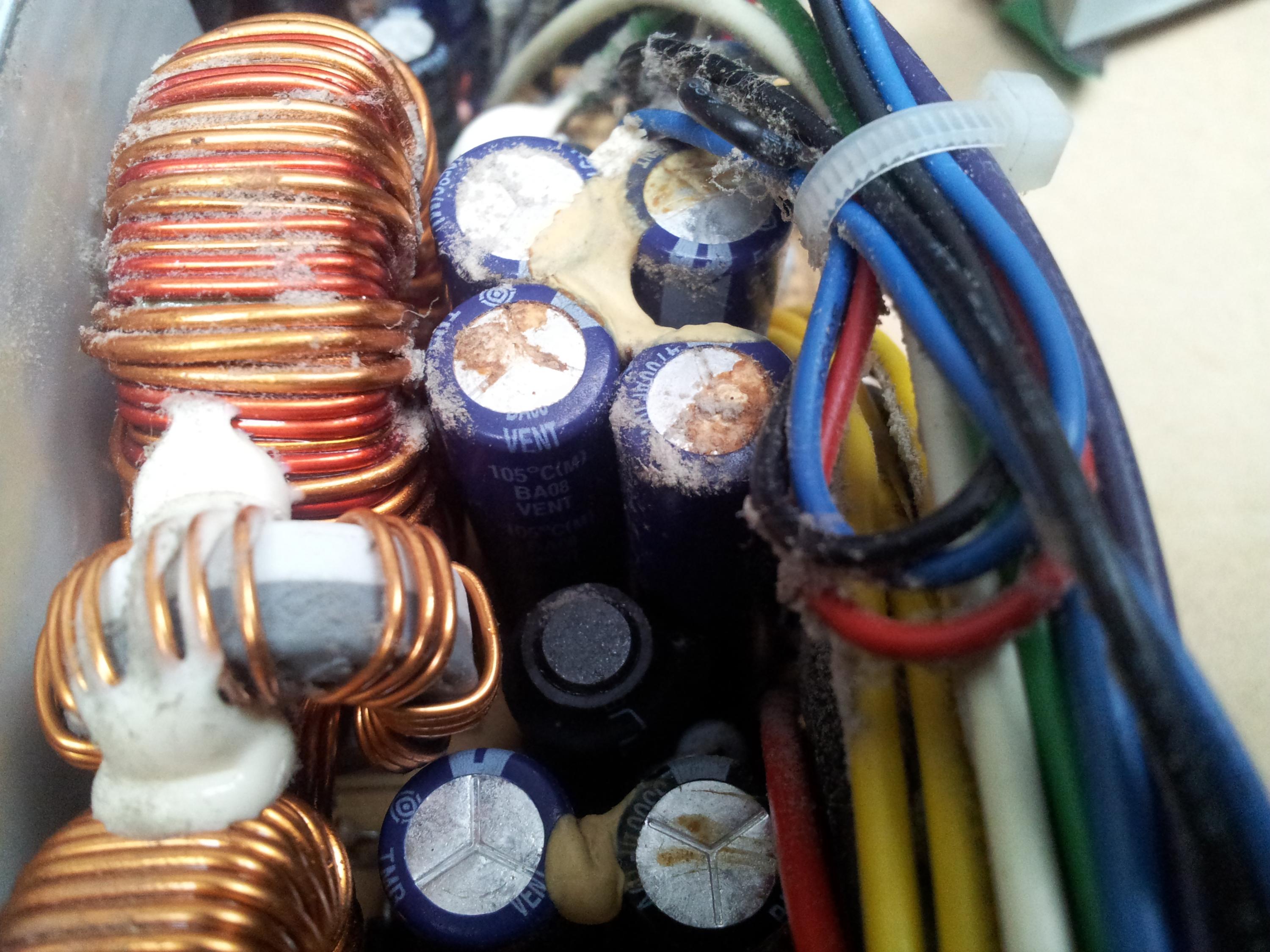

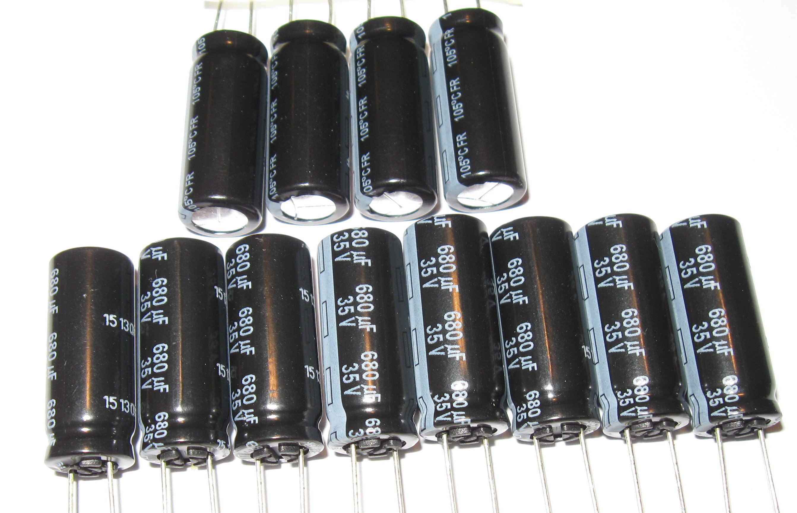

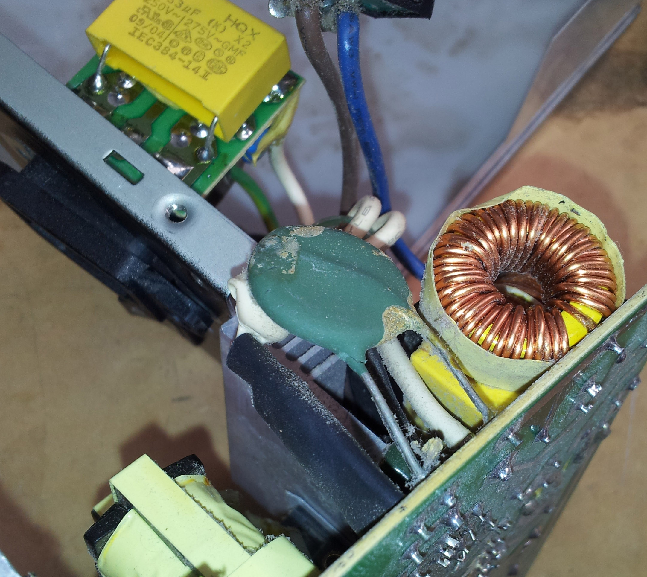

Looks like these have been quite popular to re-cap over the years here.
I have a unit that been running 24/7 (mostly) for the last 6 months.
Before that it was used in my HTPC for about 6 months and before that for a few years in my desktop/gaming PC before upgrading.
I seems like a decent unit and has served me well over the years but has been let down by those dreadful fuhjyyu caps.

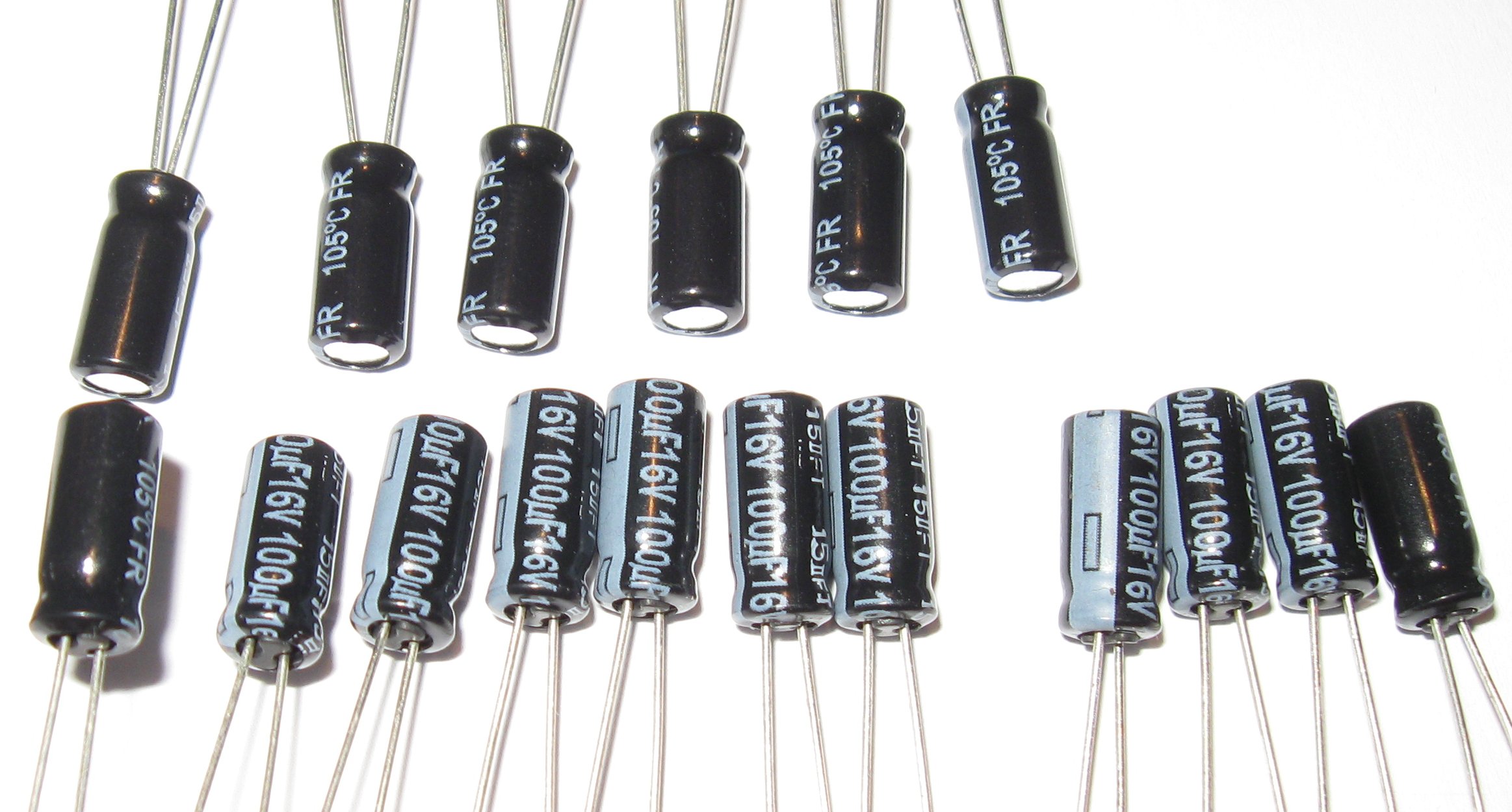

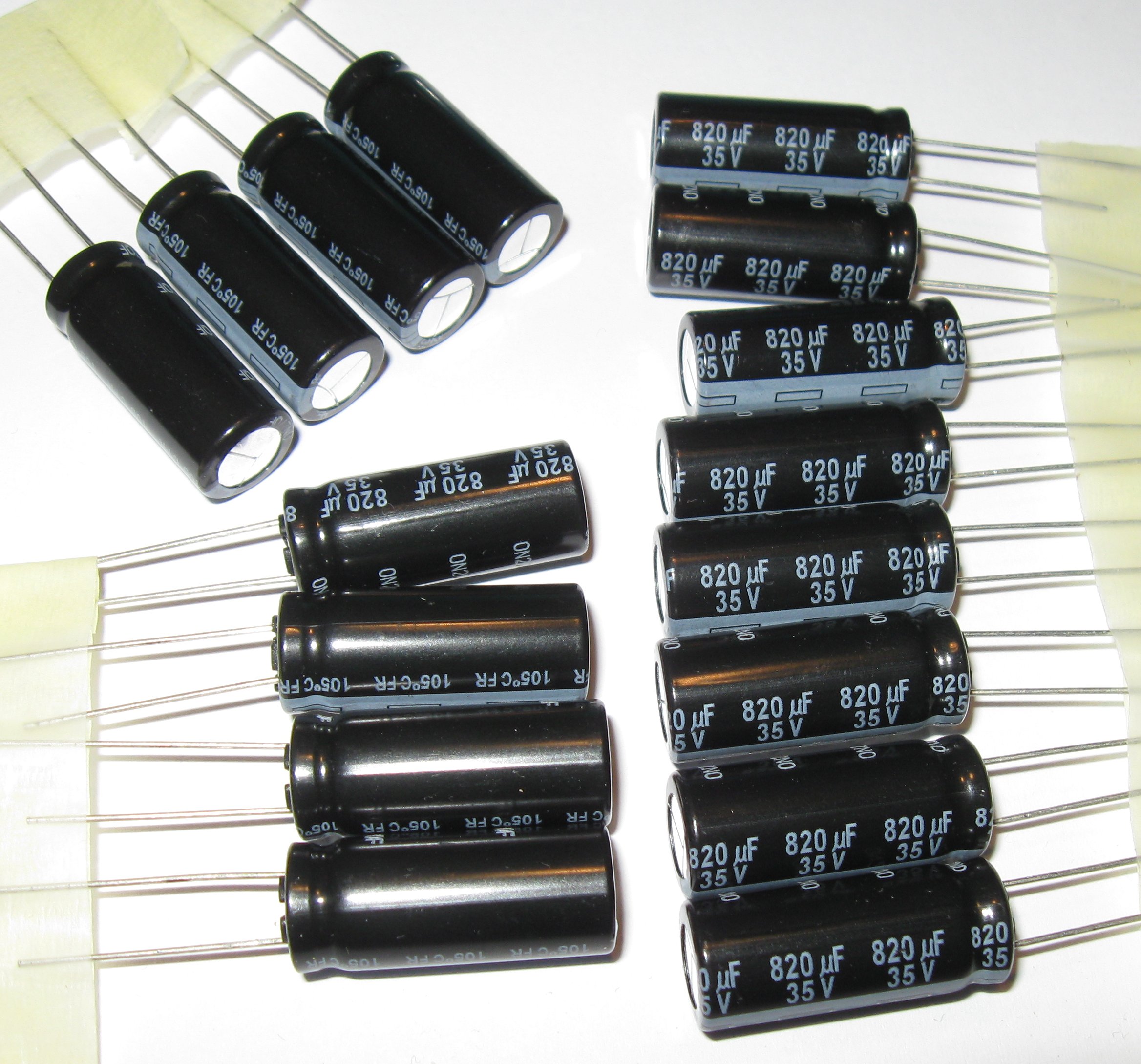

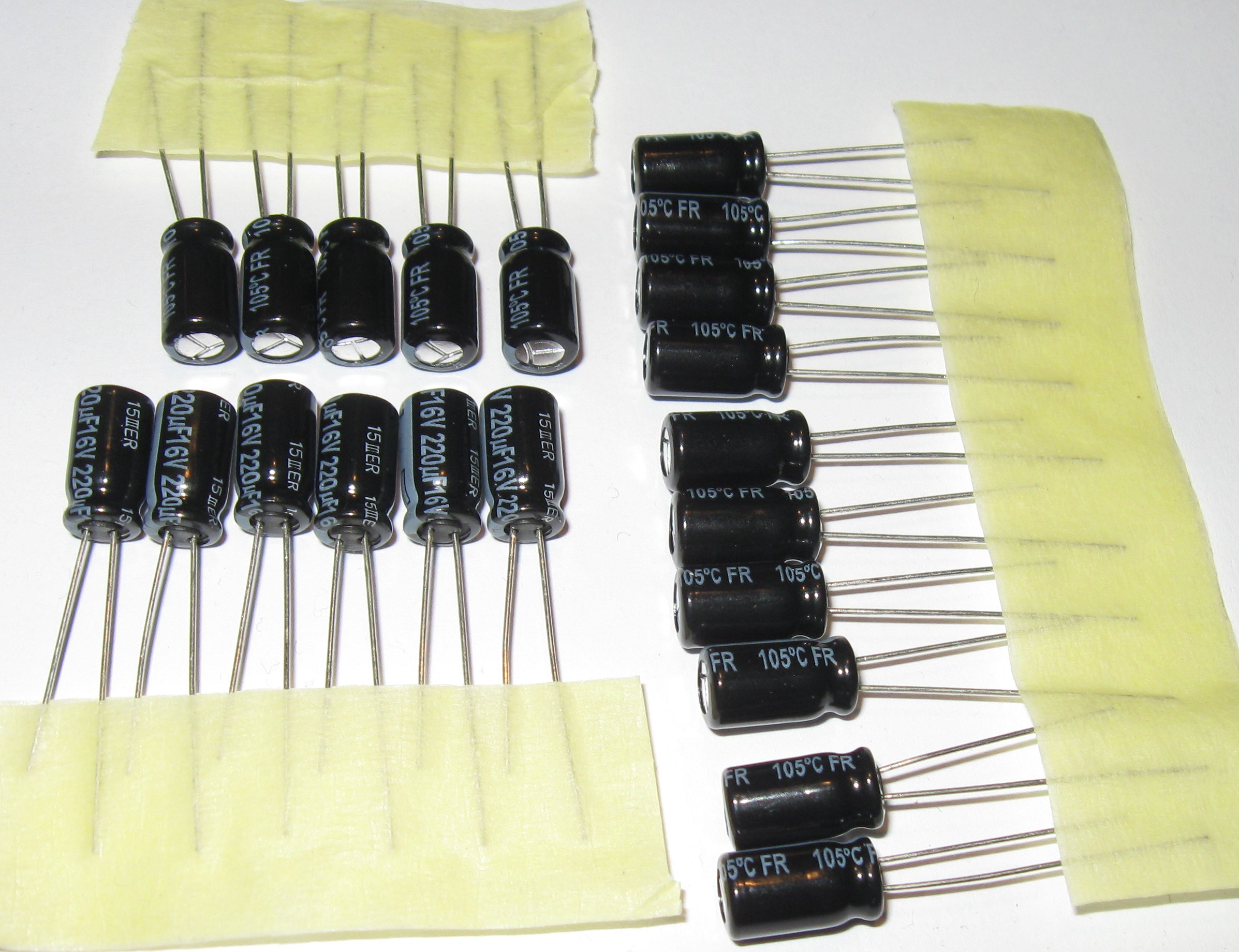

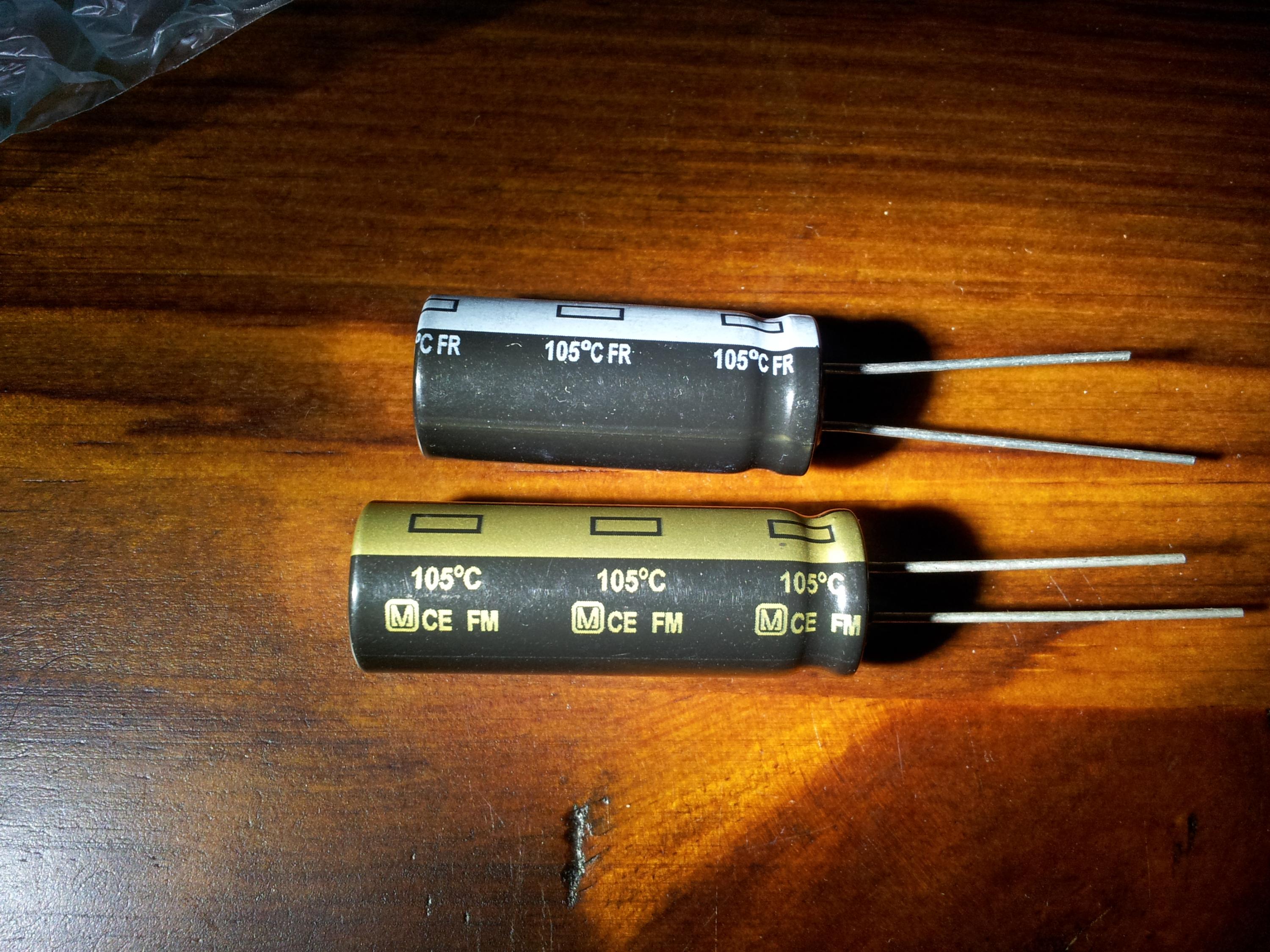

So I have ordered Mostly Panasonic FM and FR or Nichicon or Rubycon depending on size and availability. I used this excelent post as a reference: https://www.badcaps.net/forum/showthread.php?p=89628
I'm confident soldering so should be ok squeezing in the larger Panasonic caps (12.5 vs 10mm)
