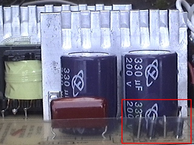

    Guys, Why do PSU makers still use 4x1 rectifier diodes instead of using a bridge rectifier chip? Isn't it more convenient and cheaper?

    cheaper to use 4 than a bridge.
    they can further cheap out by using 2 1a diodes and 2 3a
    in doubler mode the 3a are used.in full bridge mode for220 the current is half so the 1a ones are adequate.
    saves a few cents per unit.

      That`s a fortune in this business only the better brands like FSP and Seasonic usually are using hte bridge rectifier.

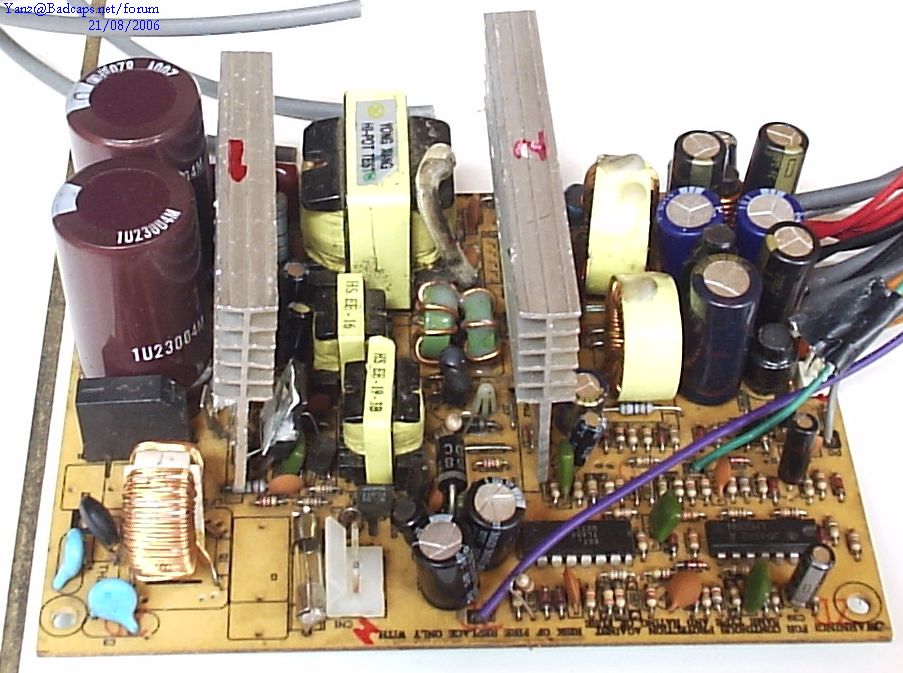

        Almost all respected brand use a chip bridge rectifier. Even the old ones like my Newton, Acbel, Astec, Hipro, and Delta (all under 200W) PSU have it. But i never see one with heatsink on it. According to the datasheet, a heatsink is needed if it will be put on heavy duty.
        I have a LC from 2002 that indeed using a chip bridge rectifier. (Simbadda ATK 300W, recapped )
        But the more recent L&C are cheaping out all it can:
        AIBO ATK 380W
        For those damn cheap deer/crap psu i use this:
        RS405 -> $0.5
        GSIB660 -> $0.25
        D3SBA60 -> $0.75
        They are all rated at 4A or 6A 600V. I think it is overkill to use 4A rated fast/smooth bridge rectifier diodes for this ~400W PSU. 4A x 220v = 880W. But for 110-120v like in the USA, it will have to be 4A at minimal.
        I can use the cheaper 400V rated ones, but is it safe?
        What about using them in dual/paralel? I know it is probably not necessary at all, but i see the enermax 1KW PSU use it. I want to know if it makes any good effect, perhaps like doubling the current ability?

            hmm, that is interesting. perhaps if i upgrade those cheap 330uf/470uf primary caps to 680-820uf or even 1000uf, upgrading the bridge rect is a must. my comp is sitting near the big laser jet printer, probably there are some effect to the line when that monster startup.
            i was seeing some decent psu of 200-300w with rs405 so i assume that 600V is ok, at least i don't have any clue what is the safest/minimal limit on the voltage rate.
            what do you think of deer 400-500W PSU still using those four single diodes, i thought the more wattage it is the cleaner the input line needed for the psu? or is it not significant wether to use the chip form and the single(s)?
