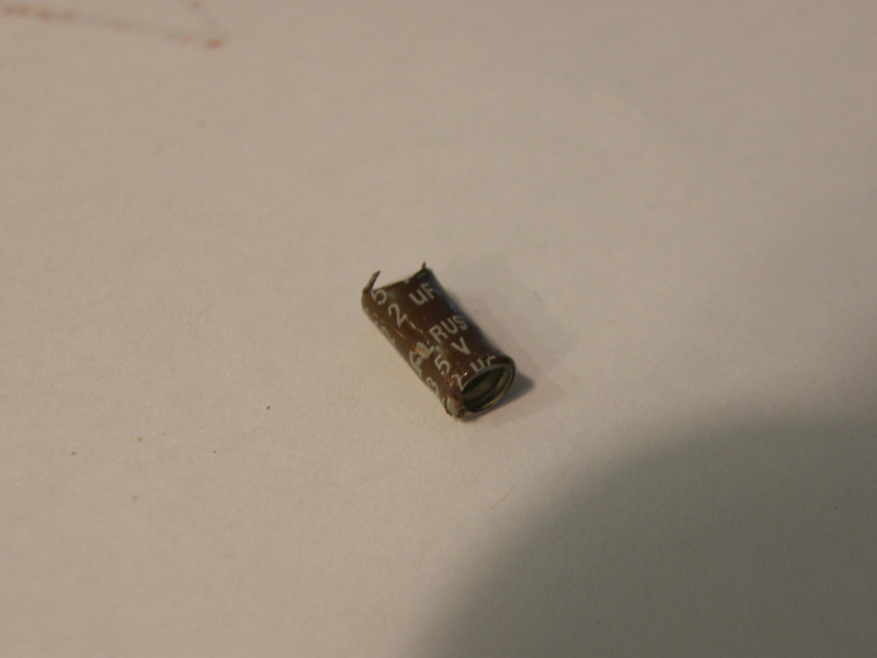

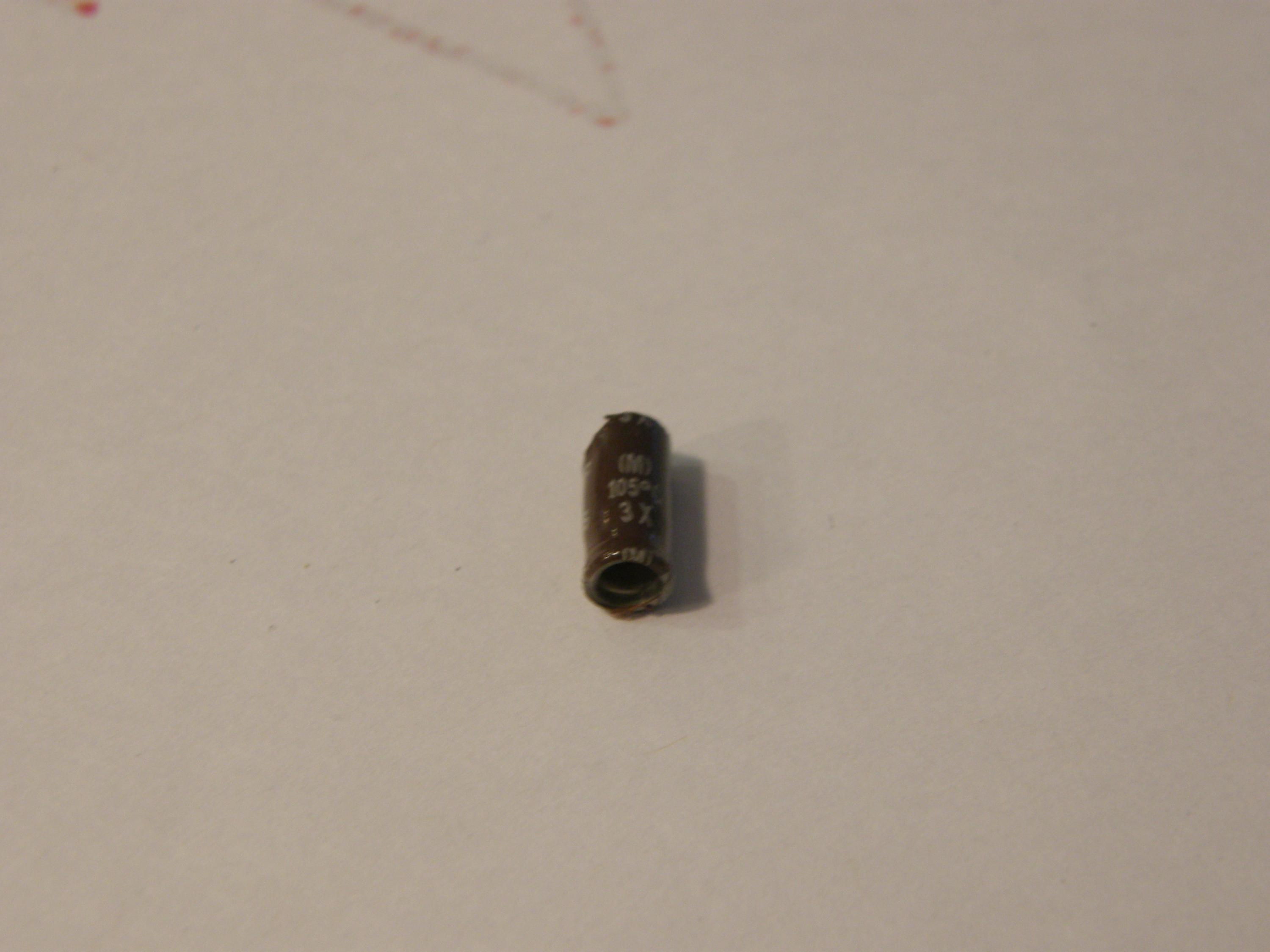

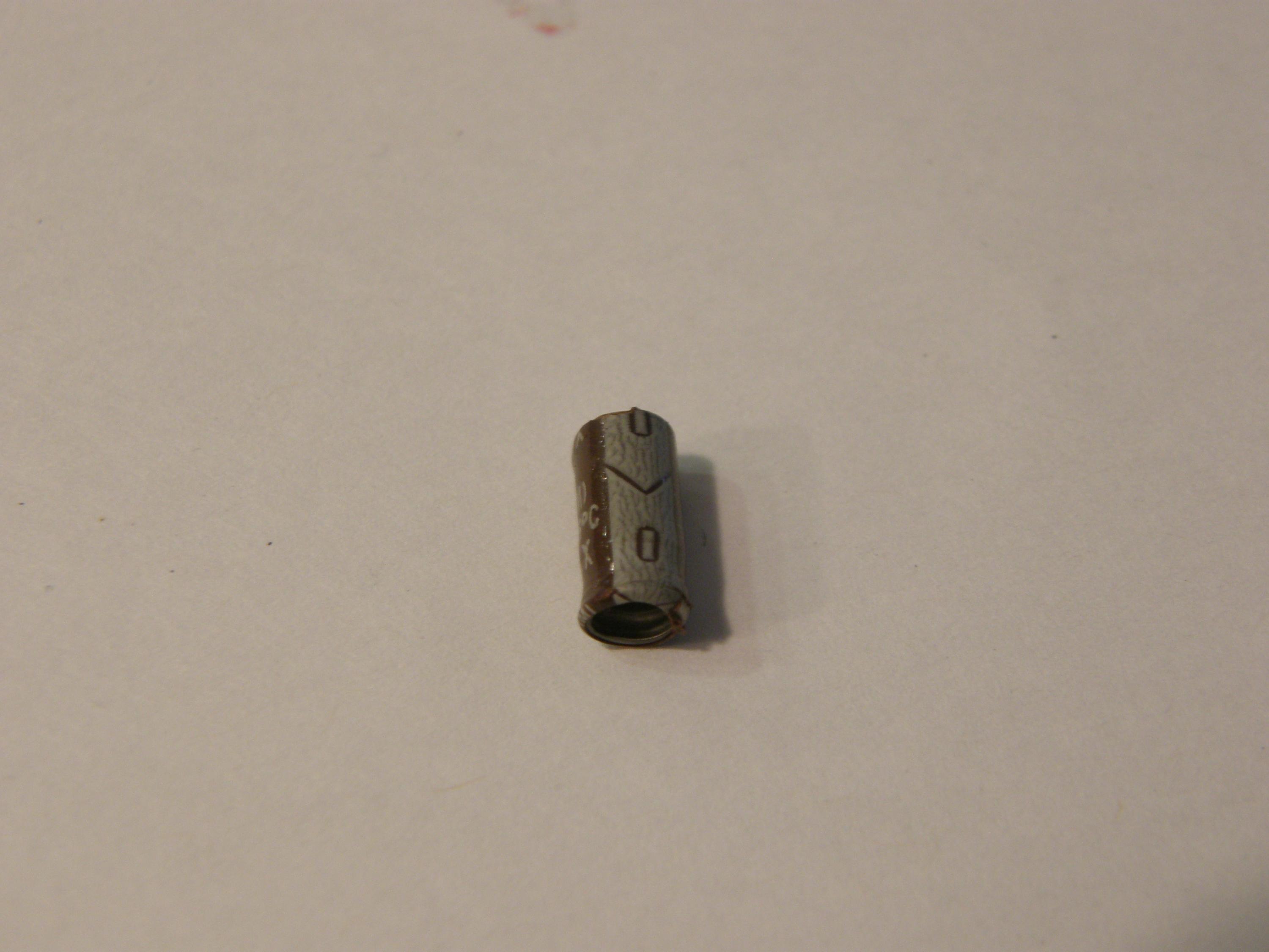

    Any chance you know what C22 was rated for? It's not necessary, but would be interesting to know. Hopefully there are enough remains of that capacitor to determine that. If not, what are the part numbers on IC3?
    Attached are pictures of the casing of the C22 Capacitor, as well as one of IC3. So no problem with Identification, but the part number of IC3 is 5M0365R.
      Forgot to post Pics

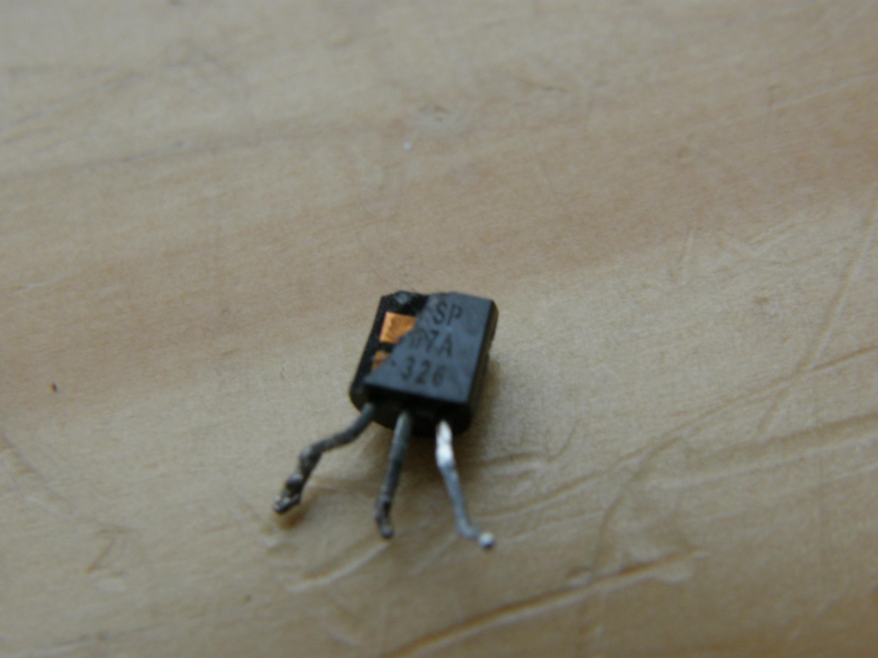

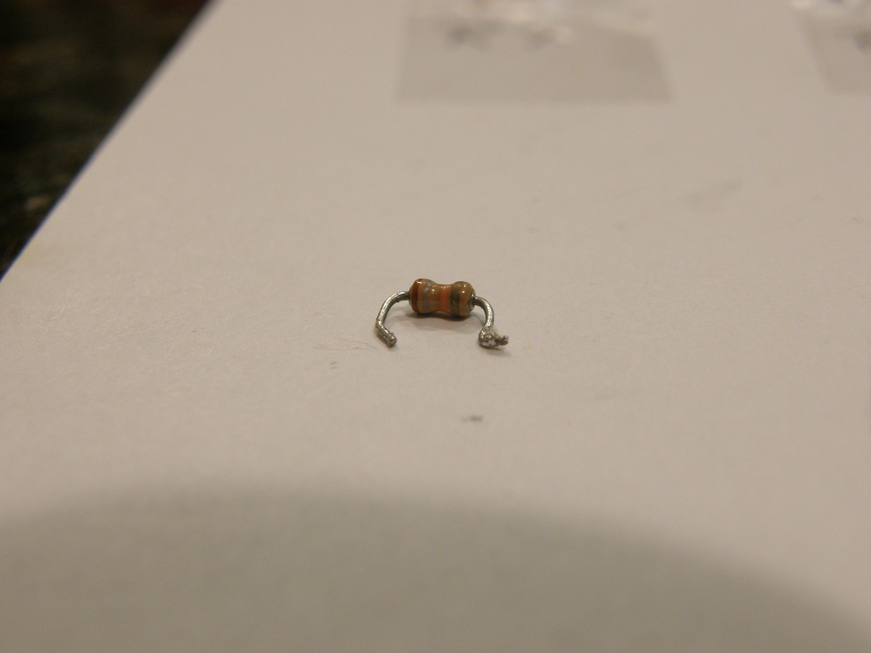

        OK. I removed all of the bellow...
        D4, D5, D15, D16, Q5 ,Q6 ,R2 ,R3 ,R5, R6 ,R7 ,R8 ,R9 ,R22 ,RS1 ,RS2
        All of the Diodes tested 'Not Good'
        Only Resistors R5 and R55 Tested 'Good'

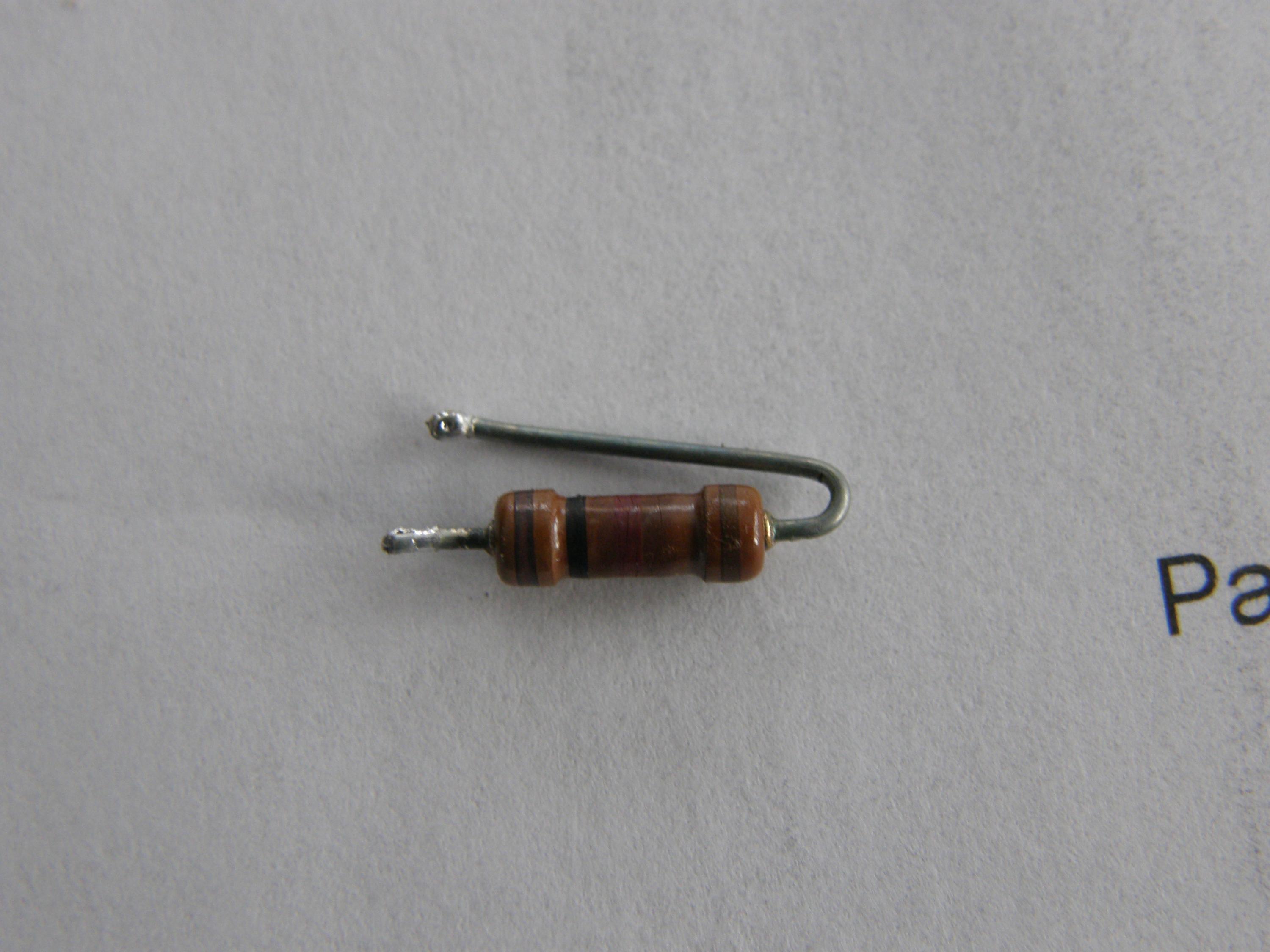

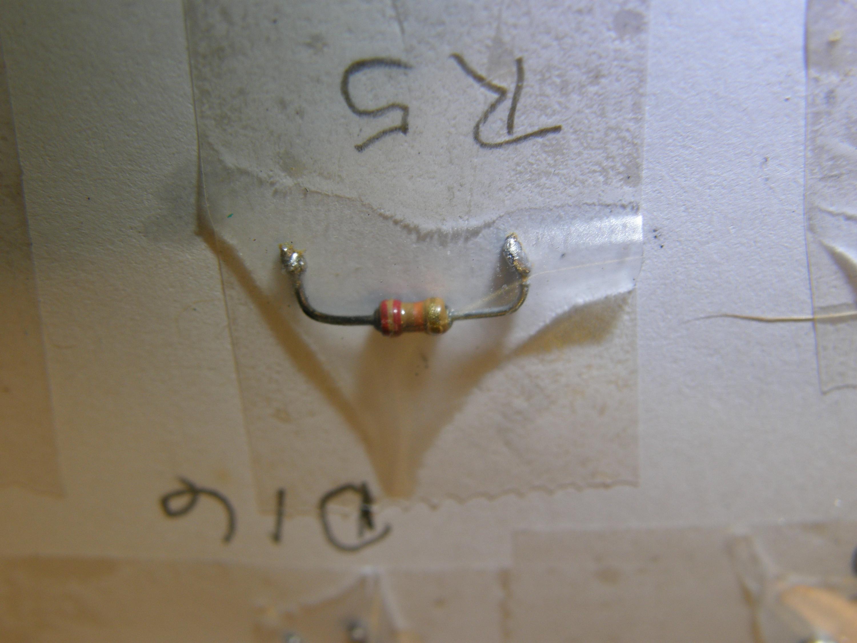

        Here Are the values I coded the Resistors as and their Tested Values.
        RS1 - .24 Ohm 5% - Open
        RS2 - .24 Ohm 5% - Open
        R2 - 23k Ohm 10% - Open
        R3 - 23k Ohm 10% - Open
        R5 - 22k Ohm 5% - 22k Ohm
        R6 - 23 Ohm 5% - 12.3 Ohm
        R7 - 28k Ohm 5% - 18.1 Ohm
        R8 - 23M Ohm .1% - .786M Ohm
        R9 - 23M Ohm .1% - .767M Ohm
        R22 - 30 Ohm 5% - 10.2 Ohm
        R55 - 4.7k Ohm 5% - 4.73K Ohm

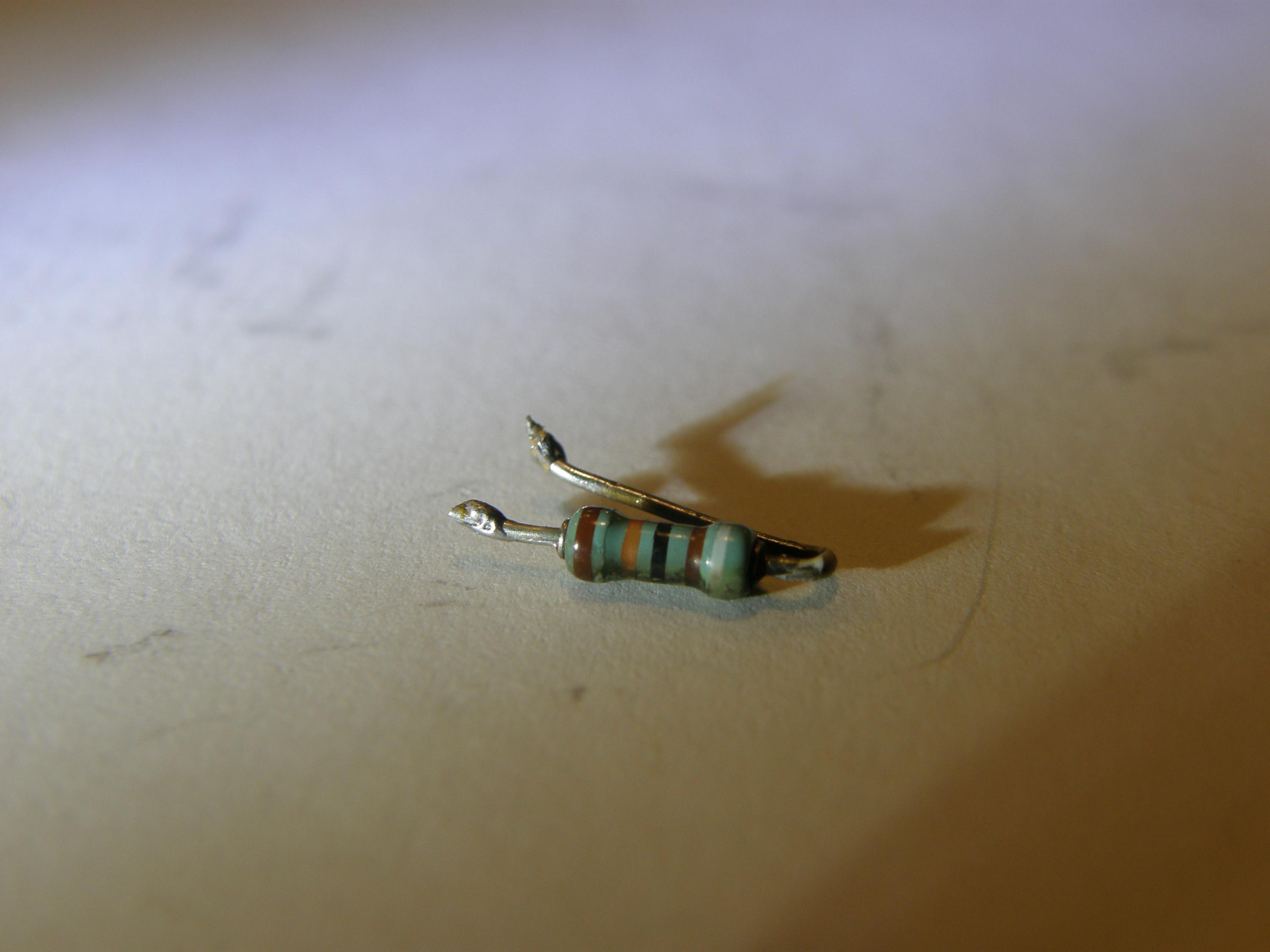

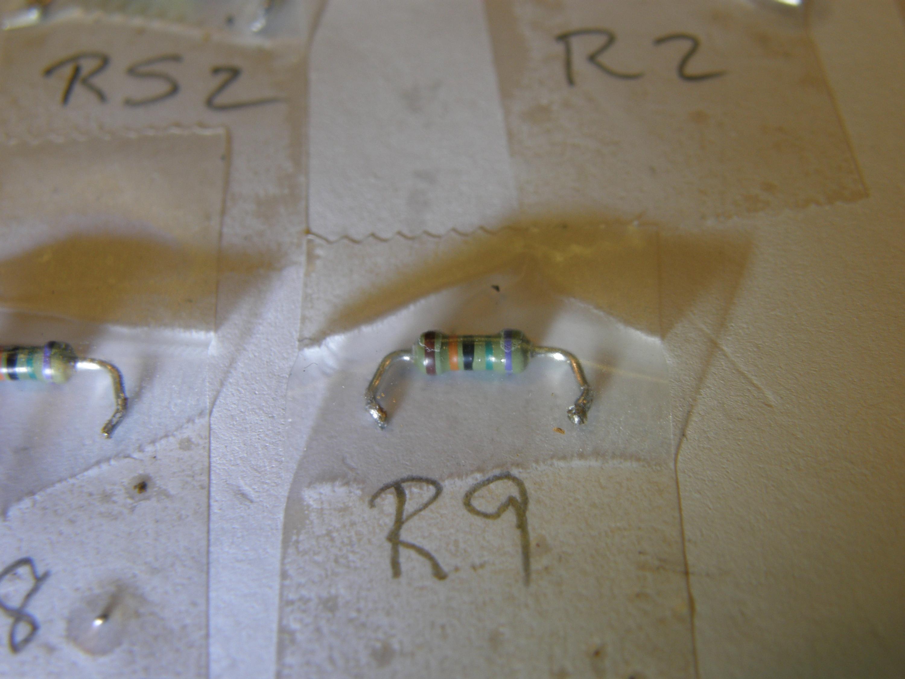

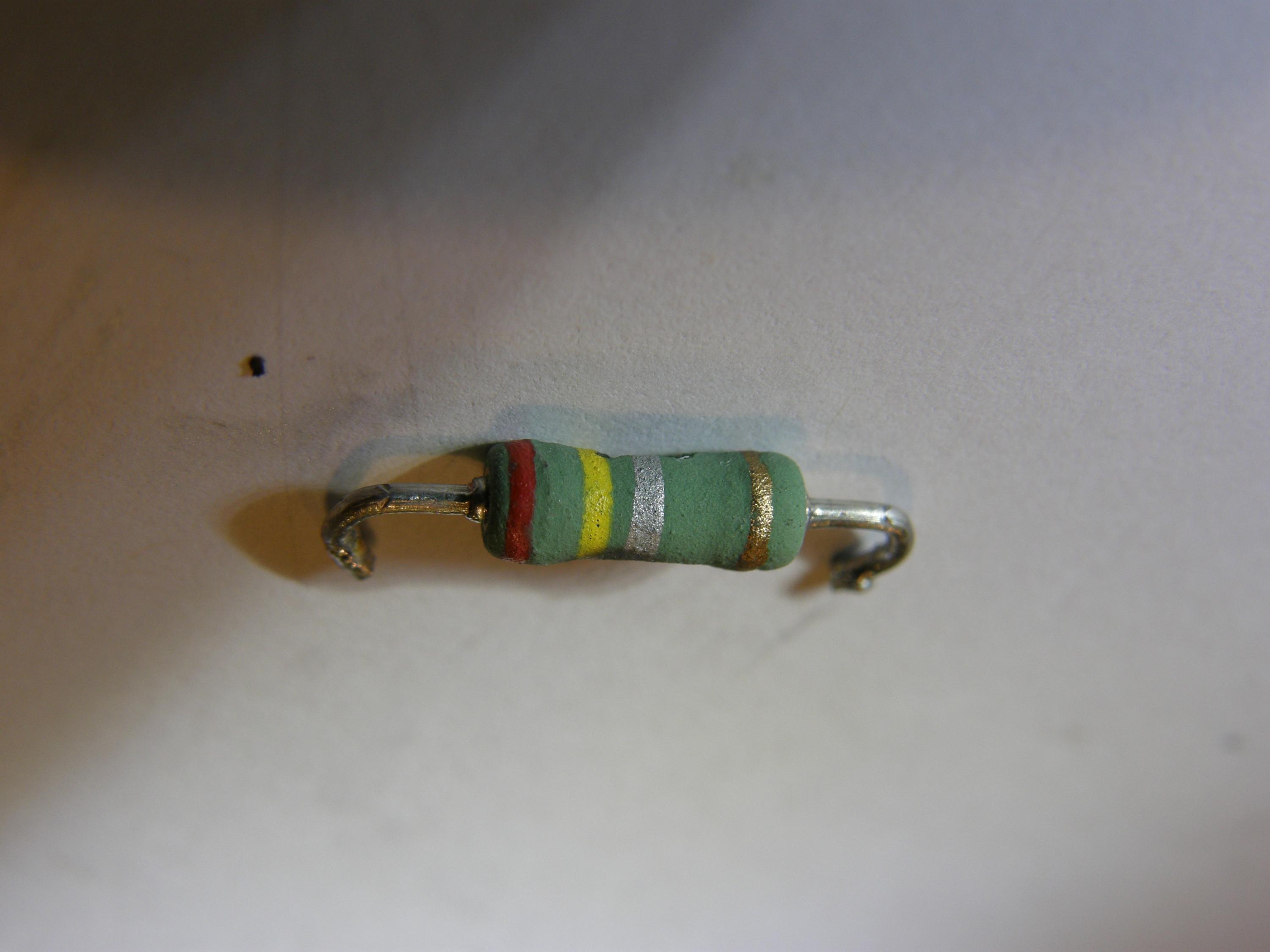

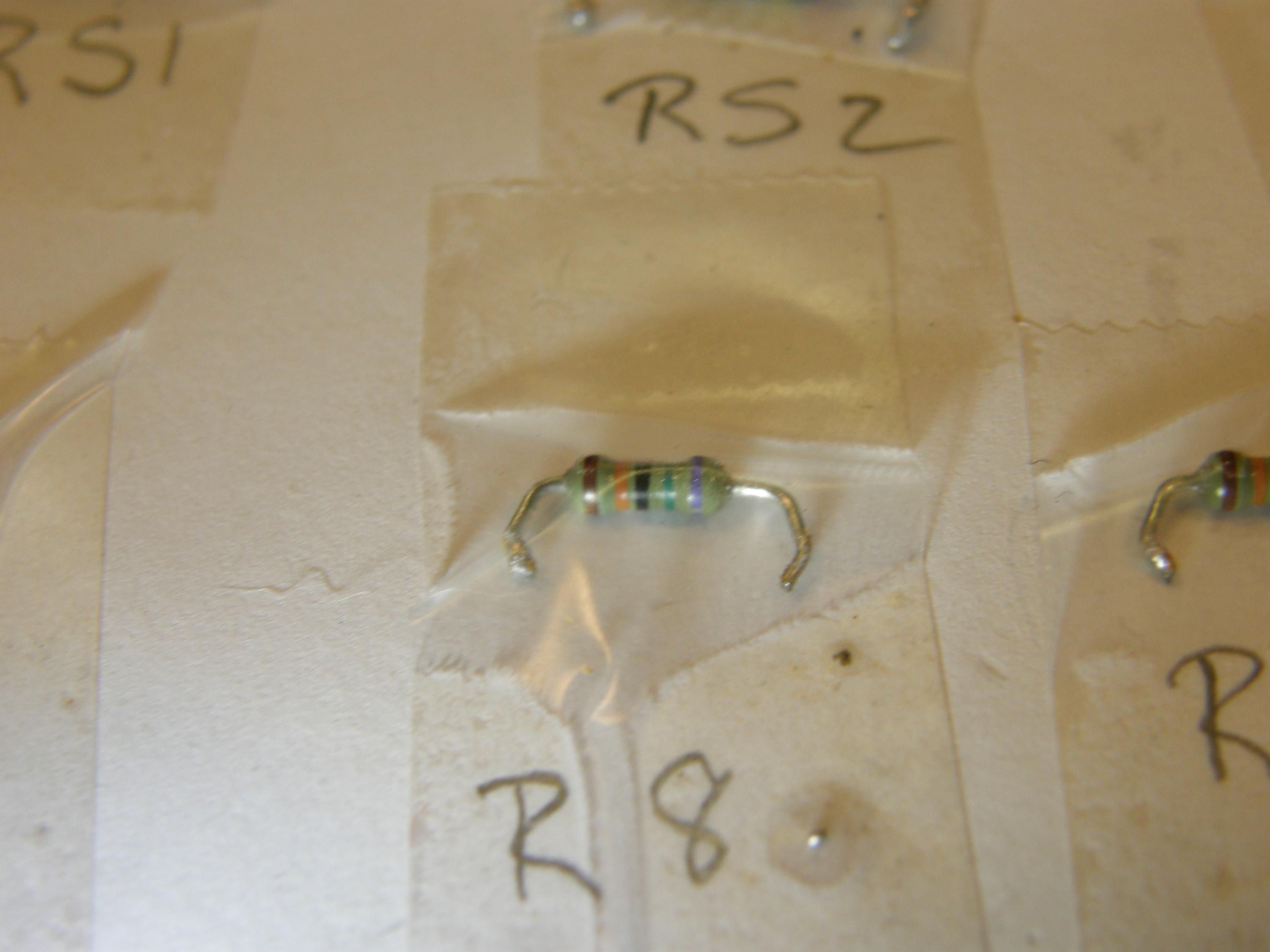

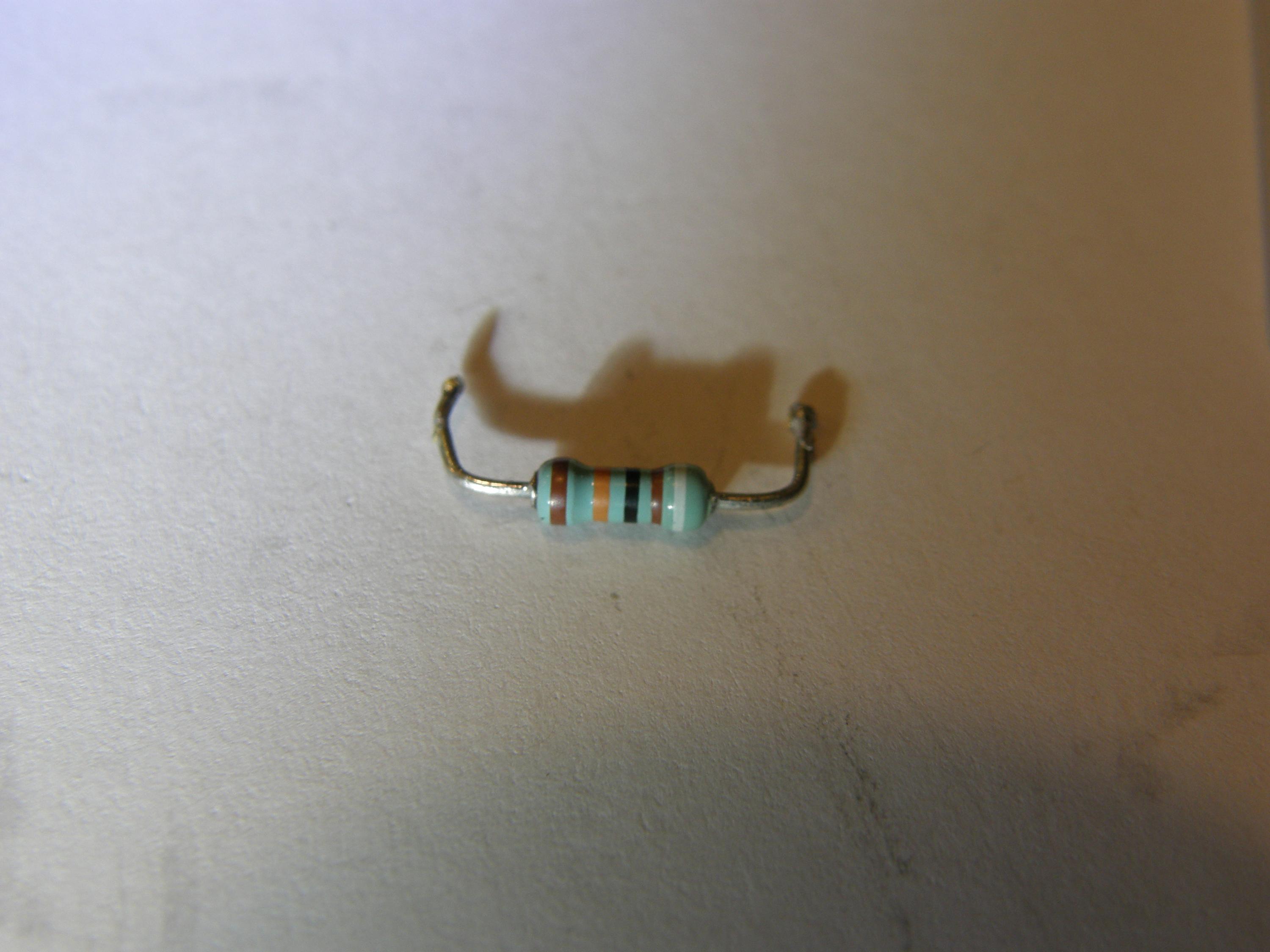

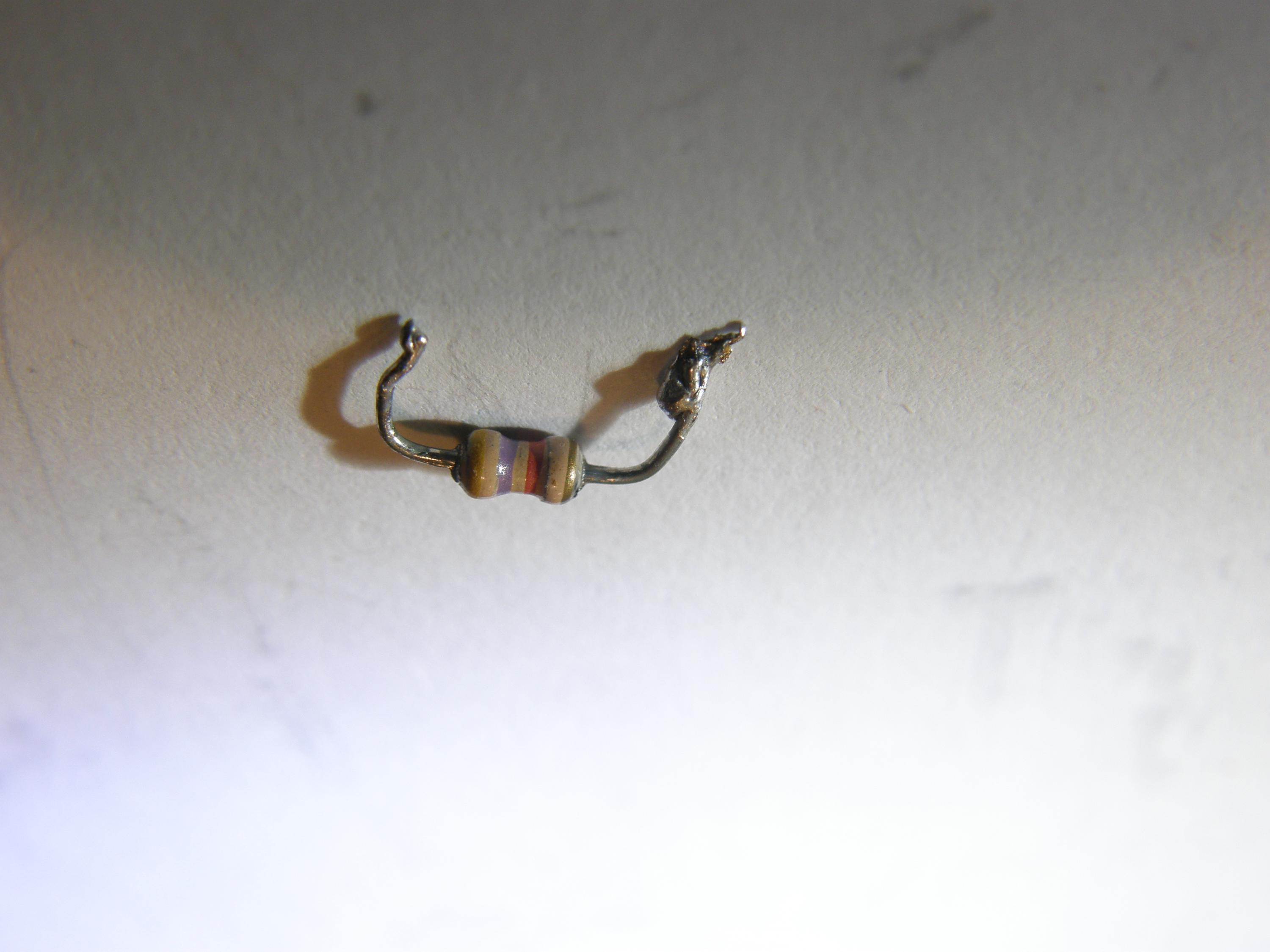

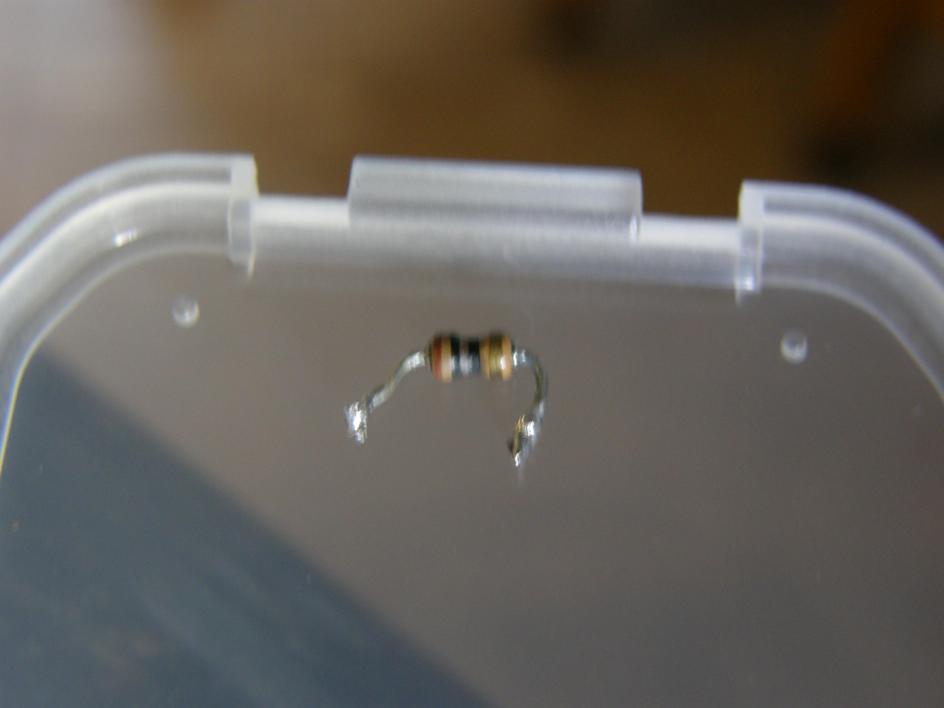

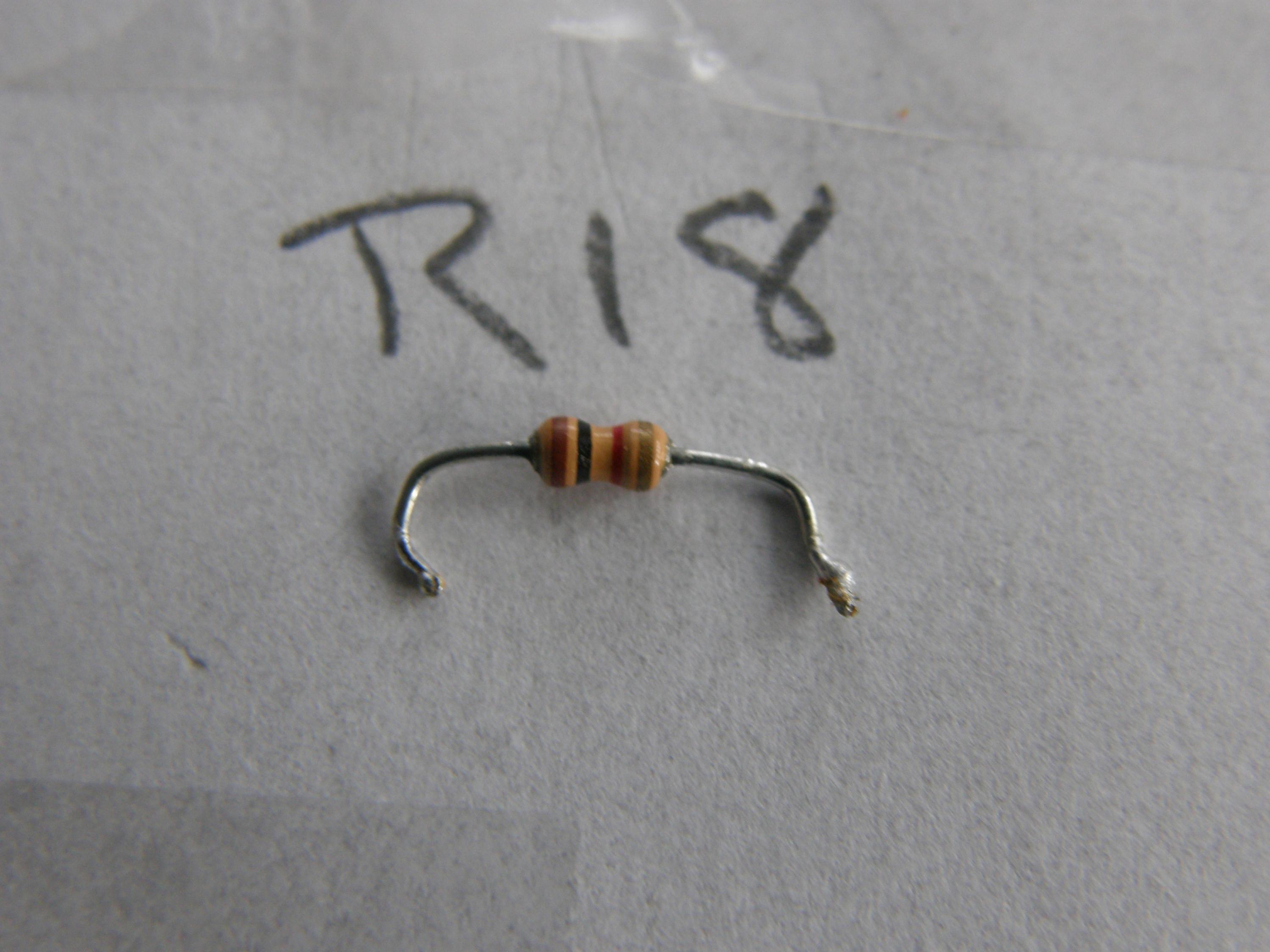

        I've Attached Photos of all the resistors (Pic name is Resistor). My eyes are not near what they used to be, so I had to use Pics to help identify them. If anyone disagrees with the values I used Please let me know.
          Correction R8 test value was .768M Ohm
          Also, I think I mis-identified them. I'm thinking they are 760k Ohm 1%.
          If this is correct, then they are very close to 'Good'.

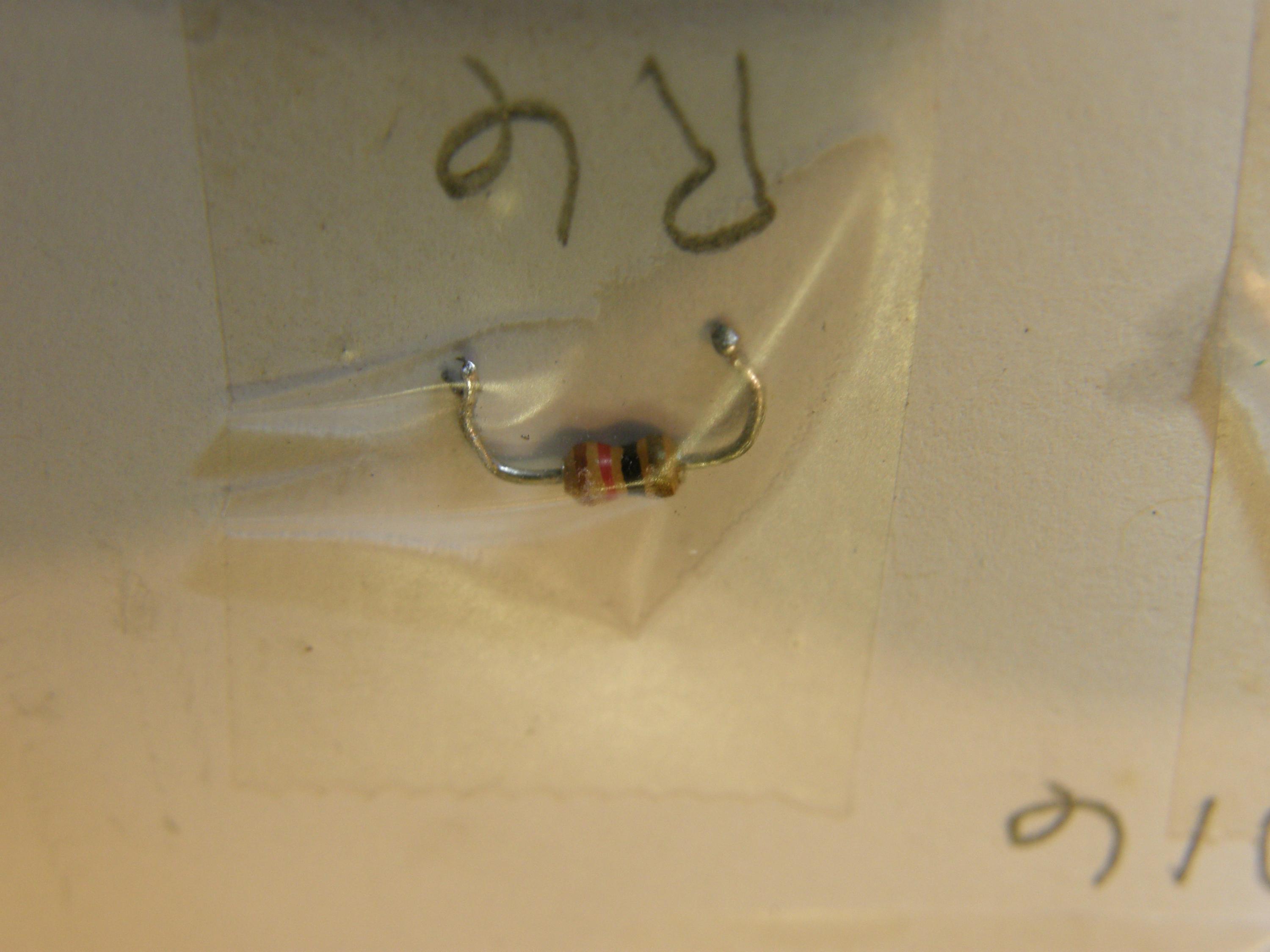

          • lti
            • May 2011
            • 2557
            Re: Help with Bentek DMC BP-200AD Power Supply
            I think R6 and R22 are good as well. Their color codes match the measured values.
            • grzesiek
              • Jan 2011
              • 23
              Reading R6 as Brown, Red, Black, Gold, I agree. I saw the first band as Red and the second as orange (old eyes).
              Reading R22 as Brown, Black, Black, Gold, I agree. I saw the first band as orange (old Eyes).
              Thanks for looking. After looking at the photos again, I agree, R6 and R22 are likely good.
                Originally posted by grzesiek
                Do you mean stuff like wall chargers and adapters for other devices?
                Yes.
                But with the number of potentially bad parts, you need not worry about the chargers/adapters now.
                C22... 22uF, 35V. Means the voltage must have went way over 35V for that thing to launch like it did. No wonder if this is why the APFC controller died. I'm actually very surprised that IC3 didn't blow first! It's rated for 30V max too (or maybe it has and that's why standby isn't working properly). No Zener diode protection either. I think tom66 is right to say that this is a badly designed power supply.
                Using the Diode test All the Diodes tested gave a result of 000.
                Is that both when the diodes are forward-biased and reverse-biased with the multimeter?
                Just to rule out any foul measurements, can you check what readings you get for D19 and D20. If nothing else blew up besides that capacitor, D19 and D20 should be good. Out of circuit, you will get a reading in one direction (when forward-biased) and no reading in the other direction (reverse biased). If not, can you check the bridge rectifier, BD1? That one should be good for sure. Just put red probe on either of two the middle pins and black probe on the pin closest to the edge of the board. You should get a reading that is not "000". Probably anywhere between 300-800 mV or 0.300-0.800 V (may take a second or 2 for the measurement to get there).
                Also, as far as the resistors go...
                R2 and R3 are 910 KOhms (according to this calculator) so check it again. Not sure if that's right, though.
                R6 is 12 Ohm, so the reading you got is good (as lti noted).
                R7 is 18 KOhm, so the reading you got is good.
                R8 and R9 are 750 KOhm, so the reading you got is good.
                R22 is 10 Ohms, so the reading you got is good.
                That leaves only RS1 and RS2 as bad, and potentially all of those diodes.
                With all of these parts removed, also check the resistance between pin 6 (GND) and the rest of the pins on IC1, the FAN7527B APFC controller (page 3 on this data sheet shows the pinouts)
                Of most particular interest are the readings across pins 4-6, 7-6, and 8-6. Let me know what values you get.
                  Glad I posted those pics. I really struggled with the colors of the bands.
                  By the way... the back (flat) side of Diode Q6 is blowen out as well

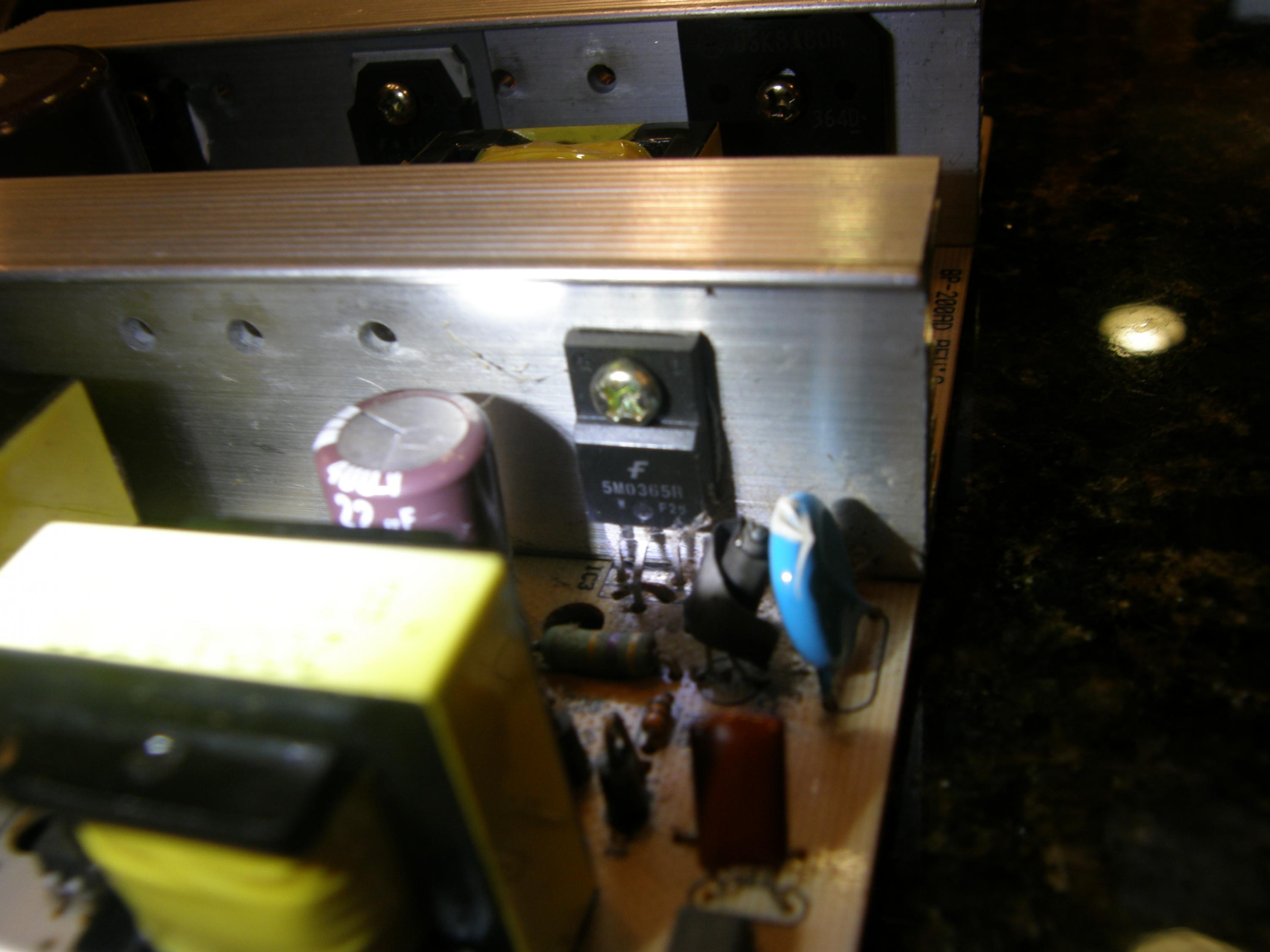

                      The output (pin 7) and voltage supply pin (pin 8) are pretty much shorted to ground. Your FAN7527B IC is toast .
                      That means Q1 is also likely toast. Check for short circuit (200 Ohm scale) between its 3 pins and let me know what you find. D3 probably survived, but check it anyways.
                      So the failed parts we have so far are:
                      RS1/RS2, D4, D5, D15, D16, Q6, IC3, and C22.

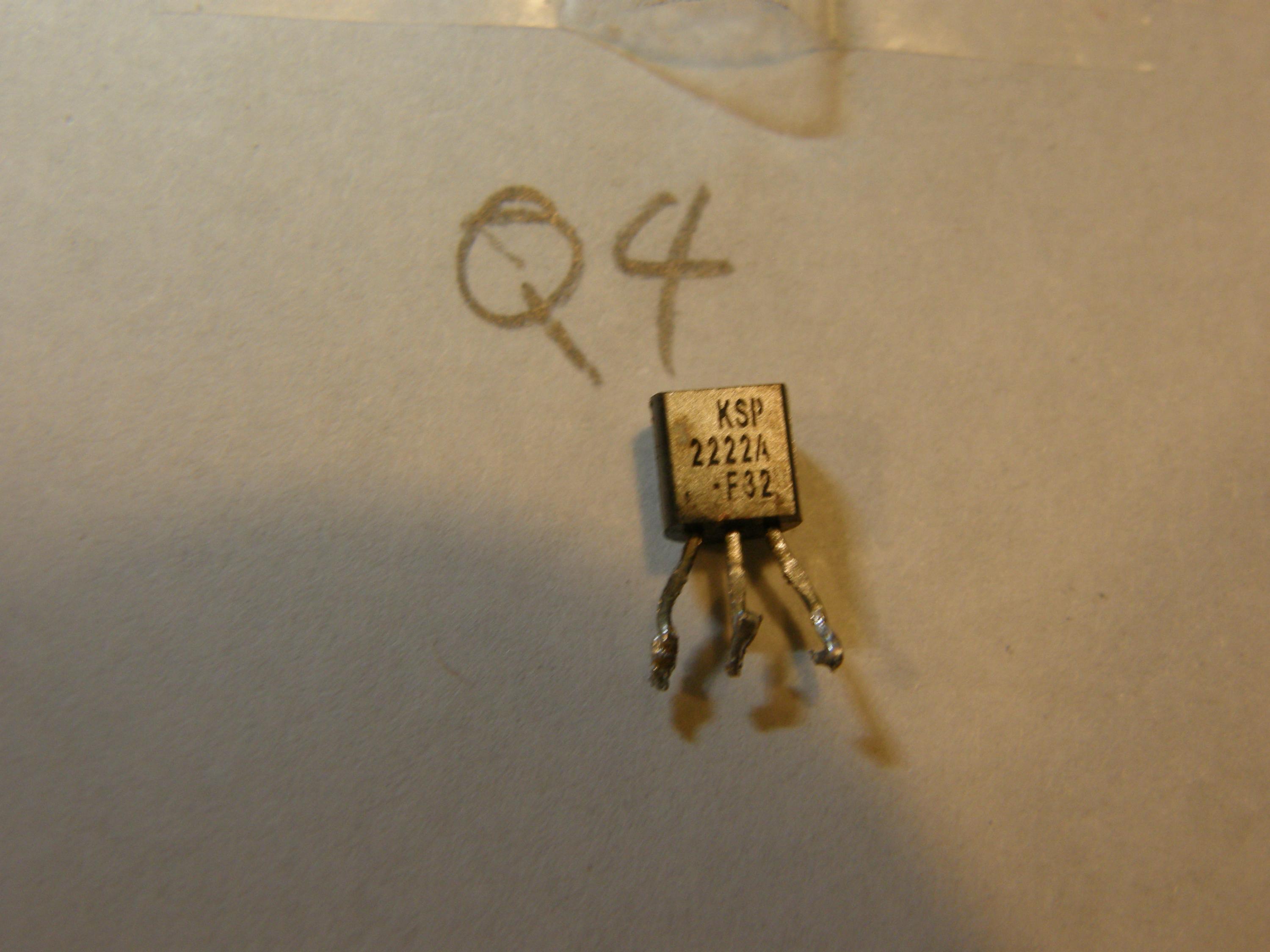

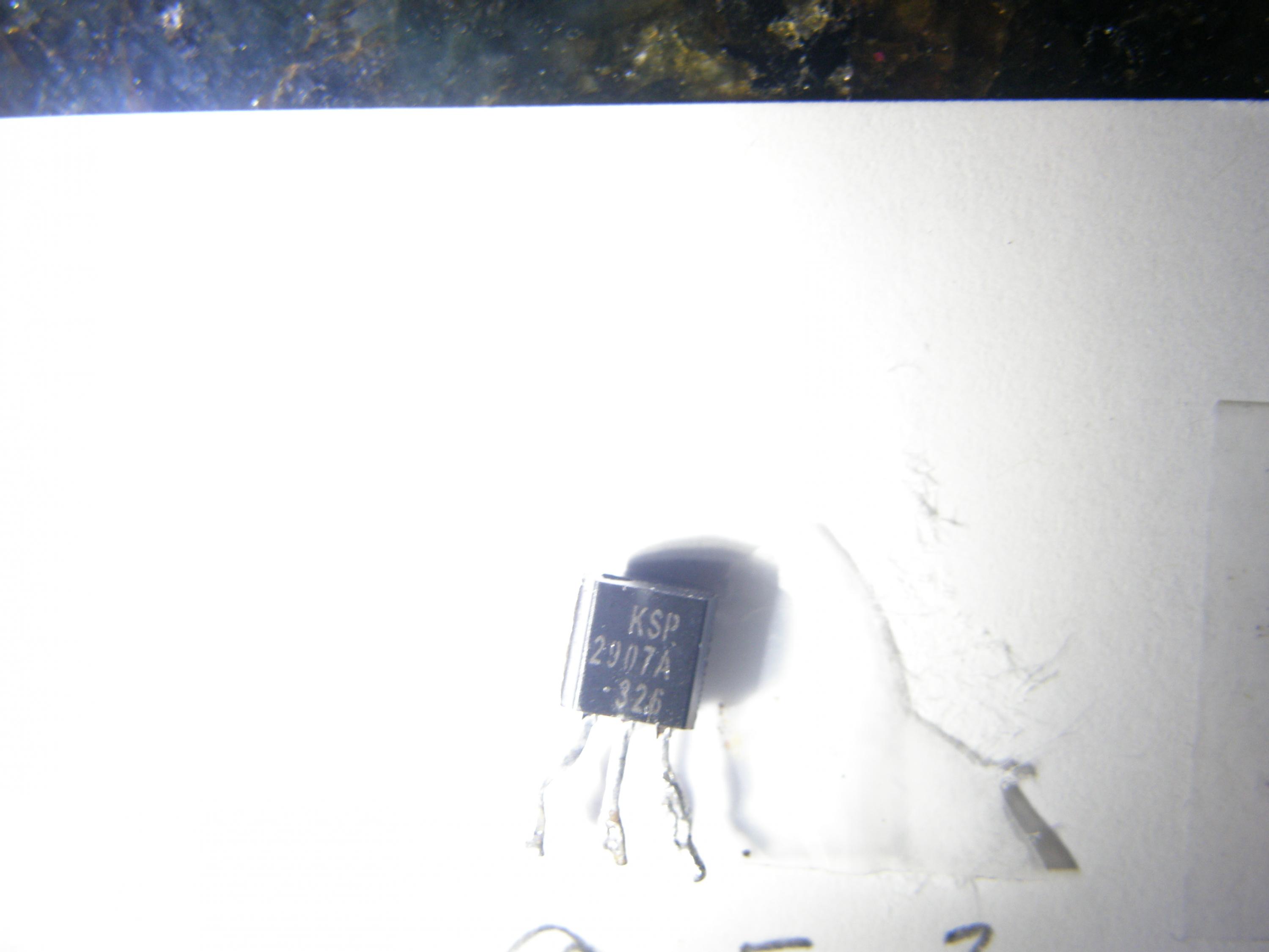

                        I started putting together a shopping cart on Mouser, and stopped. I notice there are several different FAN7527B IC's, and Resistors (RS1 RS2) have a number of Watt values. I don't think the FAN7527B matters(?) but I'm thinking it will matter for the other components. You are doing so much already, I hate to ask, but I'll need help putting together a parts list.
                        Also, I can see the numbers on D15 (526 5819) and D16 (514 5819), But D4 and D5 I can't even tell if there are numbers on them. And I don't have a powerfull enough magnifing glass to see them. I'm not sure how to Identify them. Any ideas?

                            Yup, Q3 is toast. Will need the numbers off of that too. D3 is good, though.
                            It does, actually. I see 2 different packages for the FAN7527B IC - one is SMT/SMD and the other is regular through-hole/DIP. You want the DIP, and not the SMT/SMD. Both of these will do (the first one is just end of life and low on stock so that's why it's a bit cheaper):
                              Also, any luck identifying the numbers on Q6?
                              I've attached a Pic of Q6.
                              So Far R22 R23 and R25 tested Good.
                              I've yet to test R16 and R18. D7 D8 D9 D17 Q4 and Q5. I want to take them out of the board. I'll get on that tomorrow.
                                #35
                                Possibly a 2N2907.
                                • grzesiek
                                  • Jan 2011
                                  • 23
                                  #36
                                  So Here's My results...
                                  D17 - 595
                                  R16 Pic Attached - 998 (not good I think)
                                  R18 Pic Attached - 989 (Not good I think)
                                  R25 - 75 Ohm - Good
                                  R22 - 10.2 Ohm - Good
                                  R23 - 100.9 Ohm - Good
                                    R18 is 1 KOhm resistor, so the value you got indicates it is good.
                                    R16 looks a bit toasty to tell precisely what its color code is. However, it looks like 1 KOhm as well. So it's probably fine too.
                                    I don't know how to test Q4 and Q5.
                                    Post what part numbers they have or post pictures.
                                    I'll try look into the FAN7527B and 5M0365R data sheets on Sunday to see if we can make some modifications to the circuit so that the auxiliary voltage doesn't destroy them. It might be as simple as adding a few Zener diodes to the cart.
                                    **EDIT**
                                    R23 color code looks like a 100 KOhm resistor to me, not 100 Ohm. Did you measure it in or out of circuit?

                                      #38
                                      You're right about R18... Head math I was thinking value was off by 10%, I see now only 1%
                                      I coded R16 at 2Kohm (Not good), and I agree it's toasty, I think for the price it's worh replacing.
                                      Your right R23 is a 100K ohm, and I typed result incorrectly, it measures 100.9K Ohm (in circuit).
                                      Any hints on how to test Q4 and Q5.
                                      ***EDIT*** Just noticed request for part#'s/Pics of Q4 and Q5... Info to follow.

                                      • grzesiek
                                        • Jan 2011
                                        • 23
                                        #39
                                        Pics Of Q4 and Q5 attached
                                        Numbers As I see them...
                                        Q4 - KSP 2222A - F32
                                        Q5 - KSP 2907A - 326
                                        ***EDIT***
                                        I just noticed... 8 of the 11 digits of Q5 match what remains of Q6. Is it possible (likely) thay are the same part?
                                        Q6 - ?SP ??07A - 326

                                          #40
                                          ***EDIT***
                                          Excellent observation there. Yes, they almost certainly are.
                                          As far as testing...
                                          Q4: set transistor so that its flat side is facing you (just like in the picture). The left-most pin is pin 1, middle is pin 2, and right is pin 3. With the red (+) multimeter probe on the middle pin (pin 2) and multimeter set to diode test, you should get a diode reading when you touch either pin 1 or pin 3 with the black (-) multimeter probe. Also you should not get any short circuit/beeping from the multimeter between any of the pins (out of circuit, of course). If you do, then the transistor is bad.
                                          Q5: same procedure as Q4 but switch your multimeter probes (i.e. black probe goes on pin 2 and red probe goes on either pin 1 or pin 3).
                                          Also, in case you want to test any other transistors, this is the general procedure:
                                          1) find transistor data sheet to see if it's PNP or NPN
                                          2) next find the pinout of the transistor - more specifically which pin is Base
                                          3) For NPN, multimeter red (+) probe goes on this pin and you test the transistor by checking if you get a diode reading when you put the black (-) probe on either of the other two pins (the Emitter and Collector). For PNP transistors, it's just reverse of that for NPN.
                                          4) Out of circuit, any short-circuit or low-ohm readings between B-E, C-E, and B-C pins means transistor is bad.
