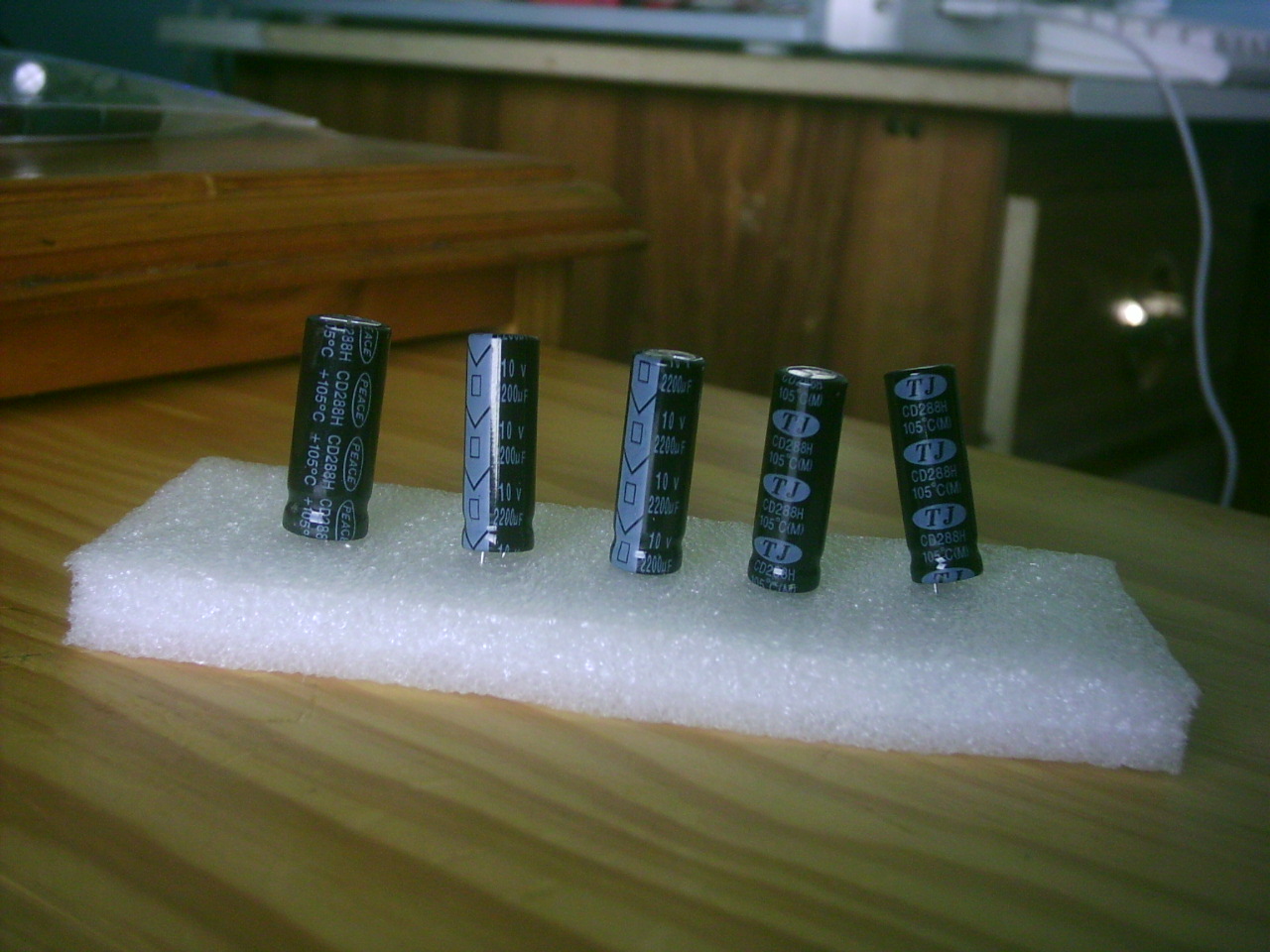

    Following the demise of my last 'yum cha' PSU (purchased within a CoolerMaster case) I picked up this Codegen 550w PSU, stability seemed good & the twin fans helped to expell all those nasty hot gases from within my OC'ed Barton system's case

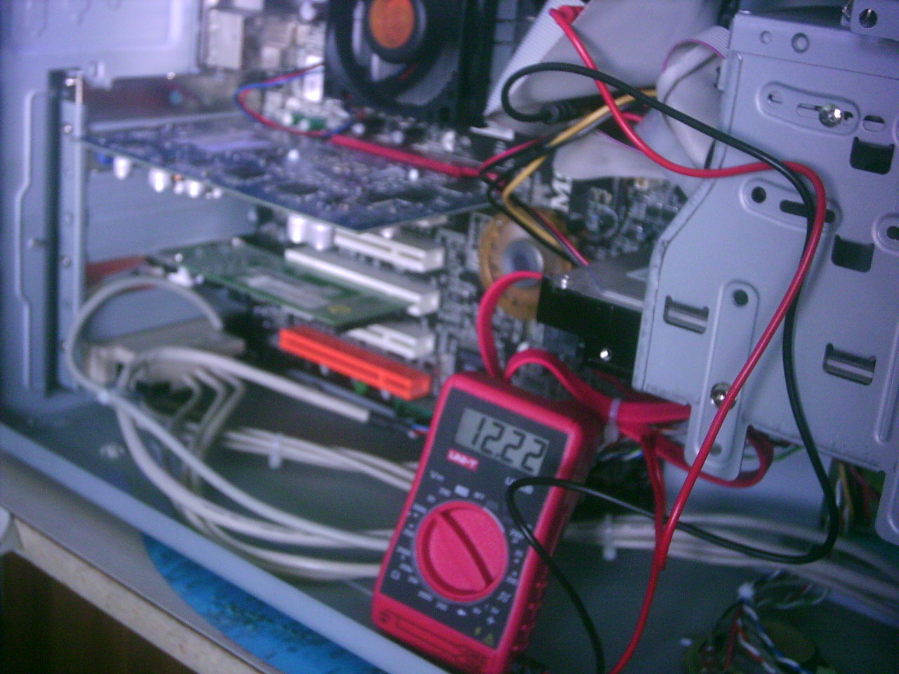

    I've only since built a s939 system based around an MSI K8N Neo2 Platinum & 3700+ San Deigo... anyway I'll cut straight to the nitty gritty, after some odd OS symptoms, I tested the loaded voltage lines only to note significant 12v fluctuations 12.19 ~ 12.31... this can't be healthy I thought
    On dismantling the PSU, I found no sign of capacitor bloating on the TJ & Peace components (see pic' below) installed, construction quality really was quite ghastly (monkeys with soldering irons), so while replacing said capacitors with SamXon equivalents, I also resoldered poorly seated components
    Items replaced...
    4 x GC Series SamXon 2200uF 10v
    1 x GD Series SamXon 2200uF 16v
    Interestingly there was a freakish size difference between the SamXon & 'Peace' 16v capacitor the end result of all this tinkering however was a far more stable 12.21~12.22v under 100% loading (F@H) unless you consult the inaccurate 3rd party monitoring software which is claiming 11.66 ~ 11.96v

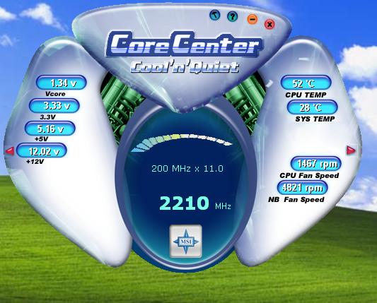

    Hmmmm... how curious, after 6+ hours of 24/7 @ 100% the multimeter is hovering steady around 12.27v ~ 12.28v, whilst the MSI monitoring utility is indicating between 11.96v ~ 12.02v... oddly I hadn't anticipated a 'settling in period' for the capacitor refit
    Still, such utilities are a compromise... I mean just look @ that supposed Vcore
