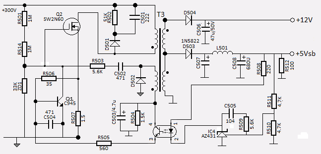

                          Re: Help for fixing PSU
                          Do you have the rest of the diagram of this power supply?
                              Temporarily no. I want to dedicate with +5Vsb first. Maybe later ....
                                The reason I want to see the rest of the power supply is that how this 5+ power supply gets 300VDC from 230V input, at 230V and without PFC, I would expect to see 325VDC feeding it.
                                The humming sound, I wonder if this self-oscillating power supply is running at the wrong frequency.
                                Do you have true R.M.S. meter, if you do, set it to AC and take the AC ripple reading of that 300VDC feeding this circuits.

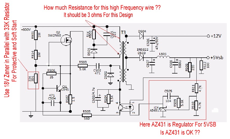

                                  I think it will be little helpful for you .
                                    Sorry that I haven't any RMS meter. Besides, I am also wondering the ability of my multimeter dealing with AC reading. When I checked the AC Voltage or DC Voltage before D502 and D503, it gives out 1.9V.
                                    1. Vow, you are really expert, you even know the design of T3.
                                    The resistance of T3 (isolated) is 4, 0.6 and 0.1/0.2 ohm.
                                    2. I haven't any 18V zener, I will get one next time I visit the shop. Is it really 18V? Can I get 16V or 20V or something? It will be more easy.
                                    3. I think AZ431 is good caused I had already replaced it. (But the "new" AZ431 is extracted from a bad PSU, I will get one from a good PSU to have a test)
                                    Besides, the T3 of my good PSU is EE-19N, the secondary output is different from EE-19, I need to check whether I can get an EE-19 from another good PSU.
                                    Furthermore, I found the DC bias of Q1's gate is 4.xV, compared with another good PSU which is only 1.9V. Is it the biasing of Q1 not good?
                                    Many thanks in advance.
                                      Normally When Primary 5VSB section is Designed with Transistor (Like C5027, C3866), I found T3 Transformer is 4 ohms . But in Mosfet based Design Transformer's I found 3 ohms Resistance . No Problem with 4 ohms if your Series Bulb 40W does not glow . Higher Rated of C502 or C503 will increase your output voltage . I am not sure about the particular capacitor . Most probably it will be C502 . Increase it littlebit (Like 222 PF) and measure the output voltage, what happens .
                                      Is it really 18V?
                                      Yes, I am sure about that - It is 18V . 18V is available in the market . And do not remove the 33K Resistor . Use the 18V Zener in Parallel with 33K Resistor . You can use 16V, But not 20V .
                                      Replace it with previous Regulator with which was given you 5V .
                                      yes, If the Circuits are from different company, then Output "5VSB, GND and IC supply" will be in different places . You Just need 1 Yards wire to check it with another transformer . Cut the 1 Yards wire into 7 Pieces and connect those 7 pieces wires with circuit and Transformer according to your need and keep the transformer besides the circuit board .
                                      Ya, Gate Voltage 4.x is OK . Because Gate voltage is upto +/- 20V for 2N60 .
                                      Set the Multimeter to AC 1000V . Now look at the circuit - Transformer's One pin is connected with Mosfet's Drain Pin directly . Now with Just any ONE probe of Multimeter's touch that line and measure how much AC voltage is present there ?
